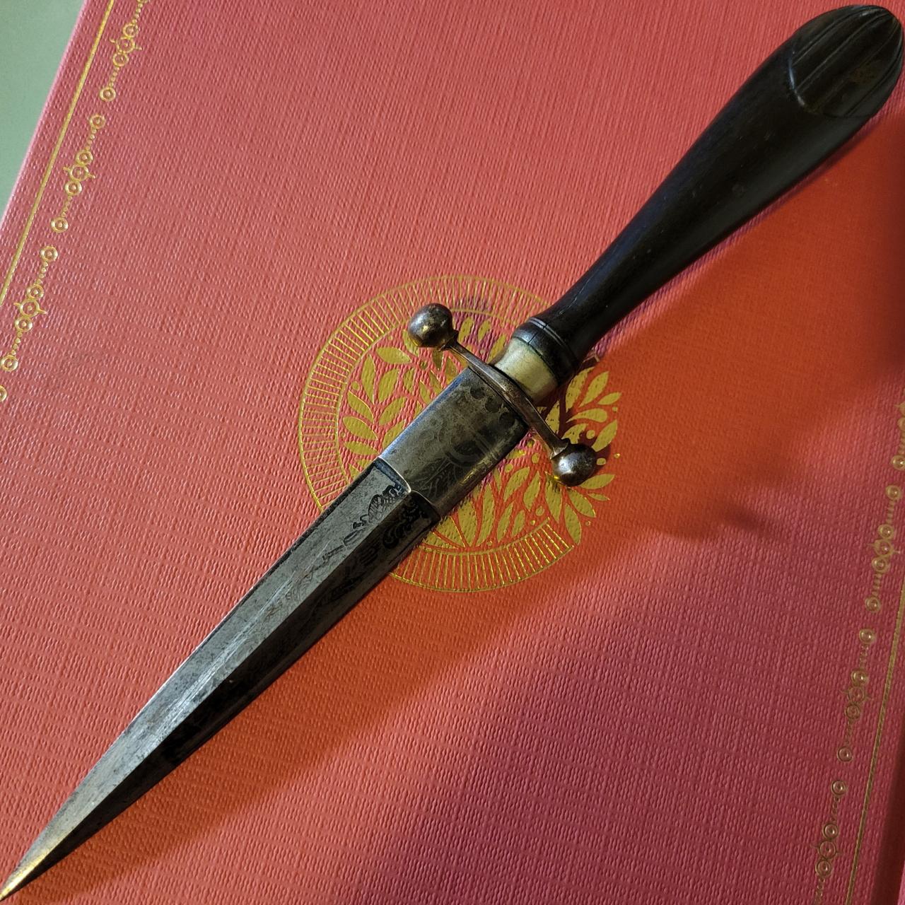

Hello everyone!
I've seen posts from these forums before regarding these type of daggers so I thought it would be the perfect place to ask. I had been looking for one of these daggers since at least 2008 when I first saw one of them at the gotavapen website for the fairbairn sykes dagger. I bought this one on fleebay and unfortunately the seller didn't say the guard was loose to the point it will rattle if moved. It has a good gap. My question is should I risk try to fixing it and if so how? I saw a person on instagram boiling one dagger to melt the resin/pitch keeping the handle attached and then reattach everything again. That dagger however had a bone handle. Mine is ebony wood.
Any advice would be appreciated. I wouldn't want to ruin or destroy this piece of history. But it sucks that when I finally get it it comes damaged like that. I've seen worse though.
If anyone has any information of time period and country of origin I'd appreciate any knowledge you may be able to share.

get a heat gun and warm the blade till its to hot to touch. hold the handle in a glived hand, when you smell the cutlers resin getcwarm push the blade firmly back into the hand.. hold it togeather and cool it off it some water.. fixed.. remember to head the blade slowly so the heat runs up the blade into the tang.. just use a cheap heat gun from a hardwear store

Just a warning, warm not heat, direct hot flame will change the the colour and nature of the blade. If you are unsure of this process, I doubt you intend to use the dagger perhaps a few spots of super glue just to stop it rattling.
Not gluing it all up.

The tang on these daggers is riveted in the pommel of the handle.
Heating the blade will not help solve the problem. There is no resin there.
In addition, there is a risk of damaging the handle, because it is already cracked.
I would leave it alone.

I guess that this dagger is German, from Solingen. I really doubt that the tang is riveted in up from the handle (maybe L_J can confirm) so I would try Ausjulius tip or open the handle and reset it new and strong.
Here a similar one.

Hi, Detlef. On the two that I can show, the tang are riveted to the handle. Both have a gap at the guard and it rattles. It is interesting that both are marked with Masonic symbols. Legendary_Jarl, if the handle your dagger is made of wood, then you can try to wrap it with a damp cloth and give it some time. I think it might help. The handle will restore the lost moisture and eliminate the gap.

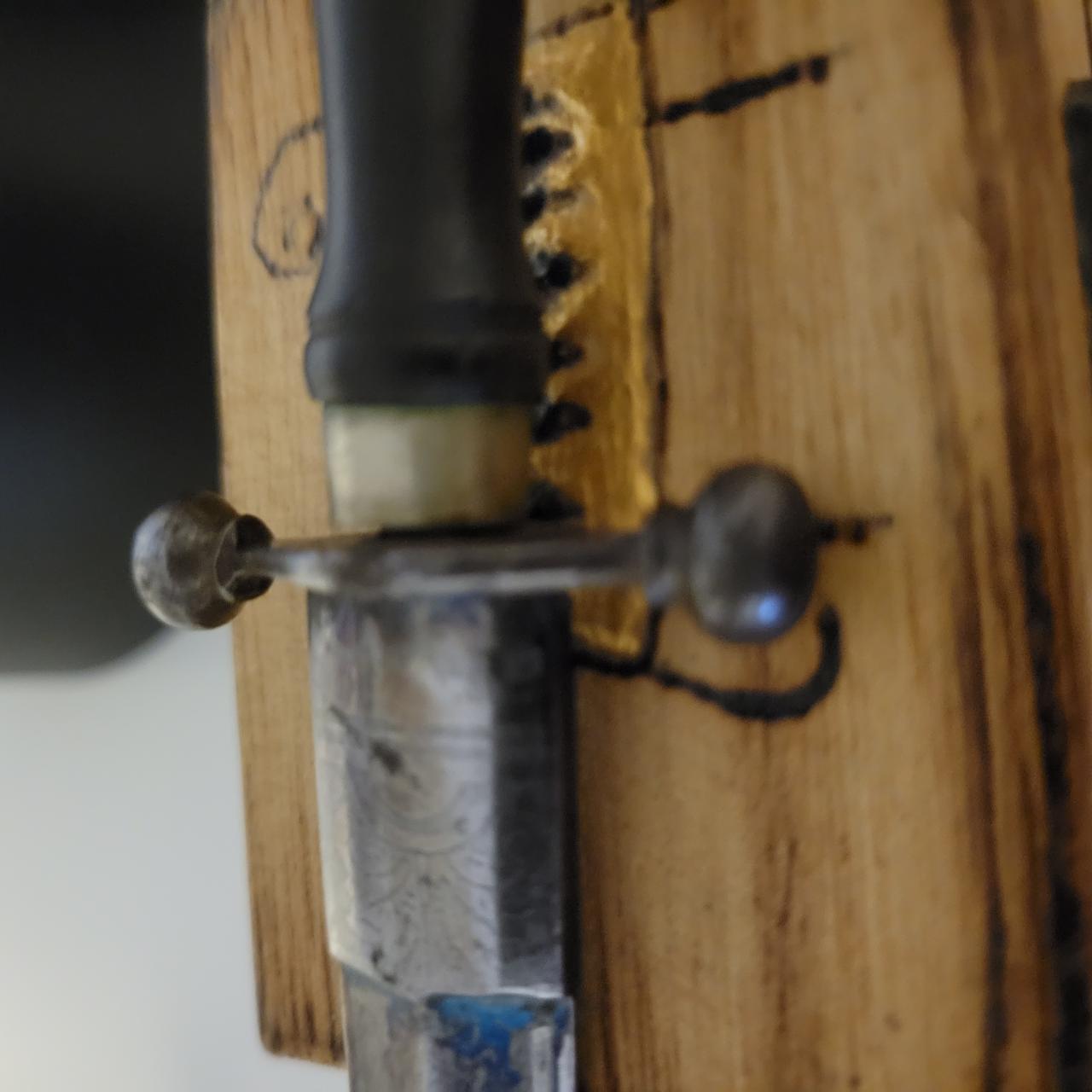

This is the best picture my phone could produce. I guess it was riveted before and it lost it but somehow it is still in one piece?
Will the wood benefit from a light coat of linseed oil?

I would apply linseed oil at the end of the whole process. After the gap is reduced (if it is reduced) and the guard stops rattling. Linseed oil polymerizes on the surface of the wood, blocking the access of moisture (but also protecting it from excessive drying out).

Yes, peened. A repair is possible but needs experienced hands. So I would follow Saracens advice.

yeah best to let it be if you havent somebody veyr exprienced to assist you. as this tang will probably be tapered and if the wood has shrun the tapered tang youll be peening may just be driving up against the wood of the handle and crack it.
youd have to remove the handle completely and re fit it ..
if it was a tool like a billhook or some heavy agricultural tool with a softer wood handle just repeening it would work as beach or ash would just compress and tighten the handle up..
but these are ebony, horn ect ect much harder.. and are carefully fitted at the time they were made. the tang would probably be a close match to the interior of the wooden handle and the handle is thin it may split when its compressed. id say there is probably pitch in the throat of the handle though.

Thank you very much to all of you for your responses. Since I don't have much experience and I don't want this piece of history to be ruined I will not attempt any major repairs. That being said, I spoke with an antique arms dealer that told me of a trick he uses in this situation involving black string and it worked well. You can hardly see it and the guard doesn't rattle anymore.
