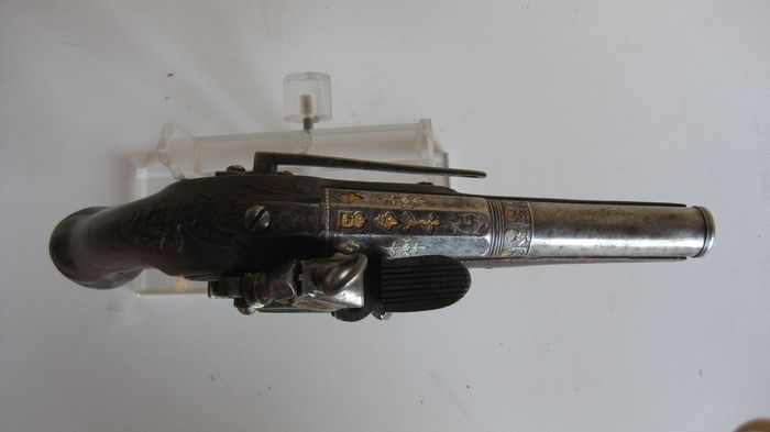

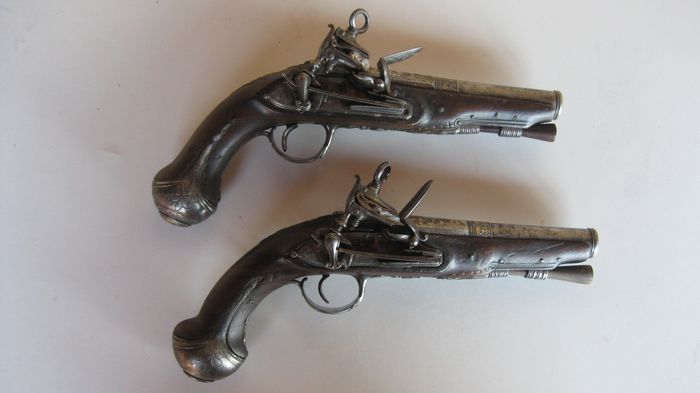

I got my first two muzzle loaders, very interesting pieces, they were sleepers coming from a miniature village at the Leon mountains. Seller says they were always in the family.
I am completely inexperienced with these. They are in good condition, but unattended for 100 years.
There is rust under the barrels, but I do not know how to dismantle them at the front. After removing the tang screw nothing moves. There shall be a retainer somewhere. Lock was easy though.
Plan is, for steel, mineral oil for the active rust with a touch of 000 steel wool and then renaissance wax. For the wood linseed oil, and then bee wax plus carnauba wax in turpentine.

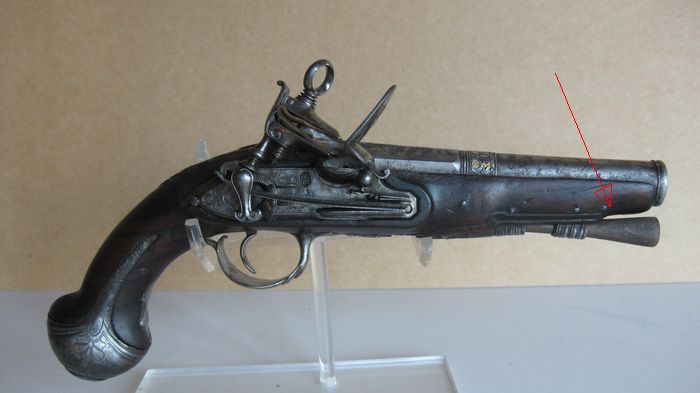

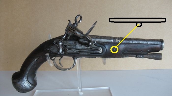

Get out this pin and you can remove the barrel easily!

Originally Posted by midelburgo View Post
...There is rust under the barrels, but I do not know how to dismantle them at the front. After removing the tang screw nothing moves. There shall be a retainer somewhere...
That is no easy job; close to impractical. Before barrel fronts were held to forestocks by means of an easily dismountable iron wedge introduced in a steel 'eye' welded to the barrel underside, pins were used for the same purpose. Only that such pins are not easy to extract; you have to push them off by carefully hammering with a rod slightly thinner than the pin hole, not to damage (widen) the wooden orifice. The holding system inside is the same; only that, instead of a rectangular steel hole for the modern tab, such early one, like yours, is round, corresponding to holding pin.

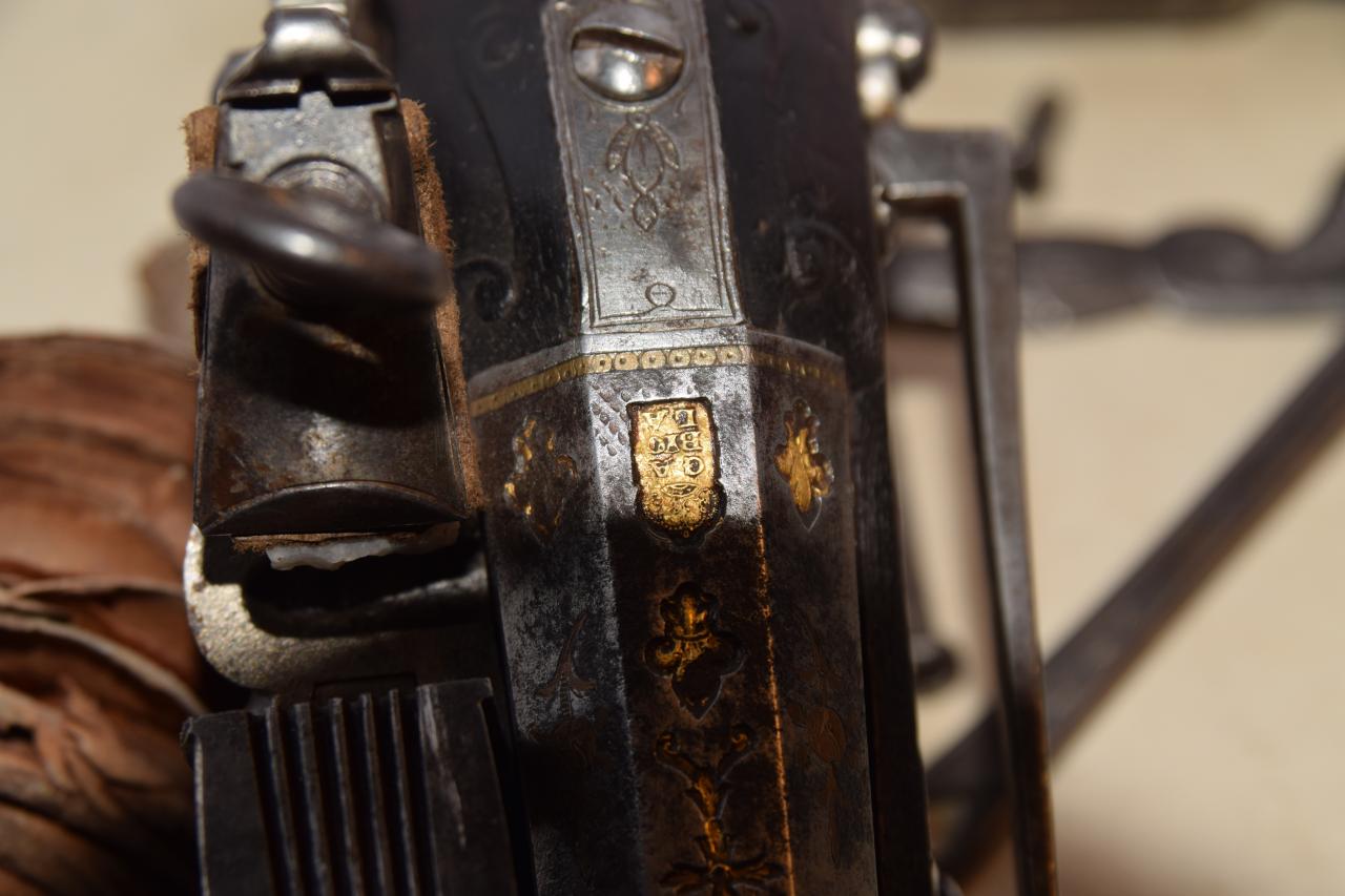

It would be interesting a photograph of the punches in the barrel, to know the manufacturer. The lock is a mikelet "to the three fashions"

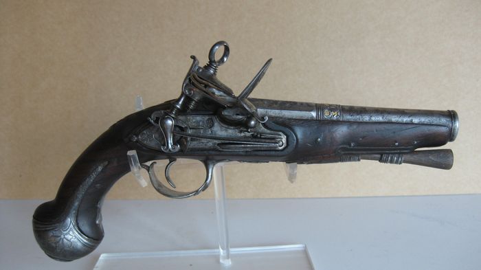

Hello
I notice that the barrel is held by a pair of pins, marked by Corrado and Fernando

So ... we are dealing with two fixation pins instead of one, as usual (per experience ).

I was afraid I would have to deal with those pins. I will attempt on them soon.
As for the marks, each pistol is marked thrice in barrel, lock and guard.
But each by a different maker. A famous one with his mark in "Síntesis Historica" and an unknown one from a known family. I am guessing if a copy was requested or the second is an apprenticeship work. The guns differs at close view, but wood stock and steel are similar.

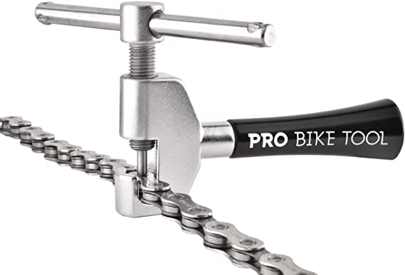

It all sounds like the bicycle tool to remove links from the chain. Just on a larger scale. Maybe it is worthy to build one, from a table clamp or a c-clamp.

The makers are Gabiola (GABYOLA), of which a pistol with very similar decoration is present at Madrid National Arqueological Museum, and Orbea (ORBEA) which family members would become famous from the middle XIX century. I take that Orbea was apprentice to Gabiola (active 1791-1810).

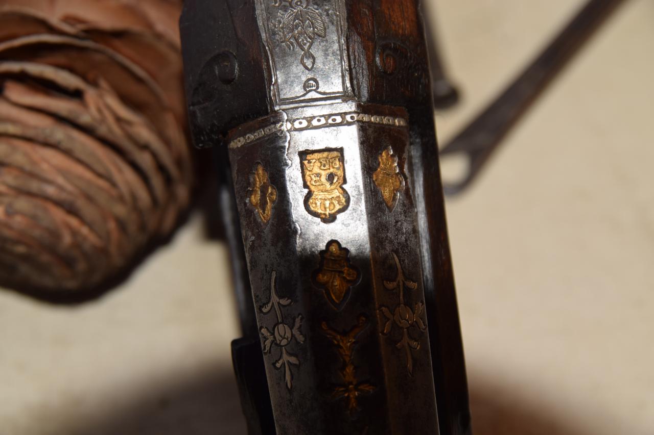

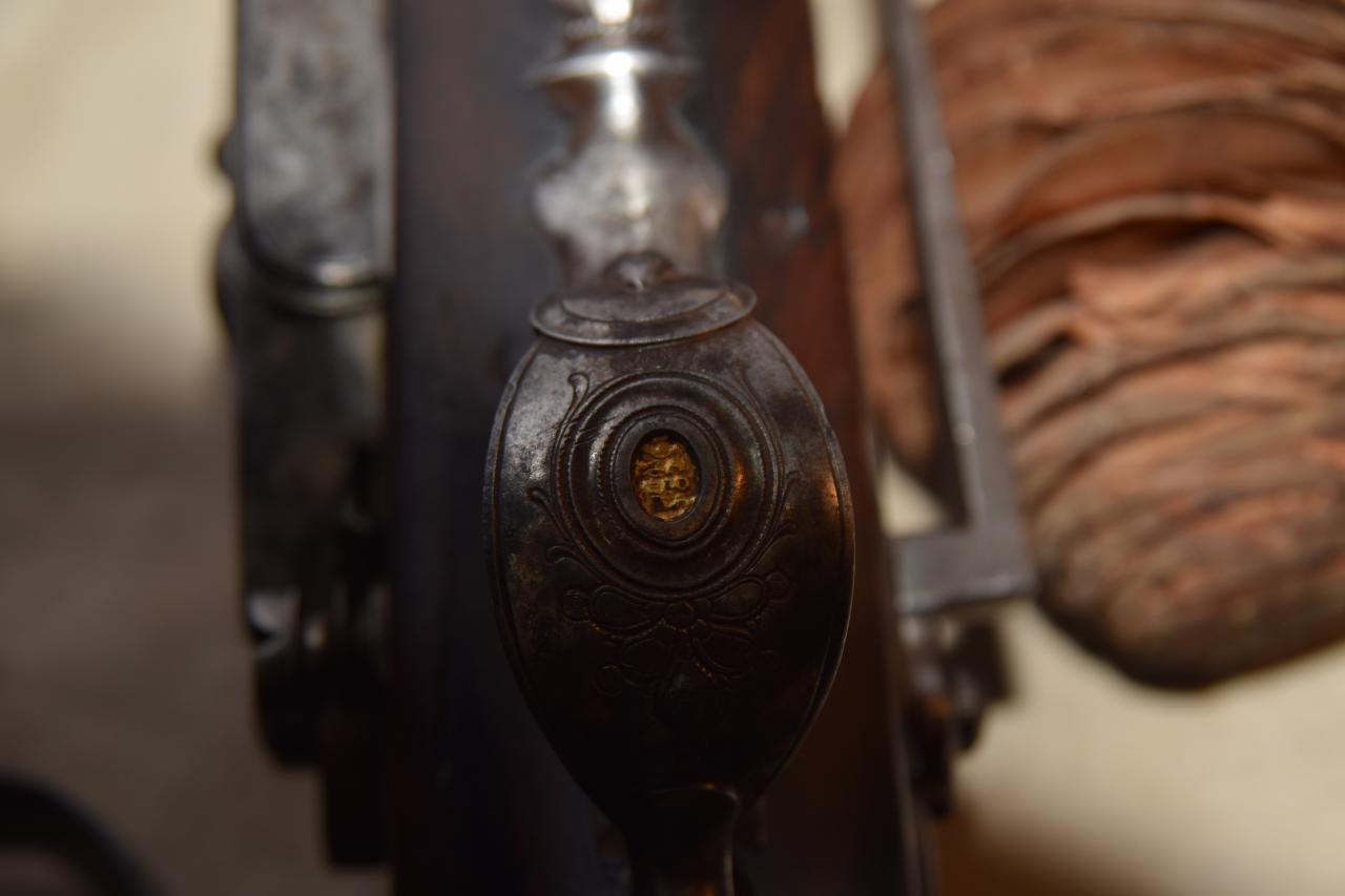

UPDATE. This is for the Orbea pistol.
Both pins came out fine. The barrel resisted still a bit but was dislodged. It has active rust but no seriously bad pitting in about 20%, mostly at the back, under the tang and at the sides. Somebody used badly an unprotected vise. About 80% of the hidden barrel is blued, I suppose all the barrel used to be like that once.
Looking through the barrel it is not charged, but there is something looking like molten tin at the bottom. The firing hole has something like a conus at the inside (?).
I noticed that the Orbea mark at the guard has an extra M, so this is M Orbea. The founders of the company in 1859 were Juan Manuel, Mateo and Casimiro Orbea.
Now the barrel had a first round of mineral oil and 000 steel wool, and I am searching for a brass scratcher. I treated the wood with a piretrin loaded solvent (Prevalien) that was good to remove rust too, and dries in a minute and now it has been covered in linseed oil. Probably I will put everything together back in a couple of weeks.
I made pictures but they are huge and I will have to adapt them to the forum. Surprisingly they go in. I did not use an stative.
