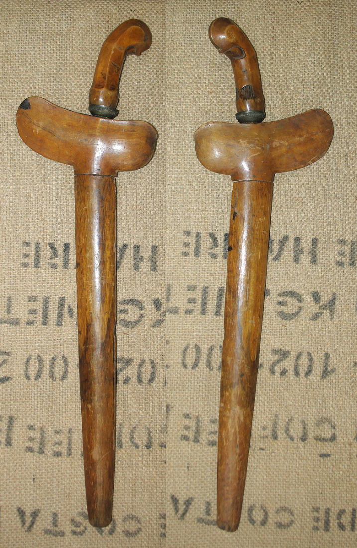

Hello
When I bought this Kriss, I didn't pay attention to the dimensions. So I was very surprised by its size when I received it.
The blade is 45.5 long, the Ganja is 10cm wide and the base of the Pesi is 1.1cm in diameter.
The Selut is in silver alloy.

Well, i'll take a stab at this and suggest the blade is possibly Tuban, if for no other reason than the rather large (for a Javanese keris) size.
The hilt cup is a mismatch though. It is both too large for this hilt and not the correct style. I would recommend replacing it with a proper mendak.

So far I have never seen a mendak or selut with an opening wide enough for a Pesi of 1cm in diameter. I think I'll take a while to find.

This is an interesting keris.
There are several things that strike the eye immediately upon seeing this keris:-
Wilah
the front of the gandhik is slightly concave
the gonjo is inclined to be thin and with only a very slight curve
the tikel alis is the old style that proceeds to the front of the gandhik
the material appears to be coarse and the pamor looks as if it has been "smeared" over the surface; this material would require close examination under magnification before any conclusions could be drawn.
it looks as if there is a rudimentary ada-ada
The slightly concave gandhik front is associated with West Jawa more than any other location, it is fairly common in West Jawa keris and seldom found in Central Jawa & East Jawa
Gonjo
The thin, flat gonjo is a Pajajaran tell, the sirah cecak has been damaged, but if it can be imagined as undamaged a Pajajaran classification could be supported, and the same is true of the buntut urang.
Wrongko
The down turned lip at the front of the atasan is associated with areas west of Tegal, there is a similar style associated with Blambangan, but here it is not as pronounced as in the example under discussion, and the same is true of a similar Balinese style.
Questions
Is the cross section of the body of the blade smoothly curved on its faces, or is there evidence of a slight ridge at its center?
The blade is within length parameters for a Javanese blade, and it is relatively broad, but is this blade also thick? Does it feel heavy or is it light in the hand? Is it lively and easily moved or is it a weight that requires a conscious hand movement? To judge this the keris needs to be held with thumb & index finger pinching the blumbangan and the gonjo resting on the index finger, with the hilt itself only loosely held, the blade more or less supported on the index finger as a fulcrum point.
Is the blade a reasonably good fit to the wrongko , maybe a bit sloppy, but that sloppiness able to be attributed to wear rather than to a poor refit?

I do not see any trace of a central ridge on the blade.
In the middle of the blade the thickness is about 5mm
By manipulating the blade, we feel its weight weighing a little on the wrist.
The wrangka fit is very good. On the other hand the gandar is very damaged, the interior is totally eaten away by worms and very fragile because it is hollow. The black spots that we see on the scabbard are from old repairs where the holes were filled with putty.

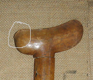

What is the reason for the sloppy & blurred patras, religious reason or just poor craftsmanship?

Old 21st February 2021, 06:08 PM   #16
Hello Jean,
Missing, highly stylized or "empty" patra seem to be an early development and examples are seen in a few of the extant early keris hilts.
In this case, I believe the hilt was not done by a specialized carver (maybe rather done by one of the former owners). The base of the hilt appears to have seen some wear or intentional thinning out (already a good while ago) - this may have contributed to the uneven lines teathering out towards the base.
