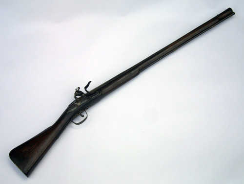

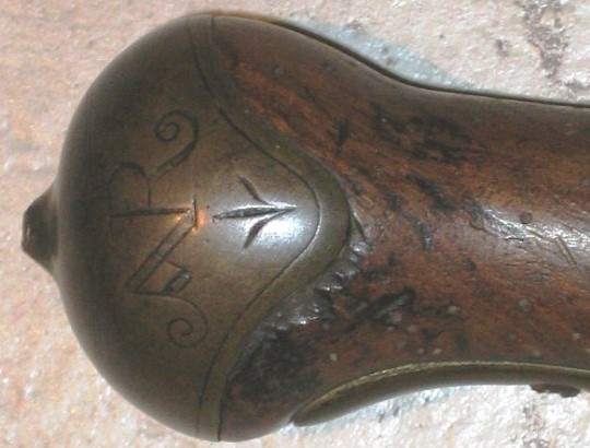

Old 4th February 2021, 04:31 PM   #2

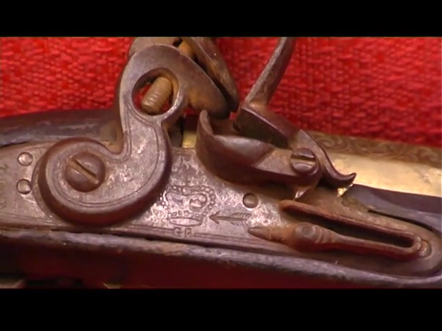

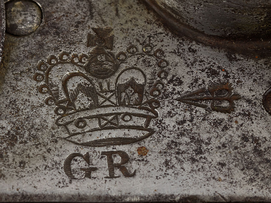

David, i risk talking nonsense but, a version of the broad arrow, one under a crown, appears in guns dated 1800 ... and even earlier .
Lots of New Land Pattern pistols with it may bee seen out there ... mine included.
Others with deeper knowledge will tell you better.

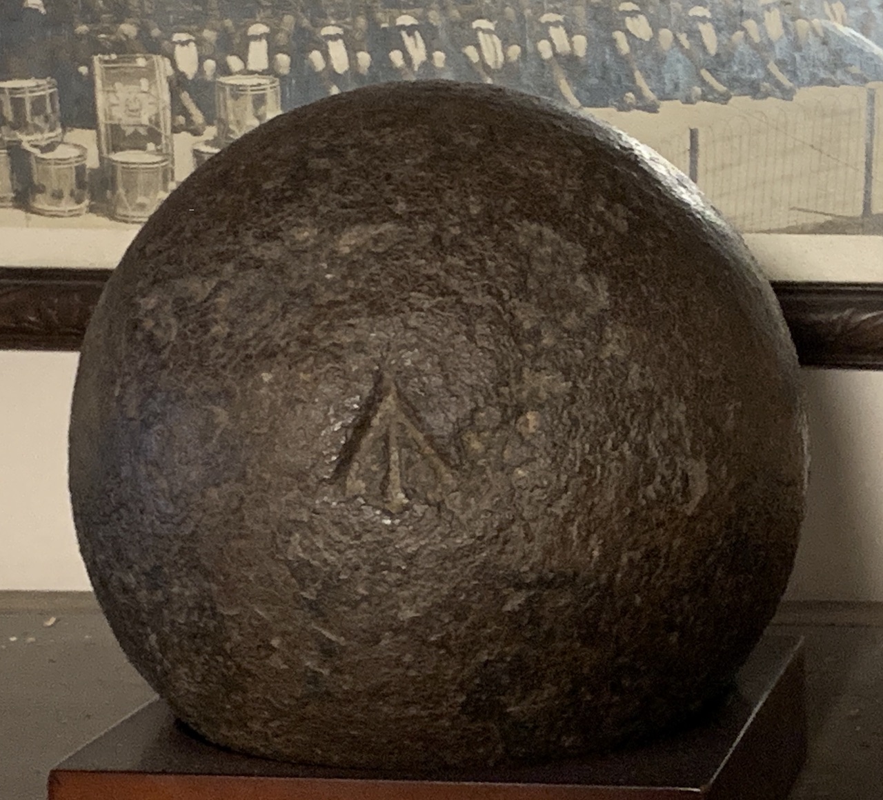

Broad arrow was also used on British cannon ball pre 1800, I'd like to think so the enemy knew who was shooting at them!
This ball dates to be fired in 1760 at Isle aux Noix fort near Montreal.

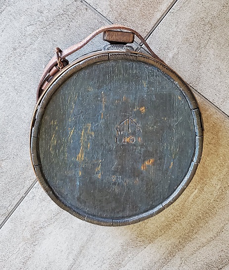

Attached is a post 1855 wooden canteen with the WD instead of BO accompanying the broad arrow.

It would seem that the locks of guns were marked with the crowned broad arrow as early as 1731, probably earlier, from these examples;
#97, Long Land pattern musket , crowned arrow, date 1731
#98 cavalry pistol date 1744 crowned broad arrow
#99 cavalry carbine c.1770 crowned broad arrow

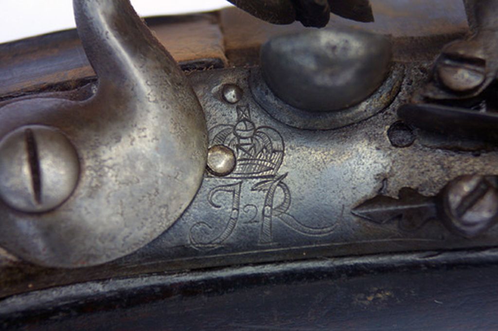

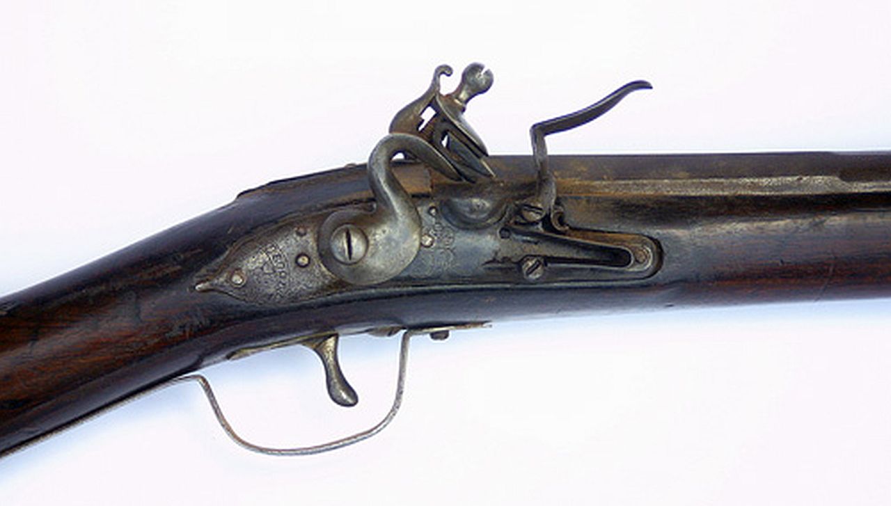

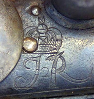

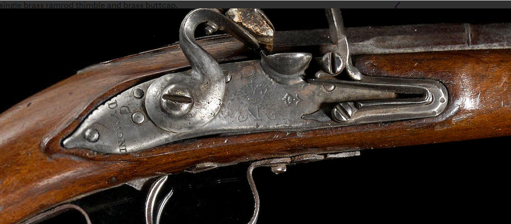

Here are fotos aof a carbine made during the reign of James II. which has no broad arrow, so its introduction must have been later.

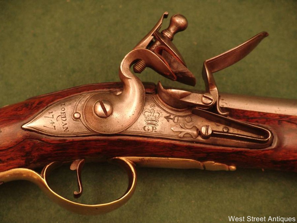

Posts: 1,268

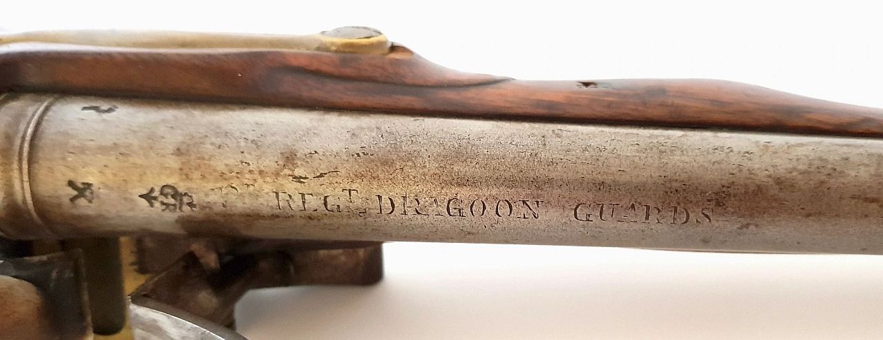

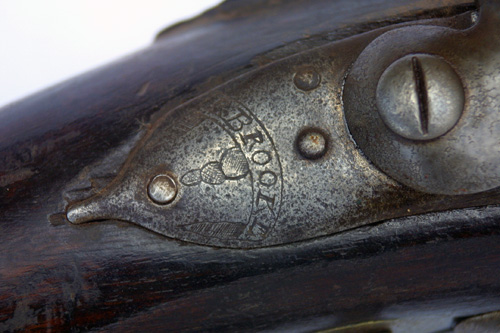

.........and here a pistol of 1747 with the boad arrow
Old 4th February 2021, 06:14 PM   #7
corrado26
corrado26's Avatar
Join Date: Dec 2014
Posts: 1,268
.........and here a pistol of 1747 with the boad arrow and a pistol of Dragoon Guards 1738 with the arrow on its barrel

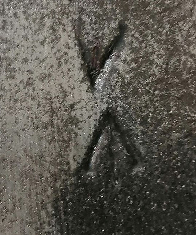

As for this mark having been used since early times as a symbol of the King's property, the most bizarre things are found with such mark; meaning that, finding it in plausible property like canteens, is nothing comparing to bizarre items like screws .
Old 4th February 2021, 07:06 PM   #9
Posts: 10,860
Originally Posted by fernando
Yes Jim; that is the original question indeed . Udo is coming close, so it appears .
Wow Fernando! now that is bizarre, a screw??? But then I guess in those days, these were not as common as going to the hardware store buying them by the box.
Given the civil unrest of these times, it seems likely that the Board of Ordnance may not have been involved in the issue of this gun, thus that stamp of broad arrow while prevailing earlier on gun components might not be present.

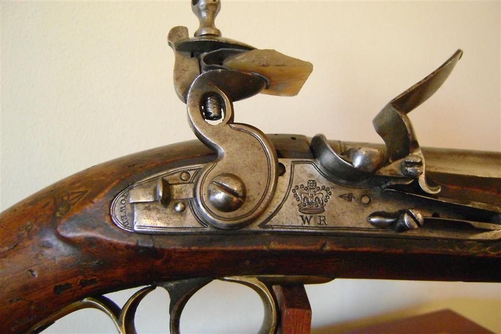

Does anyone know when the broad arrow was first used on weapons to signify government ownership?
During the reign of of Queen Anne, the Rose and Crown mark was replaced by the Crown and Crossed Sceptres mark, and the Royal Cypher had a broad arrow added underneath. (Ref H.L. Blackmore, "British Military Firearms 1650-1850". p265.) So it seems accepted that the arrow appears of firearms from the very early 1700's. In "The Brown Bess" by Goldstein & Mowbray they depict a style of early crowned arrow stamp used from from 1706-11.
I have a heavily restored musket of King William's reign, it has a no arrows at all and a paper written by David Williams "The Flintlock Ordnance Muskets of William III and their Supply" includes a description of their markings (ten muskets were used for his study) and there is no mention of an arrow used to lock, stock or barrel. King William III died in 1702 & his wife Ann became queen, this supports the evidence that the arrow appears, on firearms, during Queen Ann's reign.

"...the BROAD ARROW mark now making its appearance on ordnance stores was a Government mark which can be traced back to the 14th c. , when in 1386, a certain Thomas Stokes was condemned to the pillory for pretending to be a Kings officer and marking some barrels of ale with the 'AREWHEDE' mark. Although the Broad arrow mark s mentioned in the 1699 notice it does not seem to have been generally introduced until the reign of Queen Anne. Throughout the reigns of Charles II, James II and William III, the two government marks stamped on gun barrels were the rose and crown mark and the Royal Cypher. On the locks the Royal cypher was engraved in the middle, with the name of the maker across the tail".
Howard L. Blackmore, 1962, p.262
The reference to the 1699 notice refers to a notice in the London Gazette, Feb. 1699 drawing attention to an act of Parliament against the embezzlement of stores: "...the marks on his Majesty's arms...which are, the Kings cypher in the reign in which they were made and the rose and crown on the barrels, and SOMETIMES THE BROAD ARROW........".
It would seem that beyond these provisions for marking of the locks and barrels of firearms, it was the STOCK that was marked with the broad arrow and BO. ...according to plates in Blackmore.
Excellent entry Adrian!!! We crossed posts

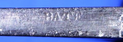

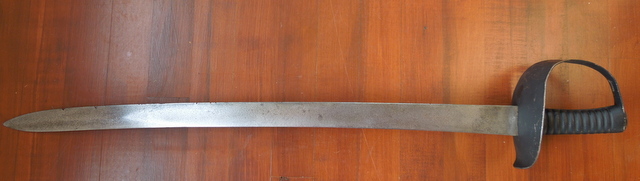

Just my 1804 spectacle cutlass it has the broad arrow halfway down the blade as it's only mark, and a reverse arrow almost touching the two points together as it's only marks. (this indicates it was sold out of service as surplus. that is, Govt. ownership cancelled).

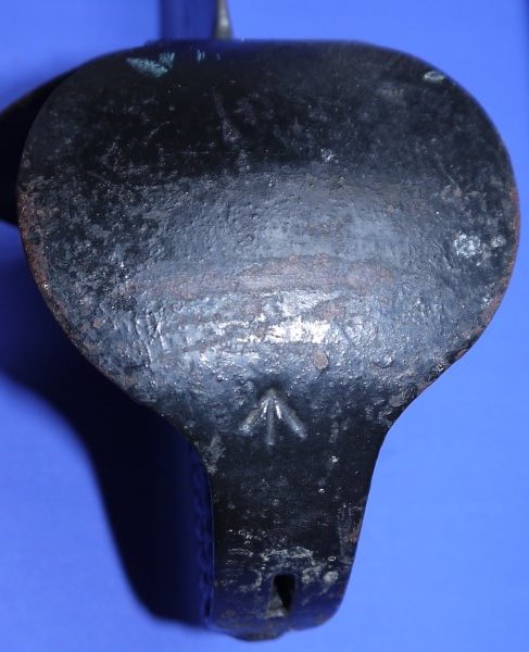

Here is another 1804 pattern cutlass marked with the broad arrow. Assuming that this pattern has only ceased being made circa 1845 (?), in this case the example shown has its actual production date limited to prior to 1807 as its blade spine is signed by BATE, who became Reddell & Bate during 1806.

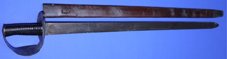

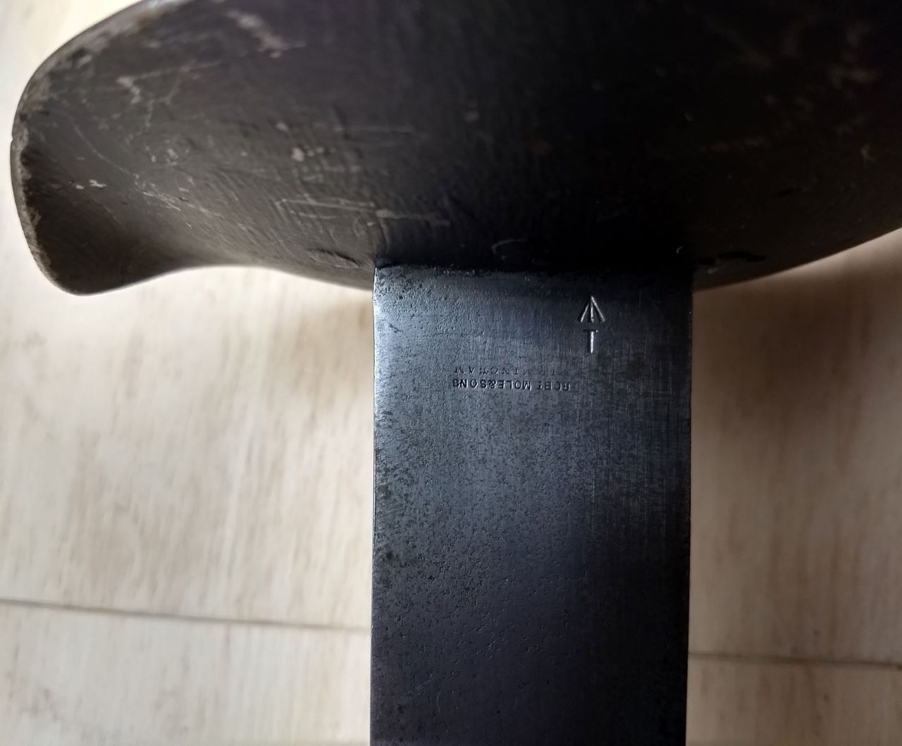

The arrow started appearing on cutlasses around the middle of the 19th century, both with BO and the later WD marks. Wayne - I can't explain the arrow on your 1804 unless both were applied at the same time when it was taken out of service.
Scinde thanks for the info on the E. I. Co and I attach a picture of a Mole cutlass with the I for India mark. I guess that dates it to around the 1855.
