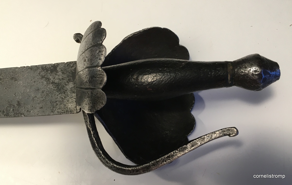

This voc cutlass was in my collection nevertheless I sold it.
at that time I drew a clear boundary at 1600.
for rare weapons I'd like to make an exception.
Now happy it found its way back to my collection
I'm looking for images of original voc cutlasses, so no reproduction pictures.
are there members who have some and can post it here ?
thanks + regards
Jasper

A great topic Jasper!
These VOC markings have always intrigued me, and finding these hangers/cutlasses intact seems a challenge as so many of these blades found their way into all manner of ethnographic weapons in the 'East Indies'.
This sword you have is one of the 'classic' examples I have only seen photos of, WOW!
I am curious on the year marking invariably placed on these blades below the VOC and chamber (there were 6) letter mark. As with yours the 'A' is of course for Amsterdam, with others being Middelburg; Hoorn; Enkhuizen; Delft and Rotterdam (the R below the VOC rather than above).
I am wondering just when the VOC started this convention of year marking and why. Also, is it true that these blades were almost invariably produced in Solingen and assembled in Koln for the VOC?
Rather than being issued to sailors and troops, I have understood these were made available for purchase.
I have seen one identical to yours with blade date 1794, the latest date I have seen...the company technically dissolved 1799 I believe.
Just reviewing notes and would be grateful for your insight re: these swords.
I join you in hoping others out there will share their VOC swords and perhaps the various remountings of these blades.

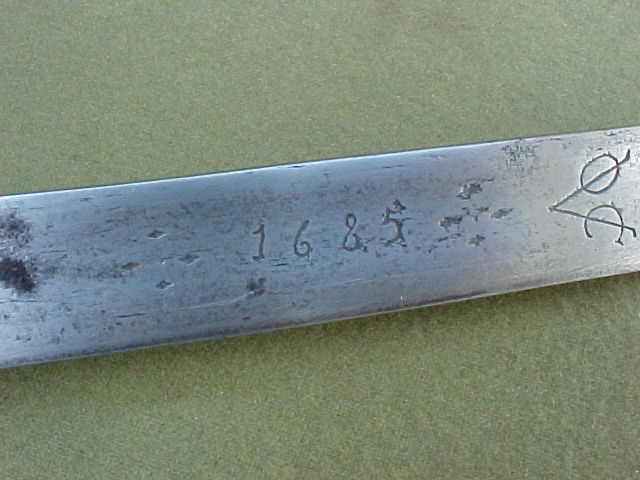

Amsterdam VOC 1685 and two ex Visser collection

Thanks Jasper,
The 1685 is by far the earliest year I have seen on these.
It seems the most predominant is the majuscule A with the drop down V center bar, and it seems the most structured letter. The character and strength of the VOC seems to vary from thinly scribed to heavy with sometimes somewhat irregular lines. .
Naturally this is Amsterdam, by far the major center and chamber, and I always wonder why the usual city stamp marks used on other blades does not occur. Is this because the company was outside the auspices of the usual guild or local controls ?
Also,the other chamber letters seem typically irregular, and not with the structured character of the Amsterdam A. I have understood the R for Rotterdam is situated below the VOC device rather than over as in the other letter markings.
I had heard also of a 'Z' marking for Zeeland, anything to that?
Great examples!!! Thank you, I am very envious of these amazing examples!

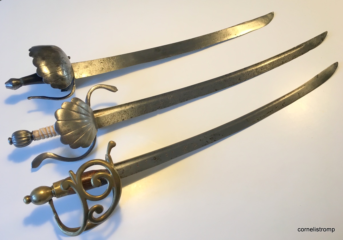

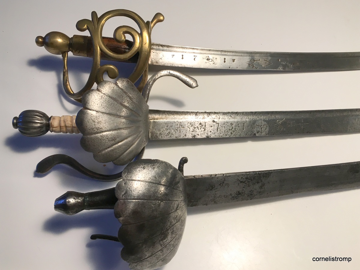

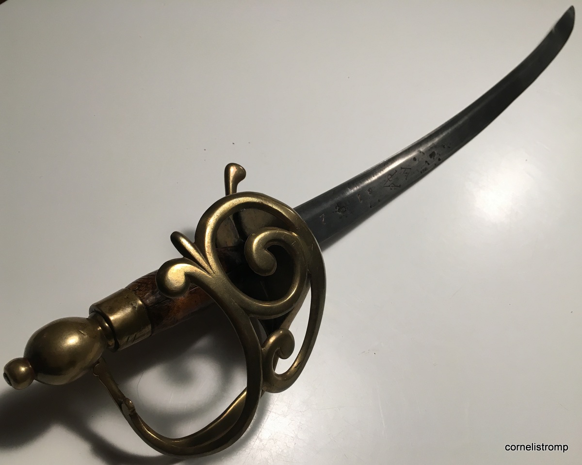

Dutch naval cutlasses in my collection.
1. Admiralty of Amsterdam
2. VOC Hoorn dated 1731
3. VOC Amsterdam dated 1761 post #1
I will later post some more pictures
best,
Jasper

Hello Jasper,
those cutlasses are really great!
Looking forward to see some additional pics of the stamps in the blade.
Thank you for sharing,

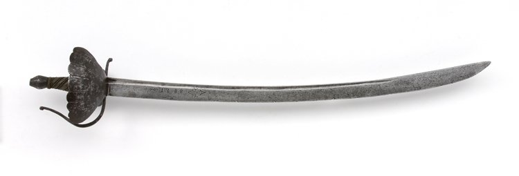

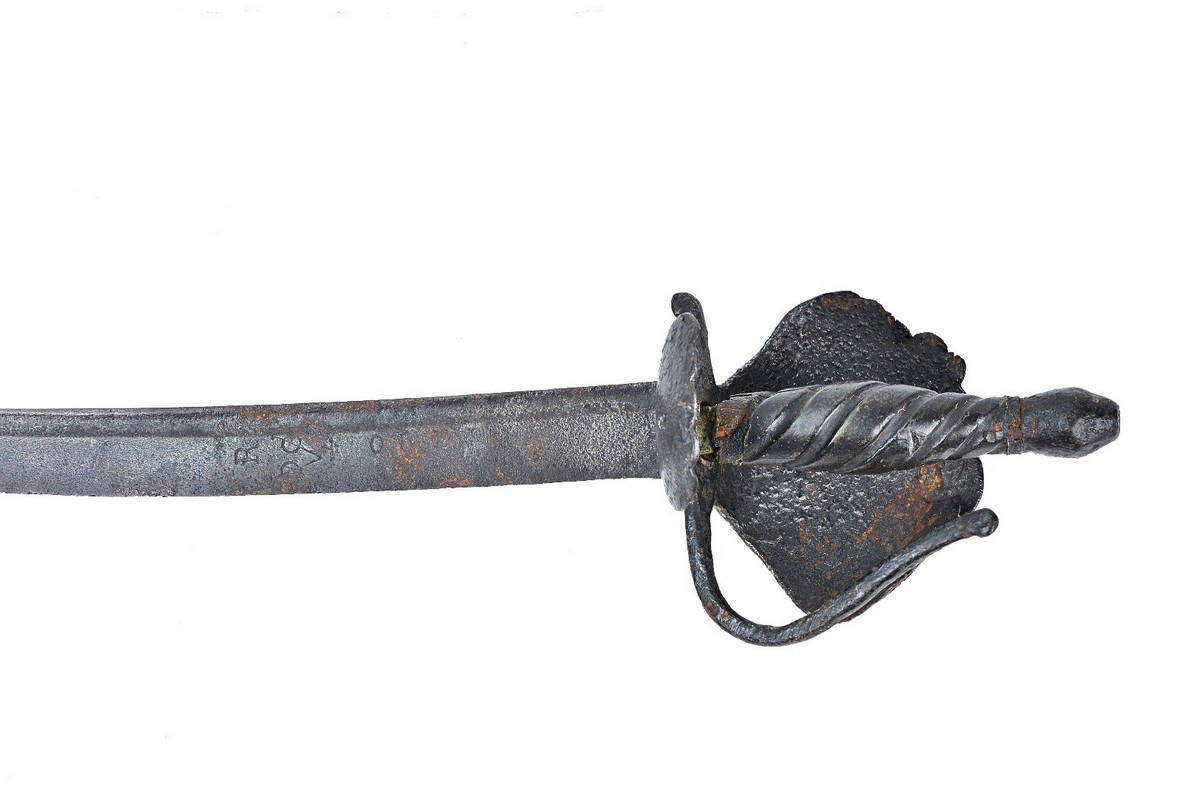

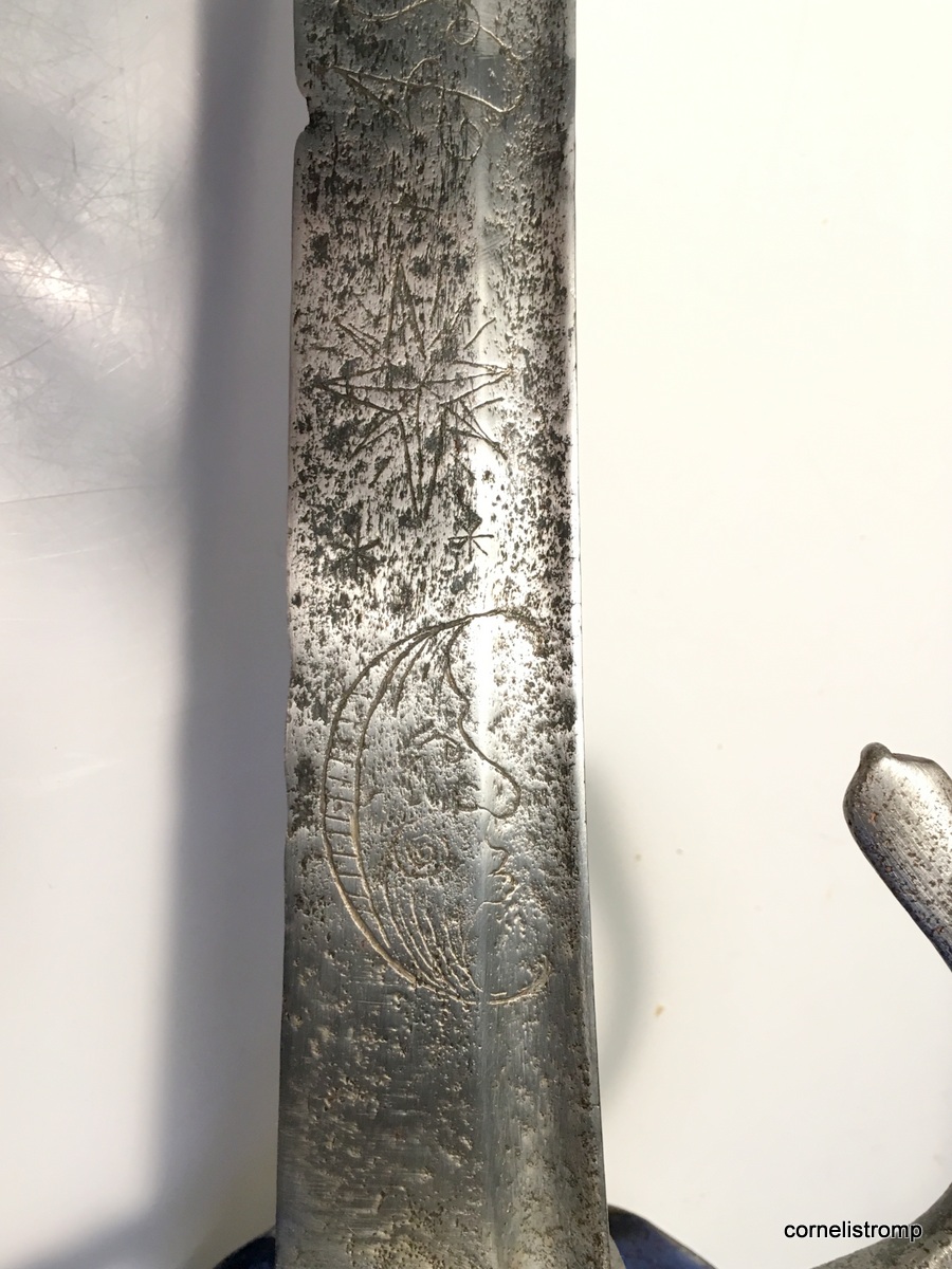

national military museum # 019069 , a houwer dated 1788 Amsterdam same hilt type as the AA one, depicted above .

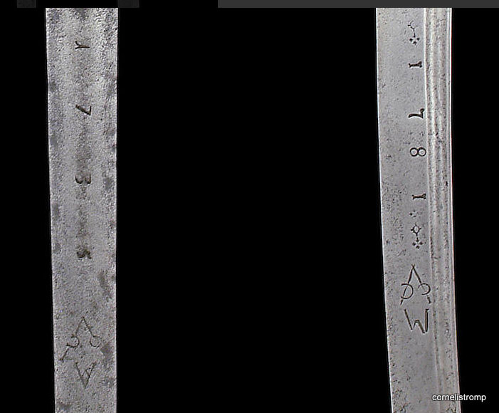

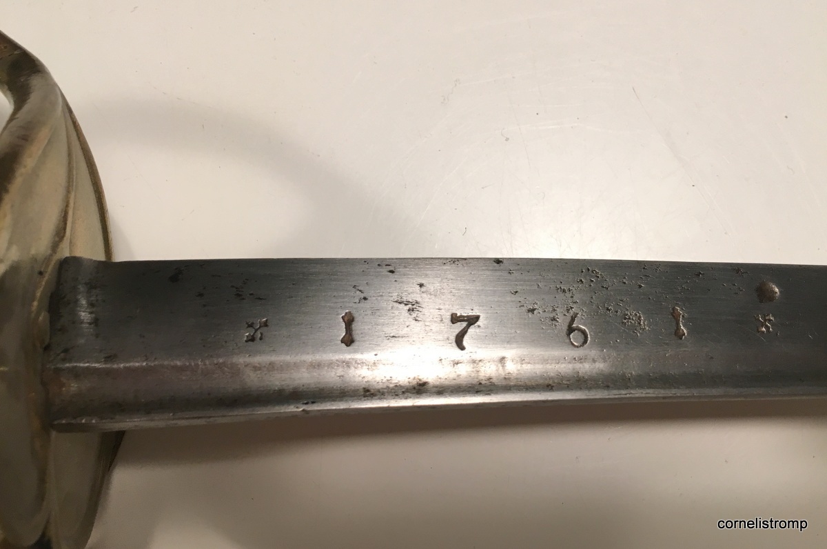

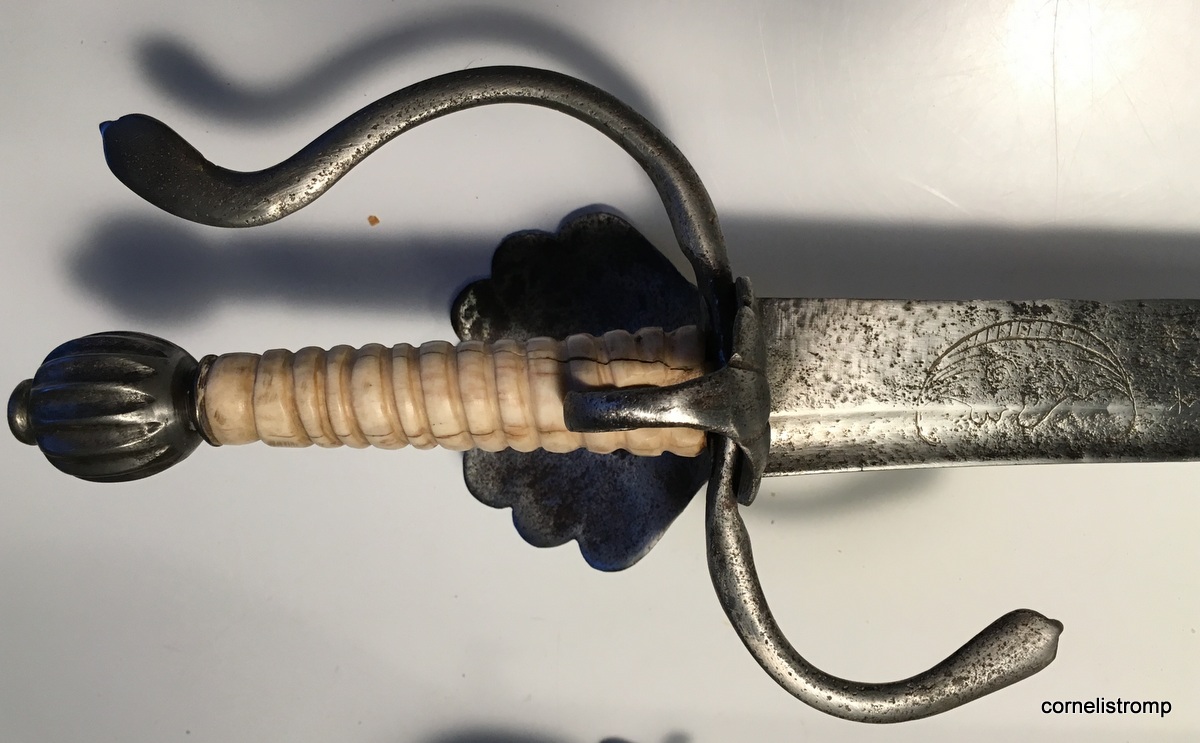

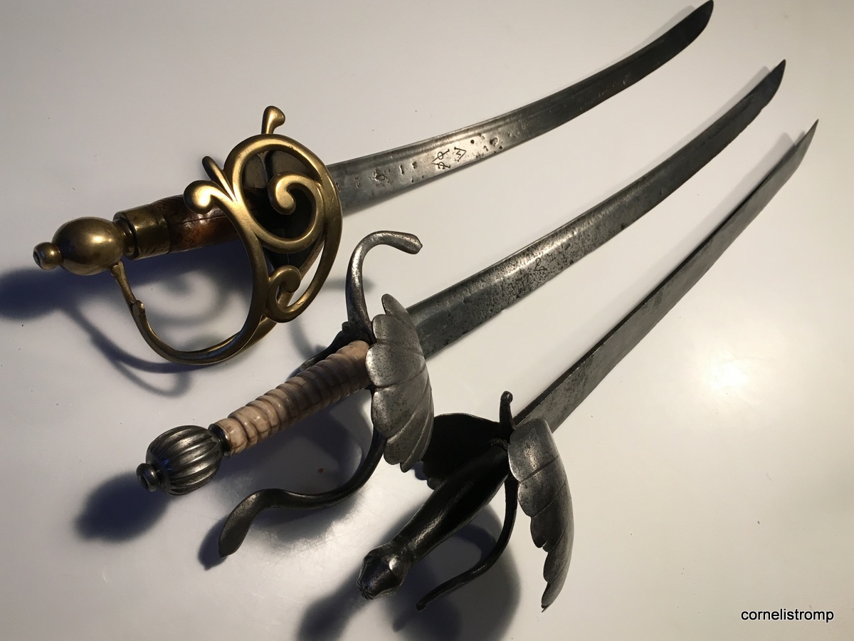

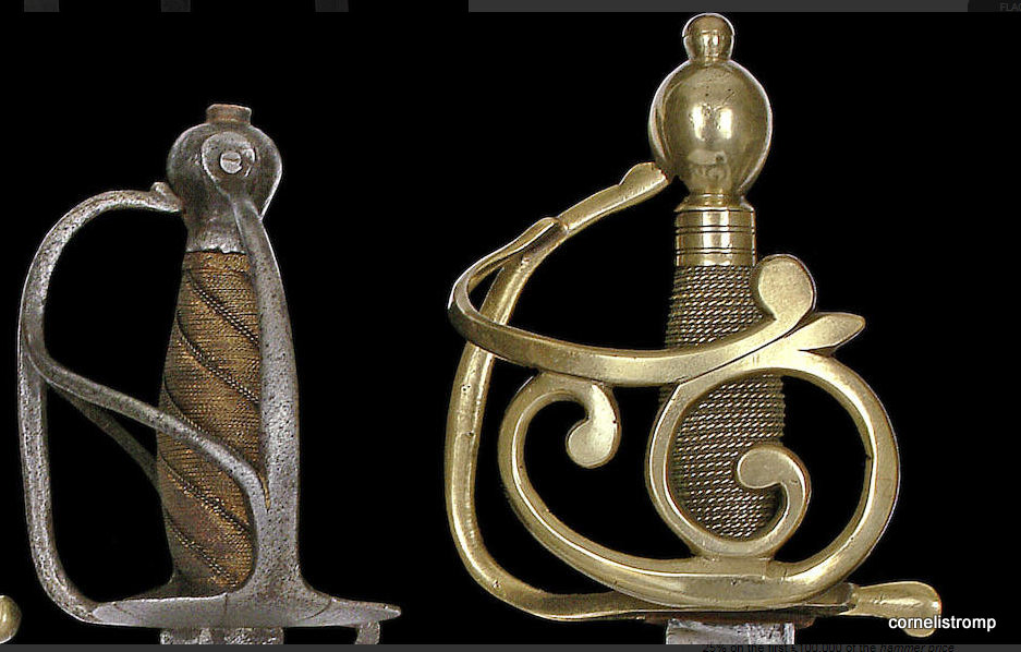

some more pictures
Old 29th January 2017, 07:47 PM   #14
Posts: 10,862
Superb examples Jasper!! Thank you!

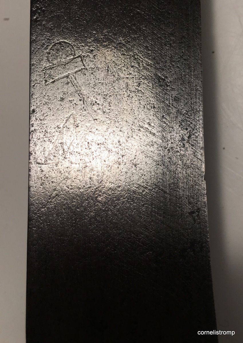

On the one shellguard hanger, there are a number of chop marks on the back of the blade near the hilt. It seems this type line chops occur on a number of ethnographic sword blades in the same manner (it seems dha in SE Asia and others). Have you come across any notations on this feature?
Also, it is interesting to see the variation of application of the dates and devices used, some in script, some stamped. The astral man in the moon aligns with of course these devices used on Solingen blades with talismanic/magic symbolism.

Hi Jim,

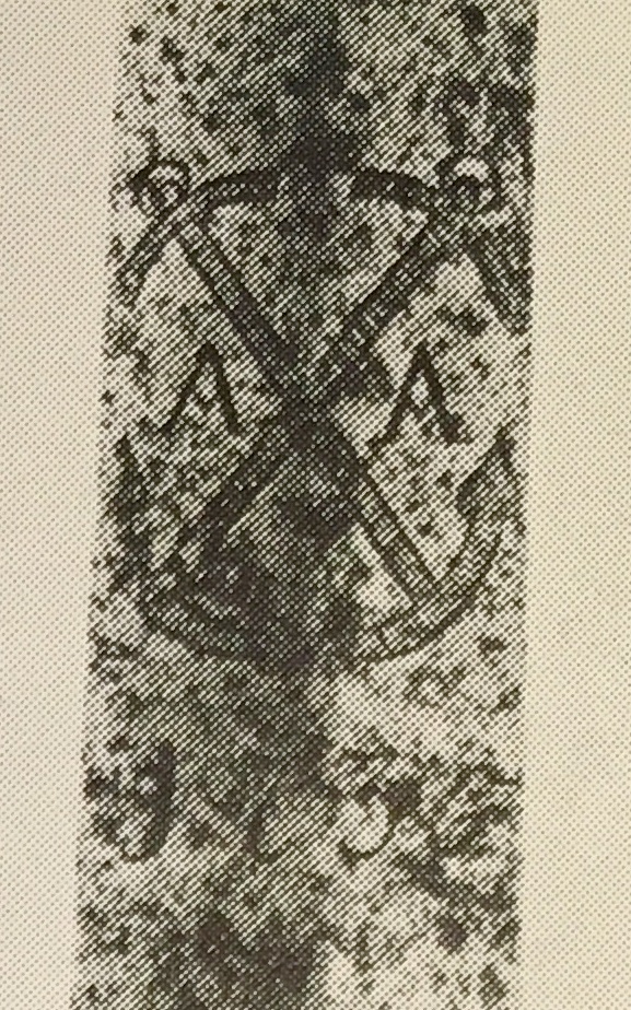

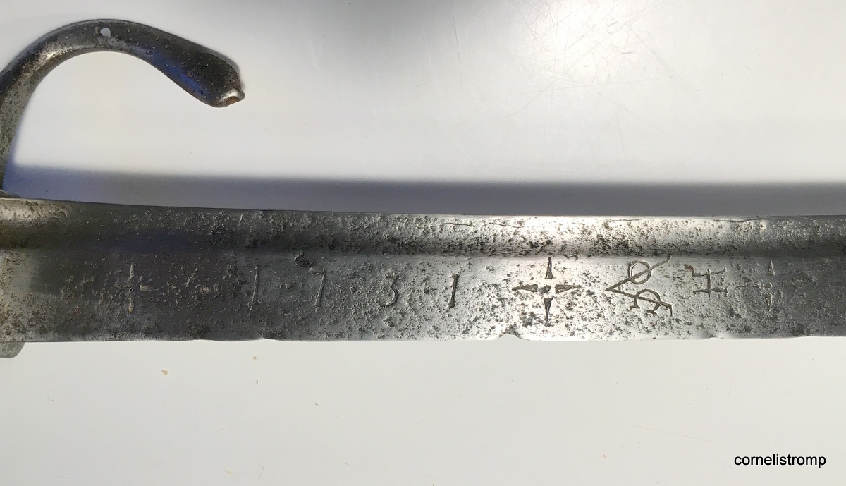

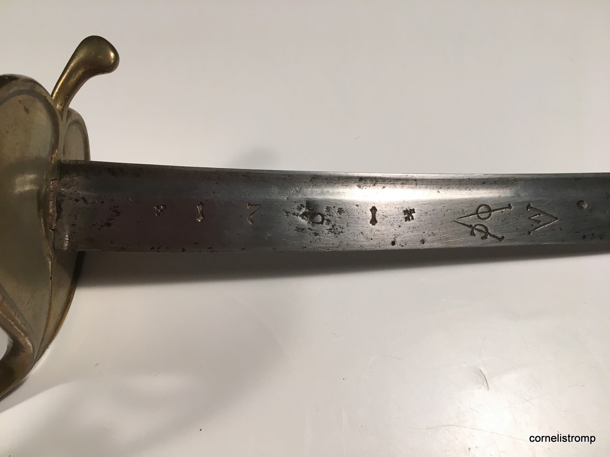

yes I noticed the lines on the back of the hilt, I have no idea why this is done.There are on this blade remains of crossed anchors with a double A
of the admiralty of Amsterdam.
Below a date, unfortunately only the one and the six are legible.see picture , for another AA example of the a similar etching.
it looks as though the date is engraved on early houwers before +-1740 and stamped on the later examples.
best,

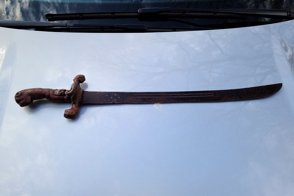

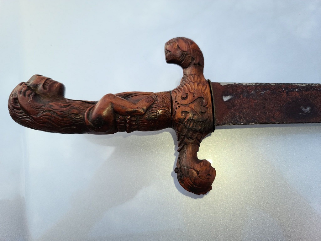

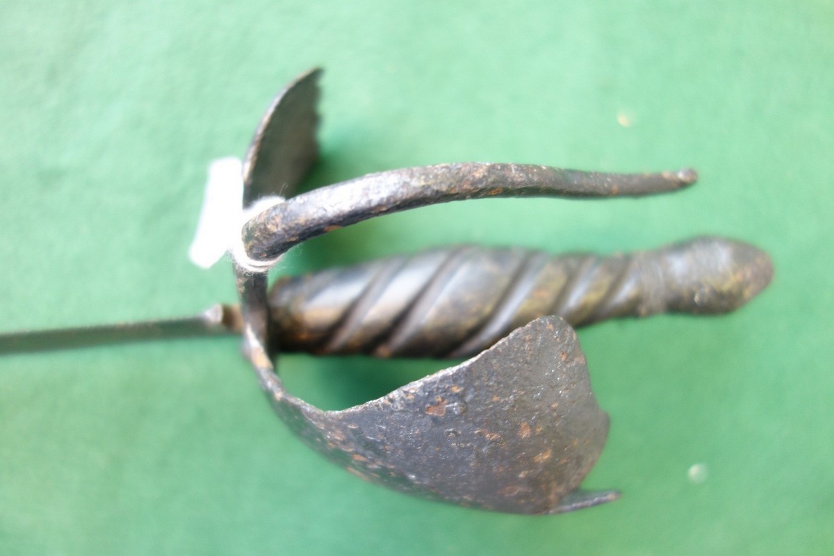

Default Dutch East India Trading Company (VOC) cutlass dated 1790

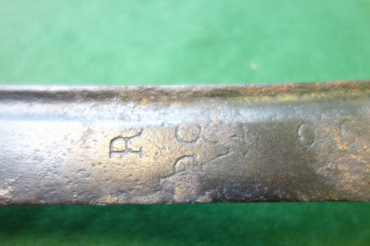

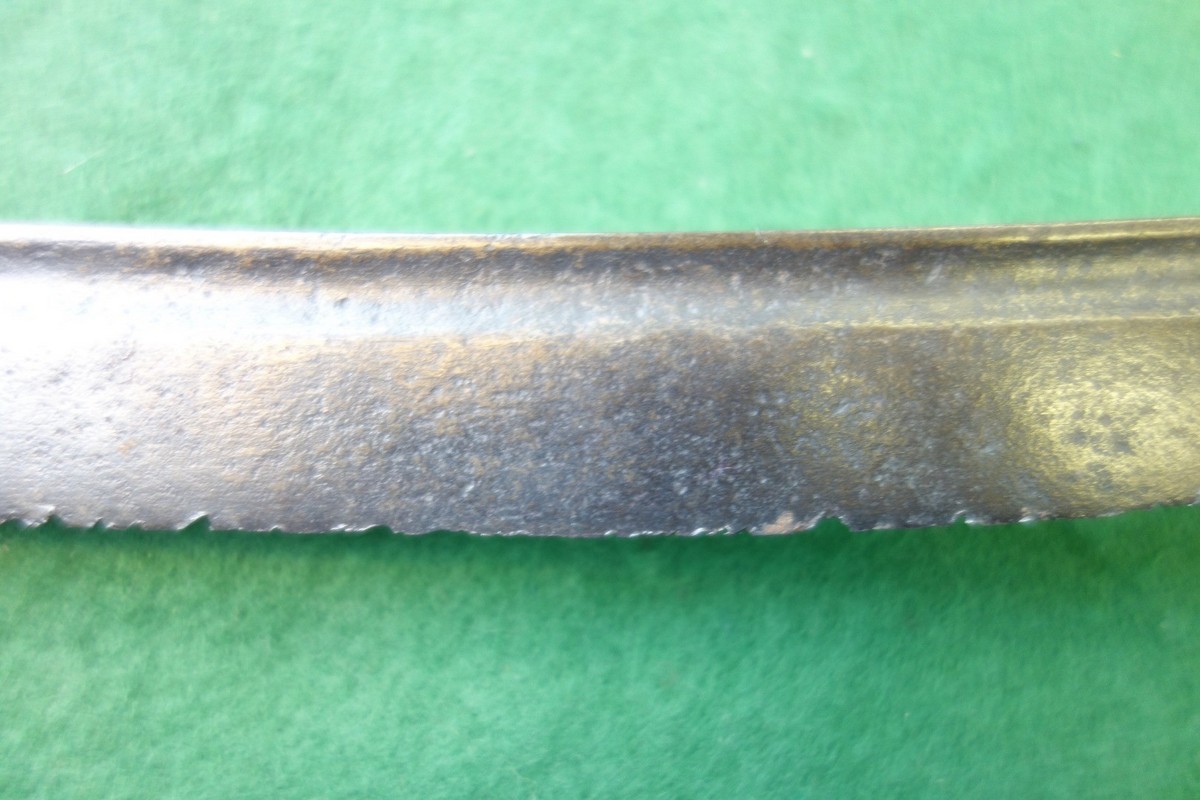

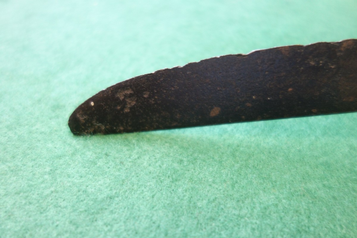

this voc cutlass was once shortly in my collection approx 20 years ago,
an rare original piece but unfortunately in a highly excevated condition.

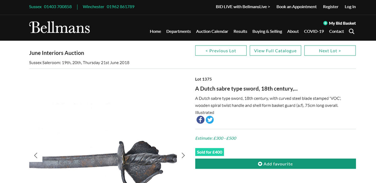

The blade is dated 1790 and marked with an R for the VOC chamber of the city Rotterdam, The VOC Chamber of Rotterdam was one of the six Chambers of the Dutch East India Company.
The cutlass is recently auctioned in 2018 at Bellmanns for 400GBP.
After offered to me with forged provenance!?! probably to boost or justify the new price of 6 times the auction value.
When I carefully informed the person the real provenance, in this particular case known to me, he felt caught and not amused.
best,

Wow, Jasper! I had forgotten about all of your truly remarkable hangers/cutlasses! Would absolutely love to have one of these types someday. Here is a hanger you helped me identify a number of years ago. Although not provenanced to VOC specifically, you did indicate that it was probably affiliated due to the hilt being the standing lion and the cruciform marking on the blade being found on Dutch coins of the era.
Old 22nd January 2021, 05:32 AM   #19
M ELEY
Location: NC, U.S.A.

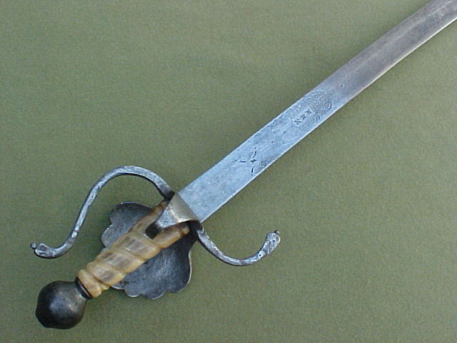

Posts: 2,229

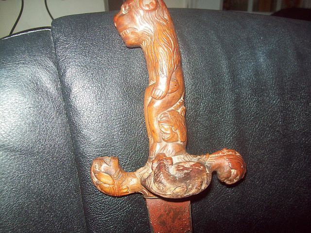

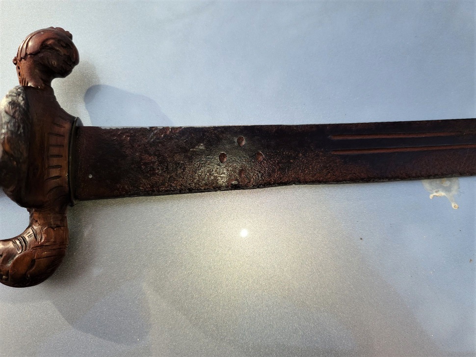

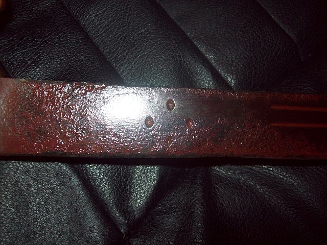

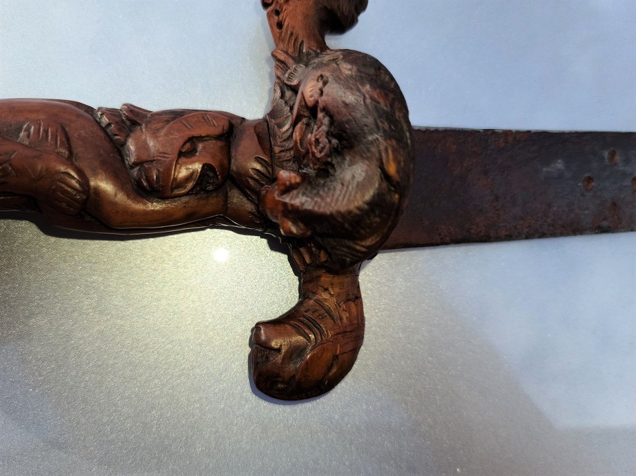

Last two...always wondered what the carved symbol on the hilt represented (S-shaped backing each other with wings?). If this hanger distracts from the topic at hand, let me know and I'll remove it!
Old 24th January 2021, 12:25 AM   #20
Posts: 10,862
Capn, I recall this amazing sword from our discussions here in 2010, and while we did not resolve any definite explanations, there were some great possibilities.
What we know is that the designs and theme are sort of an amalgam of Sinhalese style, the Hindu goddess Lakshmi and themes with hunting dogs. Swords with these style hilts were known in Dutch context mid 17th c. in what was known as the 'leeuwengevesten' (=lionhead) theme. Similar style hilts seen in painting by Rotius (in "Some Facts Concerning Sword Hilts at Hoorn Around the Year 1650", van der Sloot and Kist, c. 1970).
It is thought this type hilt was perhaps crafted by an artisan in one of the Dutch ports in colonial regions of the Dutch East Indies. This may have been in response to the carved ivory hilts made by Ceylonese craftsmen for Dutch merchants and officials in the 17th c.
The blade is most interesting and distinctly a cutlass type blade, in the genre of the hangers we know so well. Most interesting is the 'four dot' device. While I have searched many years for a defined answer to the significance of this, it may well simply have a sort of talismanic meaning of good luck, as with the four leaf clover.
I have thought of possibility with the quatrefoil, often seen in Christian architecture etc. and while the cross comes to mind, the Four Gospels also are noted.
It is interesting that these four dots occur regularly on the quillon terminal disc of Dutch walloons. As we found, they are seen in the 'dump' (small change) coins of Ceylon and other colonial contexts.
In reading (passim) it seems there was mention that Johannes Kirschbaum of Solingen bought the 'kleebat' mark 20 Oct 1660. But this was a three petal cloverleaf apparently, and not this 'four'. But, who did he buy it from, and did not find a cloverleaf mark in his markings.

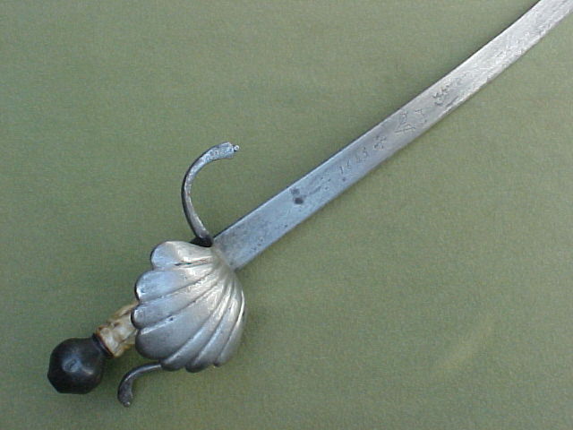

best,
Jasper
Quite similar pieces are dated to the early 17th century (e.g. http://www.vikingsword.com/vb/showthread.php?t=22245 see #8)
Was this style / model in use for such a long time?
Best regards
