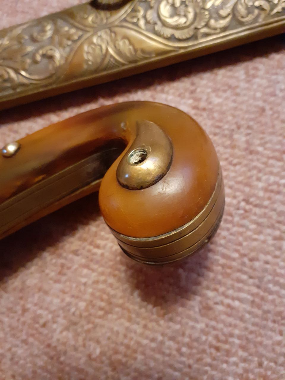

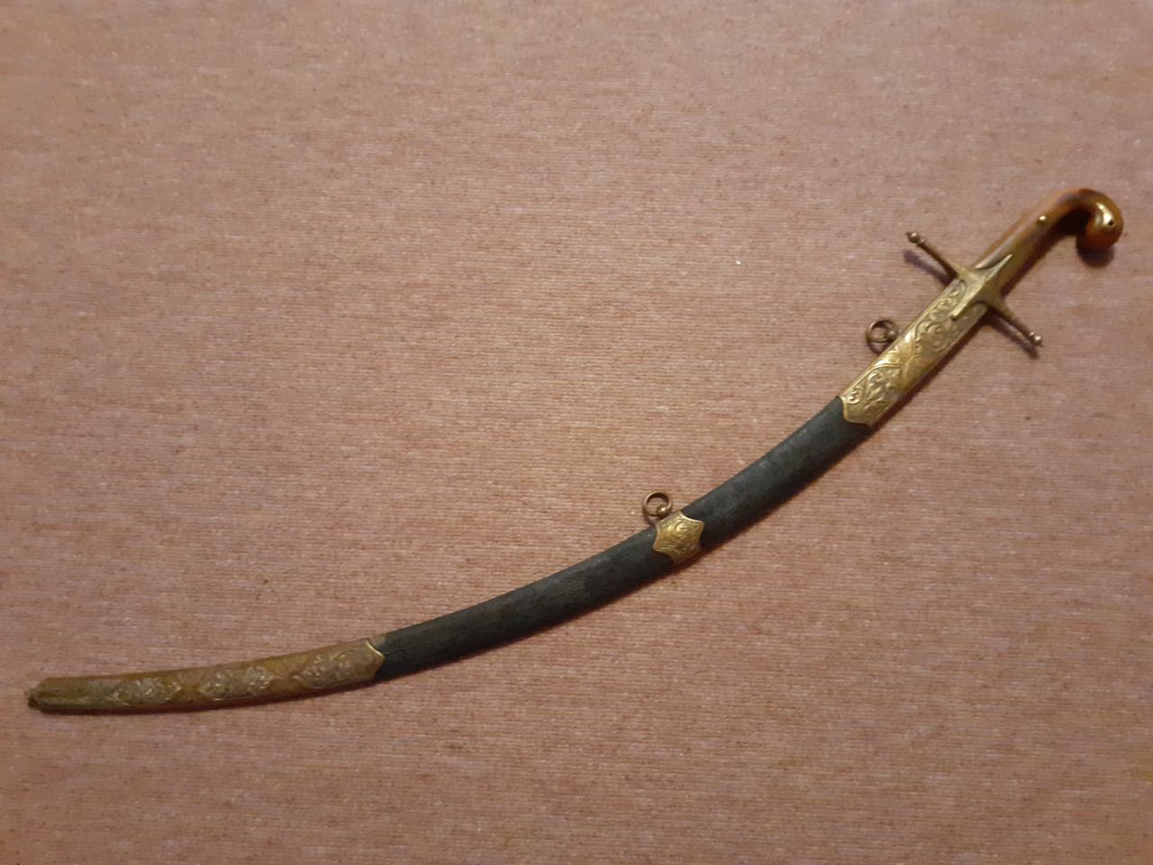

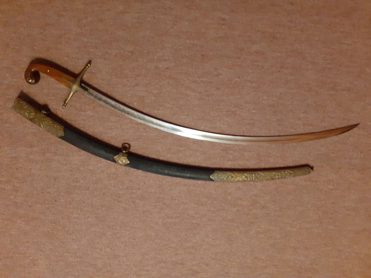

Hello dear members,
I wanted to show you this french ? saber-sword,
The blade was trapped in the scabbard ( lot of rust...)
but I finally got it !
I don't think it's an old napoleonic mamluke style sword but not just a recent copy or a good quality one:

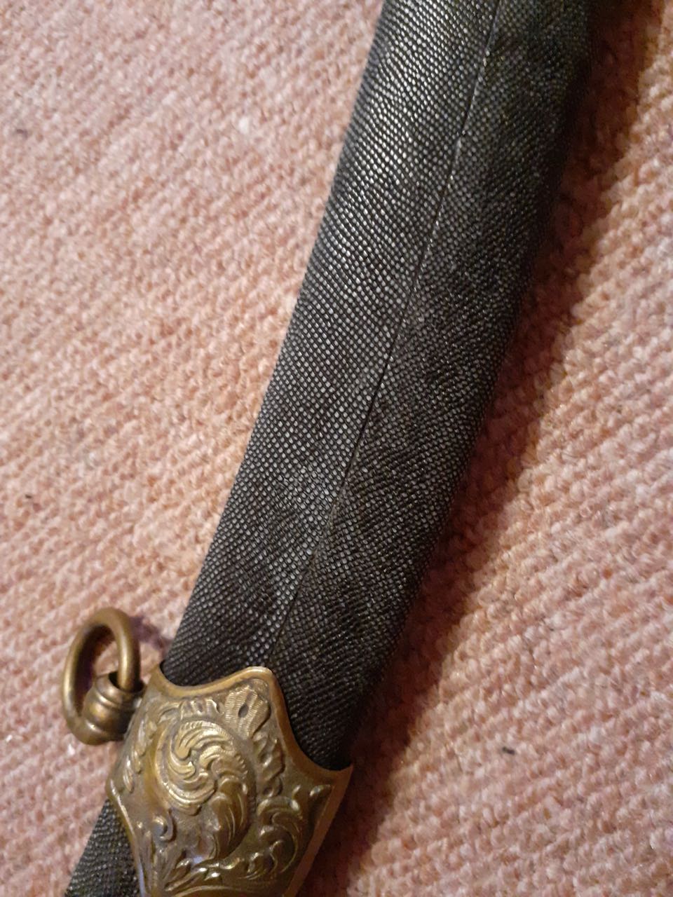

At first sight: fake shagreen covered scabbard and brass/bronze mounts that seems too well preserved make me think of a recent copy,

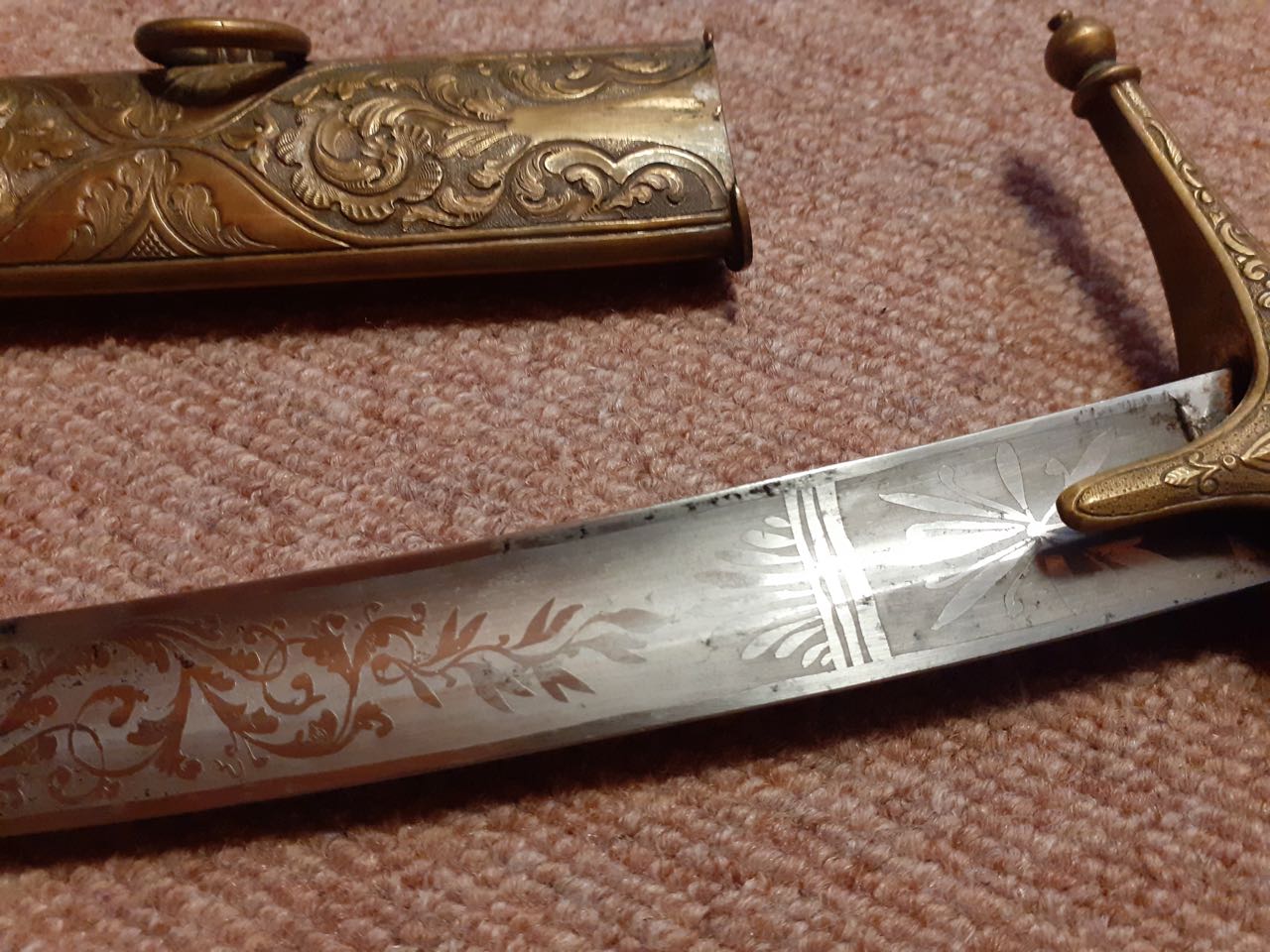

the chromed blade too seems weird...
On the other side, the chromed blade is thick but really flexible, seems made of good steel
and the hilt, has nice blond horn grips.
Too much for just a repro !?!
Or was it usual in the early 20th century to make good copy for orientalists fans ?

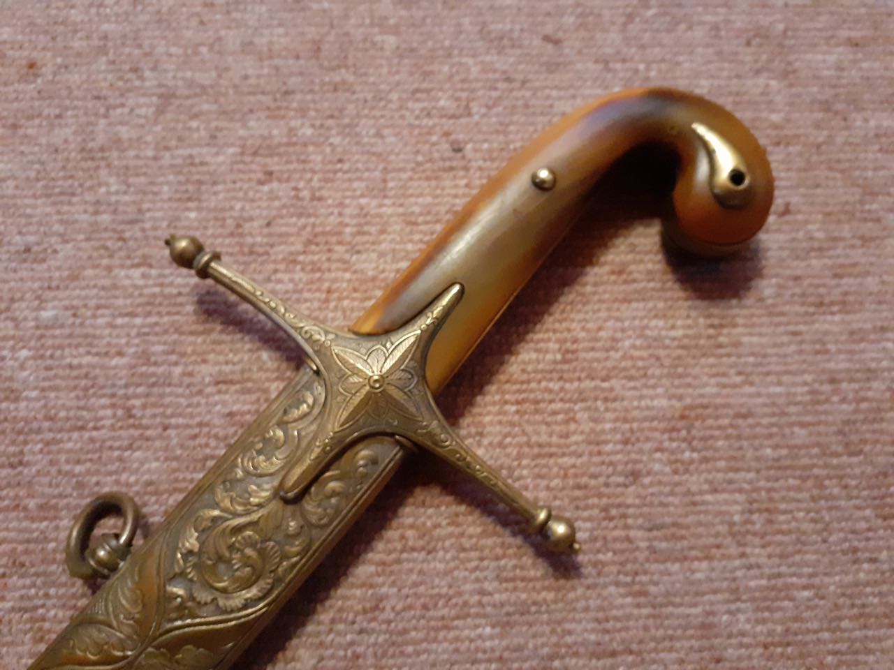

other pictures and the pitted blade...

Hello Francantolin, its French or Belgian , between 1830 and 1860 not only all original but also very good quality in this genre !
kind regards
Ulfberth

For me, the fabric-fake shagreen covering the scabbard was a later add
and make me doubt about the mounts too...

2-3 pictures of the hilt and blade who is not that bad even if chromed
( I read it was sometimes made on gala swords... )
Kind regards

Your sword blade would not be chromed, looks like etched design on the steel blade. Some mamelukes have nickel plated blades. It is difficult to make a call using digital photos whether it is nickel plated or not.
As an example of a nickel plated blade here is a Wilkinson circ 1902.
