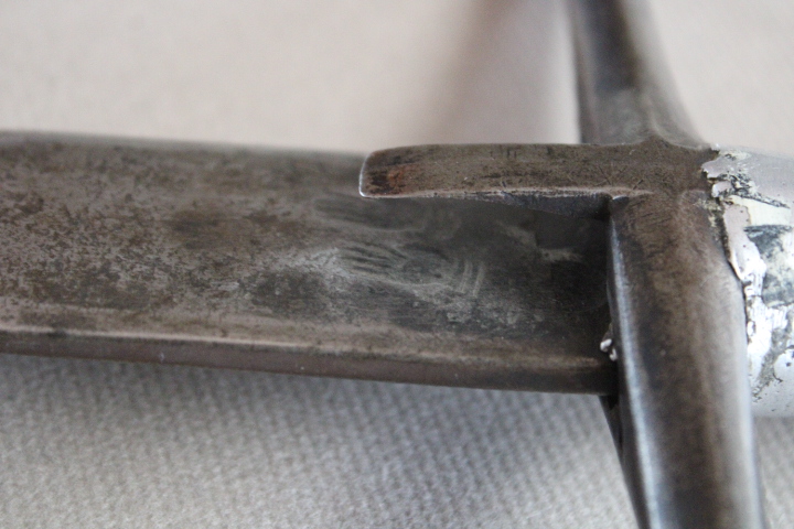

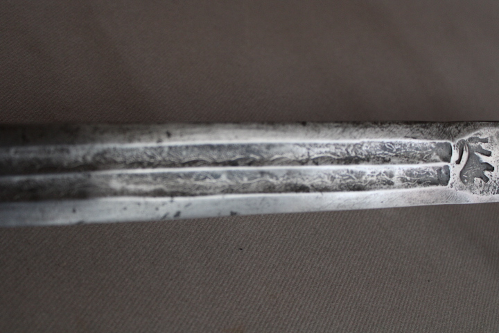

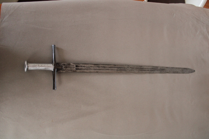

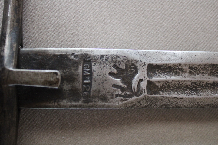

I've just got my second kaskara. the sword is 94,5 cm long, blade 83 cm, wide 3,8 cm, thickness at the ricasso 5,5 mm. A well made blade with 2 fullers. Inside the fullers a floral decoration, blade has some flex. On the ricasso markings on each side. On one side two markings, A lion and a cartouch, 6 gm 126, both deep and clear. On the other side two hands. The handle is cast on the sword, problaby aluminium or zinc.
The lion i've seen before, but the cartouche and the hands not.
According the seller it is a local made blade and the markings and the floral decoration resembling european blades.
Comments are verry welcome.

How heavy is the silver hilt?
Old 27th December 2020, 03:58 AM   #6
Posts: 10,867
This blade reminds me of the kinds of Solingen blades that indeed came through Ethiopia in latter 19th c. and often after being mounted with rhino horn hilts were sent to San'aa in Yemen. The rhino from the hilts was of course highly sought for use on janbiyya daggers. The blades were then remounted
with various silver hilts and resulted in unusual combinations, often there would be Amharic inscriptions .
The kaskara was of course well known in Ethiopia as well as Eritrea, and these blades recirculating over generations were likely remounted many times. I think Ed has the best perception of these remounts by the character of the guards etc. as described in the work he has done from outstanding field work in the Sudan and presented here.
Hi Battara
I don't think its silver but aluminium or zinc, it feels light.
I don't have anything to test silver.
Silver on kaskara handles is mostly wire or thin plates.
Solid cast silver handle would be nice allthough.
Greetings

It's not an Ethiopian lion for sure, maybe a copy...
As Jim said the fullers look like the Solingen ones.
No one mentioned the numbers... Strange for an African copy.

I agree, lighter probably means aluminum, which might indicate a later (early 1900s) dating for the hilt. And yes most I see with silver are wrapped and decorated, not cast.

These deeply channeled blades are distinctly European, and actually they were made in both Solingen and in England (Mole & Sons) for Ethiopian markets in the reign of Menelik II (r. 1868-1915). These blades were of varied types, many curved for shotels but there were numbers of these straight, channeled blades (as shown in post by Kubur with 2005 threads).
From what I recall, and image from the shambles of my notes, these blades came into Ethiopia, typically to Armenian merchants in Harar mostly, for the Abyssinian armorers (Sarlis Terzian c. 1890 was one of the many and Keverkoff another commonly seen).
The Mole versions often had the Amharic script etched in, while the German examples seem to have had the floral etching. Typically the Lion of Judah is seen at the forte, but this one is different being a couchant lion without the regalia on the Lion of Judah (the Royal Abyssinian mark).
Also, the gloves are typical of German makers marks of latter 19th c. period as yet undetermined. The numbers are it seems commercial administrative associated, and I have seen these types of numbers on various German blades to colonial clientele.
The lion has distinct symbolic value across North Africa from Sahara to Sudan, and several forms of lion exist on Tuareg sword blades (from Kaocen Rebellion, 1916-18) to Hadendoa in Sudan where this may have been 'totemic' (the Hadendoa name assoc. with lion ?).
There was a German firm (C. Lutters & Co.) using a circled couchant lion c. 1840-99(Bezdek, p. 147) and imported blades from there may have influenced native blade producers.
In "People of the Veil" (Rodd, 1928. p.233) it is noted referring to 'Masri' blades, "...another cheap variety has a small couchant lion". These marks were believed to imbue the blade with magical powers.
This convention of 'magical imbuement' was not lost to commercial production of blades, especially in Solingen, where the use of spurious markings for specific clientele had been practiced for many centuries.
As noted, these straight blades, whether intended for Sudan or Ethiopia, carried a couchant lion which may have appealed to either recipient.

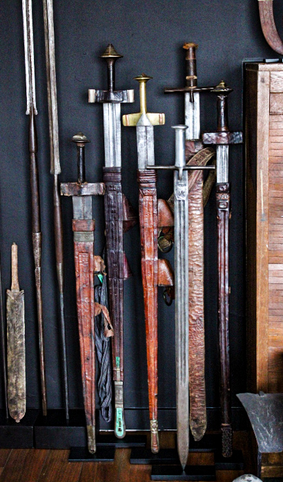

I have a very similar sword (blade at least). I associate these fuller decorations with Ethiopian influence, and the blade I was always assuming is not locally made but a trade blade of some form. Like yours mine has a panel with numbers which is rather strange. The lion marks look identical between your blade and mine, also the decoration. I think these were therefore trade blades of some kind. Your hand marks are not present on mine and look like a later addition to me.
Some pictures of my example here: https://photos.app.goo.gl/phgeUZgdUYjMEXQS9
Apart from the blade the rest of the fittings and scabbard for mine are of lower quality, scabbard is also unusual in that it is plain and does not follow the usual patterns of other kaskara. The sword itself is on the smaller end of the kaskara scale.
So all in all I had attributed these to cross over between Sudan and Ethiopia, and not that old, very early 20th C. Of course I'm interested to be proved wrong though

As I had mentioned in my post (just prior to this one) these blades are trade blades made for Ethiopia (Abyssinia) from around 1880 into 20th c. by both England and Germany. The British were providing blades for Menelik into the 1930s.
The numbers were a feature which seem to have begun appearing on Solingen trade blades at the end of the century and may have to do with lot or pattern etc. As you have noted, the lion is virtually identical but placed in different place on blade, the point is it was a favored imbuement regardless of location. It likely varied by shop or worker adding it.
The 20th century assessment is of course quite reasonable as these swords remained in use, at least traditionally, well through the century. It is well known that the kaskara was in use in Ethiopia (Burton, 1884, Danakil) and in Eritrea. I once spoke to a Beja tribesman from Eritrea, who let me see a video of their tribal dance ceremonies with kaskara.
As you note, these hand marks are not a known makers mark, and may well have been added by importing dealer handling the blades.

Thanks for the confirmation and the information posted before. I'm interested in the numbers - are the German blades you've seen matching this form of messy numbering on the ricasso?
The process of making them must be interesting. They are not machine created but appear to be raised out of an uneven depression in the blade. Perhaps deeply acid etched like the fuller decoration, but not neatly done. I don't see an easy way to make it by stamps in this form, but could be possible I guess.
I also wonder what they represent, batch numbers maybe. But it's really odd when you think of the way that blades and gun parts were usually marked at that time post manufacture, and why so visible and variable in placing.
Btw I have another kaskara with the Amharic etched in the center fuller very like the examples you posted. Again, this has a lower quality local made guard and rather plain scabbard, with a Hadendoa tassle.
For both these swords I'd attributed it to individual blades moving west, but now seeing Marc's example it suggests that these blades could have been more than a one-off chance. Perhaps more organised late 19thC/early 20thC trade with Ethiopia for suitable blades, hence the poor quality local made fittings and not the better type usually seen on older kaskara. But you raise the idea that these were Ethiopian made if I understand your correctly.
Hi Chris
I think the numbers are stamped in when the blade was red hot, if you look close you see a double print of the numbers. Problably the first blow was oneven or not deep enough so a second blow was made.
Greetings
Marc

A picture of the swords in the collection.
Greetings
Marc
Marc M. is offline   Reply With Quote
Old 29th December 2020, 03:31 AM   #23
Posts: 10,867
Greetings
Marc
Im glad I could add information and thank you for sharing this.
Outstanding collection!!!! well represented pieces!!!

Hi Chris
I'm affraid i have that bug for more than 25 years and it is probably here to stay.
Greetings
Marc
