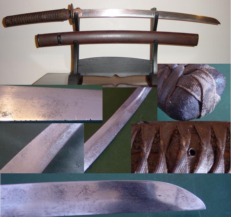

I have just learnt some (?) of the lexicon used in this weaponry, in order to try and query on this on this sector.
Probably this specimen i have just bought is a so called Wakisachi ... the blade is 44 cms. long.
The dual efect in the iron guard ( Tsuba ... ) looks like the Yin-Yang chinese symbol, which gets me lost, as i can't figure further on.
The all set is damaged ... the blade was subject to heavy misuse.
Various parts missing ( fuchi-kashiro (?) and other ).
Any member within this area, to give me a little push, both in possible age and classifying?
Thanks a lot in advance.

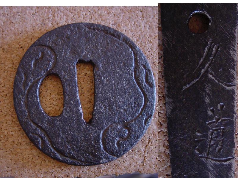

You have a shinogi-zukuri wakizashi. The signature is Hisamichi. Can't
tell age as there were several smiths working at various periods using
this name. I would "guess" maybe late 1600's to mid 1700's. But that
is just a guess based on style, condition and known smiths.
The tsuba is quite rusted, but I suspect it is an early one,
possibly Ko-Shoami or Katchushi.

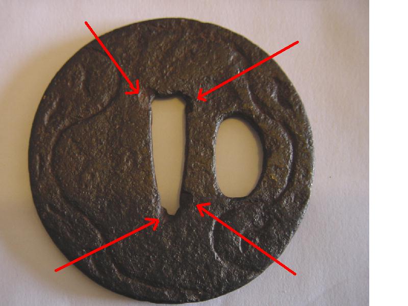

To further validate the age of your piece take a moment to look at the tsuba. When a tsuba is fitted to a blade, it is "punched" in four corners (either side of the front edge, and either side of the back edge). This is much the same concept as center-punching to prep for a drilling. The metal is pushed into the void where the blade passes through and then filed down to fit the cross section of the blade so that the fit is snug and well aligned. These punch marks should be somewhat distinct. Sometimes tsuba are cast and these marks are much softer in their form (if they have not been re-punched to fit the blade). This may also help you shed some light on your piece.
The unfortunate truth about signatures on Japanese swords is that they tend to be well documented and therefore easily researched. I find that one must rely on more than just a signature to date a sword properly.

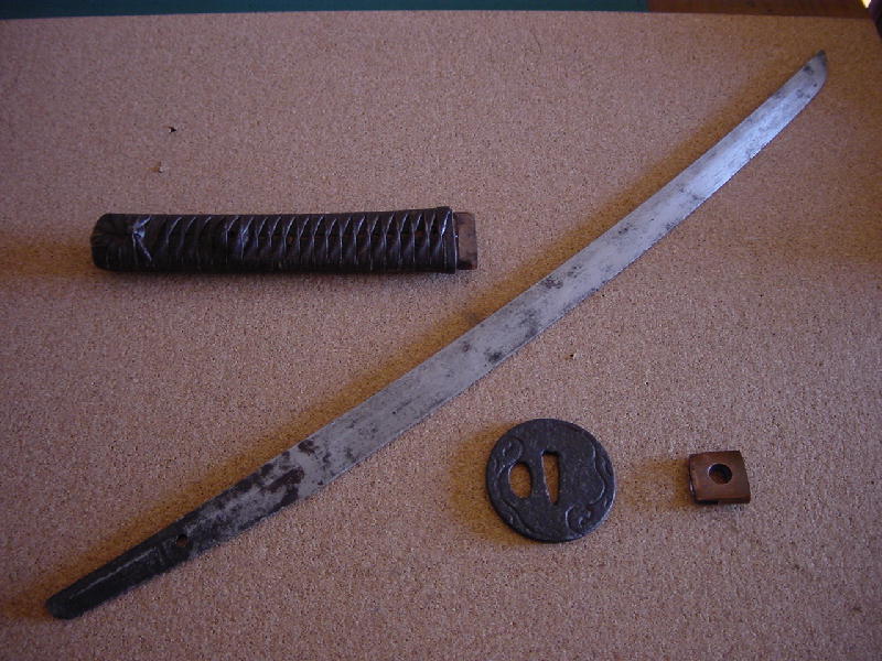

This sword was bought in a close to junk condition. All parts must have been separated and exposed for whatever time, then wrongly reassembled, with the tsuba next to the blade, with the tang and habaki stuck deep into the tsuka(?), to a craking point. The blade must have being subject to infant swords play, with its various dents. It was once striken with hard sandpaper, certainly for unrusting, not for polishment. It also served as a hammer, as the tang end was smashed in such manner.
It is therefore dificult for me to judge on its age, even after learning from you the various sympthoms to find so.

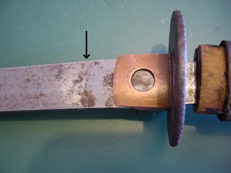

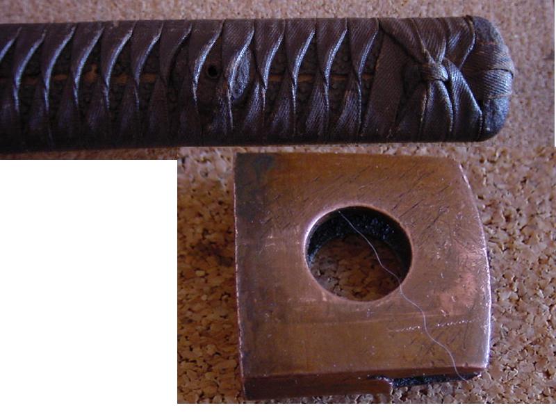

The habaky was in the first picture; it shows signs of age. I don't find the use for that orifice in both center sides, as i haven't yet seen more of this style in the web. Do you know what this represents ?
You are right, the signature is well preserved; also because it was strongly punched, even with a scale efect. It was easy for the present rust cleaning brush process, to brighten the texture scales. Before the cleaning, the tang had such slag in the greater area ... the rest was irregular rust, with some portions of neither.

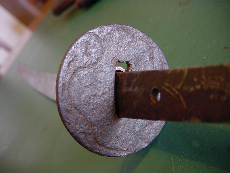

The tsuba has indeed a few punches, but apparently only on the other side, as shown in present pictures. However its center hole seems to be too large to adjust to the section of this blade. Possibly this tsuba belonged to a larger sword, as i don't see how the ( missing ) seppas woud eliminate this problem.

There were smiths named Hisamichi working from the mid 1600's to the
late 1800's. Hard to tell given the abuse this blade has had. From the
style of tsuka-maki (handle wrap), this might (?) be a Satsuma Rebellion
sword. Just a guess.

As for the circle in the habaki, I would say abstract japanese design motiff: think full moon or sun. Interpret as you will. I agree with you, I haven't seen very many pierced habakis. It threw me off. I'd be interested to know if the habaki is folded or cast (it doesn't look to be cast)? If it is folded there should be a soldered seam on the edge side possible with a small wedge in there as well.
You made me realize that someone who doesn't collect wouldn't treat the rust on the tang the way a collector would, they would simply think it needed to be cleaned like everything else. So obvious now, yet sometimes it's so easy to only look at a thing from your own perspective.....
The handle also threw me off as I have not seen that style of wrap done before. I'd be interested if this style was done for the same purpose as other so-called "battle wrap" styles. I was told that "battle wrap" (using a single pass of wrap) was done to conserve on the wrap material in times when it was scarcer (aka wartime) as a single pass around uses less than crossing passes around. Rich: are you familiar with this style? Can you offer any additional info?
I think it was fairly common for tsubas to find their way to a new sword (at least in our times), so it doesn't suprise me that it is too big for the blade even though it wasn't re-fit to it. To be honest, what I was wondering was if the piece had been cast from an original. From your photos, it does not appear to be the case. Here's a site I like with lots of examples of tsuba:

The copper habaki is folded, with an imperceptible brass welding seam below ... the front half craked ... or made that way, to aproach the blade, what would you say?
The wedge is not there, though is clearly missing one, in this specific case.

So i tryed to reconstitute this piece, compensating the parts that are missing ( fuchi and seppas and nakago ana ? ), with detachable wedging.
I saw in the appointed webpages that tsubas were often forged with a fair large opening, and its adjustment to the blades was done with
bits of soft metal ... kubicheni. Maybe this very one had that condition ... as in fact its total width is rather reduced ( 63 m/m ).
I hadn't noticed before that the grip pommel ( kashira ? ) is still there, as quite rusted and placed underneath the wraping cross.

I have being searching the web on the tsuka style, in the Satsuma Rebellion period swords, after your observation. I gladily found a note saying
that period tsukas had little or no ornamentaion, and the menuki were often " sun discs", which i conclude to be those of my sample.
As for the blade signature, i have noticed that te famous Hisamichi smiths signed a more complete name, not just Hisamichi 久道. So this could be
a later punction used by other late smiths, to add value to the piece, or just a later one with the same last Name.
