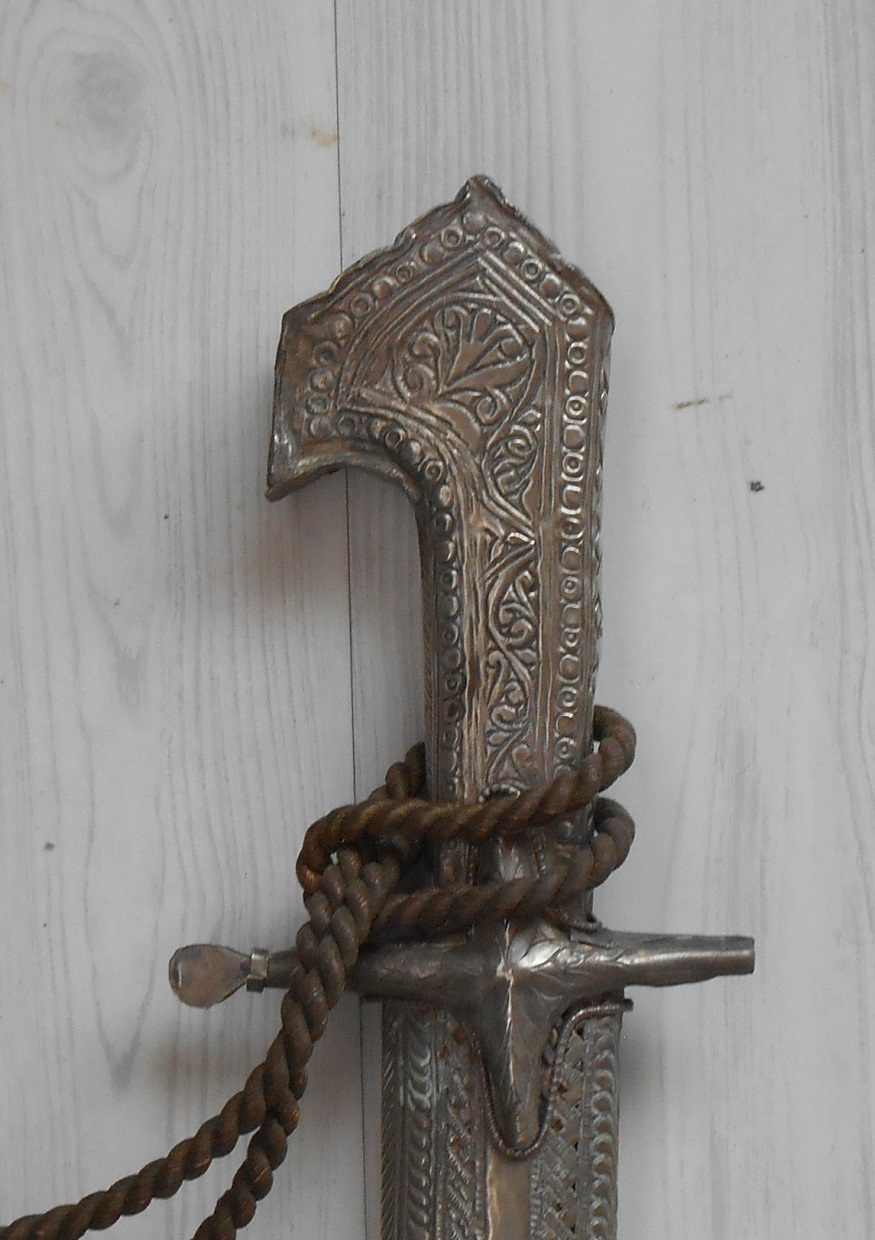

Greetings folks!

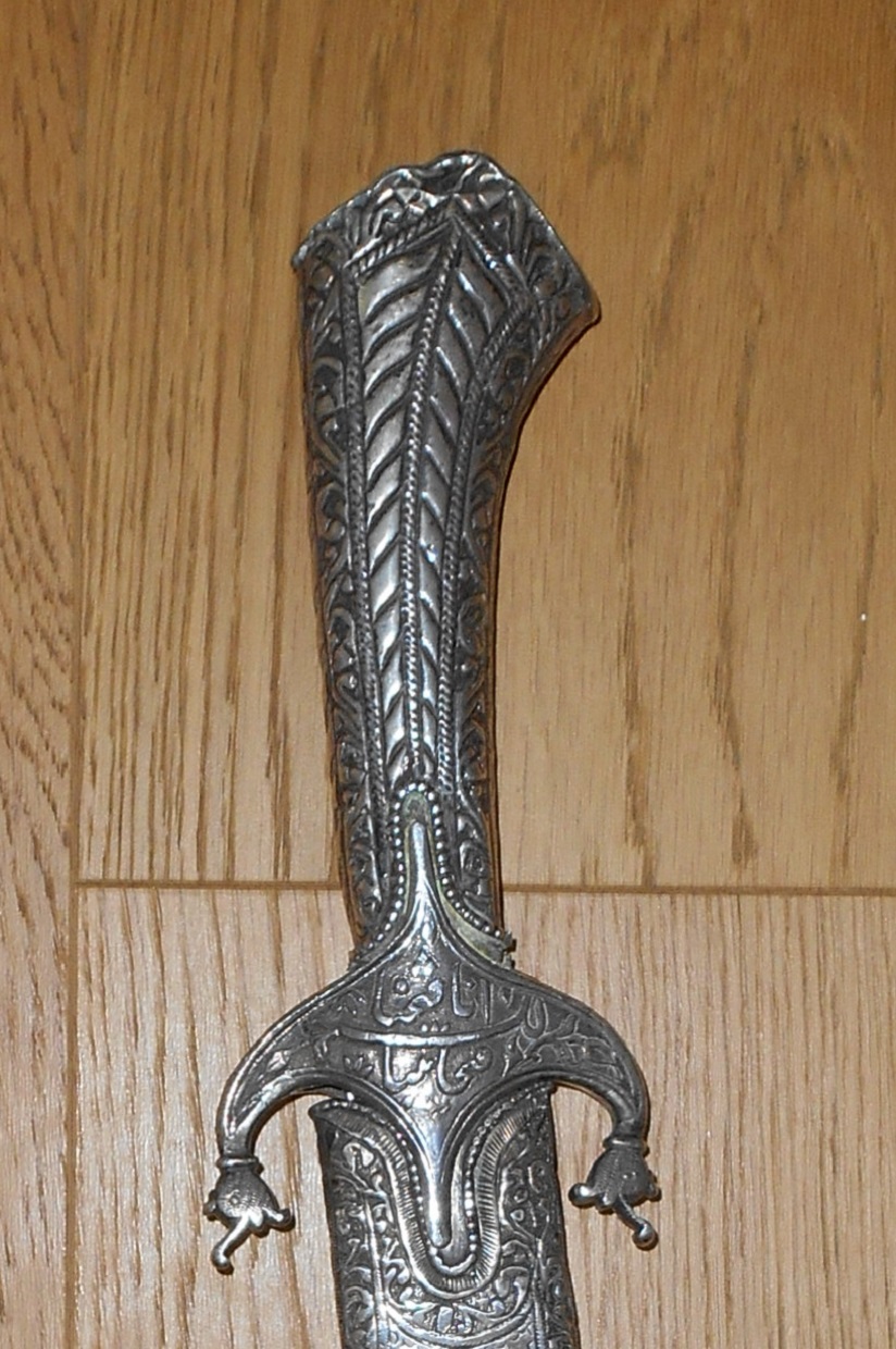

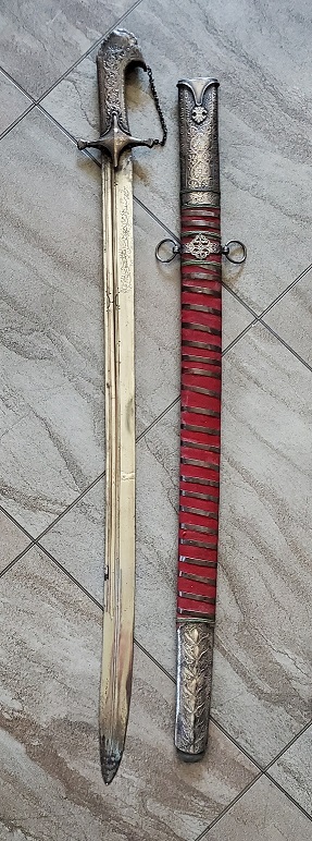

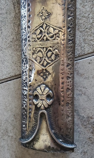

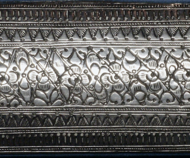

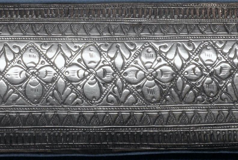

Well I got this saif (on my wish list) and I am wondering if it is from Yemen or Hyderabad India for the Yemeni market.
My suspicions come from 3 things:
1. the type of flower motif on one side of the silver scabbard
2. the type of flower motif on the other side of the scabbard
3. the type of pattern weld that is indicated on the blade
What are your thoughts?

First of all, congratulations on this extremely nice saif. Your observations on the flower motives are accurate and supported by both Elgood and Hales. Both authors state that while these swords were used in Southern Yemen, many of them and especially the nicer ones were made in Hyderabad. Have you tried bringing out the pattern on the blade?

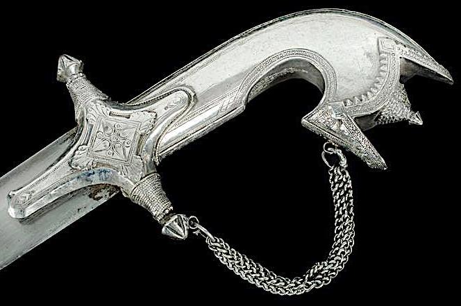

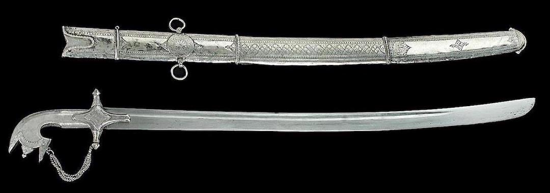

As far as I have understood from Robert Elgood, this type of sa'if was well known in Hadhramaut, which is technically the eastern part of Yemen to the Oman border. Apparently these regions often furnished mercenary forces to Hyderabad, thus the significant connections which may account for the popularity of this silver work from artisans there.
These sa'if had the canted triilobate pommel as seen on this wonderful example posted, as well as the 'karabela' type, which I have attached.
While these seem typically regarded as latter 18th century, their use seems to extend into early 20th c. and whether the hilt forms were contemporary to each other is unclear, perhaps simply matter of personal preference.
In any case, a form not often seen available to collectors, so outstanding score Jose !!! Merry Christmas!!!!!

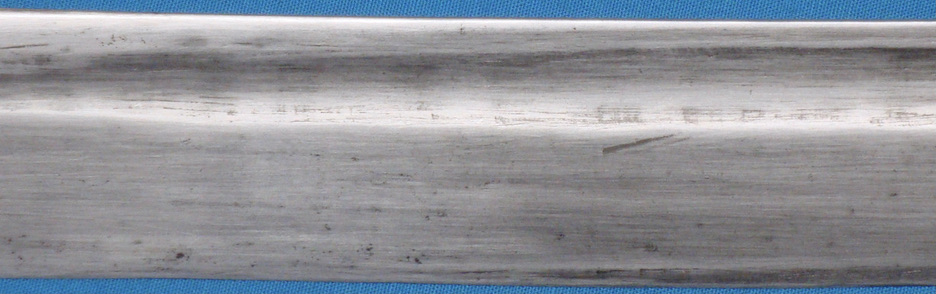

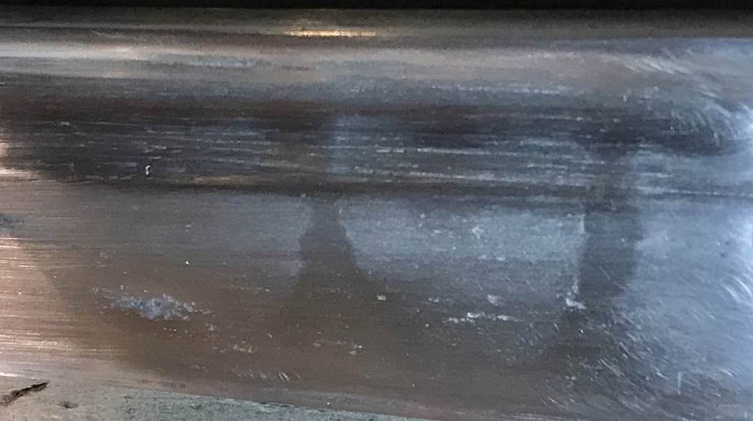

TVV - I did etch it and the patterns came out even more starkly reminiscent of some types of Indian pattern welding. (see picture).

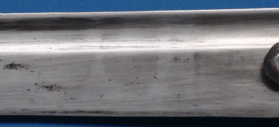

This is a very good example and it is in excellent condition. Congratulations for this quality piece!
From the photos you posted I am not sure the blade is pattern welded. Most blades of this kind of saifs are not pattern welded.
The apparent pattern may be because of lamination, heat treatment but in this case more likely because of former contact with oxidizing agents. However, it is difficult to say from the photos.
The blade is already well cleaned but with rather coarse scratches. So I think the blade may benefit from some finer polishing 1000-2000 grit. I wouldn't attempt to completely remove the scratches but only to give it a finer and more uniform appearance. By doing this, the structure of the blade may become more apparent.
PS: I consider pattern welded, a laminated structure composed of two different steels that etch in different tones so as to display a specific pattern.
So if a blade is made of multiple layers of the same steel (like the Japanese blades for example, or like many Indian blades) it is laminated, but not pattern welded.

After etching it to see the laminations I re-polished it but not finely. I will put the final polish soon.

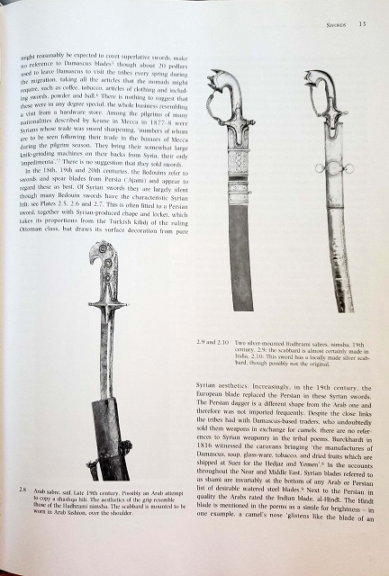

I found some excerpts from "Arms and Armor of Arabia" Robert Elgood, 1994:
Regarding the Aden Protectorate:
"...the peoples of this area frequently served as mercenaries in Hyderabad and the swords are certainly made there and locally. The better Hyderabadi ones -like the daggers made for the Hadhramaut-show red foil inder the pierced silver scabbards. The chased silver flowers and wheel pattern on the sword scabbards are Indian in style". p.15
Also, p.83,
"..west from Oman is the Hadhramaut, which like Muscat, had close trading links with India. The Yafa'i were a tribe with long history of mercenary service to the Indian rulers though other tribes were also included".
p.84-
"...only the Mukalla sultans wore jewelled daggers- FROM Hyderabad.
p.86,
"...the very best janabi and nimsha blades were imported into the Hadhramaut from Hyderabad where they were made, and simply referred to as 'Haiderabad'."
This was of course the Hyderabad in the Deccan, not the place by same name now in Pakistan.
Naturally, there were silver workers in Hadhramaut, and clearly the blades for weapons were imported from India, however as noted in this text, there seems a strong suggestion that the higher quality swords were mounted in Hyderabad.
The diffusion of these swords would of course be most likely throughout the Yemen, though much of the attribution and connection to Hyderabad seems to be related to the mercenary activity and traffic with Hadhramaut.
The attached page from Elgood shows the 'Hadhramauti' examples. The note on red foil under piercework and the silver designs gave me the idea that my example was from Hyderabad for Hadhramaut because of those elements, but in mine the silver is backed by red velveteen rather than red foil.

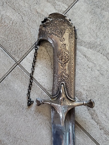

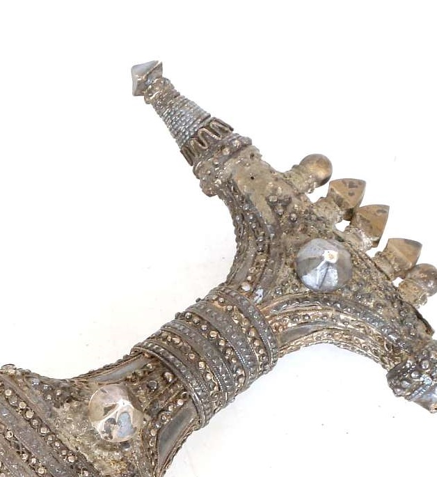

Please Jim, look at the pommel of this zaibidi jambiya extremely similar to the quillon of the sword discussed.
For Ariel, of course I agree, the Yemeni karabela is from Ottoman origin, here I post my Yemeni karabela and my Persian Zand karabela for comparison.

Thank you Kubur for showing these examples. With the swords, it is interesting to see the recess to hold the langet in the same manner as the Hadhramati examples we are discussing. The Persian influence was of course prevalent in Arabia, so not surprising to see this feature in common on a Zand period weapon. Great example!
Good comparison on those diamond like fixtures on the hilt of the Zabidi janbiyya. I'm really not too familiar with Arabian daggers, but believe 'Zabidi' refers to SE Yemen whose area included the Hadhramaut.
Mocha was the Red Sea port for San'aa (in proximity of Taizz) where there was considerable sword production as well, and the forms known there seem to have had their own peculiarities. These were western locations in the Aden Protectorate or South Yemen.
I think it is safe to say many hilt elements were favored in common, but the larger structure or configuration of hilts held to somewhat local preferences.
