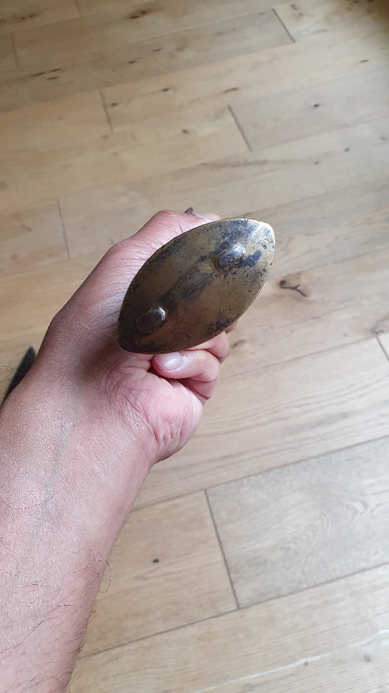

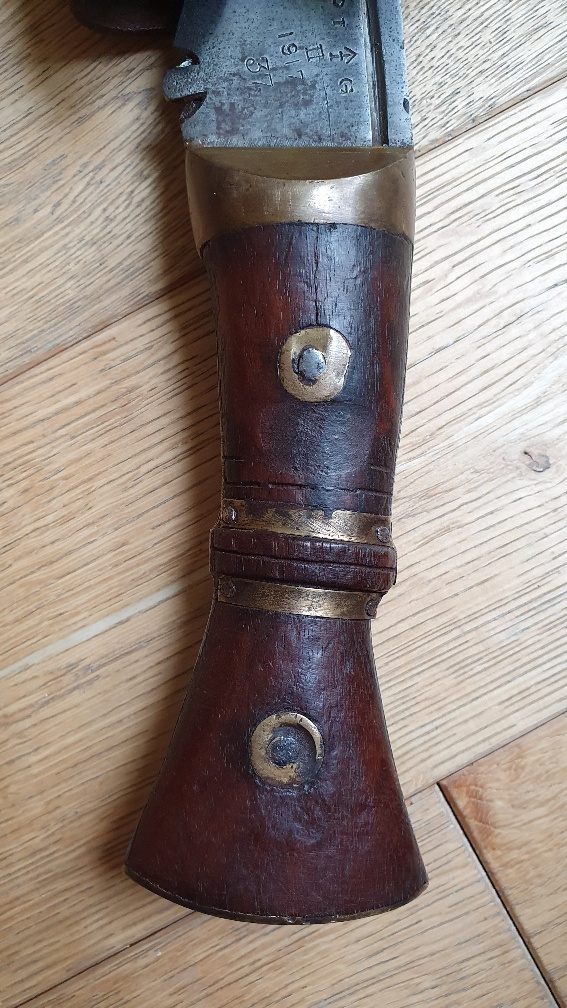

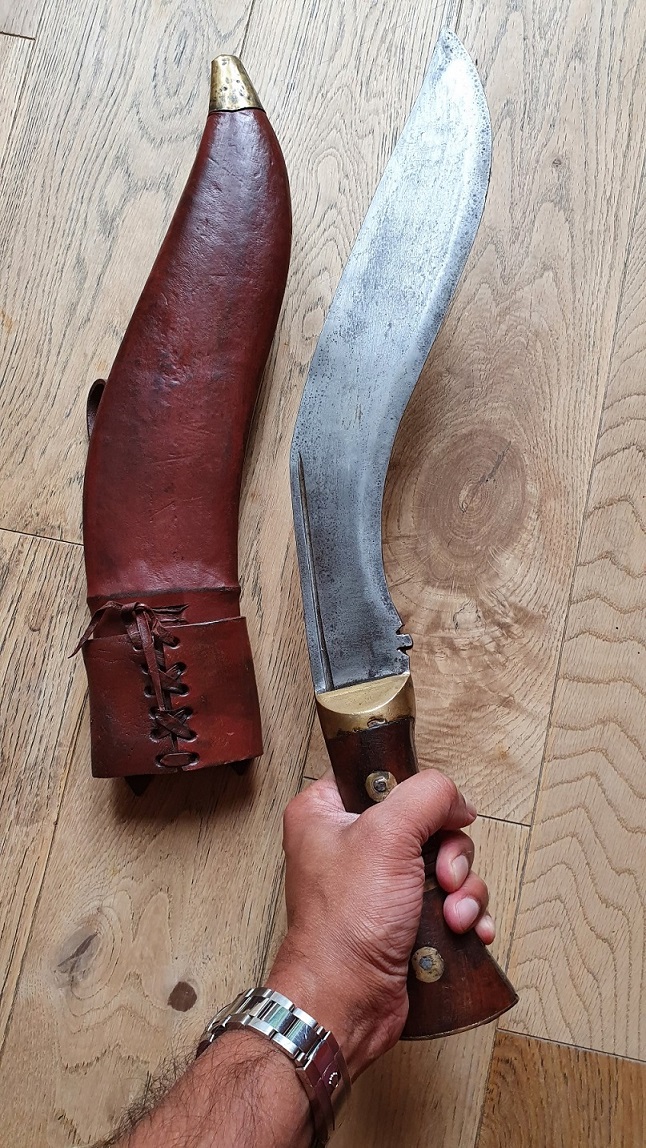

Hi All,
I picked up a couple of Kukris at the Kempton fair yesterday and just wanted some reassurance on the MKII that it's an original - I've referred to an earlier very elaborate thread on kukris by Spiral which seems to imply that MKII usually had steel bolsters, and brass were sadly fakes - but with some exceptions. I also gather eBay sells a lot of fake kukris (as it does with pretty much everything else!)
So here're some snaps - the blade is about 34cm and total length 48cm (not accounting for the curve just to be clear, just straight line measurements). Must admit I'm a newbie to collecting swords and these are my first kukris, but this one seems particularly large and substantial in my hand! I've googled some other MKIIs and they seem to be slightly smaller in size. The condition overall I'd say is very good including the scabbard.

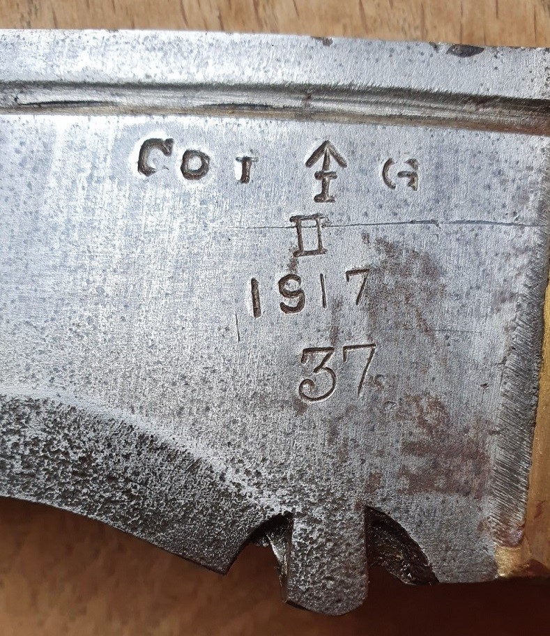

Would be very grateful if you Gurus are able to confirm the authenticity (or reject hope not!) The markings are self-explanatory - Cossipore India Store Department 1917 etc. 37 I believe is the serial number?

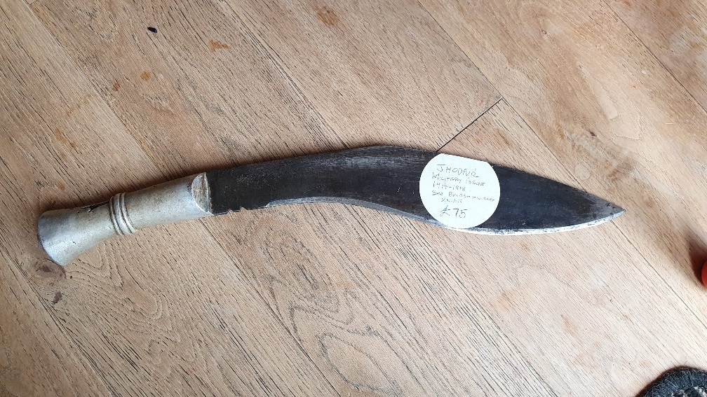

The other Jodhpur I purchased from a fine gentleman and not for the price on the label - a good bargain I reckon!
Many thanks.

To be honest there are elements I do not like
I do not like how the Cho/Notch is not finished
The different fonts on the 1917 is worrying

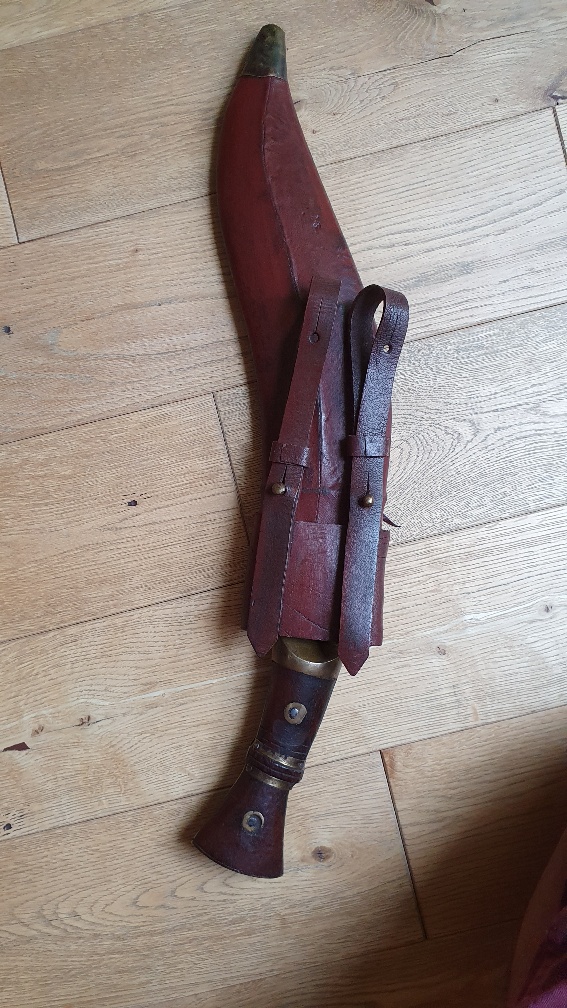

and the scabbard does not look 103 years old to me
also handle looks to be v large
when I am doing purchasing if 3 or more things look incorrect I walk away unless the price in insanely good.
Just my opinion but do not be disheartened if it is a replica you have to pay for your education in this hobby, hopefully I am wrong on all my points

Unfortunately the Mk2 is a much later "reproduction" - some might use the word fake. These are turning up from time to time. Even auction houses sell them as the real deal Looks nothing like a Mk2 should.
http://sirkukri.blogspot.com/2013/08...ary-kukri.html
http://www.vikingsword.com/vb/showthread.php?t=19597
The Jodhpur looks fine. The consensus now is that these were made towards the end of WW2 or just after.
http://www.swordforum.com/vb4/showth...-Jodphur-Kukri
http://www.vikingsword.com/vb/showthread.php?t=26021

I could not figure out how the hangar straps on your scabbard could possibly work, but I see it was made or assembled upside down compared to the original example posted previously in a link.
