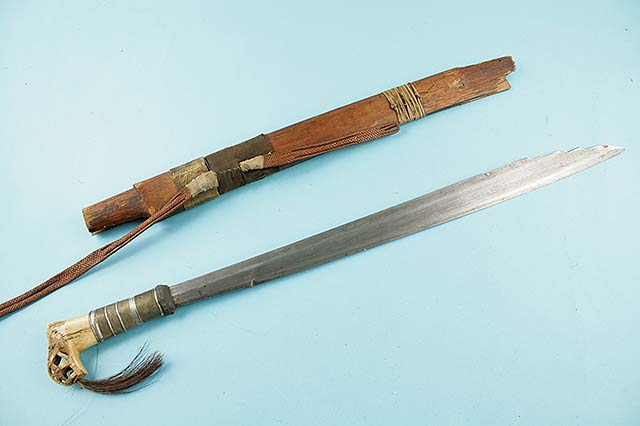

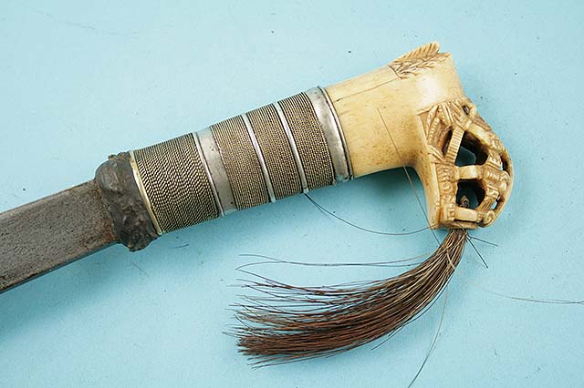

Hello. I know mandau are tricky but hoping to narrow this one down to more than "Dayak". I've seen a few photos with similar style carving but no attribution. The blade is a nice piece of work, simple for a mandau but very well executed. The silver on the hilt seems to be a bit unusual. Battara got a good look at this one when he rescued the scabbard from complete disintegration. The plug is synthetic, likely done as a repair by a collector or dealer unless anyone has heard of Dayak using synthetic materials. Photos from Oriental Arms.

Jeff, my knowledge of Dyak weaponry is slight, however using "Hornbill & Dragon" as a reference, I'd be inclined to give this mandau as Kayan.
As for Dyaks using synthetics, the old Dyak ways have been gone for a long time, even before the clearing and the palm oil plantations sent them out of the jungles, they were using modern materials to do repairs.

Hello Jeff,
I'd love to see pics of any similarly carved hilts to foster the discussion here!
IMHO the hilt seems to be influenced by Malay (floral) carving styles which could also explain the unusual silver work. Maybe this piece originates from a coastal trading port, possibly somewhere in eastern Borneo? This may also be supported by the blade type. Some more pics for more details would be great!
Jose, thanks for rescueing the scabbard - does the blade fit well and is the belt traditionally attached?
Is the plug utilizing horse hair?

Hello Jeff,
More pictures would be nice. Do you own the mandau ?
Koetei / Kutai region comes in mind, based on blade and hilt combi, floral motives.
Willem

Thank you Kai and Willem for taking an interest! Yes this is my first mandau and one that I actually have with me (I've been displaced from home for the last 6 months). Happy to take more pictures of features of interest.
I've added a couple of what I consider similar carvings. To me these look like a hunched 6 limbed figure embracing the void of the bone cavity.
A. Is my mandau purchased from Artzi
B. Is from the 2006 post by Dajak
2006 post by Dajak
C. This is a random download from Google Image Search
I've also added a better shot of the belt and a zoom of the hair plug
