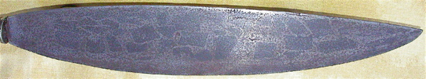

Here is an antique Barung which exhibits a very distinctive pattern welding: Looks almost like bits of high-carbon steel were thrown into melted iron and slices of this material subsequently utilized for sandwiching the high-carbon steel core. Well, I expect this pattern to have been forged but I really have a hard time to understand how this was actually done by the bladesmith!
I have seen this pattern before but only with Barung and not any of the other Moro blades! It seems to be pretty rare, too. A more knowledgeable member commented that this pattern may suggest an Indonesian origin. My guess would be leaning towards one of the coastal Moro settlements of North Borneo, maybe Tausug or Samal?
total length 54.5 cm / 21.5 in
weight 760 g / 1 lbs 10 oz
blade length (without hilt) 39.3 cm / 15.5 in
max. blade width 66.9 mm / 2 2/3 in
max. blade thickness 7.5 mm

Posts: 6,441
Kai,
I have a Barung with a similar pattern though I haven't been able to highlight it as you have .
Nice work .

Interesting.....I hope maybe Ben and Michael can tell us more about the answers if Borneo or not.

I don't understand why "A more knowledgeable member commented that this pattern may suggest an Indonesian origin" on a non-Indonesian weapon?
And I don't understand why everything odd from this region "probably is" Borneo?
I have also seen this pattern before on other barongs.
But so far I haven't read anything about specifically these barongs being either collected, or manufactured, in Borneo/Sabah.
PS Very nice barong btw!

The hilt suggests to me Samal tribe of Moros.

Hi nice Barong but I don t now if this one is from Borneo .
I don t think that the pattern has something to do from place off origine ,
it is more the style off Handle and scabbard . ( I think)
Ben

Ok, let's try to resurrect this old thread!
The example I posted does seem to be Samal, indeed. (Unfortunately, no scabbard extant.)
From very limited information that has surfaced since I tend to believe that the hint at Borneo might be spurious. Not enough data for any decision though - and there have been Tausug and Samal settlements along the coast of northern Borneo for centuries.
I'd greatly appreciate if forumites were to add more examples to this thread - thanks a lot in advance!

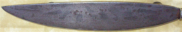

Here's one of mine for comparison.

Lovely barung Rick. It has a really interesting blade. I'm not at all an expert in how these are forged, but it seems that the initial billet was divided in two down the long axis of the blade where the long forging line appears, then forged out from there. It seems there was a central core of (? softer) steel or iron, surrounded by a (? hardened) steel layer. I've circled what I think are the area of "blotches," but are these really inclusions like on Kai's example? Am I looking at the right area? The edge has a lot of lamination activity, and its hard to know if the circled areas are just lamination or are inclusions.

No Kai, it was this one; the patchy areas were the closest I could come to anything like the OP.
I know it's not quite what you were looking for, but there was also a request for photos of Barungs so I thought I'd throw it in there.
I'll be glad to remove it if you think it's off topic...
Ian, this one came from ebay back in the good old days when it was actually possible to score bargain prices on these 'unknown' knives/swords like this one and a certain twist core kris I bought for literally peanuts.
The forging pattern is interesting and indeed it may have been divided in the process; to me it resembles the inside of a flattened banana peel.
I wonder if it is also Samal like yours and Jose's example.

The main pamor certainly is different; along the edge it does look more like the "clouds" of Ian's example in the other thread. A closeup of a full section of the blade would be good for trying to figure out the actual forging process. The pamor billet certainly got doubled over resulting in the cold shut (the single dark line along the middle).
Let's keep it here (also to show that the older response referred to a blade of different construction). I do hope we'll see a few more examples of the mosaic pamor sooner or later!
