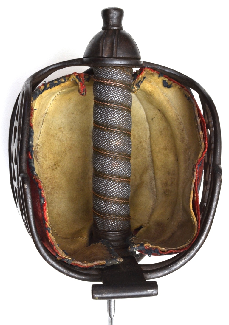

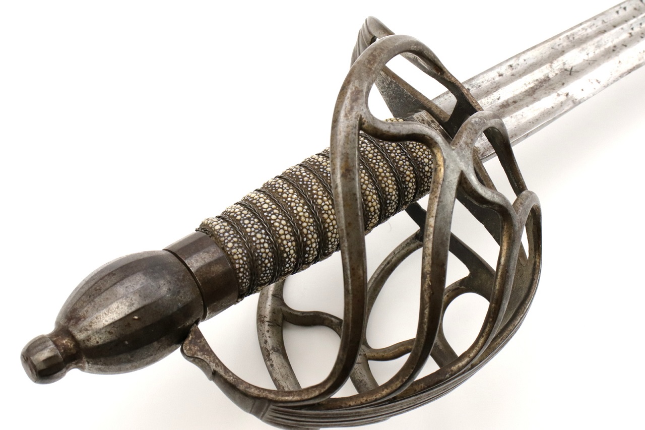

I was recently offered a c1640 British sword, but Rex was put off by the good condition fish skin grip and buff liner. I am sure the sword is correct and agree with Rex that the addition of the Fish skin grip as seen on Victorian basket hilts etc and liner may have just been an attempt to restore the sword. Then I realised that I actually have no idea when this type of grip first appeared, can anyone outthere enlighted me.
I have attached a pic of the grip of one of my VIctorian Basket hilts so you know what I am referring to.
Cheers Cathey

In rereading this, I think I would be a bit hesitant as well about presuming a well preserved ray skin grip and buff liner on a mid 17th c. British sword is original to it. As far as I have understood, while rayskin and variants were used through Asia much earlier, this affectation was not used in Great Britain on sword grips until at least mid 18th c.
It then becomes a matter of accepting the sword as structurally sound as a serving example of the type and allowing for the replaced component as an aesthetic replacement.

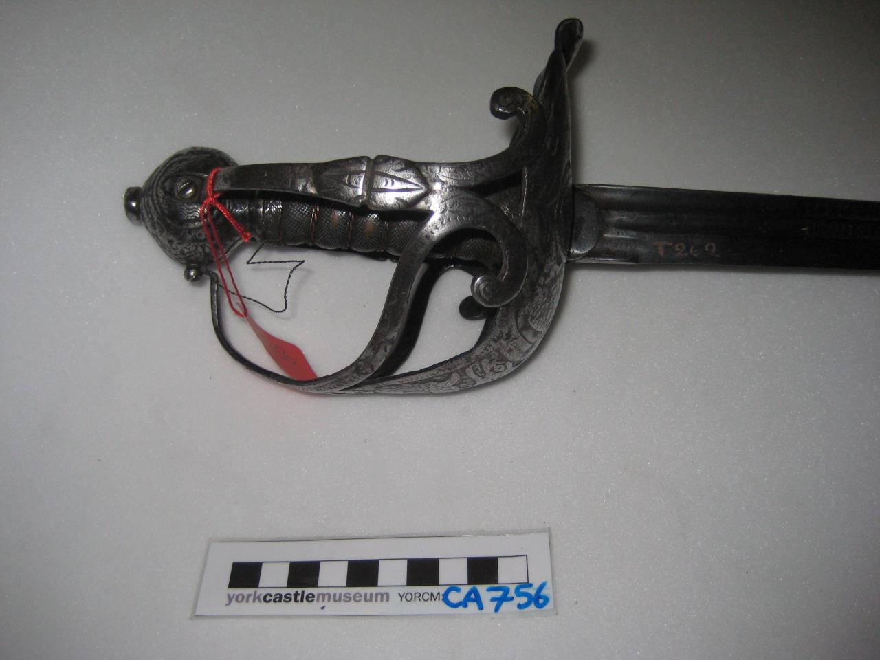

Came across this photo of a sword in the collection of the York Museum. The blade is marked "Me Fecit Hunsloe" and dates to around 1640. The grip is worn fish skin. No guarantee it hasn't been replaced at some stage, but does suggest the grip on the sword Cathey started the post with could be genuine.

Bryce, in complete accord with what you are saying....I have been going through English sword resources for hours concerning our discussion in a concurrent thread and saw the same references. This was I believe on several swords I saw in other sources as well, and these swords of 1620s-50s were indeed with 'fish skin' grips (clearly not using the shagreen term), but certainly showing the material in use in first half 17th c.

On this thread we are talking about the skins of two distinct types of fish. The British sword in the image included in post #1 has a sharkskin-covered grip.
The hilt shown in post #4 has a ray-skin grip.
Shark skin is typically gray, and very fine-grained, with a uniform texture.
There are several varieties of ray (in popular usage, the identifiers manta- and sting- are common adjectives but marine biologists have listed others, living in various areas in the aquasphere. In their natural state, ray skins tend towards white or an ivory shade. The skin is easily dyed, and this was widely practiced for decorative purposes in China. The nodules that form the "grain" on the surface are larger than shark, varying in size according to anatomical location and the species.
On some species, like the hides favored for the hilts on Tatar sabers (czeczugas or ordynkas), one often sees a peculiar distribution of huge, almost star-like nodules interspersed among smaller ones. For the rayskin strips on Japanese hilts, the part of the hide from the center dorsal region of another species was favored for the aesthetics of the graduated row of large nodules. In both these instances, the hides were used au naturel, with the bumps intact.
In China and Japan, the natural hide was sometimes filled with lacquer after being installed on the object, and then ground and polished down flush to leave the grain visible against the dark (usually black) lacquer in the low spots, a very attractive effect. I once saw a rare shield of Indian shape, covered with the "star" rayskin commonly associated with the Tatar hilts referenced above, and given the lacquer treatment as described here in one of the colonies of emigré Japanese craftsmen working in Batavia.
The normal treatment of rayskin on Chinese and Korean scabbards was dyed and polished smooth; jade green and a reddish brown were favored colors. Because the size of the nodules was graduated depending on anatomical location, care had to be taken at seams to match the material as closely as possible to maintain a more or less uniform effect. For this purpose, larger hides were considered more desirable.
