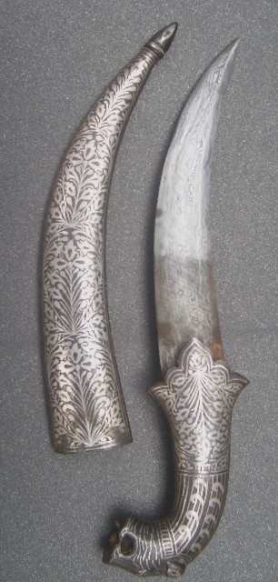

The young son of a friend has collected several knives, all tourist except, possibly this one. It was bought in a Jewellers ( ) in Goa, India.

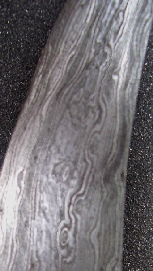

I am not certain whether the blade is wootz or 'acid etched', when you run your finger nail across the laminations you can feel them easily.
Overall length (knife in scabbard) 24 cm Blade is 14cms
Any ideas how I can determine if this is wootz? Any comments on the knife would be appreciated so I can pass them on to this young, new collector?

I think it is tourist as well. Definitely not real wootz (crystalline damascus), but some mechanical laminated pattern, rather crude. Is it acid etched as well? The texture of the blade surface looks uneven, but it may be just my imagination. The koftgary-ish decoration is very new.

I agree with Ariel the dagger is newly made and the blade is mechanical damascus steel not wootz. These daggers are produced by a growing cottage industry in India mostly for the American market.

Like Ariel says, the dagger is new and the blade is not wootz. The blade is possible acid treated, but to be sure a better picture is needed.
I have seen daggers the these – new but of a much higher quality. They do make new quality weapons in India, but I guess they can be difficult to find.
Here you can see one example http://arms.en.ec21.com/2/CA00067093/product.html

From what I can tell the kofgari is rather crude and in a particular style compared to those of 150 years ago.
