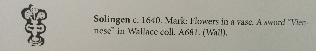

You cited from Staffan Kinman’s book. Is there a flower pot mark described in that book by any chance? The mark was discussed years ago but couldn´t be assigned to a specific maker.

Posts: 790
Originally Posted by AHorsa
Thank you Victrix!
Thanks
Andreas
I’m currently out on an island in the archipelago without access to the book. Will check in few days time.

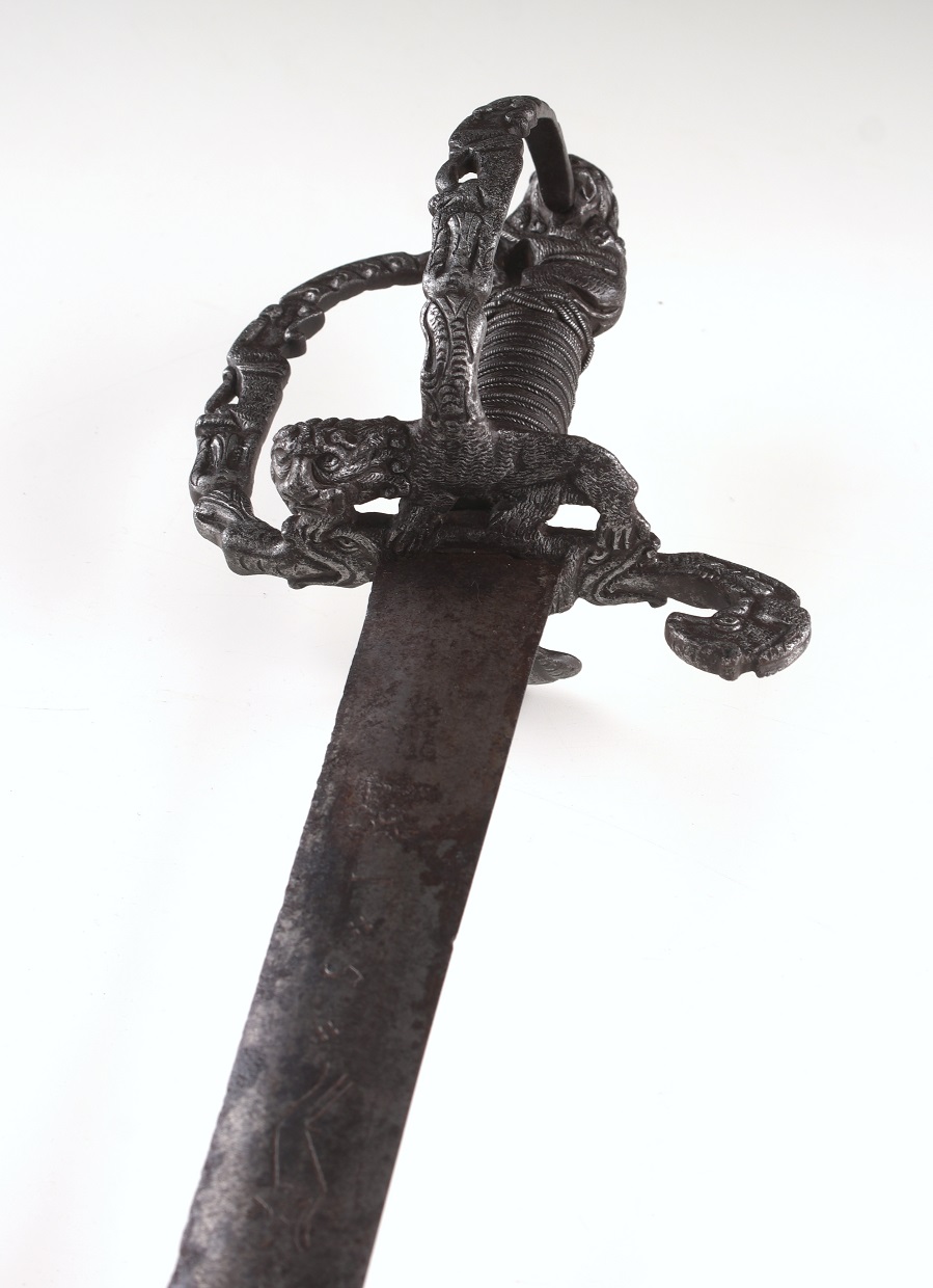

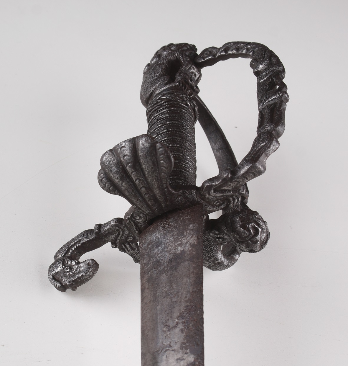

In the meantime might we see more of your interesting sword?

The sword was discussed years ago in this thread:
http://www.vikingsword.com/vb/showthread.php?t=18464

Yes I remember this stunning sword. You cleaned it so well.
The nearest mark I can find in Kinman’s book has a reference to the Wallace collection which looks about right, although it doesn’t show the mark nor mention ”Viennese.” It doesn’t give any name of the maker/smith but states Solingen which corresponds with the running wolf mark on your blade. Could the number 1518 be the Bible’s John 15:18? https://www.kingjamesbibleonline.org/John-15-18/

This mark is also described in the Wallace collection catalogue and it says that it also exists on a rapier in the Metropolitan Museum and on a sword in musee lármee Paris. But sadly also no name.

Yes I missed the Description bit: ”Swords with hilts of this kind are often described as Viennese. Compare the mark of a pot of flowers on a Solingen sword in the Musée de l' Armée, Paris (Weyersberg, Solinger Schwertschmiede, p. 75) and a rapier in the Metropolitan Museum, New York (no. 1056). Another was at one time in the de Cosson Collection.”
