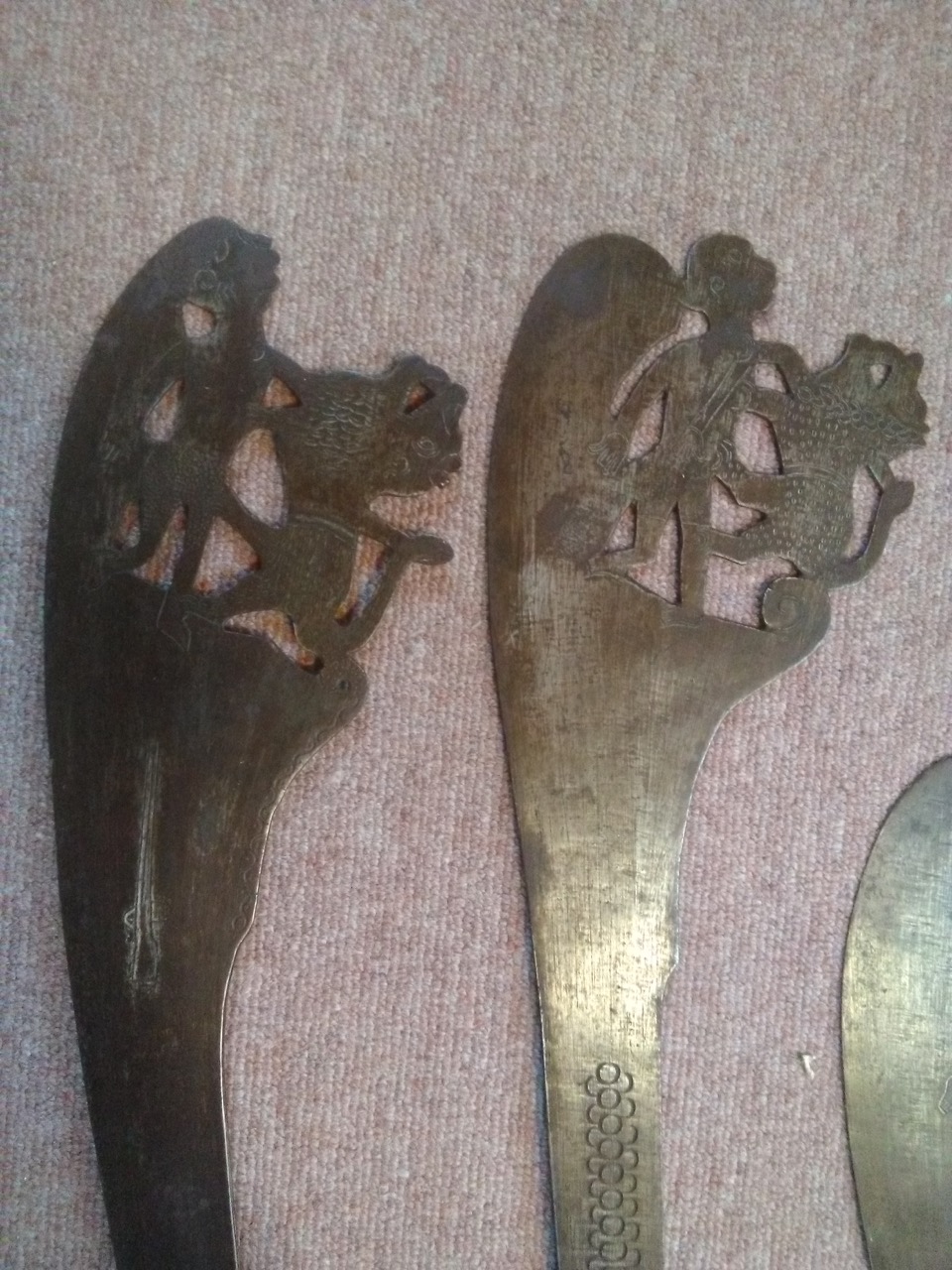

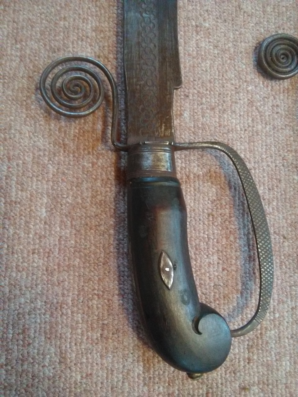

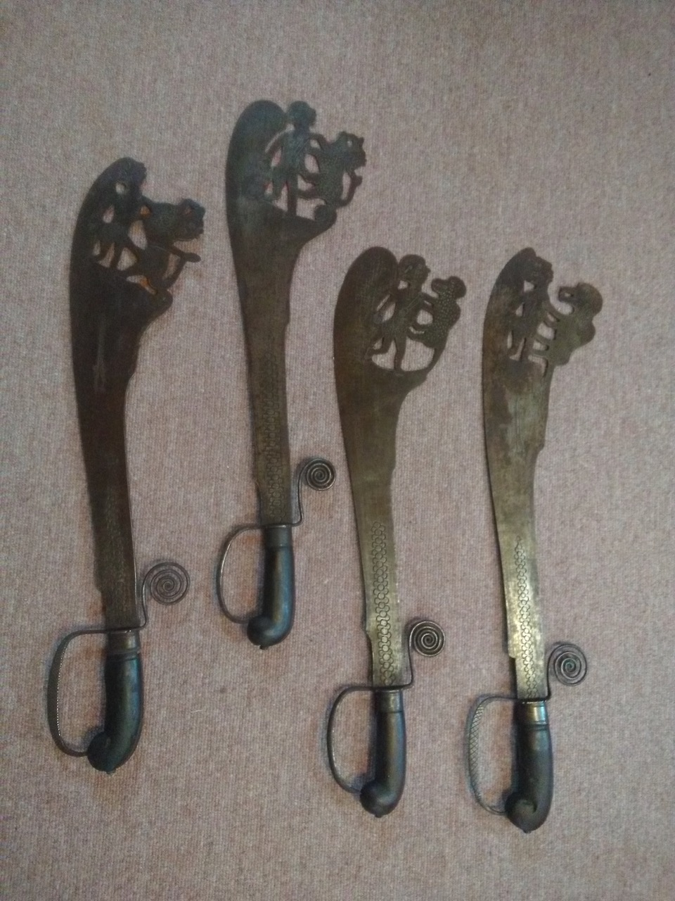

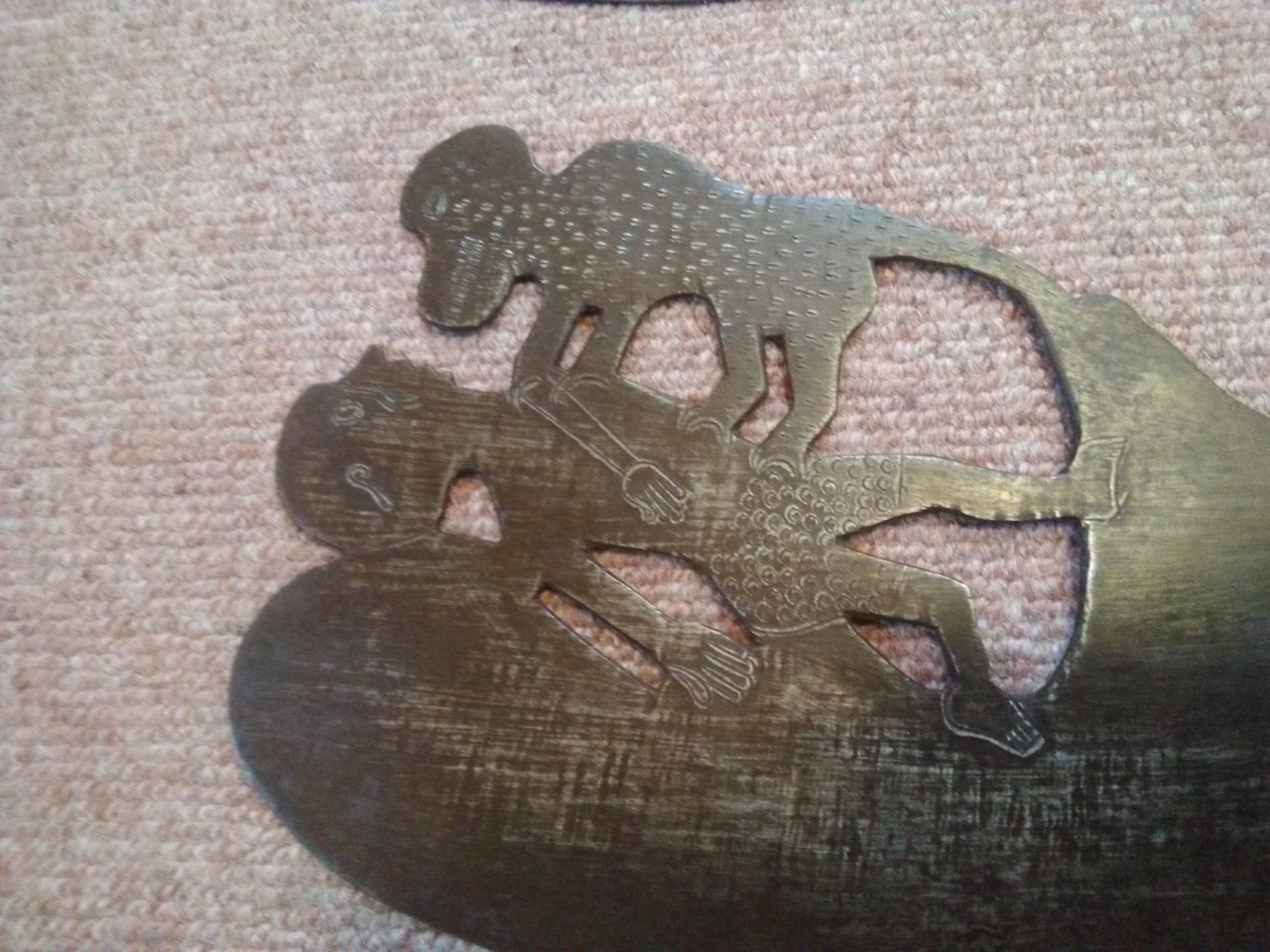

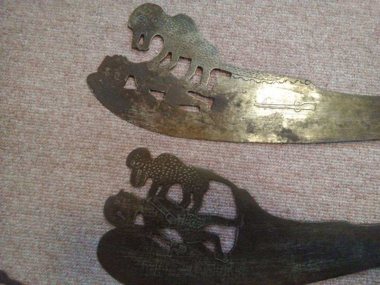

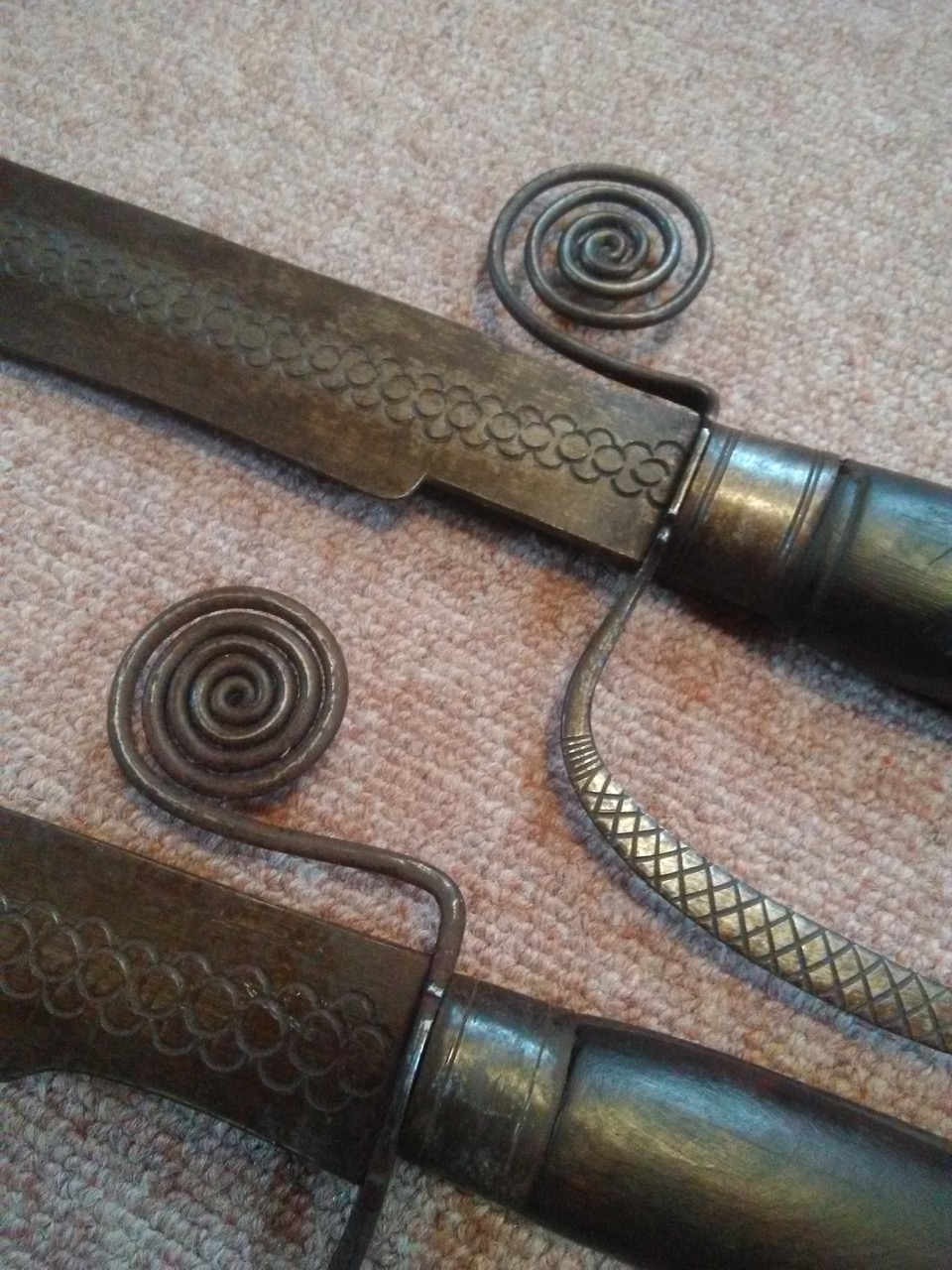

Hello everybody,
I'd like to share with you these six ritual swords ,
I like the blades decorations mixed with the european guard shape influence,
they are not weapons but only ritual ceremonials
I read some were used as voodun altar or were made as a tribute of Dahomey kings ( If it's the correct origin )
We have two pieces with a man striked down by a lion
( once with a rifle gun )
two similar items but with a monkey instead the lion ( idem one with long gun )
One with a snake ? ( older I think )
One with a crocodile ? and a nice carved hilt ( older too ?...)
Don't really know if they are old pieces.
Maybe End of 19th century -first half of the 20th ?
What do you think ?
Does someone have informations about the symbolic of each animal ?
Kind regards

These are most definitely examples of 'hwi' ceremonial swords from Dahomey (now Benin) and carried during various rituals and ceremonies in the tribal situations there, as observed by Burton in his visits there in 1863 ("Book of the Sword" 1885). We have discussed these extensively here over many years, and I typically retrieve these entries by using key words like 'Dahomey' or 'Palau Marti' in the SEARCH function found in the top banner.
Palau Marti, "Sabres Decores du Dahomey" (1967) was a key reference to these in "African Arms & Armor" Christopher Spring.
As usual, arms references seldom, if ever, address the metaphysical or spiritual representations seen in the elements of the weapons. These kinds of details are typically found by further research in references concerning the Vodun religions of West Africa. In these ancestor worship is often a key element and the 'python' was in many cases regarded as a tribal ancestor, for lack of more accurate description.
Much of the animism and totemic value is part of the themes seen in these artistically created blades.
The European style hilts and sound character of these to me suggests 19th c during French presence.
