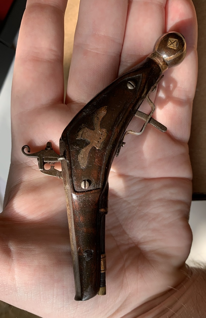

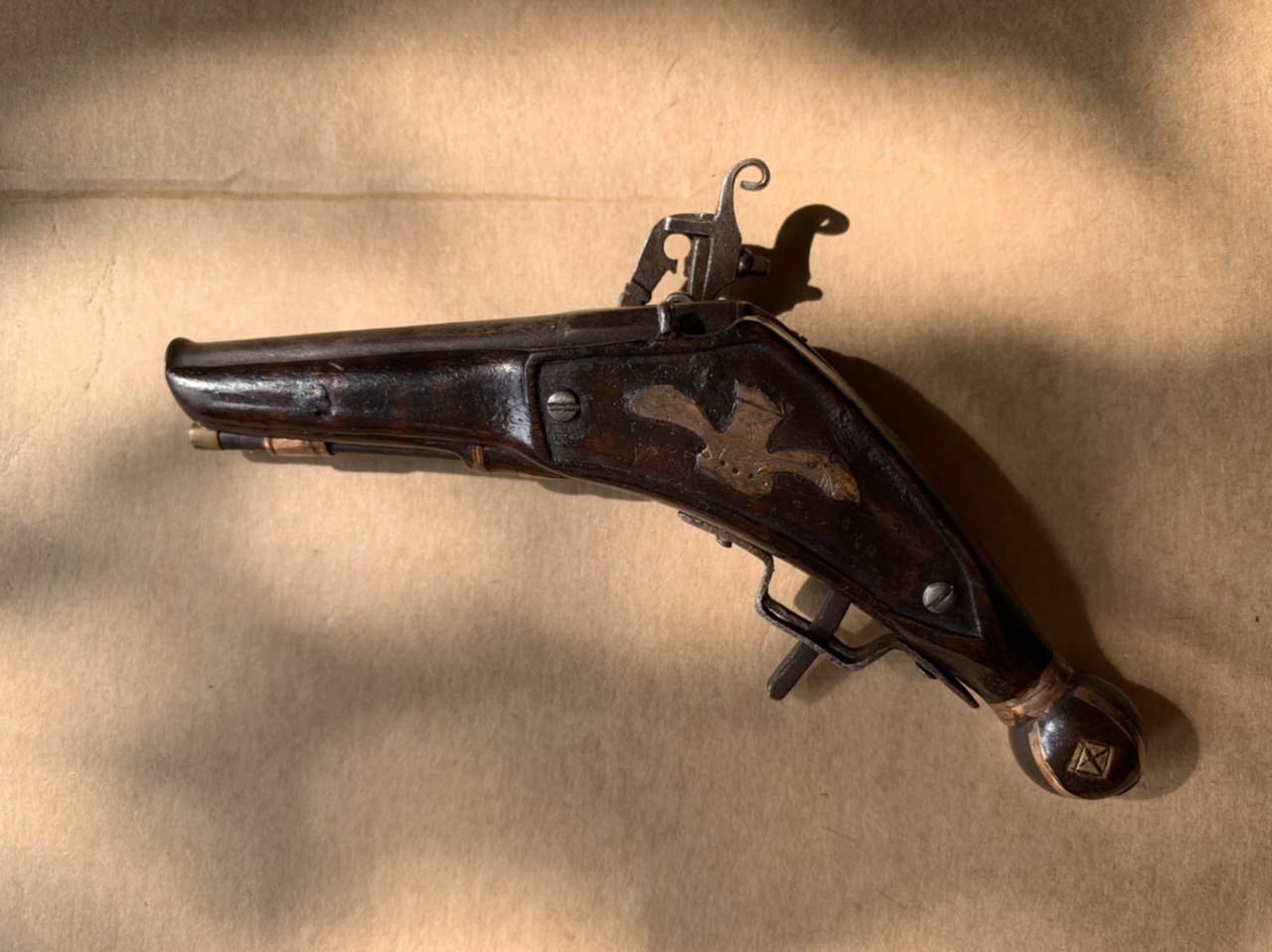

I’ve recently acquired what looks to be a period late 16th/ early 17th century ball butt miniature wheellock, it’s stock is made of burl walnut and I was just wondering what your opinions on it are as I’m not an expert and just wanted to know if you think it is authentic for the time period.

I know this miniature since a very long time and I would have bought it when I would have been sure that it is an original................

Precisely, the recommendation given by Corrado can be done with the screw that closes the jaws of the pyrite holder, or the lock can be separated from the box without damage. Precisely, the counterfeits are made by hand, and the screws (and other pieces) show irregularities made to deceive, You could take a picture of the inside of the lock, and we will have

Now that I look more closely, I see that the screw that closes the jaws is barely enough to keep these jaws closed, without pyrite. When taking a pyrite, its travel is not enough.

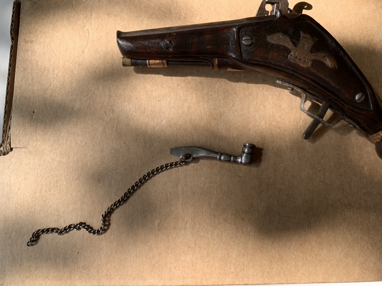

Here’s a picture of the screw that holds the dog in place

With the photo we do nothing, You have to use a thread gauge, to know if it is metric or whitwort and the diameter of the screw, and see if it matches any of the standardized types.

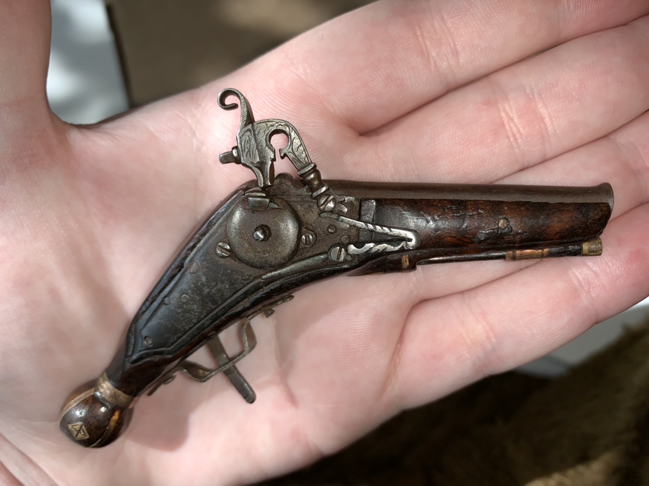

I would like to see a picture of the inside of the lock. I notice a series of screws on the plate, which do not correspond to the typical construction.

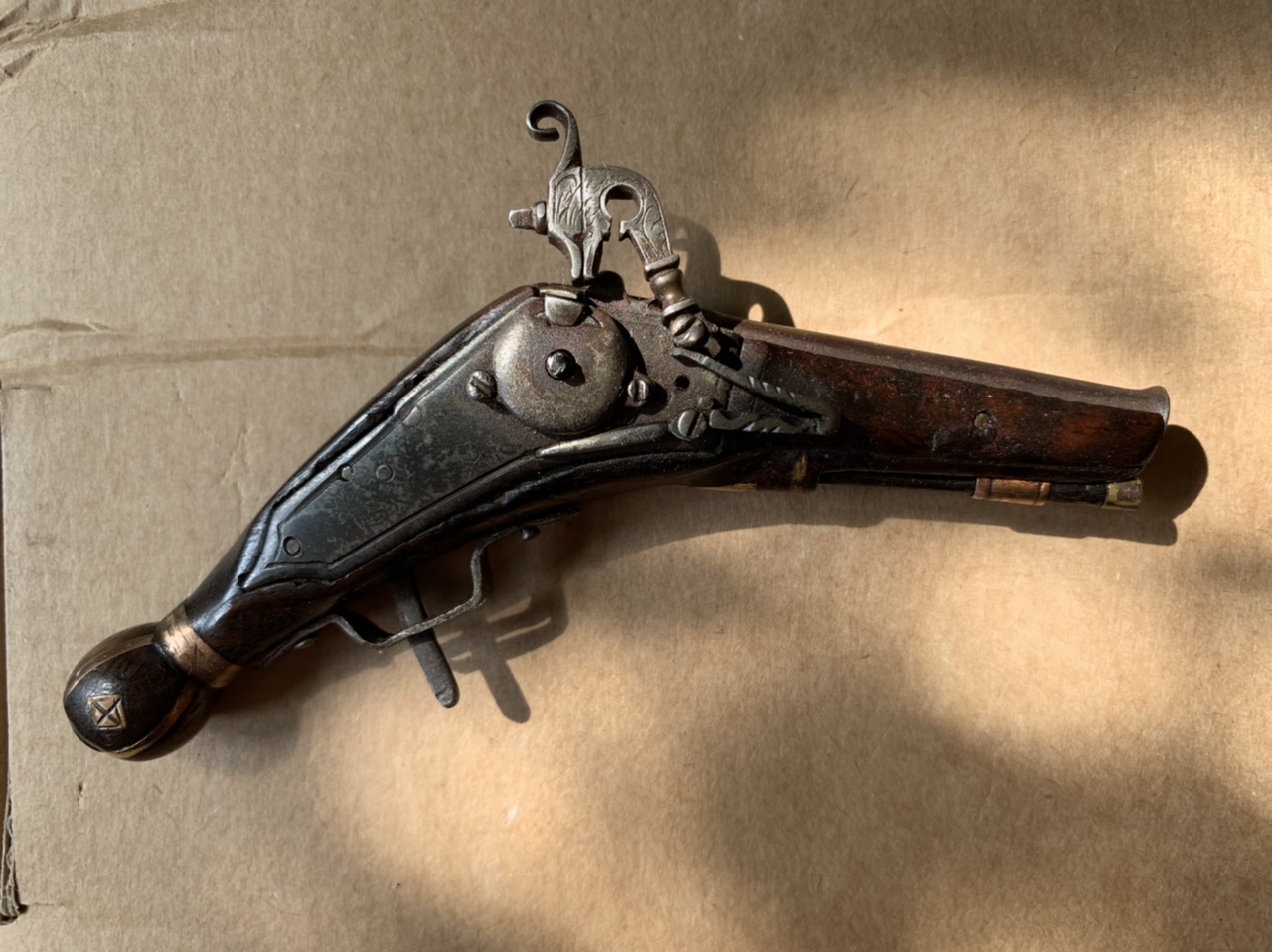

Here is the lock

It seems to be fully functional, although the pan lid lacks a spring that holds it in place, it has a single catch, when the bigger guys had two, and so the subject of the shot is different. It also differs in the fixing of some parts by forging and riveting., But it is very difficult to establish a manufacturing date, which must be done by comparing it with existing specimens.
