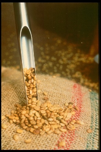

Rather
Rather's Avatar
Location: Hamburg, Germany
Posts: 72
Could ba a tool for sampling. Modern ones look like this:

This was my first thought, but sampling tools, old and new always ends with a tube so the sample (grains, beans, rice etc) will easily fall into your palm. In the tool above, the end is open and if it would have been used for sampling, the sample will spread all around.
