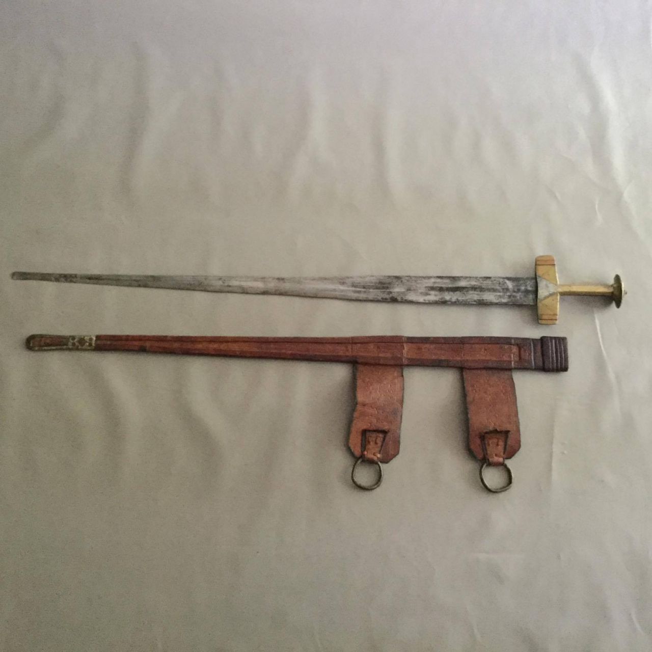

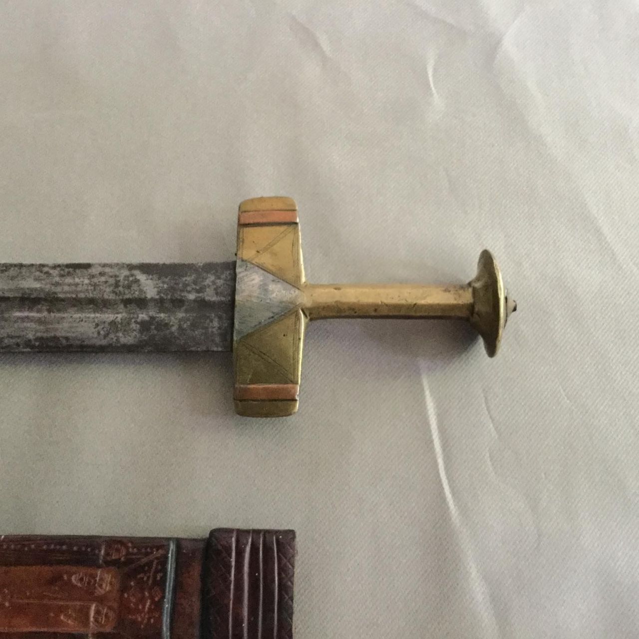

The second Takouba has what I believe a European military blade, and to what I have found of north Cameroon origin (Fulani). Strong, stiff blade, single edge and not so sharp. (photo g, h, i)

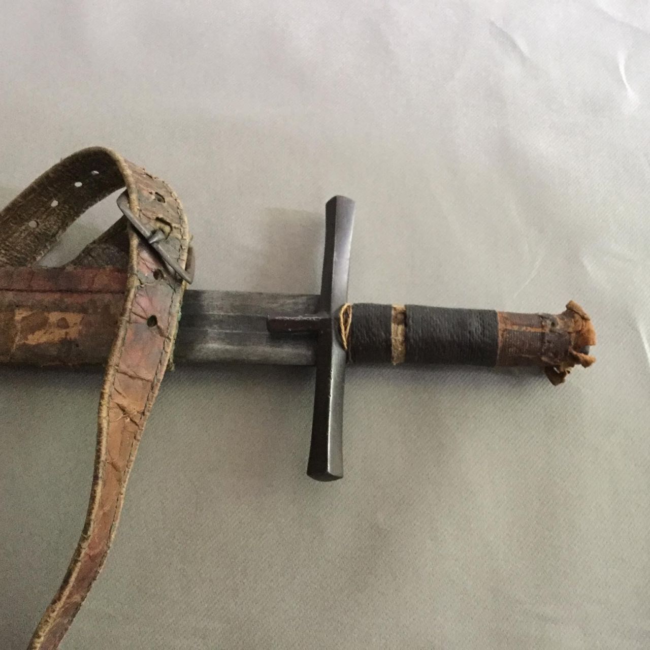

The Kaskara is my first one, stiff blade with some nicks in the edges (used in battle?), the disk pommel is missing and some of the handle wrapping in also missing. Cross gard is well made. (photo a, b, c)
The scabbard is odd and resemble a Takouba (97) in Ian Norman’s Takouba research society.
The scabbard has a small flare tip. The texture off the blade is somewhat different and the circle marking is
a bit strange as well.

Nice kaskara! a good sound example. Keep in mind these are typically not extremely old as far as the mounts, but often the blades can date into the latter 19th century. There was no widespread use of 'kaskara' until the Mahdist period of the 1880s-90s, and from there a degree of use mostly traditional wear. From the early 1900s there was nominal use only but it was not until about 1940s that production began again notable and in the Kasalla region .

The one with the brass hilt has a nice blade, albeit sharpened alot, it could even be an European trade blade, considering the regularity of the fuller (don't quote me on that though !). The hilt is really unusuam and, as is often the case, most likely later, though it does show some wear. My guess would be second quarter of the 20th century or slightly later. Indeed, I don't think aluminium was widly available in Africa before WWI, and this style (heavy brass base, with copper and aluminum, and triangular shapes), although I can't precisely pinpoint it, is very reminiscent in my opinion of what can be seen on modern decorative daggers and short swords from Niger (see post 4 here : http://www.vikingsword.com/vb/showth...ghlight=agadez), the chape of the sheath is also very reminiscent of what can be seen on some small knives from Agadez (see mine for example : http://www.vikingsword.com/vb/showthread.php?t=26194). Niger could thus be an option for the mounts, in my opinion; in anyway, that's a nice "modern" twist on a traditional design and I like it !

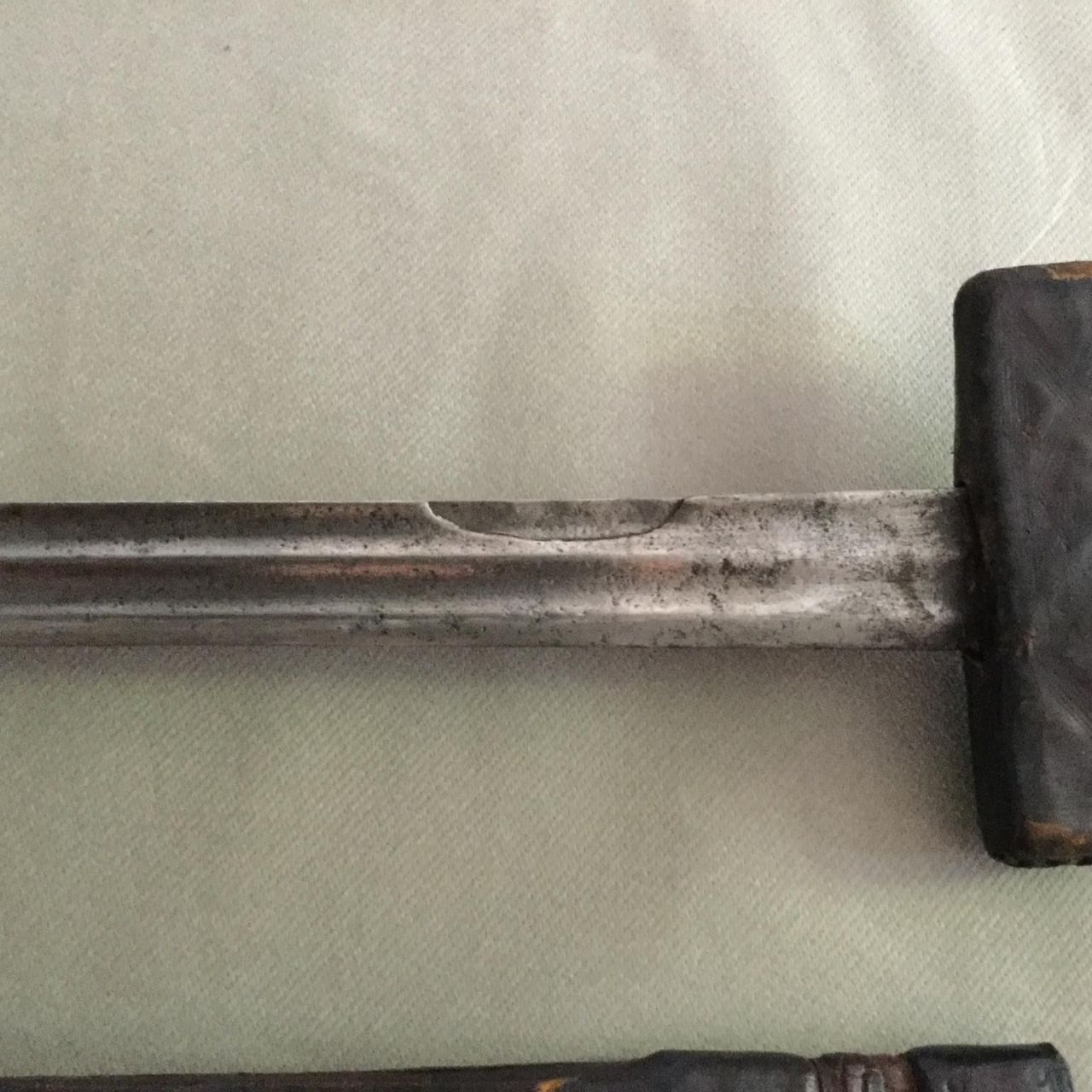

Finally, the single-edged, or Aljuinar as Jim rightfully pointed out, is indeed a textbook example of saber-like takouba that Iain Norman described as being from Nothern Cameroon. The blade on this one is really interesting, is the close-up you posted a repair ? Do you think it is forge welded ?

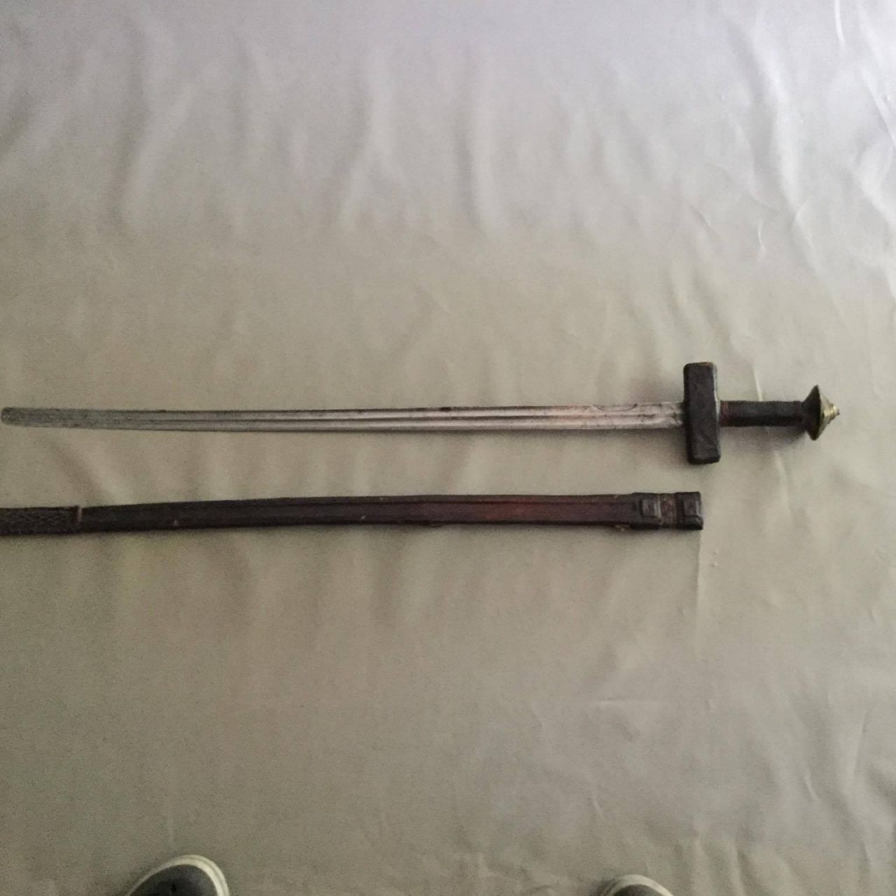

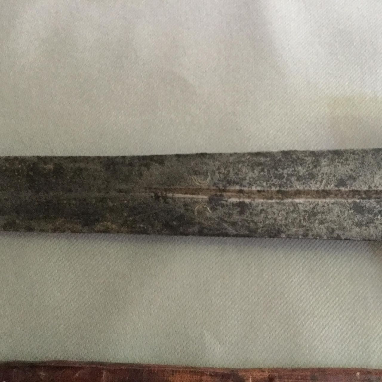

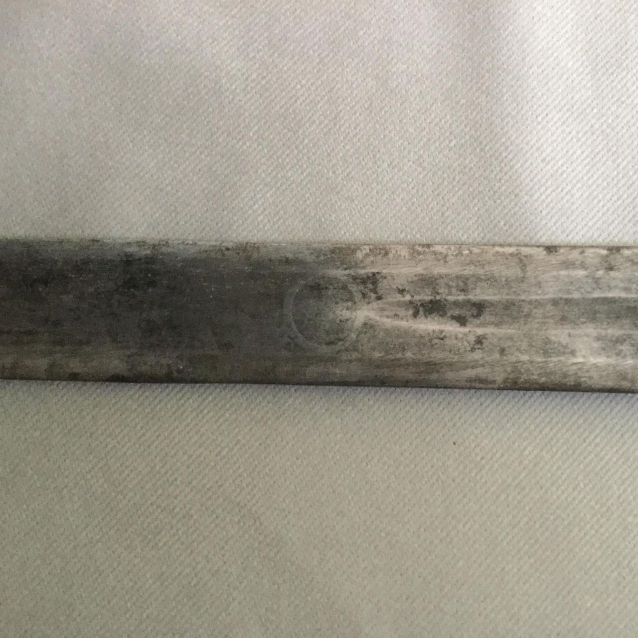

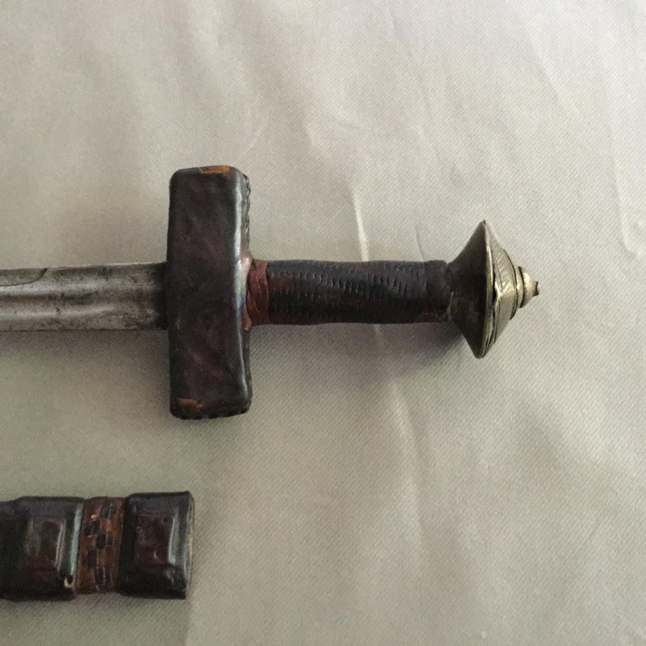

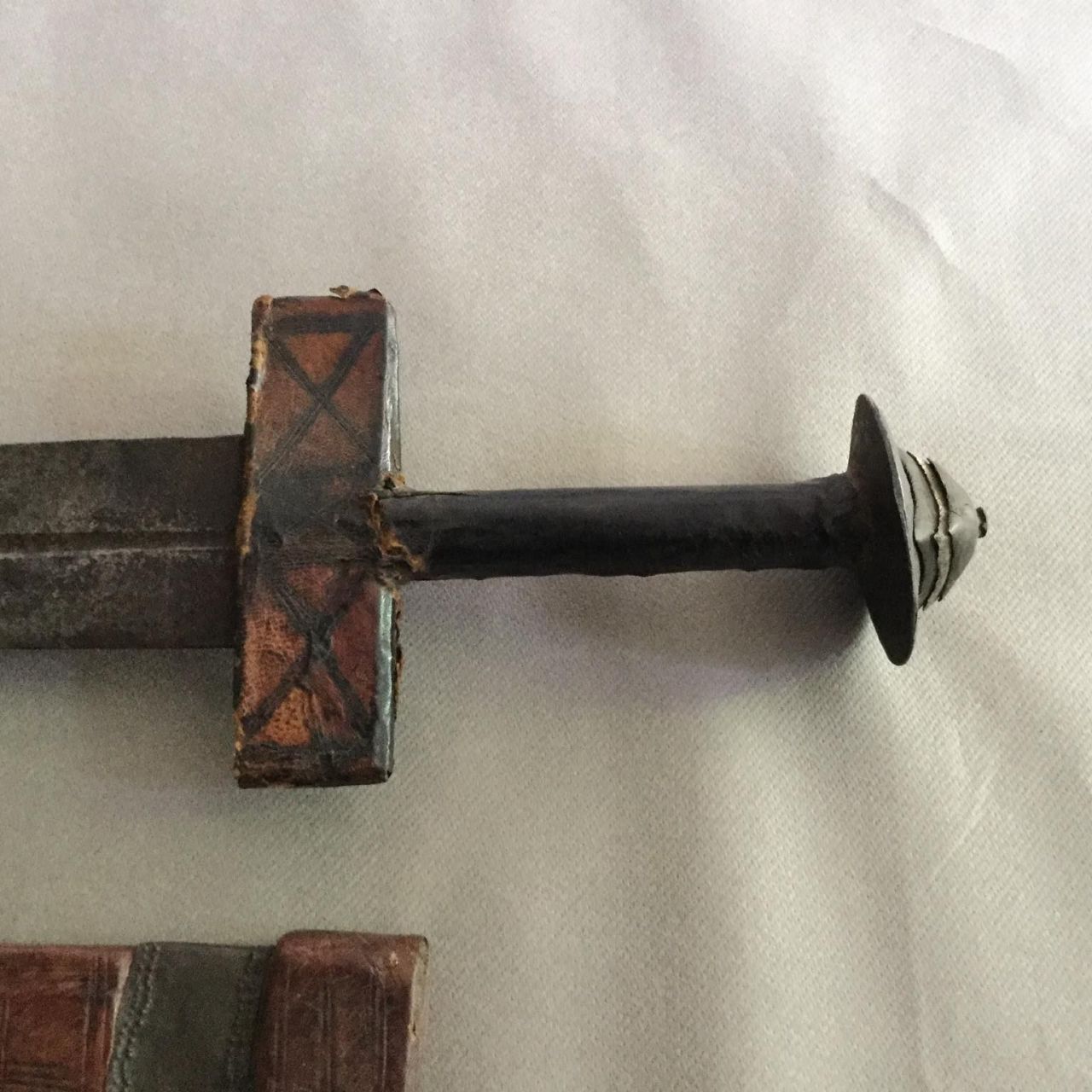

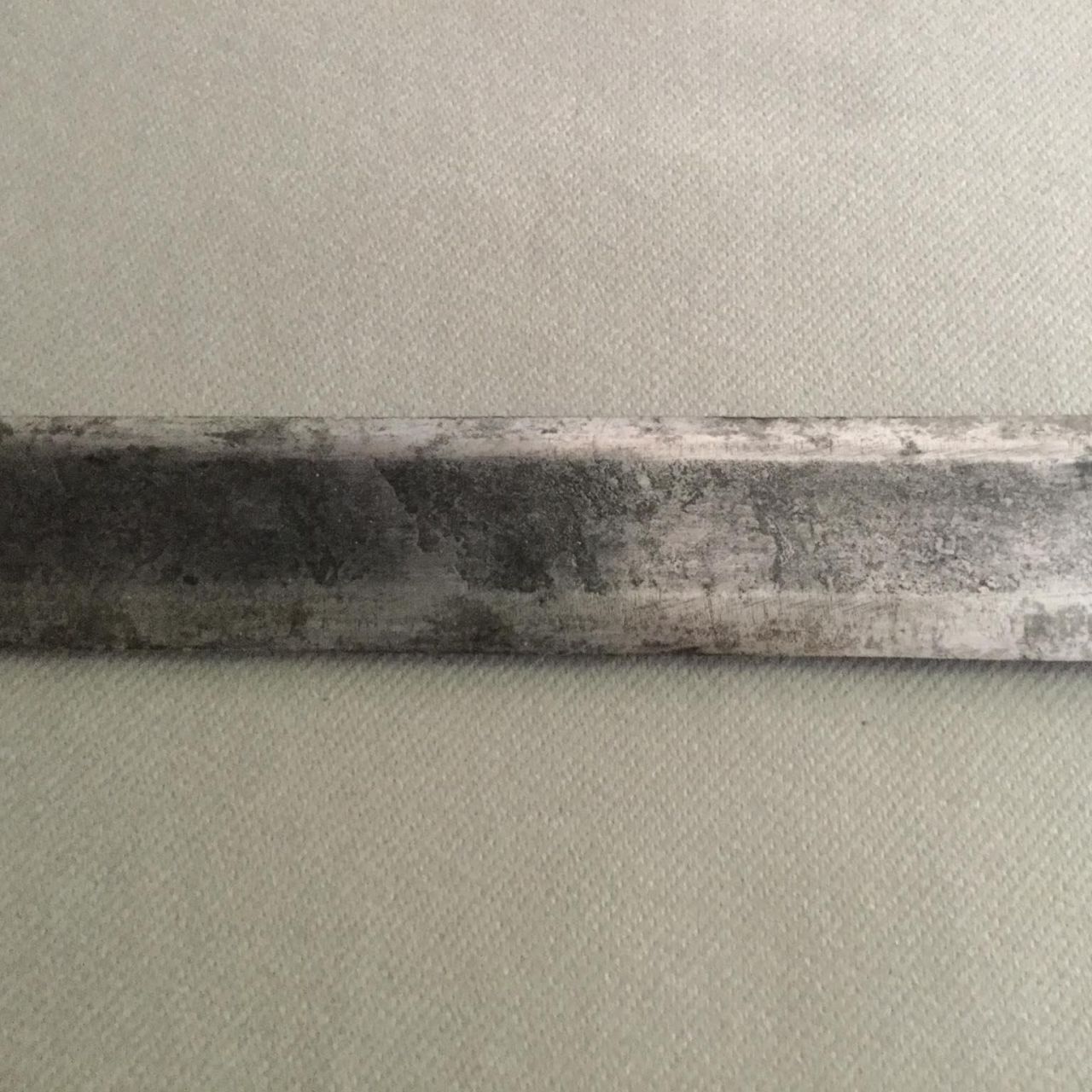

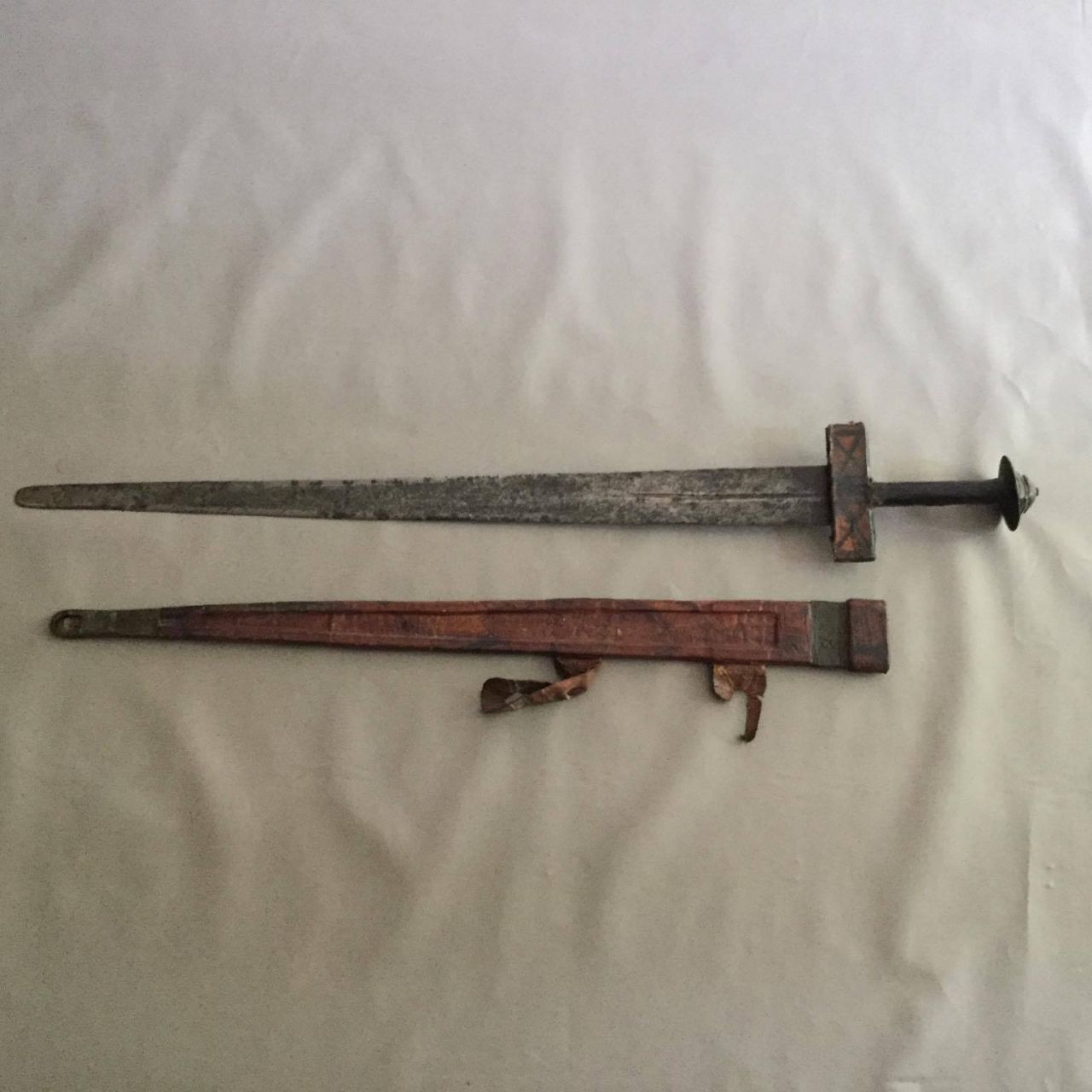

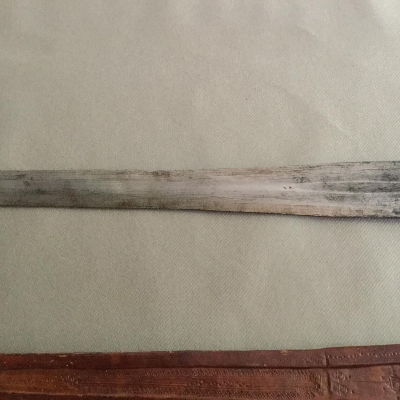

The first takouba i bought 15 Years ago. Its a low quality touareg sword, seems well used,traditionel handle and crossguard with classic decoration , the slighty oval stacked pommel made out off iron, brass and alluminium.
Native made blade with a short single fuller grinded in the blade. Two crudely made dukari on each side off the blade. The blade is shorter and thinner than my other takouba blades, verry flexable as well. The last 20 cm is sharpend,
showing the typical rough markings. The leather scabard has some decorations butt again off low quality.
Oal; 86,5 cm,sword lenght; 86 cm, blade lenght; 65 cm, blade wide; 5,3 cm,
thick; 2.5 mm from handle to tip.
Comments are verry mutch welcome.
Marc
