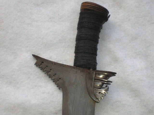

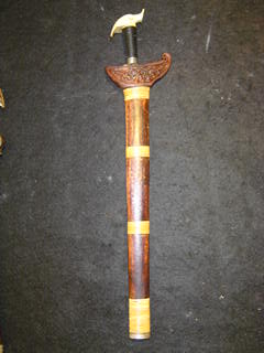

found a dealer that carry rattan strips, which is real nice and pliable. well, i had a kris handle that restored using twine, but i was wondering how it would look with rattan strips (there's one on cato's book). so here's the kris when i acquired it:
Old 5th June 2006, 10:04 PM   #2
Spunjer
Spunjer's Avatar
Posts: 1,730
the thread on the handle was very fragile and it was coming off, so i decided to redo it.

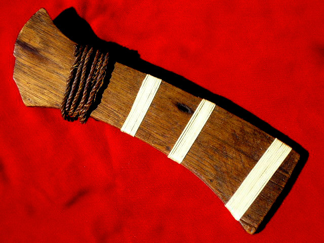

well, like i said, with this rattan strips, i think i can even make it look more bootyful. this is preliminary since i just wanna see how it looks. without stain, it looks pretty cool already. my question is, does anyone owns a kris with rattan strip handle and could you please kindly post it so i can see the patterns invlove? i think those type of kris handle is nort as common; either that or it came off a while back and rewrapped with cord instead. the rattan stripp handle on this type of kris i believe, matches better, IMHO...

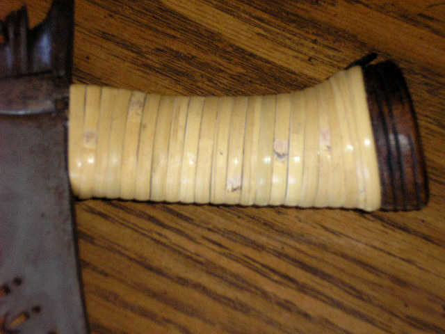

d're, two krises of mine w/ rattan strip handles. the kris w/ ball pommel has a thicker rattan strips(original wrap) while the ingraved kris has thinner strips. the ingraved krises hilt was missing a wrap exposing the iron clamp so i decided to do it my self /4th grade p.i practical arts comes handly (making broom sticks rattan rings). let me know if you needed the thinner rattan strips, i got lots of 'em.

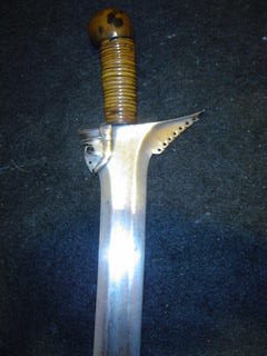

this scabbards had electric wire wraps on 'em, i had it replaced w/ rattan strips.

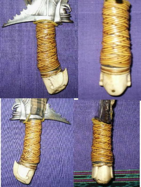

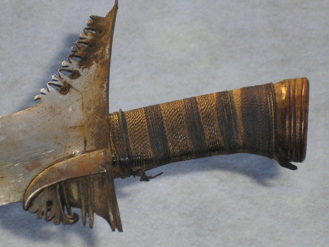

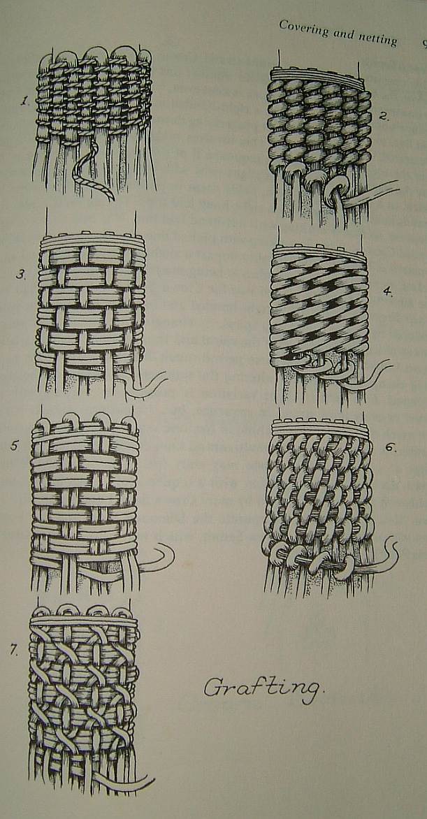

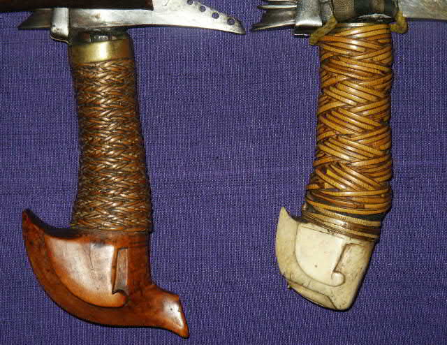

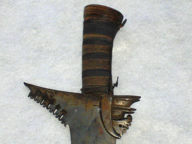

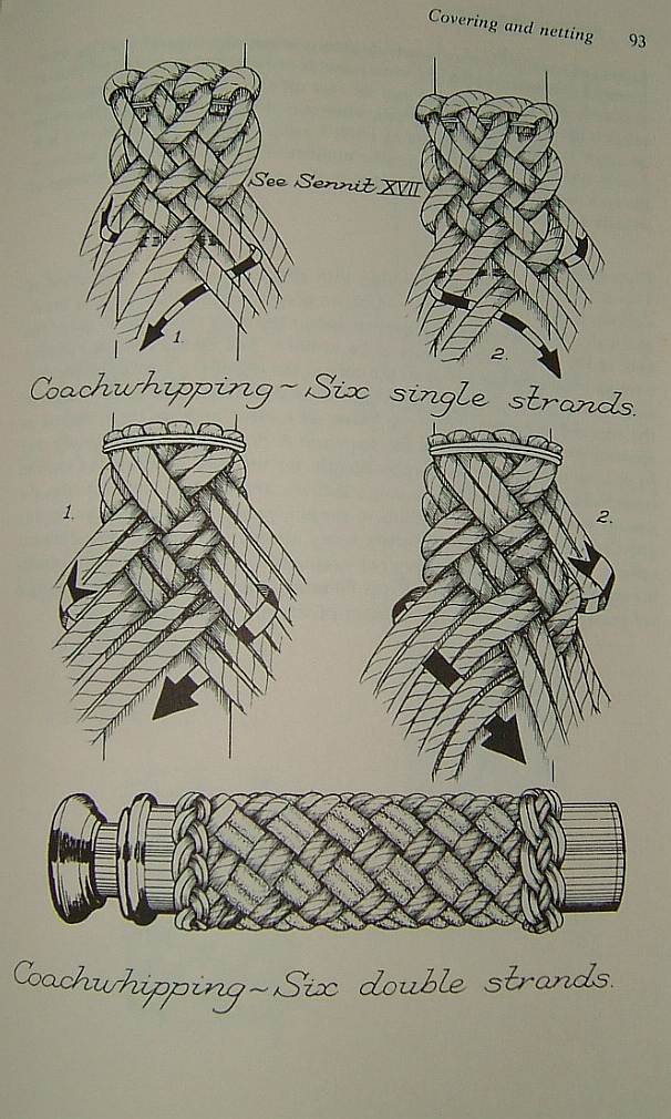

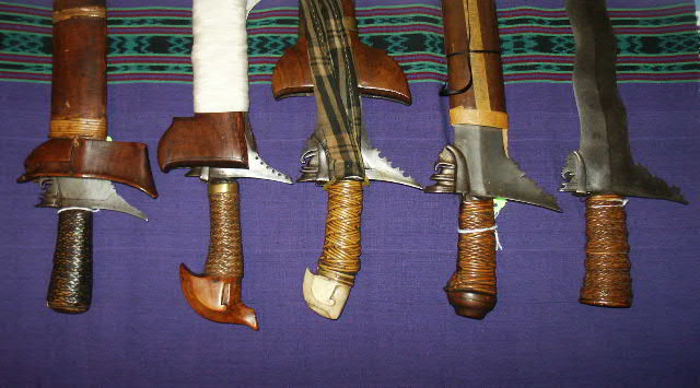

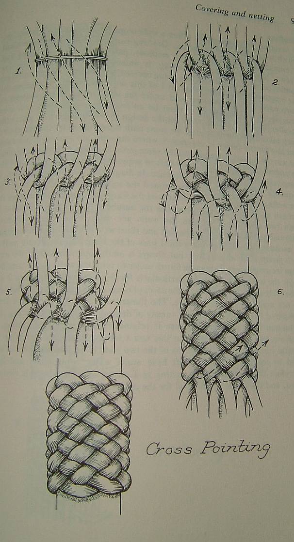

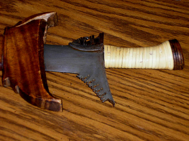

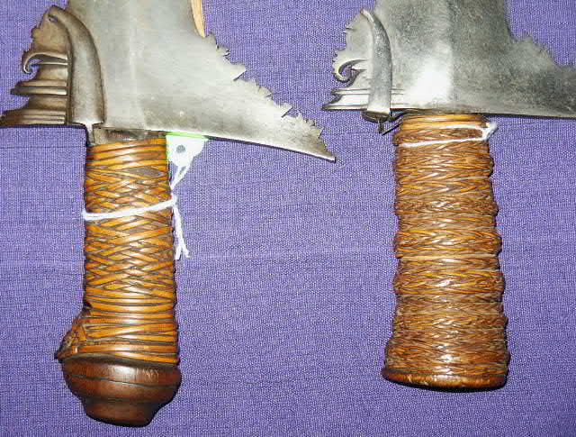

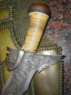

Spunger, Here are a few photos of rattan wrapped hilts. AFAIK, these are original to the swords. Each of them wrapped differently, all intricate. I have shown some wrapping to basket weavers, to see if they could copy it, I haven't found one that could, one came close. Good luck in your project.

Nice set, the double pattern is often found using wire brass, copper or silver.

kino,
thanks for the pics. i like the one with MOP(?) handle weave. that's what i've been thinking of doing...

kino,
would you mind posting both sides of the bone pommel miniature kakatua handle? just wanna see how it looks like on the other side. thanks in advance..

Spunger, I think the weave is, 2 sets of 3 strands of rattan(totaling 6), opposite each other. As they go around the hilt, one set goes up on one side the other goes down the opposite side, you need four sets of hands totaling 8. Don't get them tangled up (the hands), if it doesn't work try again. It's very easy, anyone can do it, except me.
