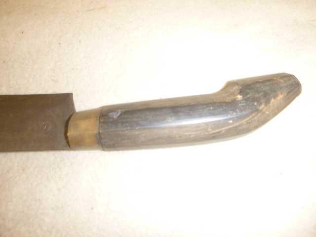

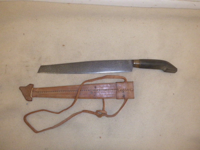

Hello All,
I don't have this one in hand yet, and thus the pics are from the seller. I usually wait to post new pieces until I have them in hand, but I realized tonight that the tooled design on the scabbard of this tabak matches, nearly exactly, the design on a matulis I have from Apalit. The hilt shape also looks distinctly like others I know from Apalit. I suspect this then is also from Apalit Perhaps even the same maker.
The matulis in question is the first (and longest) one here.
http://www.vikingsword.com/vb/showthread.php?t=22118
I'll post more pics when I have it in hand.
If I had to guess, I might place this at early 20th century?
What do people think?
Have fun,
Leif

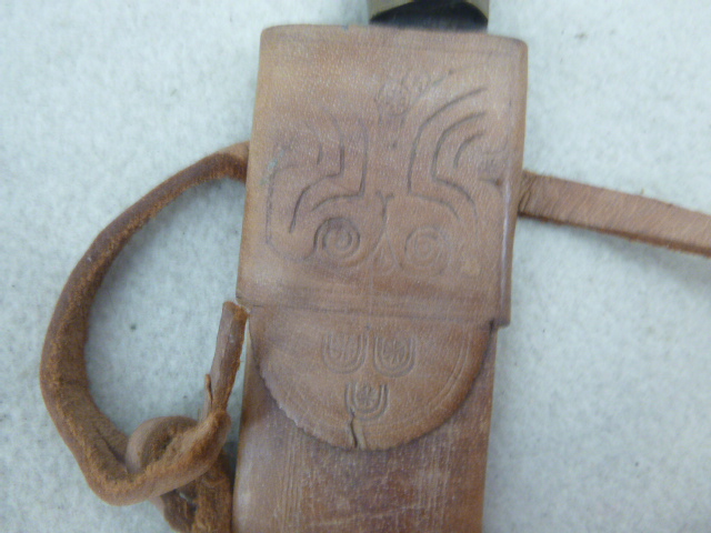

And for comparison, the design on the previously posted Matulis

Hi Leif,
agree with nearly all your observations but I think that the scabbard is much younger as the tabak.
The knife byself I would place between the 1920s until 1940s but the scabbard looks much younger. Courious to see your pictures.

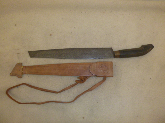

Do you think the scabbard is significantly younger in both cases?

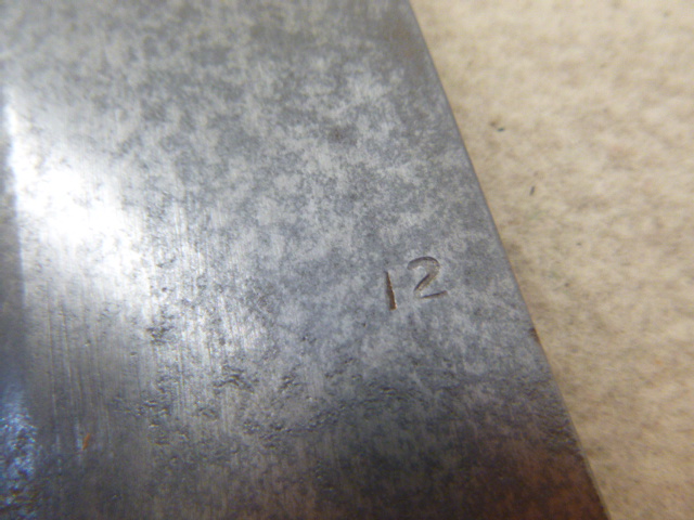

So it arrived today! Quick shipping. These are after a bit of light cleaning with soap, water, and for the brass ferrule, lemon juice and salt.
Both the Blade and the scabbard are marked with the number "12." One side of the blade as what might have been intended to say "Apalit EB," but the stamp is unclear. I'm including side by side comparison of the tooled patterns on the tooled leather scabbard. They're nearly identical. The rear side of the scabbard shows similar construction.
Also, does anyone have any thoughts on caring for the leather? It's rather "dry" at present.
No, you are correct, I think the tabak is complete (sword & scabbard) younger as the other sword.
I use shoe polish for leather scabbards, it works great for me.

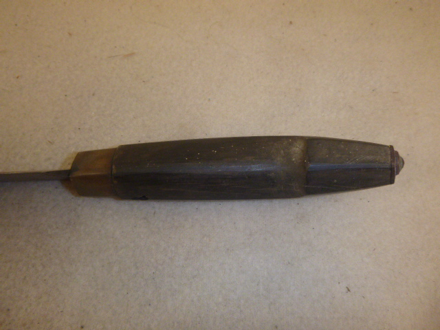

Carved carabao horn in the shape of a human figural head with hat/cap. Hilt with octagonal brass ferrule and cap with peened tang construction.
Blade :
Long clipped tipped blade. Typical blade shape used by Katipuneros.
