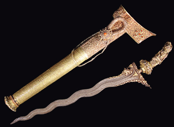

This sale (Czerny's auction N° 96) took place on Friday 13th December and many interesting krisses were auctioned. The most striking one was this very nice replica royal kris from Sulawesi or Sumbawa which fetched 22,000 Euros! it supposedly dates from end 19th/ beginning 20th century, and the dress is made from gilt metal (silver?). What do you think?

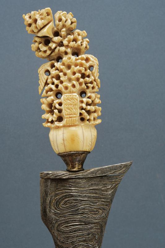

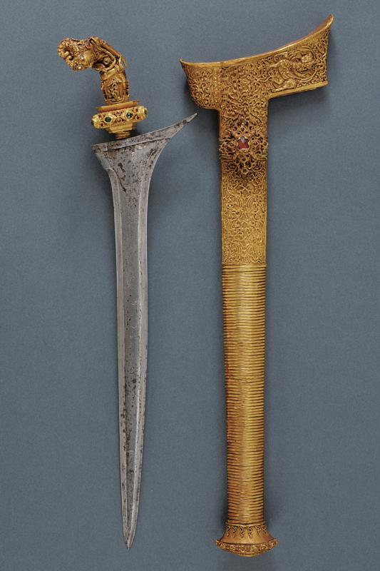

The loop is missing? Somehow the blade does not seem to be a good match with the dress? Just a feeling.

A royal kris may not need a loop (passio sumange or toli-toli) since I was told that it is supposedly made to secure the blade in front of the king?
Yes, the blade looks old but is not of matching quality with the dress.

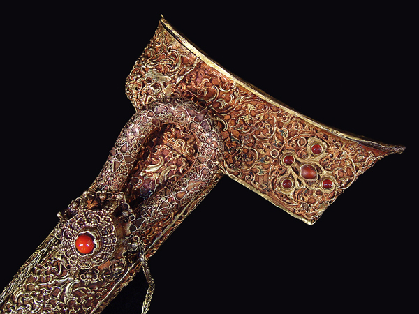

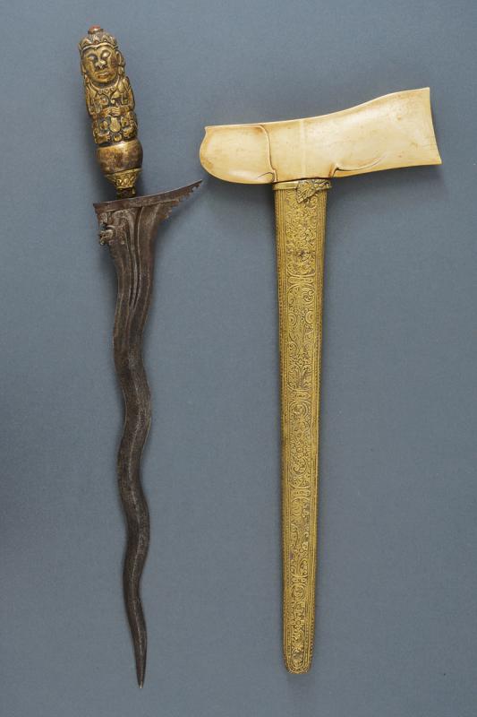

Examples of similar royal Bima krisses with more elegant blades. All with loops.

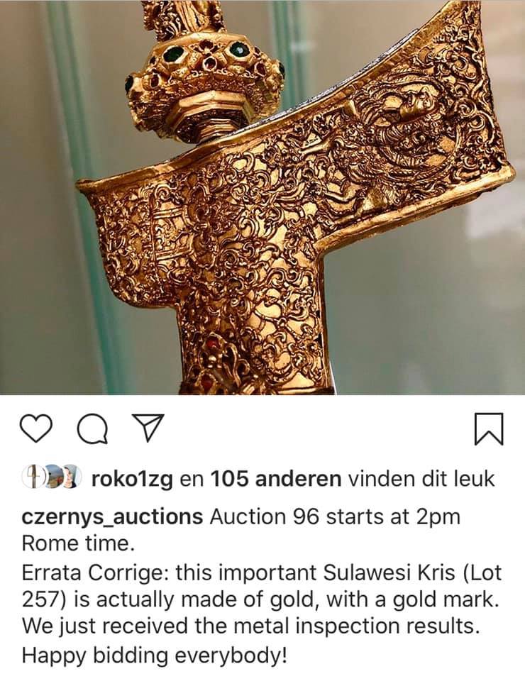

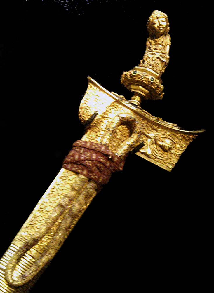

I had debated posting about this one for a few days. We have been having a rousing discussion about it on one particular Facebook page.
I have a lot of questions about this replica dress. Who was it actually created for in the first place? If they were creating a replica (and it is a rather nicely crafted one) why not create it with a blade that more closely represents this form. AFAIK this dress generally clothed a Javanese blade. As i have heard it and as related by the auction description, these keris were originally presentation keris to vassal states form the end of the Mojopahit and most often contain Javanese blades. I don't think it is so much a matter of this blade not matching the quality of the dress as much as not matching the original style such dress generally held.
While i do think this particular keris looks nice i did question the great sum it attracted. Keep in mind that the buyer also had to pay a 25% fee to the auction house, so when all was said and done the buyer actually paid over $30,000usd for this keris. That is quite a sum for a replica. There did seem to be many bad descriptions throughout the Czerny catalog and as far as i have heard many pieces when for much lower prices than they should have because of that. But the missing piece of information on this particular item was that auction house sent out a last minute message about it (see attached below). While the catalog description used the term "gilded yellow metal" a couple of times to describe the dress apparently they discovered at the last minute that the whole thing was actually gold. I don't know how such information alluded them to begin with, but the high price was probably driven by this last minute announcement. Of course the question i would still raise is "how much weight and what carat gold"??? Was the actual material value really enough to deserve such a price tag? The photos provided were not so great, but i still have doubts that any of the "gemstones" were real. The auction house only called them "red, white and green stones".

Regarding the replica kris and based on the available pics only (so not reliable) I have my doubts that the dress is made from pure gold as the base metal (silver or brass) is visible on the surface of the hilt especially. I am not a specialist of metal analysis but can a standard gold test kit distinguish between pure gold and thick gold plating/ gilding?
Also I believe that IFICAH and Czerny's would have checked this critical issue before posting this "high" kris.

If this is true Jean then i would say that Czerny is guilty of fraud and should be prosecuted.

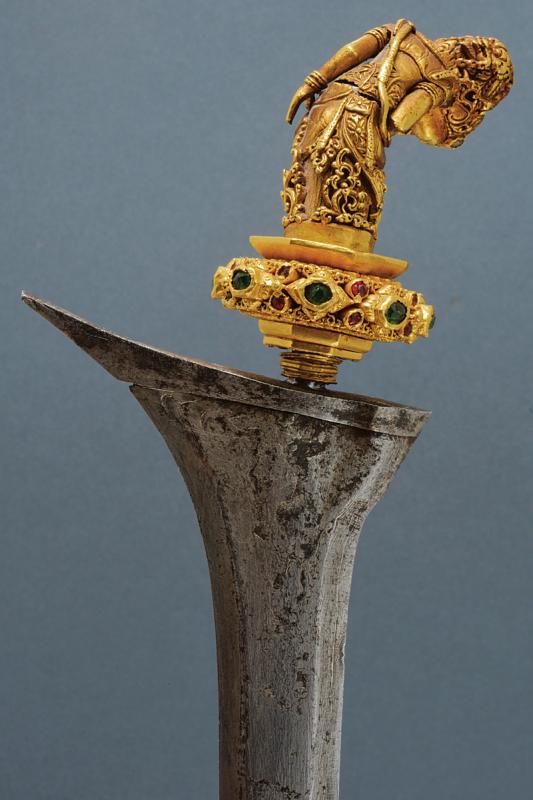

Jean, did you notice the damage at the back waist of the hilt figure. The gold foil is cracked all the way across. It was only just pointed out to me.
David is online now   Reply With Quote
These hilts on resin are very fragile, I had one broken during transport but fortunately it was nicely repaired by an Indian jeweler.

Imagine bidding, winning and paying 30000 Euro for a keris covered in solid gold, then find out is only gold plated...

To be clear Marius, the bidders final cost were more likely just a bit over $30,000 USD, not euros. I generally don't like spending too much time talking about money on this forum. I think people were all just scratching their heads a bit at first because the catalog description of this keris was very cautious, calling the materials only "yellow metal" that had been gilded. But if you noted my post #8, Czerny Auctions made a last minute announce on this keris claiming that the metal had tested as gold. I must say that at this point it seems unlikely that the dress is only gilded at this point. There would be legal ramifications for such a deception and they are a long standing and respected auction house.
What i would rather steer this conversation towards is the Auction House's claim that this is an "Important" keris. They stress this word "important" in the catalog description as well as their last minute social media update about gold content.
Given that is is a replica made at a date far removed from when keris in this original gold dress had some legitimate cultural meaning do members here also see this keris as being "important" in the world of keris and/or keris collecting? If so, why? Who would such elaborate replica dress have been made for at the start of the 20th century, especially assuming it is in fact solid gold? What function would it have served?
This last minute announcement that the metal of the scabbard and hilt was tested as solid gold does not look professional in my view. For instance I was not informed about it although I placed many bids in this auction (but not for this piece of course ). Czerny's should have corrected or removed the ad.
Just for reference, one collector whom I know claimed against Czerny's because the description of the received item was not as described and Czerny's replied: "OK, we will give you a (small) discount on the price of your next purchase". Of course the prejudice was much smaller than potenrtially in this case....
