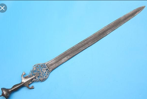

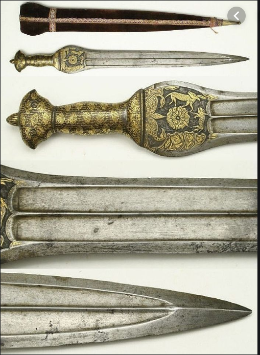

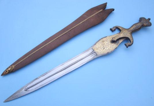

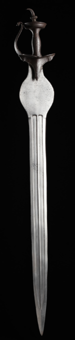

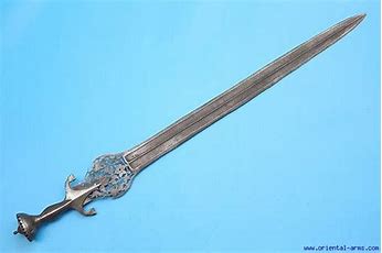

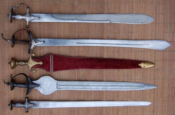

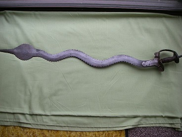

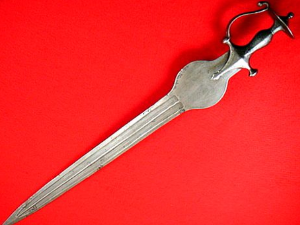

On pp. 109-10 and 121, 123 Elgood shows peculiar S. Indian swords with disk-like widening of the blade by the handle.
They are popularly called " cobra swords" by the Westerners, even though they have nothing to do with the snake: the widened disk is a representation of Chakra, a weapon of Shiva.

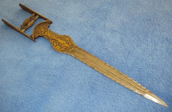

Also, I am showing a S. Indian katar with identical feaure, confirming the S. Indian origin.
However, similar blades are found in the NW India, the so-called Pahari Kingdoms, established by the Hindu Rajputs escaping Muslim control over them.
Many of them carry typical Afghani Pulwar handles, and are usually defined as Indo-Afghani swords. However, some carry very "Indian" handles, without cup-like pommels and down-turned quillons and some have a mix of both features.
Any idea re. several questions:
1. Can the S. Indian and NW Indian examples be separated based on the configuration of their handles?
2. Could some of S. Indian examples have replacement handles, ? Among the examples I show there are " pulwar", " tulwar" and likely "Deccani" ones?

Very interesting topic!
What strikes me at these swords is the unmistakenly Indian construction of the blade (with chiseled central ridge and reinforced edges).
Old 22nd November 2019, 08:56 PM   #7
Marius,
You are absolutely correct: the blades are unmistakeably S. Indian.
This strengthens the argument that the handles were a later modification.
So, should we stop calling them Indo-Afghani?
Probably not: the modifications on many of them were of Afghani styles. By the same logic, Persian and purely Indian blades are in fact “( Something)- Afghani”, we just need to look separately on different components of a given sword.
I may show some swords that, in my estimation are purely Afghani based on both handle and blade.
Handles are simple: pulwar-like are unmistakeable.
Can we start describing features of a genuinely Afghani blade?
Let’s open the floodgates! Go on!

It is very easy to attach a word “Afghani” to a bladed weapon when it has typical “pulwar” handle.
But if Elgood is right and there was a “ marriage of convenience” we may need to sit down and start thinking anew.
Look at the series of pics shown by me: there are examples of Tulwar handle, modified basket handle ( Deccan?), unquestionable Pulwar and a modified Pulwar with downturned quillons but with an original S. Indian pommel.
With this variety of handles how certain are we in our blanket definition as “ Indo-Afghani”?

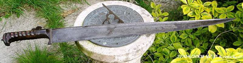

What is this?
Is it a Nepalese kukri?
Is it an Indian tulwar?
Is it Nepalo-Indian?
Is it Indo-Nepalese?
I simply believe it is a "kukri with a tulwar hilt."
Simple and clear.
And the same logic applies for the "cobra swords" in question.
Old 23rd November 2019, 02:55 PM   #12
It is indeed a "khukuri with a tulwar hilt". It has a cho (aka kaudi).

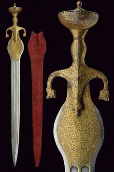

In the very theme of this discussion, the 'cobra' term applied to the distinctive enlarged forte at the root of these blades is a 'western' appellation suggesting a nagan symbolism in the sword type.
We know however that the typically disc shape is most probably representing the chakra, and these originate in the Hindu Pantheon with symbolism regarding Vishnu. That this symbolic feature is just that, and has no pragmatic purpose in the blade function can be seen for example with the khanda pictured with undulating blade and the 'chakra' toward the tip of the serrated blade.
In this case, it might be argued that the position in this case would serve as a weight to add impetus to a slashing blow, such as with the yelman on sabers, but the strong symbolic nature of the feature seems otherwise paramount.
The fact that there was considerable Afghan influence in the Deccan which led to the considerable cultural exchanges between these disparate regions can be explained by the Pathan communities such as Kurnool, Cuddapah and Savanur situated in Deccani areas.
It has often been suggested that the elements of the paluoar hilt are from Deccani influences, but that too is of course contested despite the compelling similarities in comparisons.
The blades on these 'cobra' swords are also a talking point here beyond the 'chakra', with the deeply chiseled channels often seen. Look at the blades on the Afghan military swords of latter 19th c. which have what seems similar deep channels recalling 'atavistically' early Vijayanagara blades.
The hilts of course are interestingly combined features of what recalls British military bayonets in styling, combined with the 'swan neck' type hilts of many northwest guards on tulwars . These open piercing of the bars on the knuckleguard are also seen on paluoar hilts in many cases.

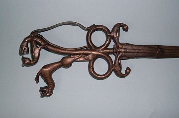

Also the image of the addorsed zoomorphic figures hilt is of course the same as on one of these 'cobra swords'.

Ariel, the first sword you show seem to have a lotus decoration on the hilt, and the lines would represent water. The strange thing is, that the pommmeel also seem to be a lotus flower together with the missing quillons- this I have never seen such a pommel before.

In the original post, it was asked, (1) if southern and northwest examples of these distinctive 'chakra disc' type blades could be separated by the hilts mounted on them.
(2) it was asked if the South Indian examples could have 'replacement' hilts.
If I am understanding correctly, the objective is to determine the regional place of origin of these blades as a type, and if they indeed became used as far north as Afghanistan, given the oft appearance of the paluoar hilts on them.
It seems to me that the incorporation of the disc is agreed to be a religiously inspired element from the Hindu 'chakra', and that it is indeed placed symbolically is further indicated in the unusual placement toward tip instead of forte of the blade on the khanda illustrated.
The blades seem to be typically deeply fullered or channeled in the manner of earlier Vijayanagara types, and with the chakra feature added.
These factors considered lead me to believe the origins of this style of blade to be effectively a southern convention, and that the use of the disc element may have evolved from similar blade 'widenings' of perhaps earlier forms.
It is clear that there have been atavistic adoptions of diverse blade forms from iconographic sources in southern India for some time, and as well noted by Jens, these styles often, if not typically moved northward in the regions of the subcontinent.
Whatever the case, it would be difficult to try to assess the regional provenance of an example with this type blade simply by the hilt it bears given the obvious disparity of the hilts seen on them. That being the case is directly in line with question (2), the replacement of handles on these type blades, which is well known in India with the propensity for refurbishing weapons.
It is well established that blades were a widely traded and exchanged commodity, whose often long working lives in many cases resulted in rehilting with favored local styles and upgraded fashions.
In the case of the paluoar hilted versions, it seems these were likely to have been syncretically joined in regions of the Deccan and northward as suggested in Elgood in accord with the Pathan element from Afghanistan.
As far as I have known, these distinctive blades are not known in Afghanistan regionally, while obviously the paluoar hilt style found its way southerly into the Pathan enclaves described.
In the cases of these type blades with tulwar; khanda or other hilts, including the curious case of the katar, it would appear mounting again to local favor.
If I recall, it seems that the katar with this feature was even suggested at some point for possible origin of the blade style, unsure on that one.
