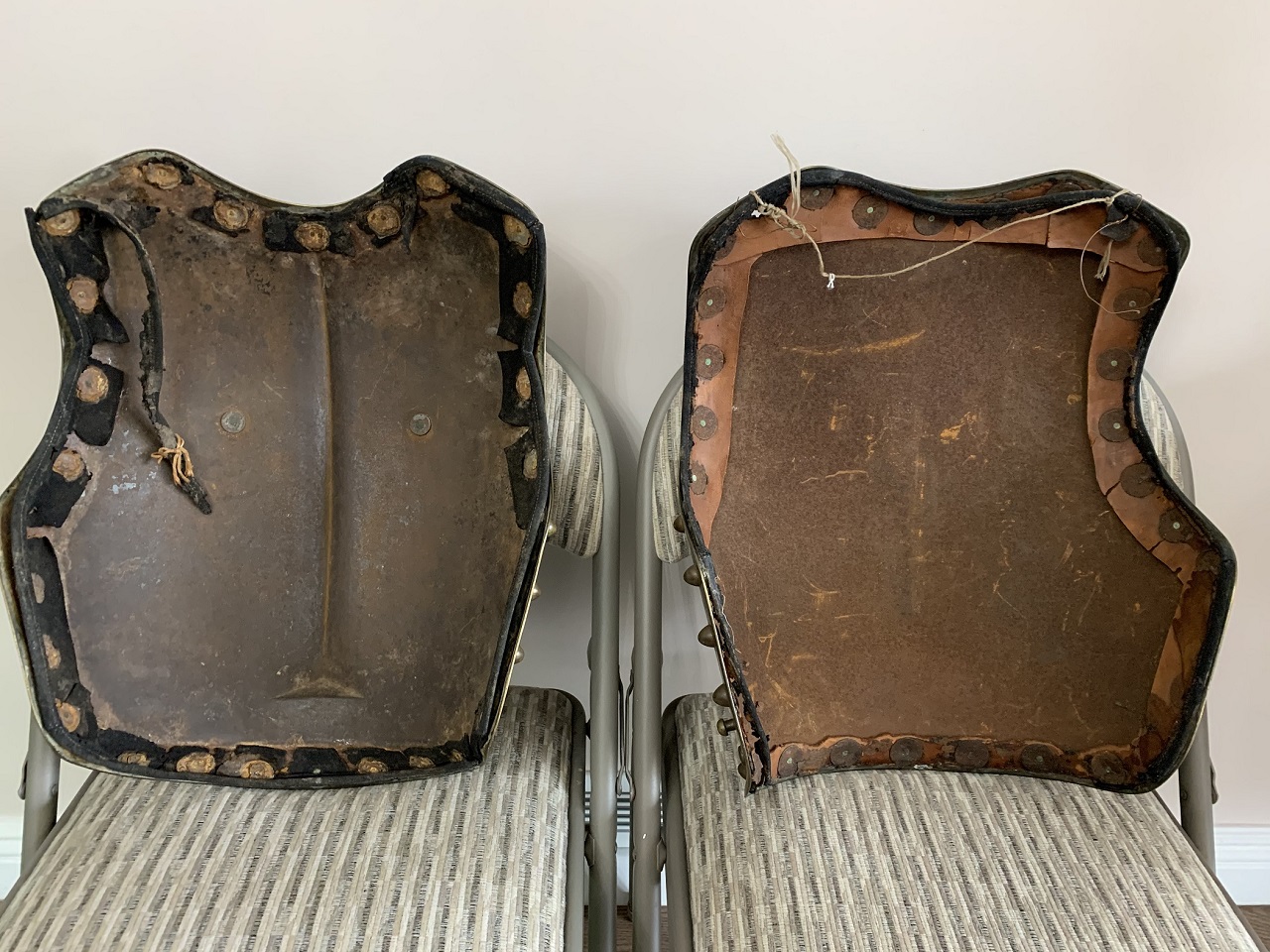

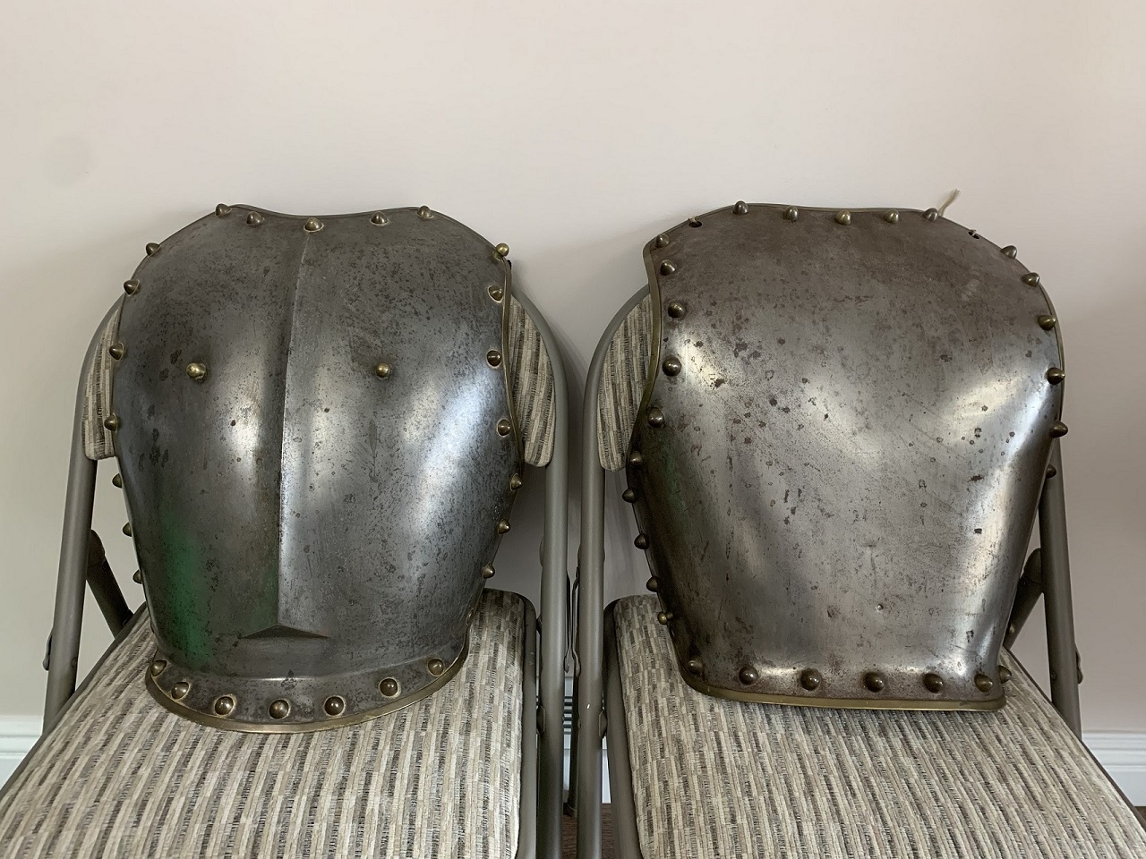

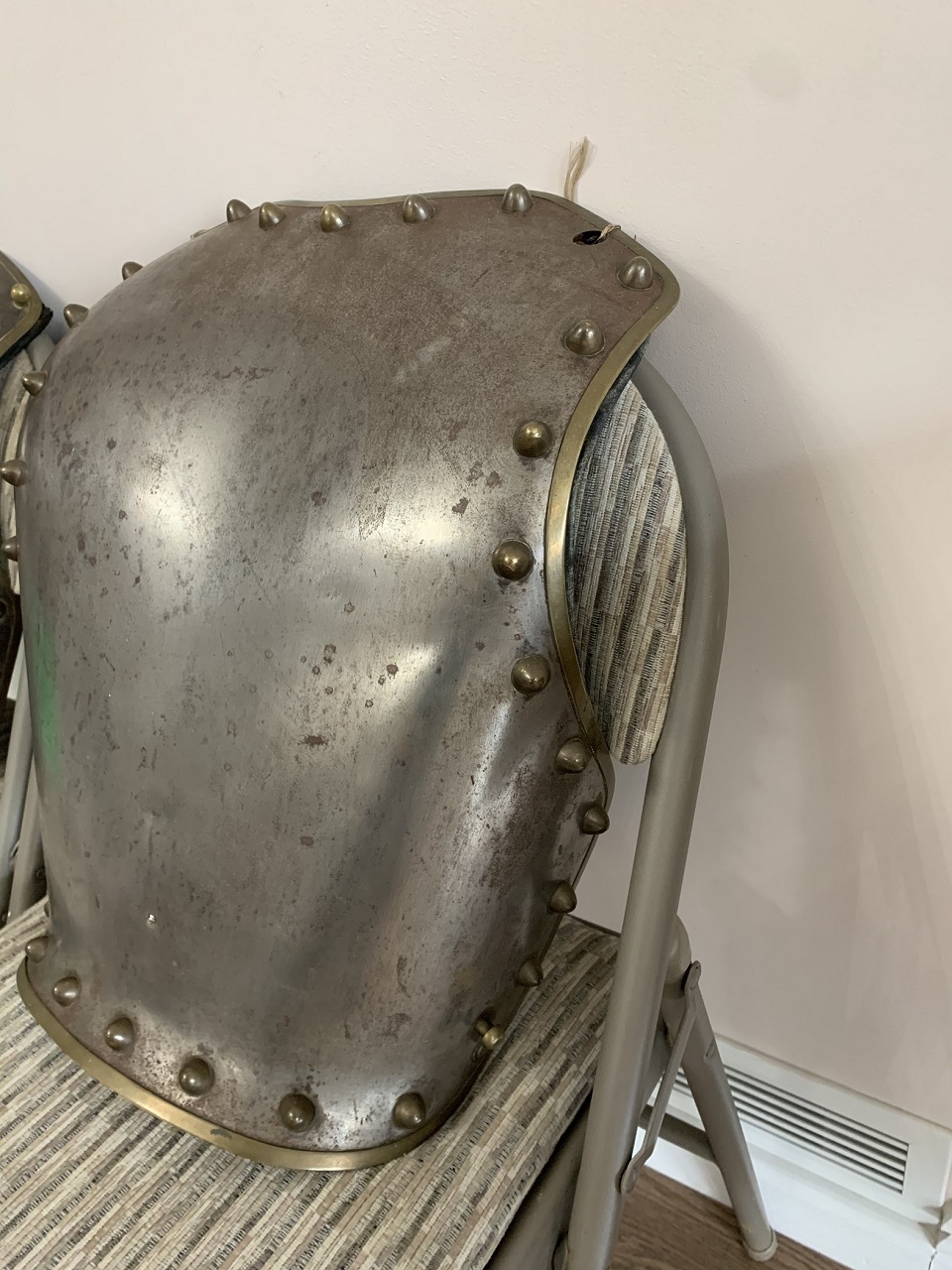

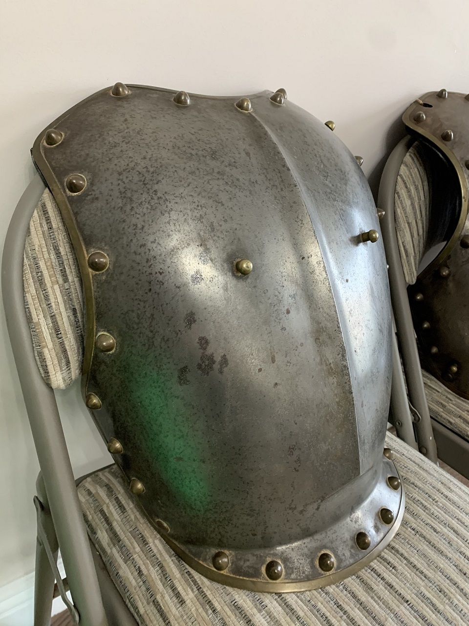

I have recently acquired European Breast and Back Plate. The seller was not positively sure what region this item is from. Judging by the it’s condition he assumed that it dates back from late 18C to 1st quarter 19C .
As far as I knows this piece is heavy cavalry (Cuirassier) armor and it may very well be from late 18C to 1st quarter 19C . However, much of European countries were making heavy cavalry armor which were similar in design and some of these armors were used/produced up until 20th century. I thought that the markings located on the armor would narrow down my search, but I was unsuccessful to find them in my database.

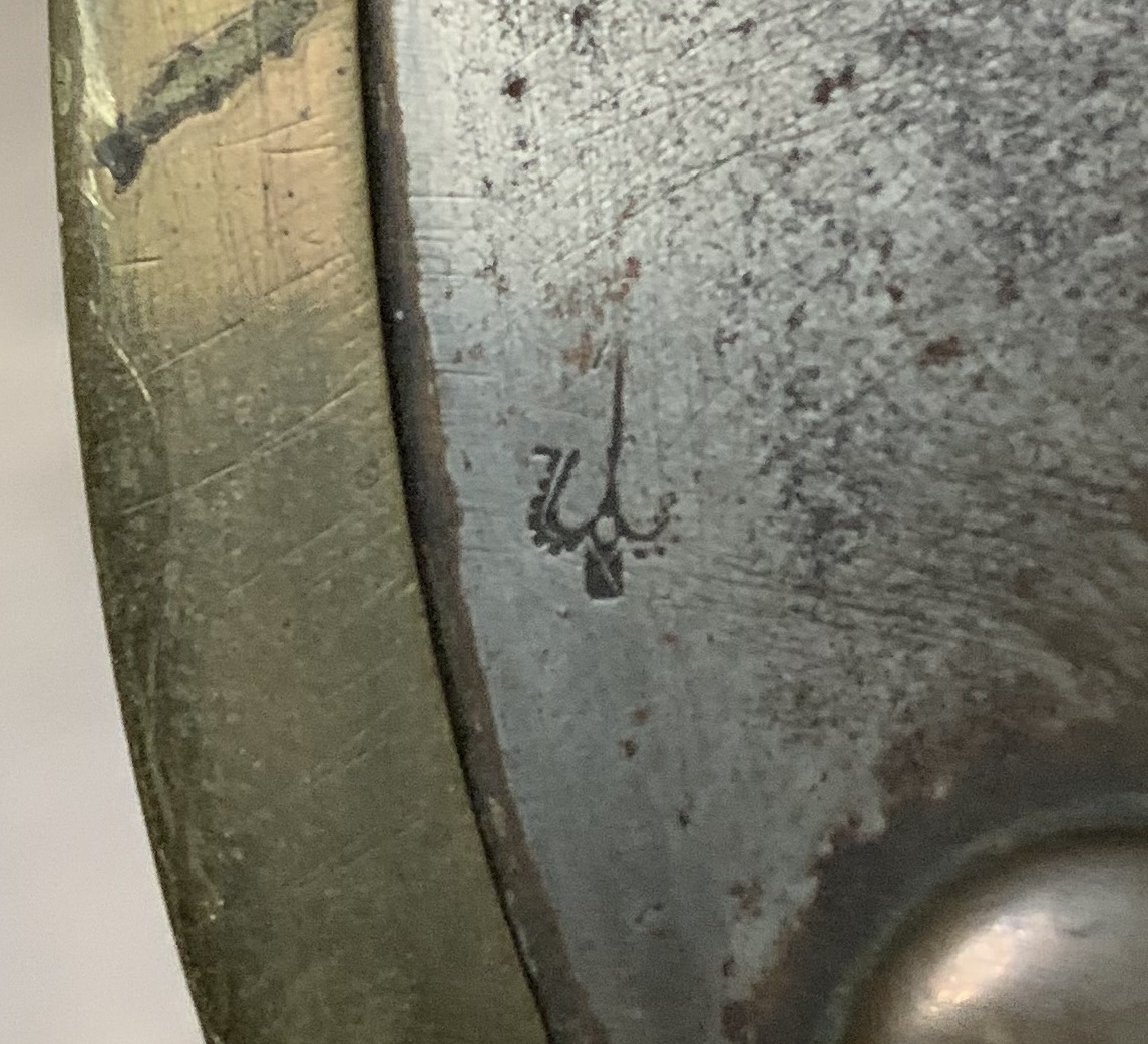

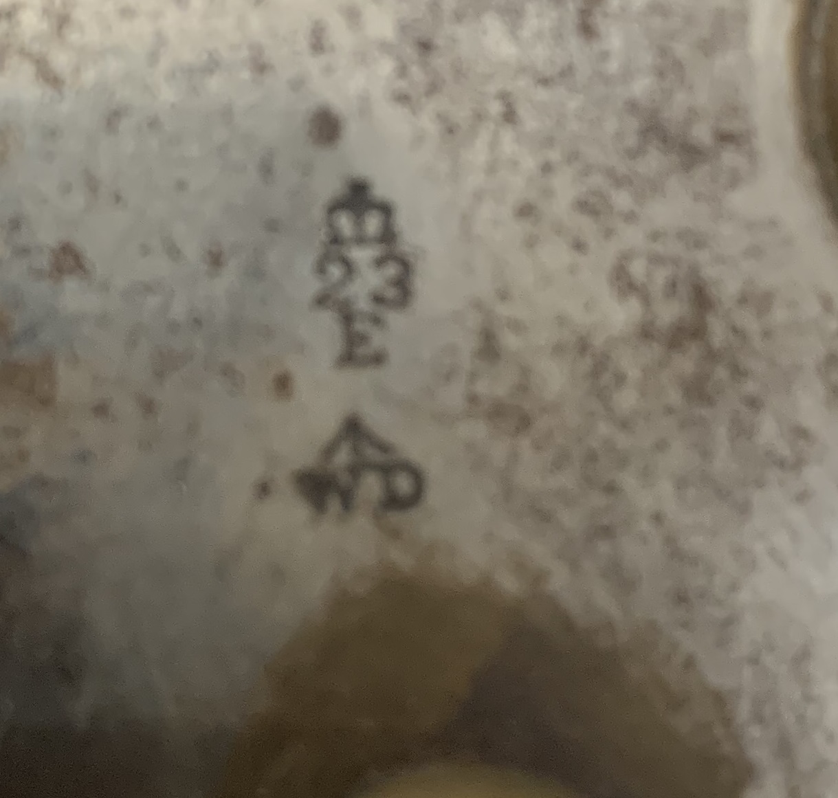

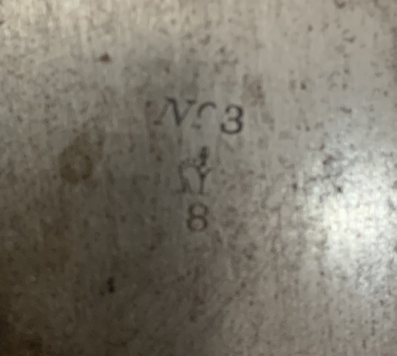

I would greatly appreciate any help with identifying origin of the armor and its age. Also, I wonder if anyone recognize these markings.

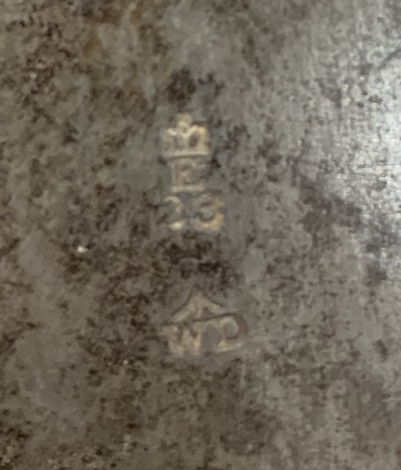

The "WD" mark of the British War Department with the broad arrow makes it clear: This is a British cuirass, but because of lack of documents I am not able to date it exactly. .

According to this https://en.wikipedia.org/wiki/War_Department_(United_Kingdom), the War Department was officially named this 1855-57. Before that it was officially named something else (and stamped its property differently?).

The inspection marking Crown/E/23, "E" being Enfield. Most likely a Household Cavalry cuirasse. Very nice find, wish I had one!

If you will have any more information about other marking, I would greatly appreciate it.

According to this https://en.wikipedia.org/wiki/War_Department_(United_Kingdom), the War Department was officially named this 1855-57. .
So the cuirass should have been made and marked during these years!
