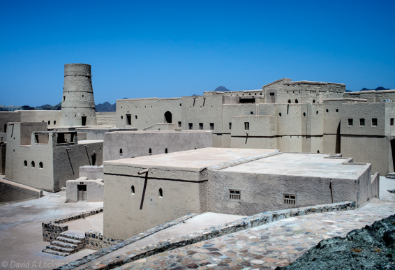

As a background margin note I have to say that the efforts to revive Omans Forts has been considerable as many were in total despair having been washed out by the heavy rains and generally left to fall apart down the ages. The question of how to handle this situation is not easy to answer since ...do you restore or leave alone the original and build a faximile next to it... Do you flatten it and start again... or is... was there ...a way of retaining the main fort structure and restoring where possible?
Here is a before and after shot of one of Omans most famous fortresses at Bahla originally errected by the Persians in pre Islamic times...It has a perimeter wall surrounding gardens and farms in the shadow of the Fort 12 kilometres long ! In the old picture you can just make out the outline of what is the right side of the Castle..One sneeze would have brought the lot down !
Ibrahiim al Balooshi.

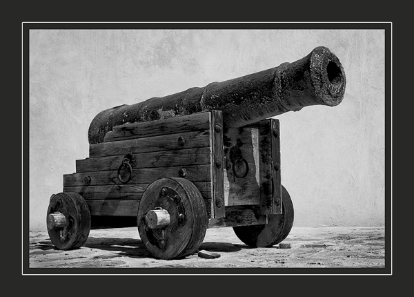

For a brief but interesting view of what appears to be an Omani Cannon made in Nizwa in the 17th C please see http://www.youtube.com/watch?v=rN8TCs_u05c

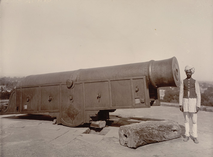

Mine's bigger than yours !!!
Cannon at Fort Deeg, Rajasthan. Photo 1900, British Library.

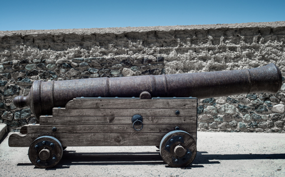

Barka Fort proved to be more incredible as access was granted for a special visit today. You dont at first realise that the fort originally stood inside a giant triangular wall making defence doubly strong. Each point of the triangle had a further tower and heavy armament. The main doors had slots above so that should the enemy be fortunate in getting that close hot molten dates could be poured on top of them. The doors in addition were iron spiked against elephant attack.
Cannon varied at the Barka Fort from English 6 pounder through Armstrong 9 pounder to Monks and Dundas 32 pounder balls fired from two and a half ton barrels!!...Cannon were first used by Oman in 1616 at Sohar fort.
What is clear is that gunpowder was a game changer… Forts had to be re constructed to take the heavy recoil and for protection against incoming rounds. Barka has one peculiar cannon designed to fire small shot like a claymore charge.
My favourite Cannon are a pair of weapons gifted by the English and stamped and decorated with the rose configuration and ER and dated 1587. A makers mark IP? appears over the breach end with their regimental numbers. There were a few shot out barrels discovered excavated from the sand in front of the Fort near the sea, badly corroded but probably English 6 pounders and one barrel blown apart.
The Fort cannon are complete with all their oak water barrels and ash ramrods etc.
As noted the first thing to note about the Fort is that the huge triangular external defensive wall is absent! see pictures below. Apparently local people helped themselves to that wall to build their houses about 250 years ago. It therefor stood inside a massive external triangular 20 foot high perimeter wall with a tower in each corner and must have protected a small population of traders, probably slavers soldiers and local people. The extra layer of defence would have been formidable and with the addition of the fort proper… almost invincible. The fort is built around two massive towers one of 8 sides and the other round. There are hundreds of rifle ports in addition.
Cannon and inhabitants use a lot of water so Barka was built with 4 water wells built into it. The Fort has dungeons simply very deep holes down which prisoners were lowered and a grate dropped over the hole. Food was simply dropped down the hole.
Shown below are a variety of cannon some from different forts as "examples" of weaponry in general circulation including at Rostaq, Jabreen and in the South at Mirbat (with the peculiar spoked wheels).

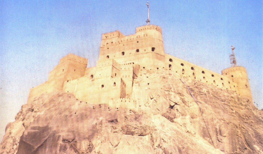

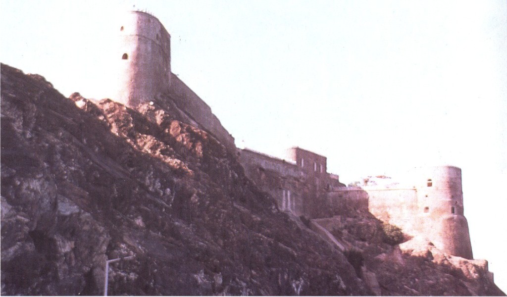

This print shows Forts Mirani and Jellali ..The two major Forts constructed by the Portuguese ..There also built a few towers around Muttrah.

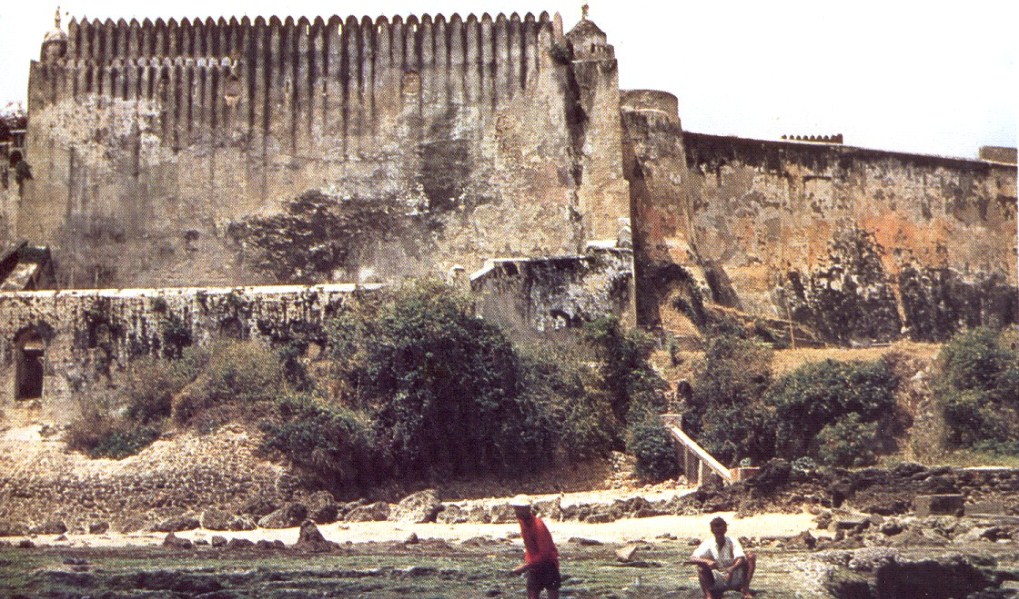

Very often fortifications were built over the foundations or remnants of earlier castles, although with designs more compatible with contemporaneous defence needs.
Fortifications Jalali (ex-São João) & Mirani do not escape the rule; they were built upon earlier Islamic forifications by Portuguese Rui Freire.
Mucat presents an extremely nice and curious defence net. Formed by three defence sysems, each with a different purpose.
The first one composed by a wall of envolving the city, as a primary line of defence. In the surrounding mountain heights towers of survey and atck form a circle around the harbour and the city.
These third complex, Jalali and Mirani together with Matrah, were the more sophisticated expression of what may be called the art of defence based in a Luso-Arab cultural whole and not Luso-European.
This might have been the greatest Lusitanian creation on what concerns their way of projecting and living architeture. Seeking to mix with the gigantic landscape that involves it and to which forms an integring part, all geographic irregularities are profited, with the capacity and shrewdness well typical of their know how to live with geographic discontinuity.
Although this formidable defence complex was considered unassailable, it was subdued by the Omanits in 1653.

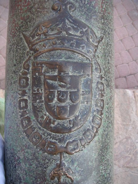

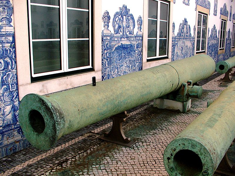

I wonder where the more comprehensive displays of artillery in Oman are already open to public. In fact a rather complex and expensive work took place quite a few years ago for the purpose; an episode that i happened to follow at the time.
Those are the Castles of Al Hazm, turned into an artillery museum and Bayt Ar Rudaydah, this one converted into a heritage small arms museum which displays the historical progression traditional weapons in Oman.
Attached a picture of a Portuguese crest in a cannon at the entrance of one of Muscat forts

Salaams fernando...True indeed ...I haven't got to those exhibitions yet but am working round to them...There are a number of Portuguese cannon and certainly one at the gates of Nizwa with a Swiss Cannon also. They often have the crest of the particular General etc over the barrel..I will pick up on those and the exhibition which I believe were the result of comprehensive work by Dr Roads. See Martini Henry...http://www.vikingsword.com/vb/showth...3&page=2&pp=30 at #34
Your comments about Sohar...called Soar in the old maps (and correctly mentioned as such in your post)... is interesting and I think you are correct...although details I have read indicate the first Omani firing of cannon was in 1616 from that fort...but it is vague and unclear. Certainly I have Mirani and Jelali plus the towers at Muttrah as Portuguese, though, there must be at least influence if not involvement in other fortified projects. It is also true that they retreated inland when the Piri Reius Turkish expedition attacked Muscat pre the building of Mirani and Jelali... Did not the Portuguese pass on their techniques in areas like Nizwa and Mannah...the latter being a fortified town reminiscent of Portuguese work? The question as to when these cannon arrived at the forts they are now in...is as yet, not answered but I hope to do that as the thread develops.
Thank you for the excellent details...

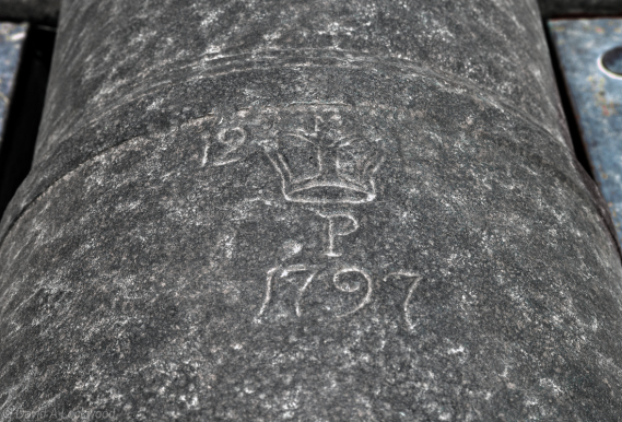

Bahla Fort Gate Cannon.
So what is this weapon?? The P and Crown appear to be proof marks ...The numbers not pictured over the thick end of the barrel would give the weight in hundredweight quarters and pounds...see site below for details and mathematics.
Note;Pictures Courtesy of David Lockwood.
I viewed http://www.treasurenet.com/forums/sh...-markings.html for cannon marks and discovered some how to spot the cannon weight and other details...worth logging .

As may be read in the text, the Fort Jesus de Mombaça (as the name Jesus denotes), was built by Portuguese in 1593-1596 and only taken by the Omani in 1698.
Built upon a coral formation, is considered one the more significant examples of Portuguese military architeture of the XVI century in the oriental African coast; nowadays classified as world patrimony by UNESCO.

Salaams fernando...Glad to hear that... I am on a project next to Barka Fort for a month and Seeb is near my appartment. Corfecan may be a bit more difficult but I shall endeavor to raise pictures of the current instalations. You refer to the Fort Jesus which is entirely described here as Portuguese though changed hands later...The Fort at Bahrain is also Portuguese. Forts were not reclassified Omani Forts because of some religious decision but perhaps since some were either largely or totally rebuilt... I mean for example the fort at Bahla is an Omani Fort but was built by the Persians ...originally.
What I want to know is who was involved in either the design or rebuilding in each case and when was each one modified so that a precise picture can be presented. Such was the deterioration that in some cases the entire surrounding triangular wall ...e.g. at Barka has vanished; incorporated into the surrounding old houses construction which can be seen ...and I shall photograph those exposed walls next week..I am fascinated that 3 forts were essentially identical; Seeb, Corfecan and Barka.
It can be said that Bahla is totally reconstructed and was in such bad condition that no cannon of any size would have been used from inside it...as it would have brought the fort crashing down with the vibrations...
There are differing types of reconstruction down the ages;
1. Preparing the forts for cannon.
2. Running repairs say after heavy rains or part collapse...
3. The third type of renovation is because of tourism requirements.
My view is that the outer surrounding walls need to be repaired...reclaimed..and that a complete and true picture be assembled as to what cannons were at which Forts ...moreover who built the installations and when...The record book can then be retuned..

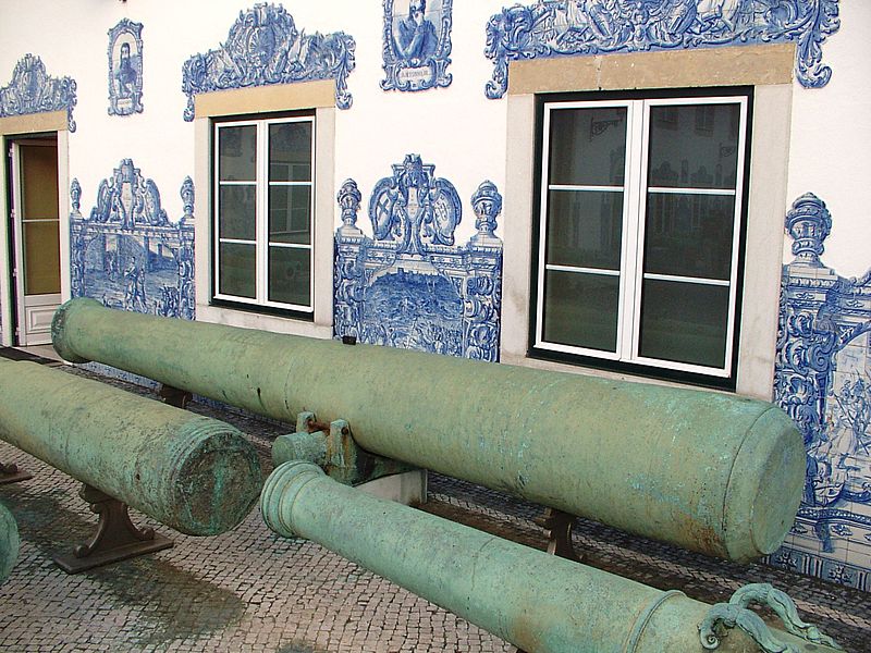

Originally Posted by Kubur
The best Muslim canon is in Leeds
http://www.royalarmouries.org/galler...gle-object/196
It's my own taste, it's up to you to follow...

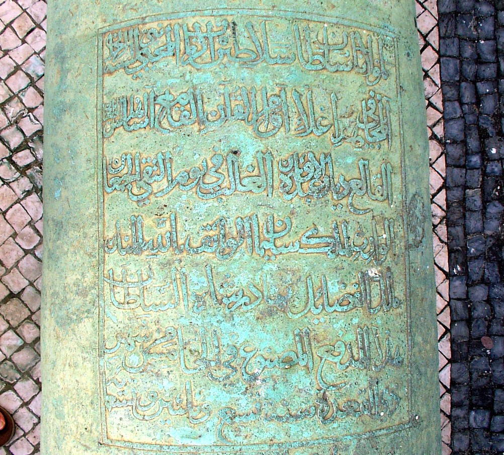

Well, when i said " One of the most formidable Muslim cannons that ever existed in India resides nowadays in Lisbon Military Museum" i was far from ensuring it is the best. Despite my personal appreciation for such specimen, i am far from being able to classify cannons but, the quotation on it stated by scholars is that it is one of admirable greatness since the XVI century and one of the largest basilisks in the world, with its 6,11 mts length, 19.499 Kilos weight and a caliber of 23,5 cms, throwing 43 kilos iron projectiles.
But what is important is its symbolic value, rather than its sophistication or dimension.
(I have already posted this cannon in a different approach. It is somwehere in the archives; can't spot it)
The iscription it contains saved it from being molten for the casting of a statue of King Dom José I around 1770 when, at the last moment, intelectual Friar José de S. Antonio Moura translated the said inscription which reads (Arabic writers may correct ):
From our Lord the Sultan of Sultans of time; verifier of the tradition of the Prophet of (God) Merciful; who combats for the exaltation of the precepts of the Koran; the demolisher of the arguments of the supporters of impiety; the one that removes the houses of worshipers of idols; the Victor in the day when the two armies encounter; heir to the kingdom of Solomon; trusted in the God the Benefactor; the possessor of the virtues – Bahadur-Shah Sultan; this piece was made in day 5 of the month Dhul Ka'da, year 939.
This cannon, built in 1533, was captured and brought to Portugal in 1538 and had practical use in Lisbon defences, before its ending in exhibition.
It is known as O Tiro de Diu (The shot of Diu), name given after its use in the siege of Diu in 1538.
