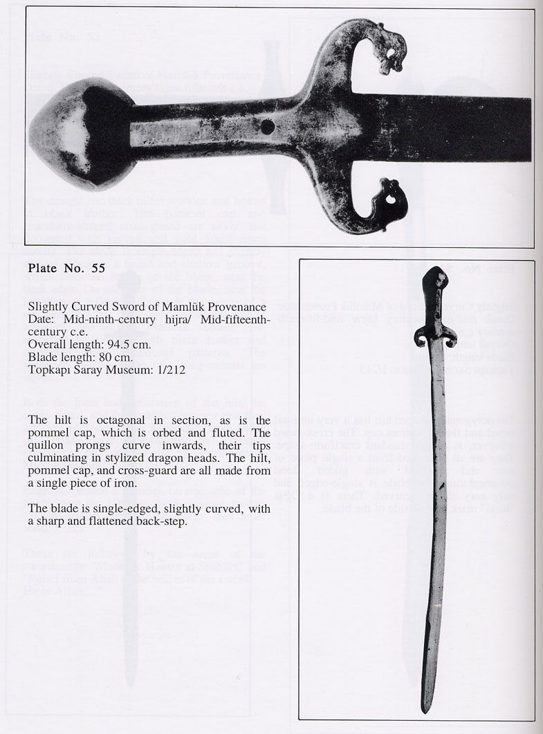

Jim, do you have the magnificent and very weighty exhibit catalog The Arts of the Muslim Knight: the Furisiyya Art Foundation Collection ed by Basher Mohamed (Milan, 2007)? There is a discussion with double-page and centerfold photos (pp 44-47) of a remarkable and perplexing sword whose blade is identified as Nasrid, 14th cent. from its inscriptions, but for all intents and purposes this blade (single edged, spear-tipped, one narrow dorsal fuller each side and a supplementary fuller at the ricasso) is the most un-Islamic thing imaginable in terms of form. If you looked at it, the opinion would undoubtedly be a backsword blade of "firangi" type commonly seen on Indian swords of four or more centuries later. Furthermore, the hilt resembles those Hispano-Portuguese "crab claw" swords from the beginning of the 16th cent. that were widely imitated in crude form in Kongo. But the hilt, according to Mr Mohamed, is said to be of 19th cent. manufacture.
This is an intriguing sword, the blade defies conventional perceptions and I don't know what to make of a hilt that is said to be 19th cent. on it (a revival of a long-obsolete form). I regret not posting a scan of the image(s) simply because the large-format pages, on which the sword appears on two facing pages and again on a three-sheet foldout, are too large for my scanner.
At any rate, the catalog commentary has something interesting to say about the Hispano-Moresque so-called jinetasthat are the real subject of this thread. According to Mr Mohamed, there are only six known examples, and their blades are nondescript, uninscribed, and do not resemble any comparable double-edged blades from other Islamic culture-spheres. This group was reportedly exhibited at the Alhambra in 1992 to mark the cinquecentennial of the conquest. You might want to look for the exhibition catalog, Al-Andalus: the Art of Islamic Spain (Metro. Mus. of Art, 1997) which has images of these swords. I don't have a copy but it's on the "get" list as of now!
That being said, it might be appropriate to examine some of Mr Mohamed's assertions regarding this small genre. As to their dissimilarity to other Islamic double-edged blades, if we could compare images of all six surviving examples with the counterparts to this type in the Topkapi Sarayi Museum collection, featured in Ünsal Yücel's Islamic Swords and Swordsmiths, we might have a better idea of the degree of dissimilarity and whether it is significant.
Based on the images available to me at present, the Topkapi's published blades are of flattened lenticular cross section except for one with full length wide shallow fullers. The jinete sword published in Held (referenced in prior post) has a half-length deep and narrow fuller, looking for all the world like Oakeshott's Subtype XIIIb. It would be great to see what the other survivors look like.
All of the above referenced blades have similar ogival tip profiles, regardless of fullering or or other details.
As to inscriptions or the lack thereof, the example published in Held does show a circular cartouche, bridging the fuller, that contains some squiggles including something looking like an S, which in the book illustration is of insufficient resolution to decipher. Whether that qualifies as an "inscription" awaits better imagery. Let's hope that the Al-Andalus catalog provides us more to go on.

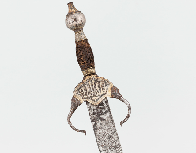

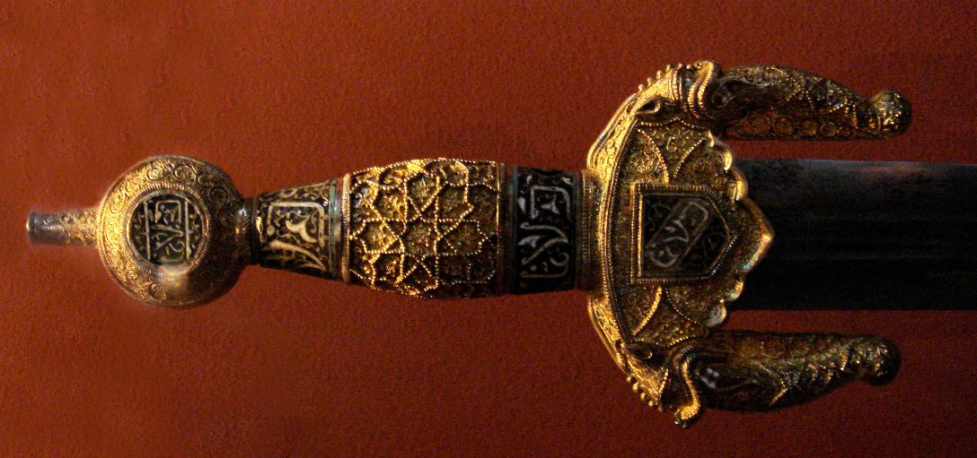

Originally Posted by Marc
If by “the war sword of Ferdinand the Catholic” David Nicolle means either the so-called (sometimes) “Ferdinand’s sword” in the Real Armería:
or the sword from his tomb that stays now in Granada:
then, beyond some decorative aspects, I don’t really see any relationship with the so-called sword of Boabdil in Madrid’s Army museum.
which is a “typical” exemplar of the courtly/luxury Hispano-Moresque sword of Nasrid style from the 14th-15th c, of which some exemplars (less than a dozen, I think) are still extant. I seems quite clear that from this date afterwards this was the style associated with what a “jineta” sword was, specially in the Christian ambit, but it is not so clear that this was the kind of sword that the Zenetes brought with them. We know the Zenetes, in their 13th c. invasions of the Iberian Peninsula, bring with them the light cavalry tactics that will heavily influence the Christian Spanish way of fighting on horseback, including many changes of equipment. But the period descriptions of their swords are not clear enough to make us able to recognize a Zenete/Jineta sword by itself, specially regarding their morphological features, as many of the accounts are not only vague but also centred in the description of how rich and decorated some of them were, obviating the characteristics of those swords that were not destined to the rich and powerful.
On the other hand, in the 13th c. the Zenetes had already been Islamized for a long time, as they had contacts with the first Umayyad invading waves that in the 7th century swept North Africa from East to West, and in fact they helped them to first conquer Iberia as shock troops, at that time. Well, to make a long story short, what I try to point out is that the elite ruling classes in Muslim Spain, those who brought the strongest “foreign” influences in art, religion, society, law, technology, etc. were Umayyad Arabs. And the pre-Islamic and early Islamic Arab swords had straight, double-edged blades, with short, curved quillions (even “D” shaped guards, where the blade emerges from the straight side and the grip from the curved one) of Persian/Sassanid influence (see, for example, HOYLAND, R. G. and GILMOUR, B. “Medieval Islamic Swords and Swordmaking. Kindi’s treatise ‘On Swords and their Kinds’ ”, Ed. By E. J. W. Gibb Memorial Trust, 2006; ALEXANDER, “Swords and sabers during the Early Islamic Period”, Gladius XXI, 2001, pp. 193-220 or ZAKY “Introduction to the study of Islamic Arms and Armour”, Gladius I, 1961, pp. 17-30). And in Al-Andalus there was no take-over by the Central Asian Turcoman tribes with their curved swords (among other things), but instead there was a certain fondness by the old Arab traditions. And on top of that, and most importantly, there are examples of straight double edged swords with short and/or curved quillions from the 9th (CANTÓ GARCÍA, “Una espada de época Omeya del siglo IX D.C”, Gladius XXI, 2001, pp. 183-192) and 12th (NICOLLE, “Two swords from the foundation of Gibraltar”, Gladius XXII, 2002, pp. 147-200) centuries in the territories of Muslim Spain. The picture that seems to emerge to all this, is that the late Nasrid swords are a development of these earlier double-edged swords which in turn are the inheritors of the pre-Islamic and early Islamic Arab swords, and that their dropping quillions seem to owe more to the Persian/Sassanid typologies than to any European influence. As an additional twist to the question, those early Arab swords are, after all, what the Qajar “revival” swords tried to imitate, if I’m not mistaken, with a tendency to also feature the kind of dropping quillions that we also find in Qattaras from Oman and Yemen.
In short, that although the mutual influences between Hispanic Muslims and Christians is an absolutely undeniable reality for as long as they shared the territory, I don’t think that the dropping quillions of the late Nasrid luxury swords are a consequence of it, but a development of the old pre-Islamic and early Islamic Arabic sword typologies.

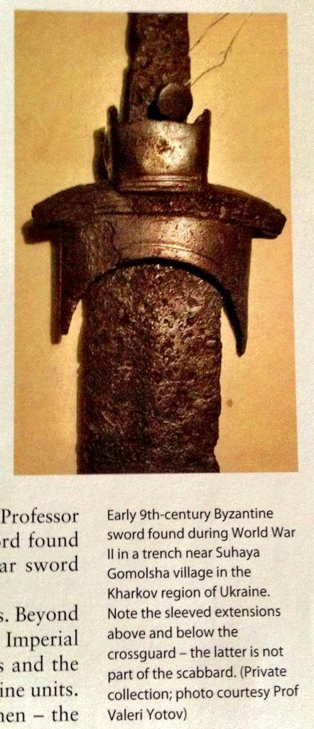

Originally Posted by Gonzalo G
The influence from the Umayyad Dynasties ended in the 11th Century, and so the relatively isolation of the Califate of Cordoba from the rest of the islamic world. From the 11th Century, north african infuences went into Spain with the sucesive waves of the invasive berber which founded new dynasties, intensifying the cultural contact among them. First the Almoravids, latter the Almohads and finally the Zenetes related to the Marinid dynasty to the beginning of the 14th Century. They were part of the ruling class in Al-Andalús, and the support of the Nasrids for a time.
Although I think traditions changes slowly, some amount of influence must be carried by the new berber rulers along all those centuries of constant intercourse with North Africa, and this is specially valid in the case of weapons. I can´t imagine the berber warriors leaving their weapons and adopting new ones but in a period of time where very serious intercourses must be happened.
I agree that there are almost no recorded swords from this period, and the same thing happens with the christian swords. The swords from Santa Casilda, Don Fernando de la Cerda and King Sancho IV, are among the few we can count on. By the way, the sword of King Fernando El Católico is more related to this last sword, clearly a christian sword, than to the muslim swords. There are documented downward quillons in swords from the 12th Century in Europe, in Oakeshott, "Records of the Medieval Sword" from the types Xa and XII and foward, but I think those are clearly different from the muslim types.
So, there are great difficulties in establishing ancestries and the various steps on the evolution of the spanish-muslim swords and their infuence over the ones used by christians, as the swords used by the kings are not necessarily representative of the diverse variants used by the common soldier. But there is a fact which makes me think more, that there is a connection between the nasrid swords, and the espada jineta, and this is the fact of the great similarities among the Omani Qattara and those swords, a smilarity which goes more far than a mere coincidence and points directly to the berber as the link between them. Of course, as I said, in the measure we have more information, even in this thread, there can be other explanations. More archaeological developments and more translations from arab books must be made to have a firm certainty in all this genealogic tree of muslim swords in Africa and Spain. In this, I would leave a chapter apart for the nimcha.

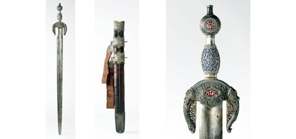

Old 27th October 2018, 09:04 AM   #13
5
JINETA SWORDS A quote from a sold item at
Quote"Jineta (or Gineta) swords are the most direct, fair and rich inheritance of the hispano-arab panoply. The name origin comes from the Cronicles of Alphonso X which tells us about a berber tribe of the Benimerines also known as Zenetes who moved into the Iberic penninsula during the XIII century to fight at the service of Mohammed I of Granada, and brought with them this type of weapon, with a shorter and lighter blade but still as wide and with a great quality steel as the ones used by christian forces of the time.
Due to their quality and scarcity (nowadays hardly a dozen of these swords survive) the jinetas are universally considered and admired. Besides a few now within private collections and worldwide museums, in Spain only three museums are fortunate enough to treasure some examples; the San Telmo Municipal Museum (Picture 9) in San Sebastian, Basque Country, The Army Museum (Museo del Ejercito)(Picture 10); and the National Archeological Museum (Museo Arqueologico Nacional)(Picture11) in Madrid".Unquote.

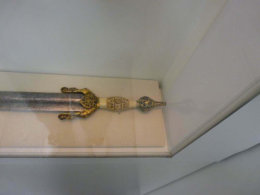

Old 27th October 2018, 09:04 AM   #14
6

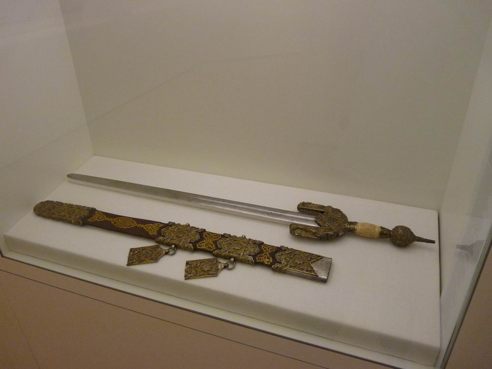

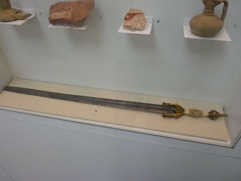

Originally Posted by TVV

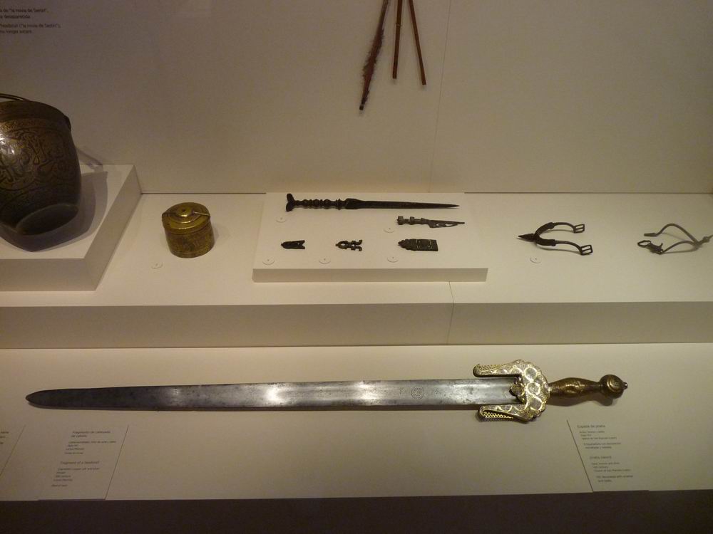

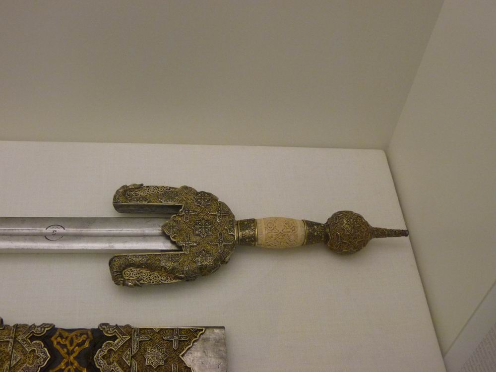

When I was in Spain a few years ago, I took the attached pictures of the jinetas.
First, a couple heavily adorned examples from Museo del Ejercito in Toledo, I believe the first one is attributed to Boabdil.
Then, a broadsword with an ivory hilt, also one of Boabdil's swords.
Finally, one more sword from the Archaeological Museum in Madrid.

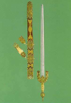

Old 27th October 2018, 09:06 AM   #15

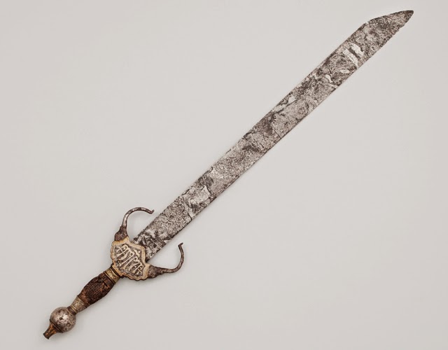

7

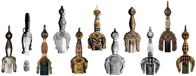

Whilst the Moroccan Nimcha has occasionally been associated in the design to or from this weapon I see virtually no link whatsoever except a vague potential hint because of the turned down quillons ...which as you can see bare no resemblance at all, nor does the hilt; whilst the blades are totally different...in fact the Moroccan blade is often European.
The swords below are indicated as (Top left to right) but may be incomplete as there are 11 descriptions but 12 pictures!! but it may be correct up to item 7.
1 - Sword found in Sangueza, pommel is missing (XIIIth century ?, probably the oldest known)
2 - Sword of the Cardinal Infant Don Fernando (Real Armeria in Madrid)
3 - Sword said to be of Sayyidi Yahya (Casa de los Tiros, Granada)
4 - Sword of San Marcello de Leon (museo archeologico, Madrid)
5 - Sword said to be of the Sultan Boabil (museo del ejercito, Madrid)
6 - Sword "bèrbère" (armeria real, Madrid)
7 - Sword hilt
8 - Sword of the "Cabinet des Médailles" (B Nat, Paris)
9 - Sword of San Telmo (San Sebastian)
10 - Sword said to be of Abindarraez (MET museum, NY)
11 - Sword of the Kassel Museum (Germany)
Ibrahiim al Balooshi.

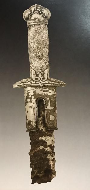

Old 27th October 2018, 09:11 AM   #17
9
The broadswords with downcurved quillons came to the Iberic Peninsula since the early Muslim rule, as stated in the bibliography given by Marc, to which I add the study by Rafael Carmona Ávila, already mentioned. But until the 11th Century those swords have not yet the type of quillons found in the Nasrid swords. Those last came in two types: ceremonial (more apltly denominated “dress swords”, the type of sword used by Boabdil) and fighting. An example of the last is seen in the article from Berástegui Lizeaga, Crespo Francés y Valero y Rosado Galdós, “Identificación de una Espada Jineta de Guerra”, Trabajos de Arqueología Navarra, No. 18, 2005, pp.91 to 112 (it can be downloaded from the Internet):
This sword has more taper, no central fuller and more space to place the index finger over the quillons and under the blade. This is one of the very few existing jineta fighting swords, so we don’t know how representative is of his type. How can we fill the gap between the Muslim sword from the 10th-11th Centuries backwards with this new type? The only information we have is that the Berber Zenetes arrived in Al-Andalús around the 12th Century, and I quote again the work by Nicolle on the Gibraltar swords:
“A new type of sword and its associated tactics are believed to have been introduced to the Iberian peninsula by Berber mercenaries and conquerors in the 11th-12th centuries, perhaps as a precursor to or early version of the jinete light cavalry tactics clearly introduced from North Africa in the 13th-14th centuries. Light cavalry combat a la jinete was again associated with what western European came to know as the Italian Grip and, according to some scholars, with curved quillons 10. In fact the term jinete comes from Zanata, the tribe from which many of the Berber soldiers of both Granada and Morocco came. Their highly effective light cavalry tactics using minimal armour, light leather shields, relatively light swords and javelins thrown from horseback were adopted first by the native Andalusian troops of Granada, then by their Christian Iberian foes, and eventually by some other European cavalry as well.” Nicolle, Ibid., p.158.
Even if we concur with Marc in the fact that there are vague descriptions of the morphology of the jineta swords, we can establish: first, that the Zenetes Benimerines were the main military force under the Nasrid Emirate of Granada to almost its fall, so it is very likely that their military equipment dominate the military fashion of the emirate; second, the fighting sword already shown corresponds with the description, since it is not a broadsword, but a very tapered one, less heavy and more apt to pierce the evolved plate armor of the Christians (the cuirass); third, the quillons are more narrow and allow the “Italian grip” with more protection to the index finger than those given by the quillons of the traditional Muslim sword, since they almost close on the blade, like the later fingerguards, to which they very possibly evolved in time (see Ada Bruhn Hoffmeyer, Idem., pp.32 and 34); the so-called Italian grip favored a more accurate thrust, which corresponds with the intended piercing action of the tapered blade; the Zenete sword was different to the classic Muslim broadsword, this is why it called strongly the atention in the Al-Andalus and Christian spheres, not only the morphology of the hilt and the quillons was different to the known Muslim broadswords from Al-Andalus, but also the morphology of the blade, and the souces insist that they were lighter; the difference among the dress swords and the fighting swords could be great in the Iberic Peninsula, just see how it evolved the rapier as a dress sword different from the military.
But it must be also noted that North Africa experimented a development in the production of arms and armour, as Nicolle and McBride write about this production in the 10th-11th Centuries:
“These centuries also witnessed a huge expansion in Noth African metallurgy, far beyond what had been seen in the Roman period; but although arms and horse-harness were made locally there was little exportation of finished goods”.
David Nicolle & Angus McBride, The Moors. The Islamic West 7th-15th Centuries AD, Osprey Military, Col. Men-at-Arms, No.348. 2001, UK, p.18.
In other words, the problem with North Africa and probably the Iberic Peninsula was not the quality of their weapons, but the capability to produce in mass with a more or less uniform quality, a feature which conditioned the need of imports into the Muslim world from elsewhere, including India and Europe, especially under the constraining needs extant in times of war. And the west North Africa and the Iberic Peninsula were always in recurrent times of war, more or less like Europe. This is a feature which will characterize many areas of the East, since their producing capabilities were not equilibrated with their military needs, as their more traditional crafts were not so “pre-industrial”, possibly with a less efficient labor division and technology, a feature which would be more developed under the pre-capitalist and capitalist European economy. It was already noted in other thread that the Indian swords produced in Deccan were superior to the English, at least until the 17th Century (R. Elgood, “Swords in the Deccan in the Sixteenth and Seventeenth Centuries”, pp.223, and 224), but still existed the need to import European blades, as they also imported the Persian blades, even made with Indian steel.
My hypotheses: the original Zenete-Jineta was not the type of dressing sword used by the Nasrid nobility. This last had a blade more in accord with the traditional muslim broadsword, except for the hilt, which was influenced by the Zenete but highly ornamented, and not capable to support the “Italian grip”, since the altered form of the quillons did not allow it: they were literally closing over the blade. It is a common feature of the ceremonial swords to imitate old forms and use extreme ornamentation, since they gave to their owners the prestige of tradition and power. Fighting swords were another matter.
The Christians were influenced by this last type of sword, but with modified quillons and an incipient development of the ring guards, probably a development from the grip and quillons of the fighting jineta swords. It is not casual that the first ring guards, which evolved to the “crab claw”, appeared for the first time in the Iberic Peninsula, on the Christian Spanish and Portuguese swords (please see the Black Swords or “Colhona” used by the Portuguese). It must remembered that also Portugal was part of the Muslim domain and that to the 15th Century, even already independent, was influenced by the military traditions from the rest of the Peninsula.
The rapier evolved, at least in part, from this original fighting jineta sword. The cited study from Ada Bruhn Hoffmeyer points in this direction.
The nimcha sword type of quillons does not necessarily owe to any European tradition. The cultural elements behind them were already in North Africa long time ago. In the Catálogo de la Real Amería de Madrid (the catalog of the royal armory of Madrid), we find a suggestive description of four sabres taken from the Spanish Expedition to Oran in 1732 (free translation): “Four Moorish sabers owned by the Bey of Oran. The first one with wood hilt and a cap of engraved silver; guard, quillon and guard rings ended in pythons, all this decorated. The second one has a hilt of horn with plaques of chiseled silver, guard with a quillon and ring guards made of steel. The other two have their hilts covered with shell, nacre and plaques of chiseled silver, guard, quillon and guard ring made of engraved metal. ” Catálogo de la Real Armería, edited by Aguado, Madrid, 1854. p.61. It must be noted thay they are sabres, had a guard (probably a knuckleguard) and only one quillon, since the word “gavilán” in spanish denotes a single quillon. Does this rings something? Maybe a nimcha?.
On the other side, just saying that the jineta or the nimcha are “likely” or “suggestedly” a product of influences from Italy or France, is patently a subjective judgment, as the words imply. And sometimes we found a wide abuse of this words, if not supported by clear facts. The first fact we have to take in consideration is that there are no European hilts in the 13th Century resembling those of the jineta sword. The second fact is that the crab-claw type of guards appear until 15th Century in the Iberic Peninsula (see Ada Bruhn Hoffmeyer), and their only visible antecedent is the fighting jineta sword. Again, see the Castilian and Portuguese swords from this period.
And speaking of the possible diffusion into Europe, especially Italy, from this type of hilts, the berbers did have contact with Europe, contrary to what has been said. Europe did not came to North Africa, but the berbers went to Europe in this period. Just to mention some facts: Aghlabid Berbers conquered Sicily, North African Muslims colonized Bari, Taranto and Apulia in the 9th Century and in the 10th Century they fought in Southern France as allies in local Christian quarrels. Bishop Athanasius recruited Islamic troops and Muslims settled in the province of Lucania. David Nicolle & Angus McBride, The Moors. The Islamic West 7th-15th Centuries AD, Osprey Military, Col. Men-at-Arms, No.348. 2001, UK, p.16. And the Zenetes were a military contingent in all this armies. Just search in the history of the Berber emirates and dynasties and you will find.

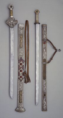

Old 27th October 2018, 09:15 AM   #19
More including the one with a "falchion type blade" (in a Museum in Paris)

Then Philip, you will have to satisfy with a 2D image of the one in the Middle Ages Museum of Cluny
Are you sure Cluny?
I was thinking the National library
https://gallica.bnf.fr/ark:/12148/bt...f/f1.item.zoom
Another one in Paris
with a different kind of blade
http://www.musee-armee.fr/collection...-boadbdil.html

I believe the jineta subject is quite more complex than initially thought so the best is to pile up all the relating info.
This is an interesting start even when in Spanish:
http://www.alhambra-patronato.es/fil...sa_nazar__.pdf

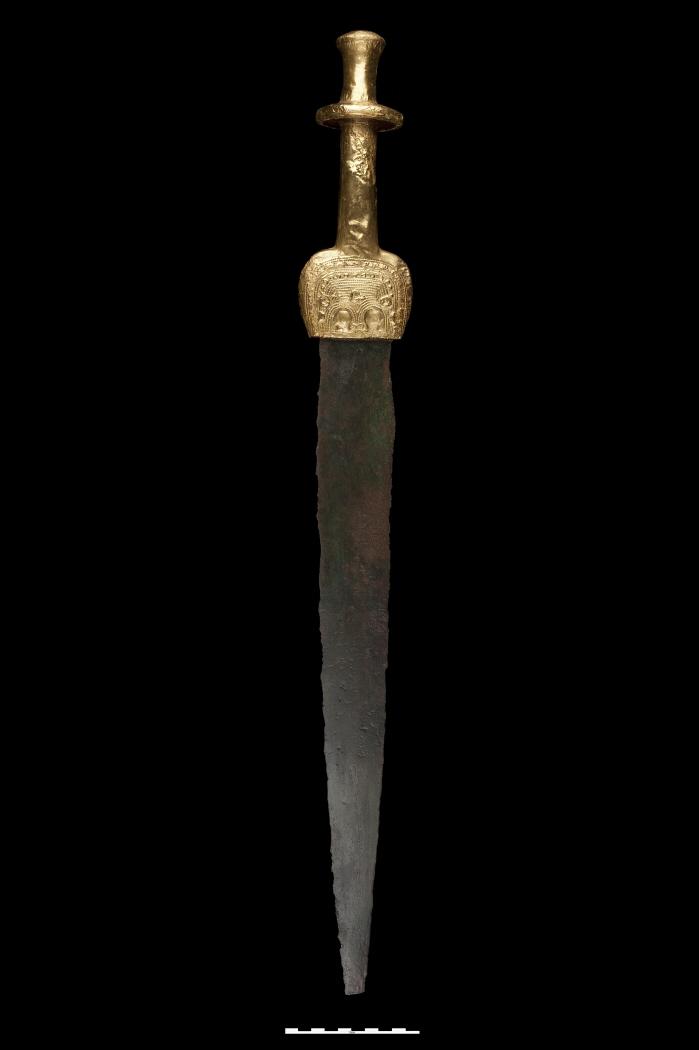

There are several archeological remnants usually not mentioned as ginetas, for example this islamic sword found at Guadalajara (the gilt one).
For me, the closest relatives to the Nasrid jinetas come from the Mamluk State. And the Mamluk weapons come from Syria. And the Syrian weapons are derived from Bizantium.
Interesting pictures in an article by Yotov:
https://www.academia.edu/2328824/A_N...1th_CENTURIES_
A not anymore extant Jineta was painted by El Greco. You can compare it to the San Telmo Gineta and a Mamluk banner...
You have mamluk swords with low quillions and others where the hilt surrounds the sheath mouth. Spheric pommels seem to be a characteristic of some mamluk and bizantine swords...
We can go East to Xian an Tibet as well...
