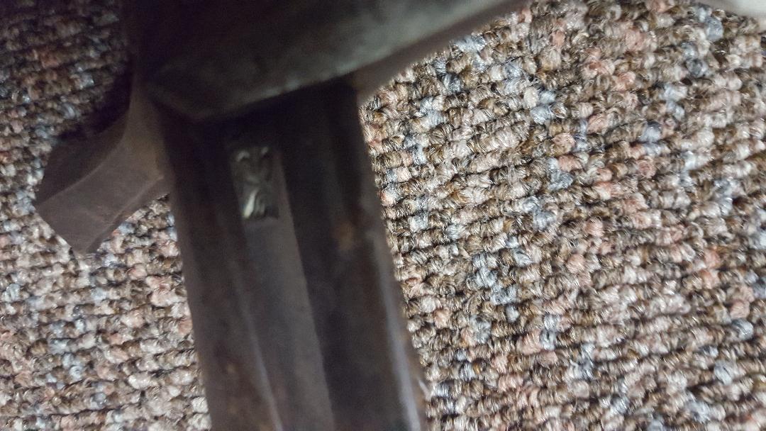

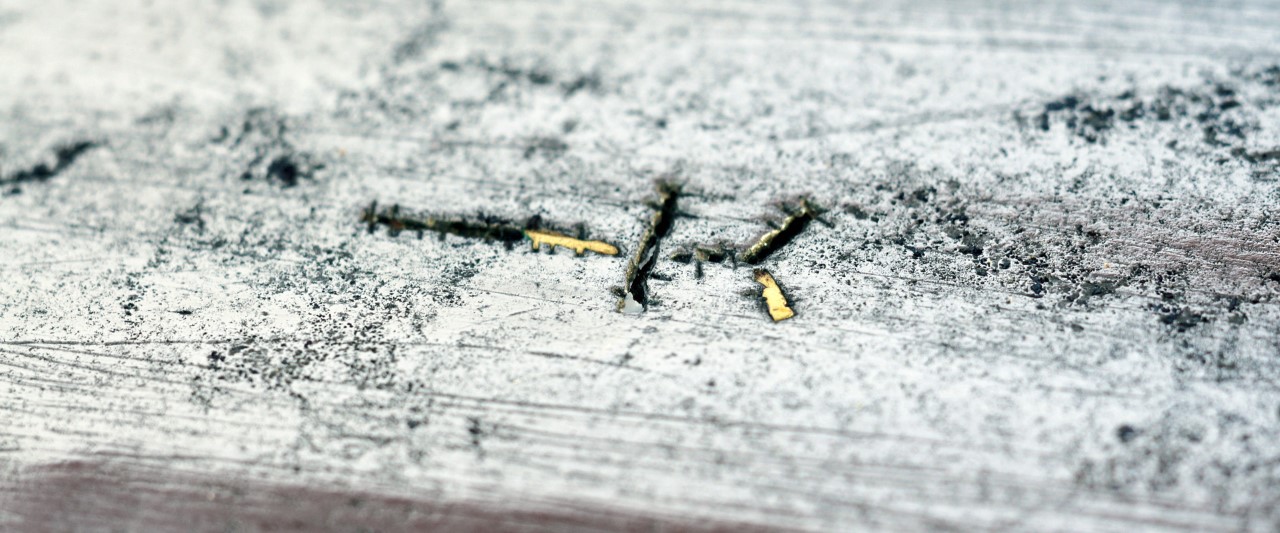

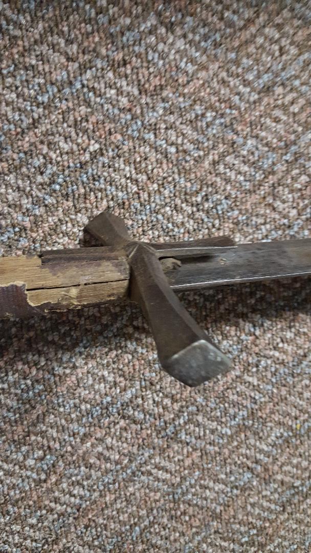

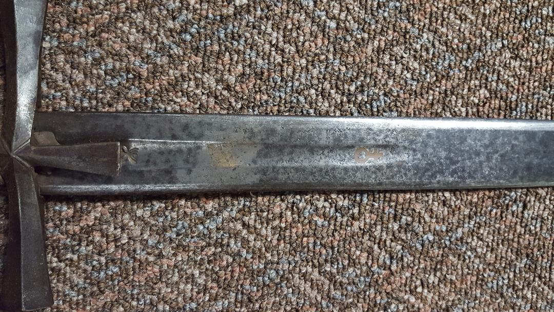

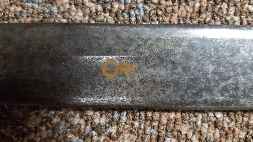

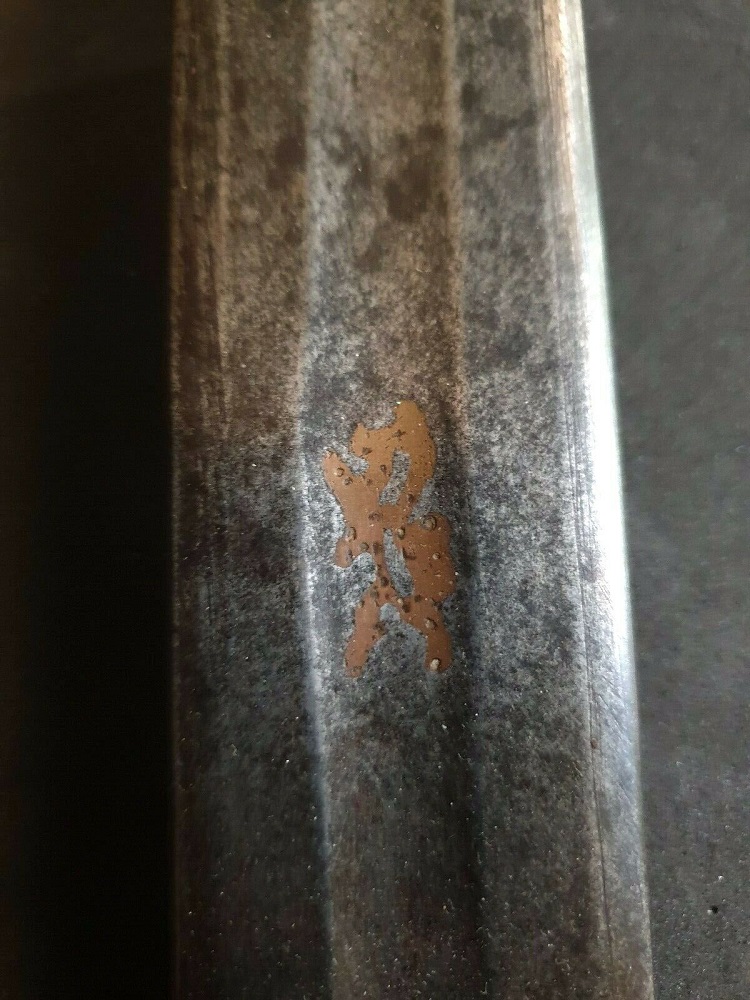

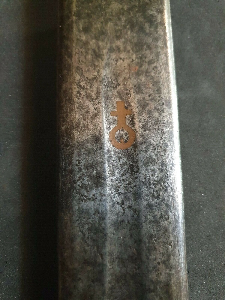

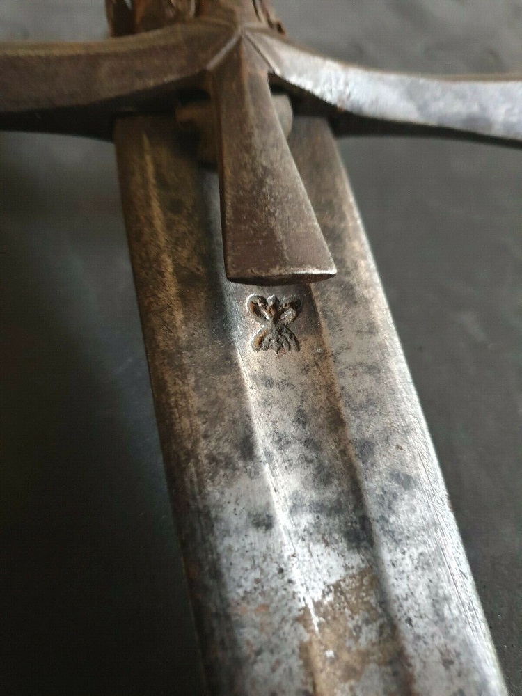

I won this kaskara off of eprey. It had enough red flags that I did not use the buy it now option but put in a low bid with a lot of hope. I won it as the only bidder which made me even more concerned that the red flags where seen by others who decided not to bite. This is a completely new area for me so my experience is limited. This was the eprey banner, "Superb European bladed Kaskara Solingen likely 18th century North African sword" The orb and cross and standing cat had copper inlays. This worried me that they may not be inlays at but just drawn. The markings seemed to be in a differnt place then my referenece(All my reference is Ed Hunly's articles. THANKS Ed). It also had the fly markings. The crossguard seemed to be of the type; Sammaniya, small flare forged iron. WHich matched the sellers age guess. THe markings are; Fly, orb and cross, and standing cat. THe fullers really bothered me as they looked very crude. But the fullers and blade shape matched the type; Dukkeri abu Dubban.
I have this blade in hand and am still stumped. The fullers are not well done but do not seem to far off from the reference. The fly is there, twice. one is hiding under the cross piece. THe orb and cat are indeed inlaid and not painted or drawn as I feared. I cannot say what the metal is could be copper but it has a odd patina. The blade is unsharpened in the ricasso area. The sharpest area is near the tip which is still quite sharp the rest was sharpened but is not as sharp as the tip area. There seems to be some file marks on the edges, which could point to repro but... Oh, he!! I just can't tell so what are your thoughts. If it's a repro that explains me as the only bidder and it's a lesson, if it's the real deal then it was the deal of the century. Don't be afraid to be brutal or blunt. I've been collecting for years and do not offend easily.

Far as I can see it is exactly what it appears to be. Good quality guard and Solingen export blade. Other buyers may have been put off by the hilt condition and lack of scabbard?
Congrats on a good deal. A solid piece in terms of the surviving components.

Well done MRoss!!!! This is a great example with outstanding blade and the guard! These are of course the key components and regardless of the grip condition, this acquisition is important and especially for those of us who are focused on the history of these weapons.
The poor condition of the hilt suggests that this sword has probably been static for some time, thus has avoided the clutches of crafty dealers and innovative sellers.

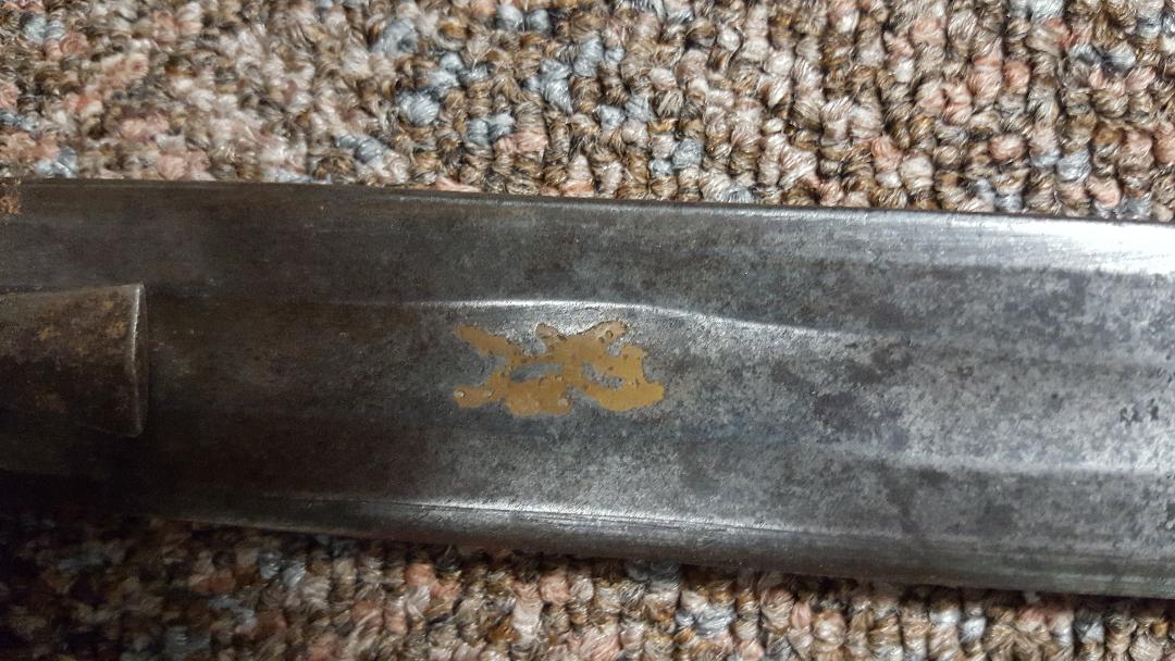

Iain, it has been a while since we have looked at these 'latten' (inlaid brass) markings in the Sudanese context. We had discussed the possibility that these schiavona type blades may have been produced in Solingen specifically for this North African market. Is this still a viable theory?

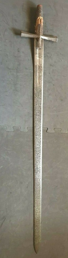

Have attached some seller pictures, they are not bad so they show it well.

I'm glad the kaskara essays were useful. I agree with both Iain and Jim. Well done. I would differ with the seller as to age. R. Cronau's book attributes all three marks to Peter Kull in 1847. Bezdek gives the cat and cross & orb to Peter Kull (1830-1870) and the fly to Samuel Kull (1847-1860).
Back in July we had a good discussion about copper filled Kull marks.

Excellent! Thanks. Brass inlay makes sense it, I did not think it was copper. So it looks to be around 1847 or so?
Just followed the link above and saw my sword at the end of the discussion. Cool. One point of interest, on mine it has two flys one is under the crossguard. That would make a pretty convincing argument it was made at the time the blade was made and before the cross guard was added. So a new question; How did these sword parts come together? Was a complete sword made in Solingen or were blades shipped to Africa to be assembled from local parts there?
Yes the blade is circa 1850. The guards were also exported it appears. There is a period French reference for this. The inlay is almost certainly local. So potentially the guard is European made. Very hard to say. The majority of guards seem to be locally made.

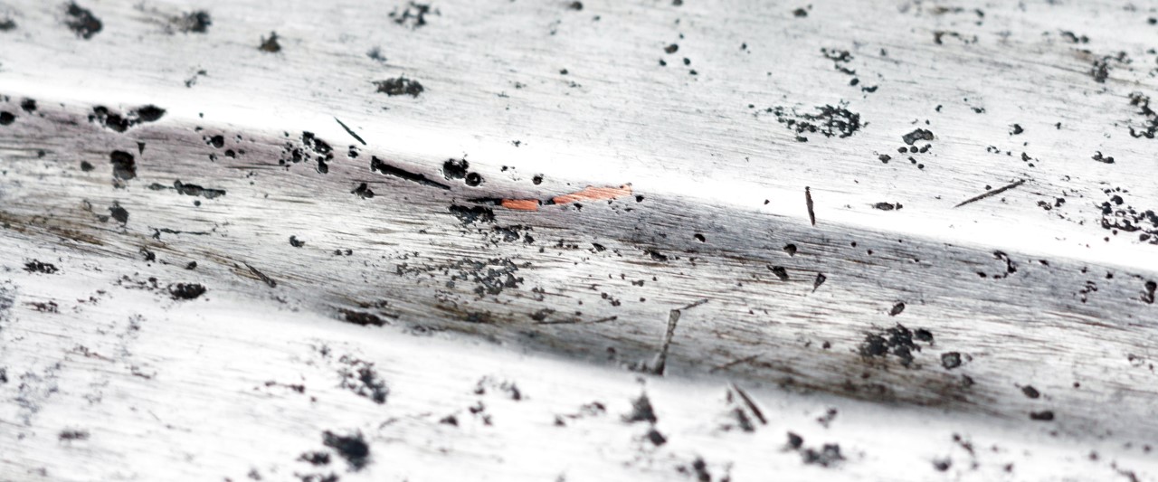

I think in the included link the copper was pored rather than inlayed cold. Also, we have at least three kaskara with the same copper treatment into Kull swords, plus the takubas previously noted. This suggests to me a common source. It would have to be a shop capable of melting copper, likely a jewelry. Since we have takuba blades, maybe the shop was in Tunis, and your kaskara blade was traded into Sudan, likely Darfur. This is all speculation, but sounds reasonable.
A final question remains; WHY? Why would an importer or jeweler do this on a wholesale basis. Would potential purchasers consider them special?

Yes, it mimics European latten work on blade marks which I have detailed on various takouba before. Just two examples are attached.
I think as well it was likely done in bulk in a workshop for precisely this reason, as well as the talismanic properties

I think we can safely say this is a Kull blade, and I hope Iain and Ed will agree as they are the true authorities on these swords here.
It seems that in the many years I have been fascinated by these kaskara, I have seen these latten (copper or brass filled marks) in a good number of their blades, and typically with the cross and orb, if not with the lion as well.

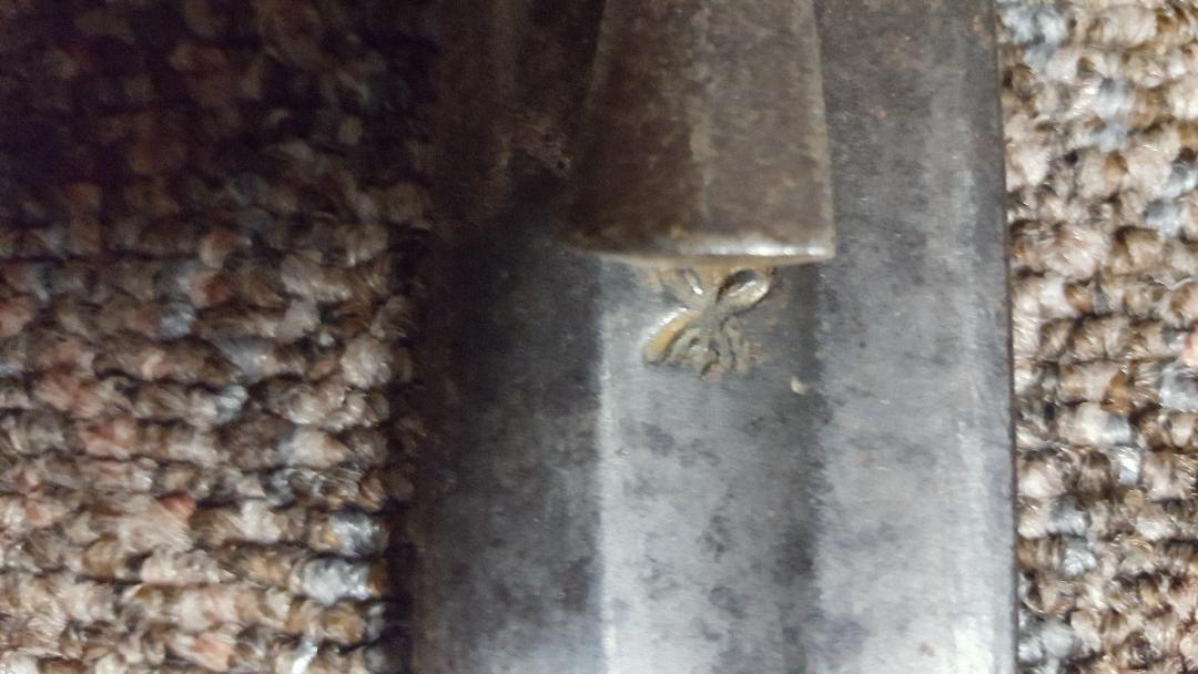

The fly mark is indeed for Kull (Bezdek, 72.73.74) and suggests the c. 1847+ date. It does seem that there was a distinct market for blades, and even crossguards in the third quarter + to the Sudan (Les Soudan: ses rapport aveck commerce European, 1871). I do not have more on citing this source but I know Iain has it.
In one reference which I think was Slatin (Rudolf Slatin, who was governor general in Darfur in 1882) who surrendered to Mahdist forces in 1883 and was in captivity for 11 years...….mention is made of swords, which were being brought in from Austria. There were some with double head eagle (Holy Roman insignia of Austro-Hungary) but I feel sure that mention was made of the cross and orb and the lion on numbers of these. Naturally these would be presumed of German origin.
In references such as Robb (1924,describing Masri blades with lion and cross and orb) as well as Briggs (1965) the presence of these distinctly marked blades is well established.
The cross on the cross guard center has typically been regarded as a Darfur affinity from the post Khalifa period or Ali Dinar period of early 20th but references show it was used in Sudan prior to that.
If I were to imagine the trajectory of these clearly Kull blades (so marked with fly) I would agree that an entrepot in North African port with the facilities for melting copper/brass as suggested by Ed and Iain, likely applied the talismanically oriented devices on the blades . These then entered the trade networks which clearly went to varied centers including Darfur, where seen by Slatin.
In all, a remarkable sword regardless of its hilt condition, and beautifully represents these historic times and events in the Mahdiyya period.

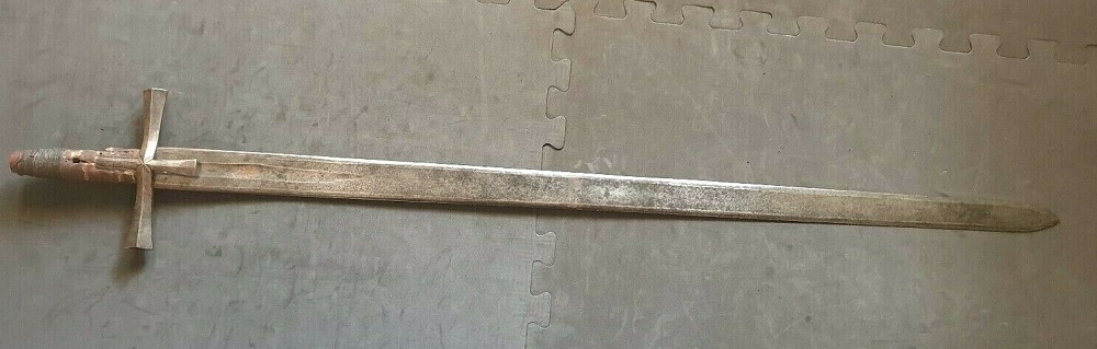

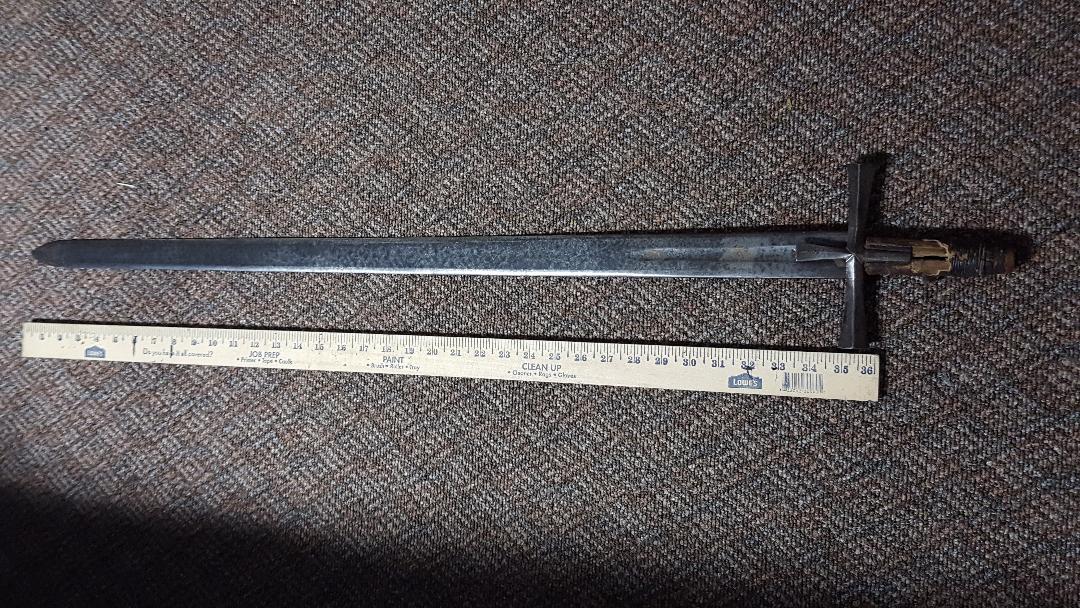

Finally got the full length to go. I know there is a better full length shot, the photos of the seller are much better than mine, but this is next to a yard stick for size reference.
Yep, that's the usual blade size, these are very much of a size, although the exact length of fullers etc seems to vary a little due to the hand made nature. Given the extensive use of water powered trip hammers and grind wheels, these were something that could be churned out in large numbers.

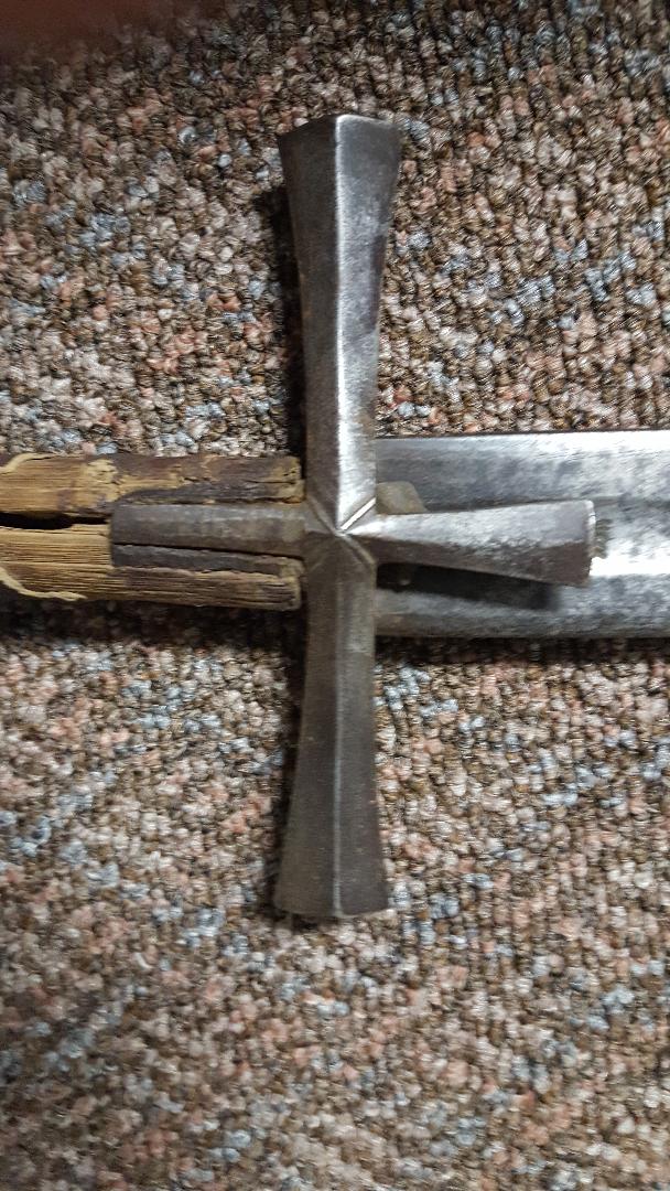

I concur with the Kull blade attribution, but can't agree on the notion that the guard may have been imported from Europe. Here's why.
We have only two references to imported guards; your French one and an 1871 observation by F-G Garnier that German blades and GUARDS were imported to the Suakin port from Egypt.
We don't know their design. material and appearance of these purported imports. With the exception of the copper alloy cast grips often seen on Thuluth swords (see attachment), I have never never seen a kaskara with a guard other than the traditional 4-piece forge welded design. Also, I don't know if the Thuluth guard has a slot or how the blade, guard and grip are secured together.
The kaskara's method of securing/wedging the blade, grip and guard into a unified whole seems to me to be unique; at least I'm not aware of other ethnic origin type swords secured in a similar manner.
I understand that European guards were made with a central slot that fit over the tang as shown in Oakeshott's styles. Maybe Arabic, Persian and Indian were similar as well. I just don't know.
https://myarmoury.com/feature_oakeshott4.html
The quillon flares are wide and first rate, though not as extreme and as the Ali Dinar regalia & gift swords produced apparently only in his workshops during his reign (1899-1916). I doubt that European workshops would bother to make a 4-piece forge welded design with flared quillons just as an extra export Sudanese market item when a must cheaper cast copper alloy unit may work as well. I understand the one-piece kaskara guard innovation was not developed until c.1940.

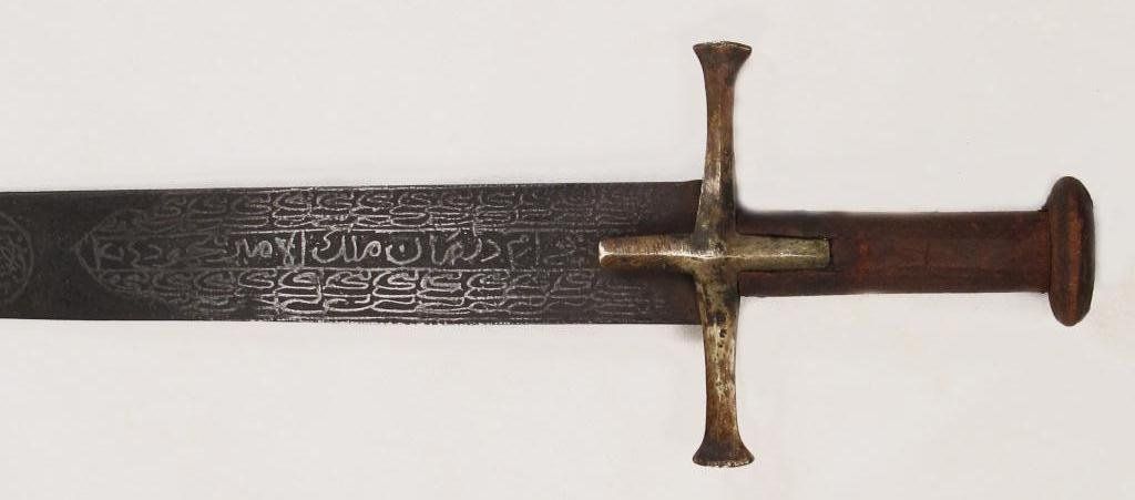

I found another kaskara very much like yours from Royal Armouries, XXVIS.204 with copper cat/lion and cross & orb. No fly was mentioned. As Jim observes, there seems to be a large family of these blades.
https://collections.royalarmouries.o...ject-9627.html
