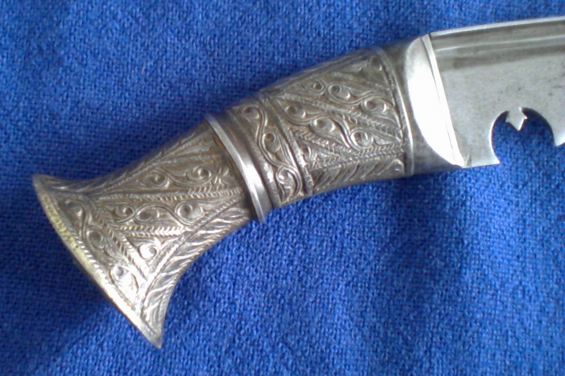

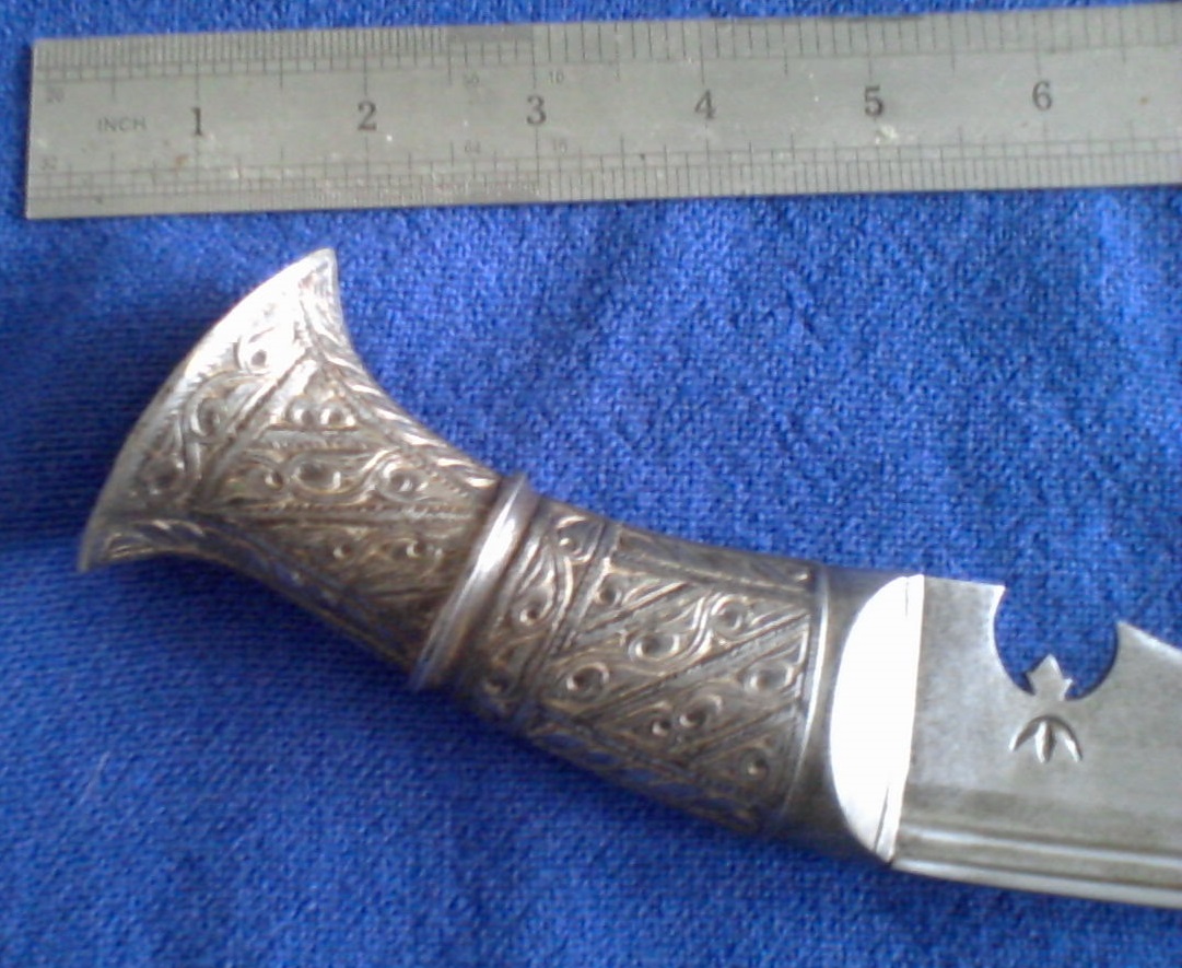

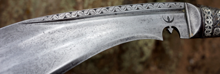

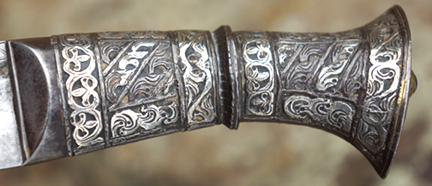

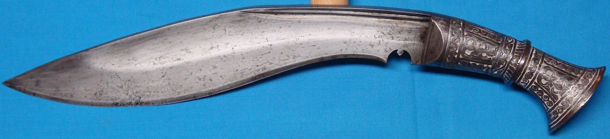

Here is my newest kukri (thanks Rsword). It has a laminated steel blade with one large fuller and smaller ones up top. The hilt is chiseled steel i floral motif. I packed the recesses with lime (remnants of lime was already in the hilt).
Damascus bladed kukri's appear to be rare, and this one I suspect might be from the early to mid 1800s (or earlier according to Rick's informant).
Enjoy.

Waouh,
Lovely !
Really nice piece !
Will you use sandstone 800/100 for clean/sand it ?

Posts: 7,280
I was luck - it was already polished. Just had to use acetone to get off the old oils. then I etched the blade and limed the hilt.
Also I forgot that it could also be from the late 1700s during the Indian Mutiny.

This is a nice kukri that I would put to the Indian Mutany period based on other similar kukri with steel hilt, full tang peened arrangement, fullering and laminated steel. 1857–59 or there about.

Old 2nd September 2019, 05:10 PM   #7
Posts: 9,202
Hi Jose,
Very nice piece! Blade is after my fancy too dark etched, or too strong, I would repolish the blade a little bit. Anyway, congrats!

Posts: 1,911
Very good and rare aquisition!
However, this is not a kris so the etching should be very discrete... if any.
I suspect it was over-etched to make the pattern discernable in the photos, and facilitate the sale.
So, I agree with Detlef and suggest you polish it a little. The pattern should be only visible in reflected light.

Posts: 7,280
Thanks folks.
I will go back and repolish and re-etch the blade to where it won't be so dark and a little more subtle.
Also I'll also get back to you on the measurements as well.

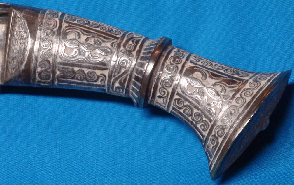

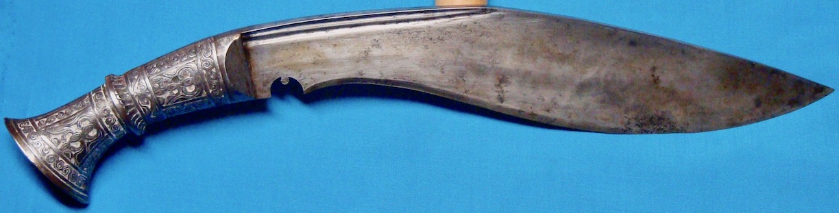

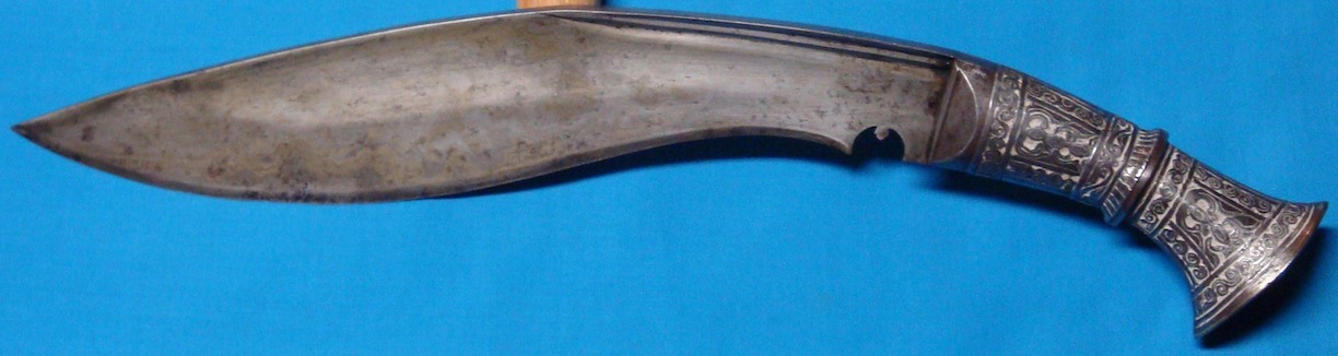

Join Date: Apr 2017
Posts: 68

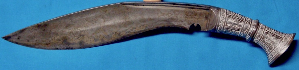

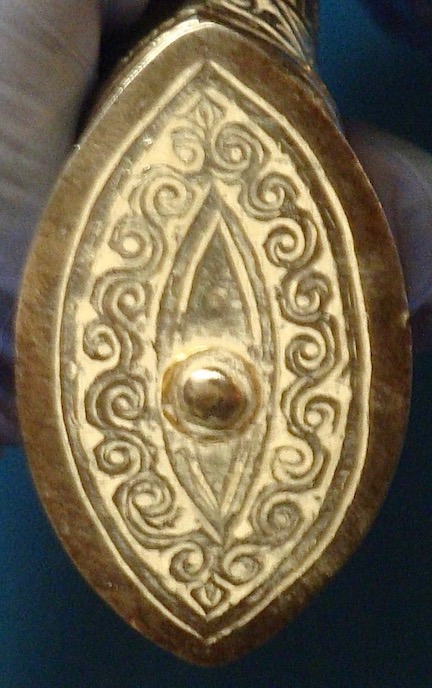

Here I have its cousin from the tin chirra branch of the family. The laminations are certainly visible in the right light, but I haven't brought it out through etching.
There are a few spots on the grip where there is a gray/white residue (you can see this in the close-up . . . next to the ring on the concave side of the grip).
Please educate me: What's the story behind liming the grip?
MacCathain is offline   Reply With Quote

Posts: 7,280
MacCaithan thanks so much for posting - you have now confirmed what kind of scabbard should I choose to make one for my kukri.
The "white" parts of your hilt appear to be silver plating over the steel. I figure that the lime packing is for visual effect, that it brings out the designs better (like that of some Moro scabbards).
Also I forgot to add the lengths: 15 inches over all (37.5 cm).

Join Date: Apr 2017
Posts: 68
Thanks, Battara. The silver bits in the design that contrast with the darkened steel areas constitute what I think could be classed as niello decoration, and they are, indeed, silver.
The residue that I mentioned is different; it looks a bit like old toothpaste in the small crevices (the deposits are not as easy to see in the image as I had hoped they would be). There are only a few places where these are visible, so they may not be residual decoration (perhaps they're just toothpaste).

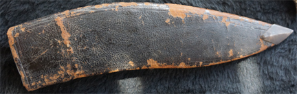

The scabbard struck me as being unusually plain for this well-executed kukri. I would have expected something a bit more flash. Even the chape has been given the darkened steel treatment, though, so I believe it is the original scabbard. Here's a better view of what the face of it looks like.
This kukri measures 15.75" straight from the tip to the farthest end of the pommel cap. The grip is among the smallest in my small collection at only 4" on center.

Yup that "toothpaste" is lime.
Also thank you for the scabbard picture.

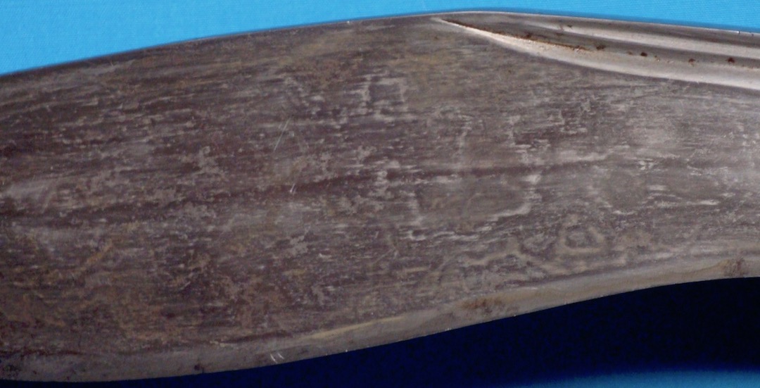

Posts: 7,280

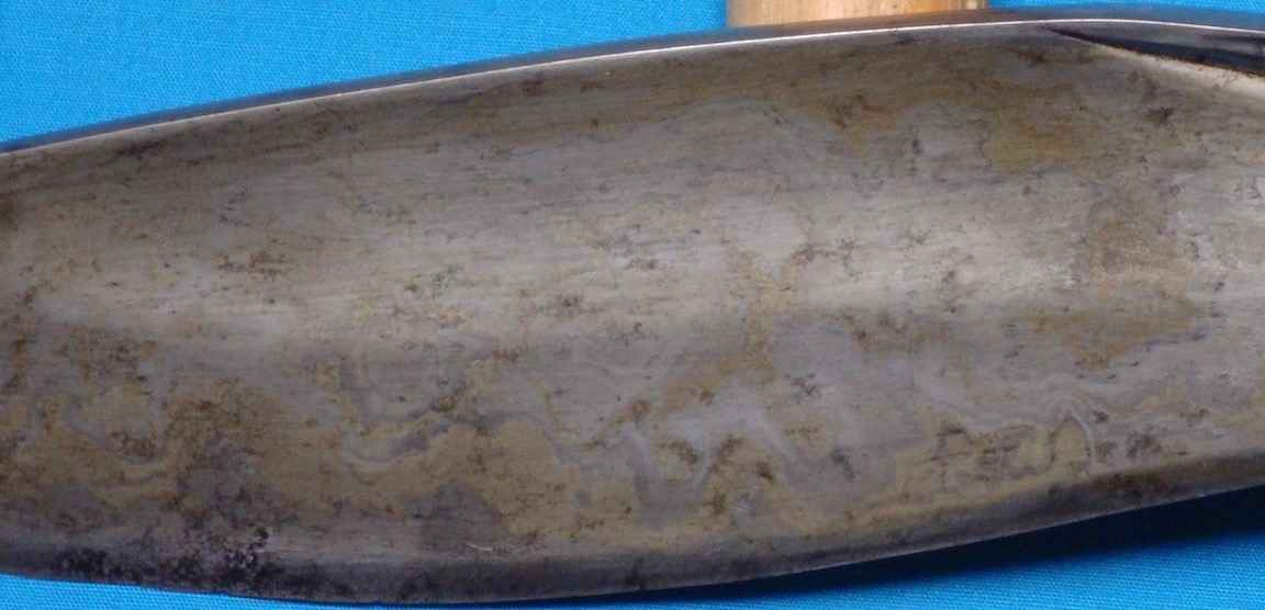

Is this better?

Posts: 7,280
Oh my re-etch is not in response to you, MacCathain, but to the feedback from others.
Not sure if I should polish even more, or re-etch even lighter.
Old 5th September 2019, 02:15 AM   #17
Posts: 6,339
My 2 cents, polish more; and what is the brown color coming up when you etch?
Maybe try a different etchant to avoid the brown tones?
It is a very nice old warrior.
Or maybe don't etch it at all. The pattern should still be visible.

Posts: 7,280

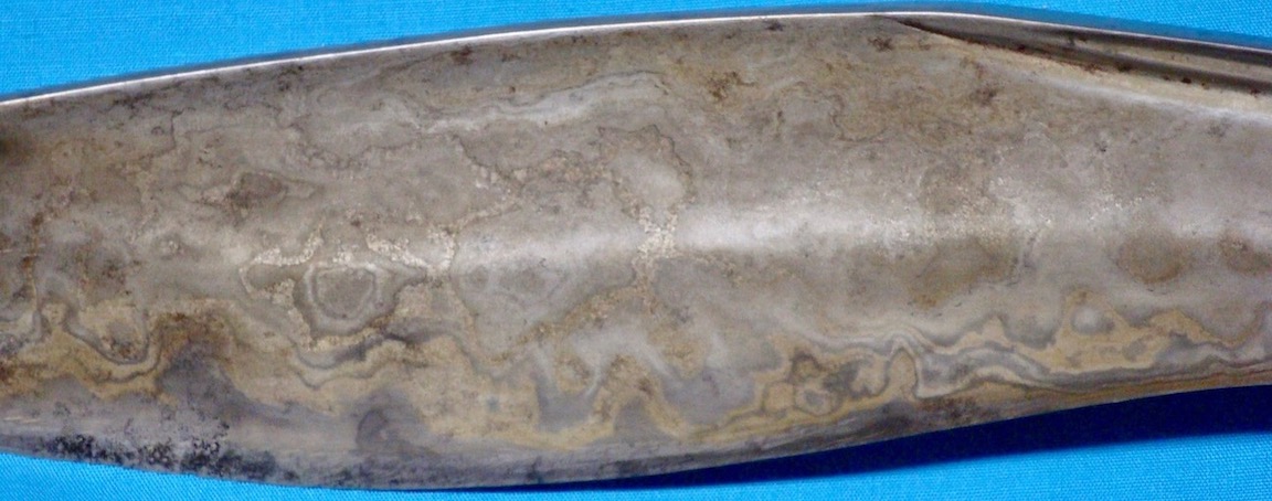

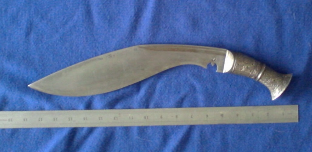

Here is the final version. I just took 600 grit and gently took off the yellow and brown. The picture of the damascus is done at an angle.
Thank you for your advice and help folks.

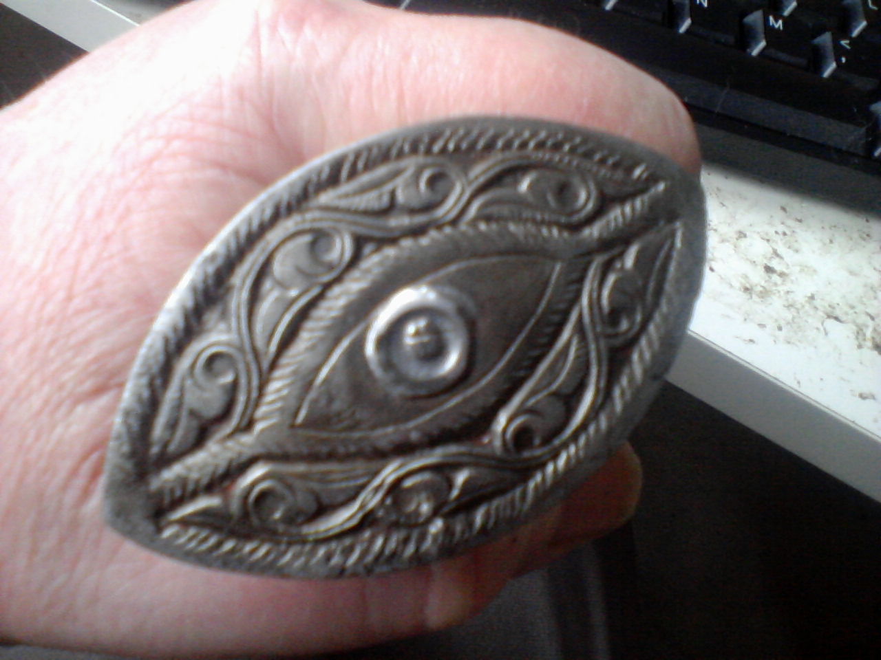

Properly speaking, I would say it's a laminated or watered steel blade rather than Damascus, a term normally reserved for Wootz or Pattern Welded blades. It is a very nice piece indeed, and I find the idea of "liming" the hilt to bring out the pattern very interesting.
Here is my chiselled steel hilt for comparison... There's not a lot of them about.

Great piece for comparison Dave, thanks!
Yeah lime on kukris was new to me too, but steel doesn't produce that kind of oxidation, and it's not dirt either.
