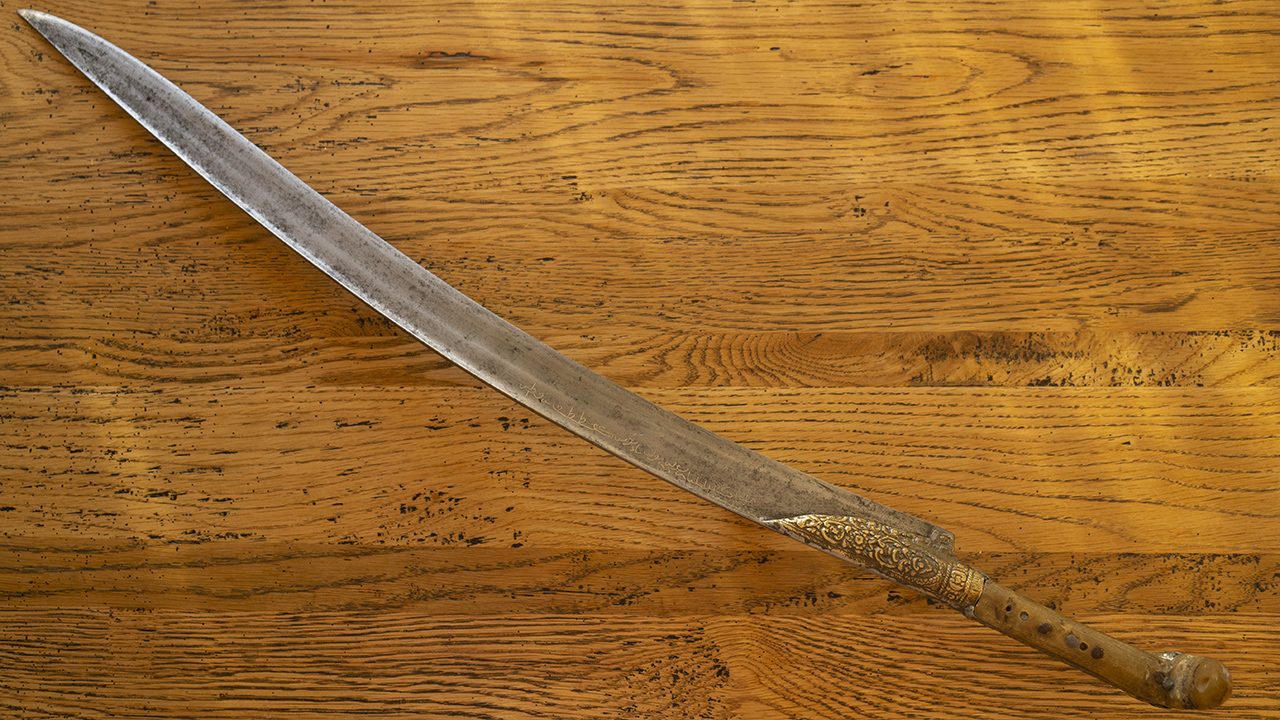

Default Identifying horn species on a yatagan hilt

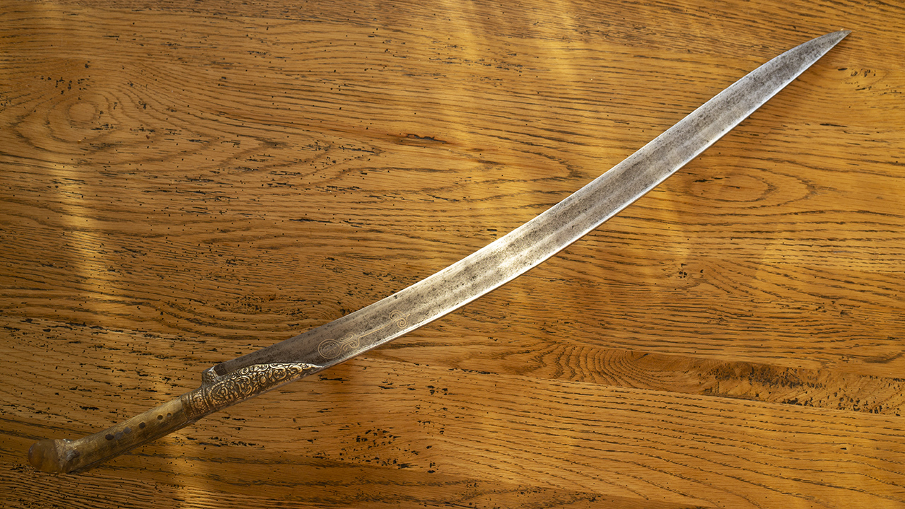

So I got this zeybek yatagan with its distinctive T shaped hilt, a nice twist core blade and some silver inlay, and what I thought was a wooden hilt in the photos turned out to be horn.
Is there any way to identify the species it came from?

Can we have a photo of the whole thing please.

There is a reason I asked for a pic' of the whole thing... More clues!

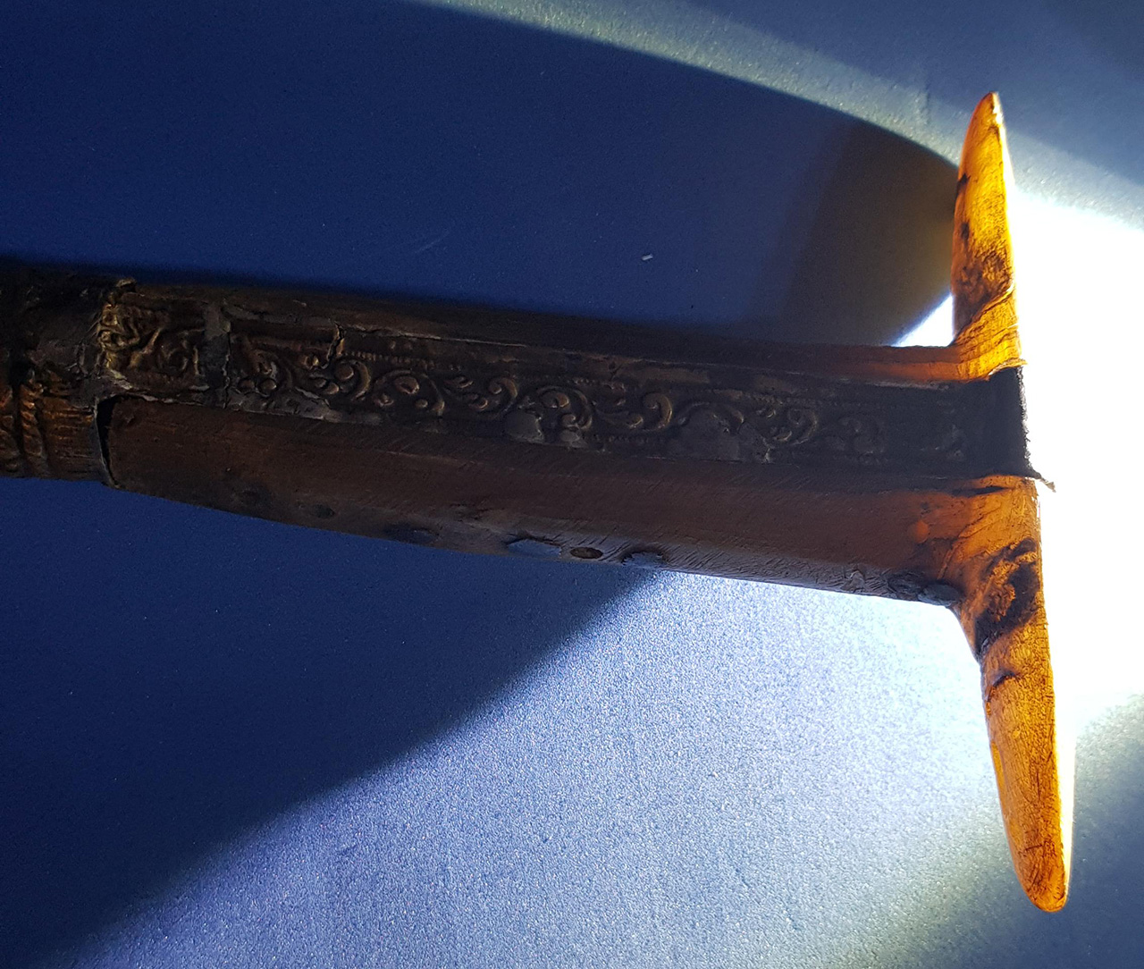

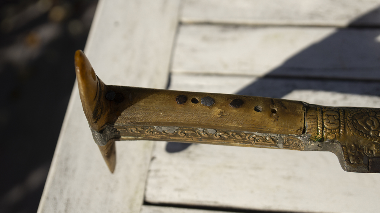

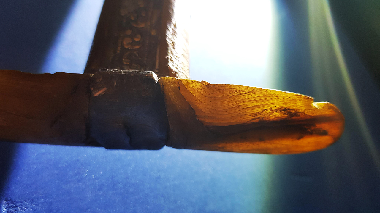

More photos
ipostswords is offline   Reply With Quote

Why is it bovine and not Rhino...? Its translucent and has the grain of Rhino...Therefor l suggest Rhino.

I have handled albino carabao horn before and it doesn't seem to be translucent like rhino, nor is it as fiberous as rhino.
If there is an example of albino carabao horn that is translucent like this, please post so that we can compare and learn.

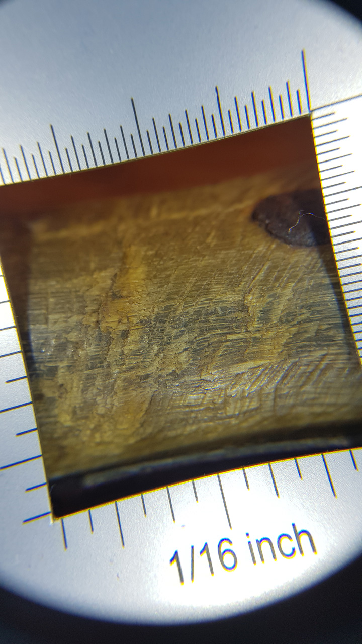

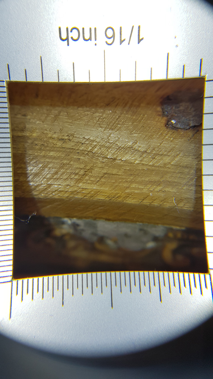

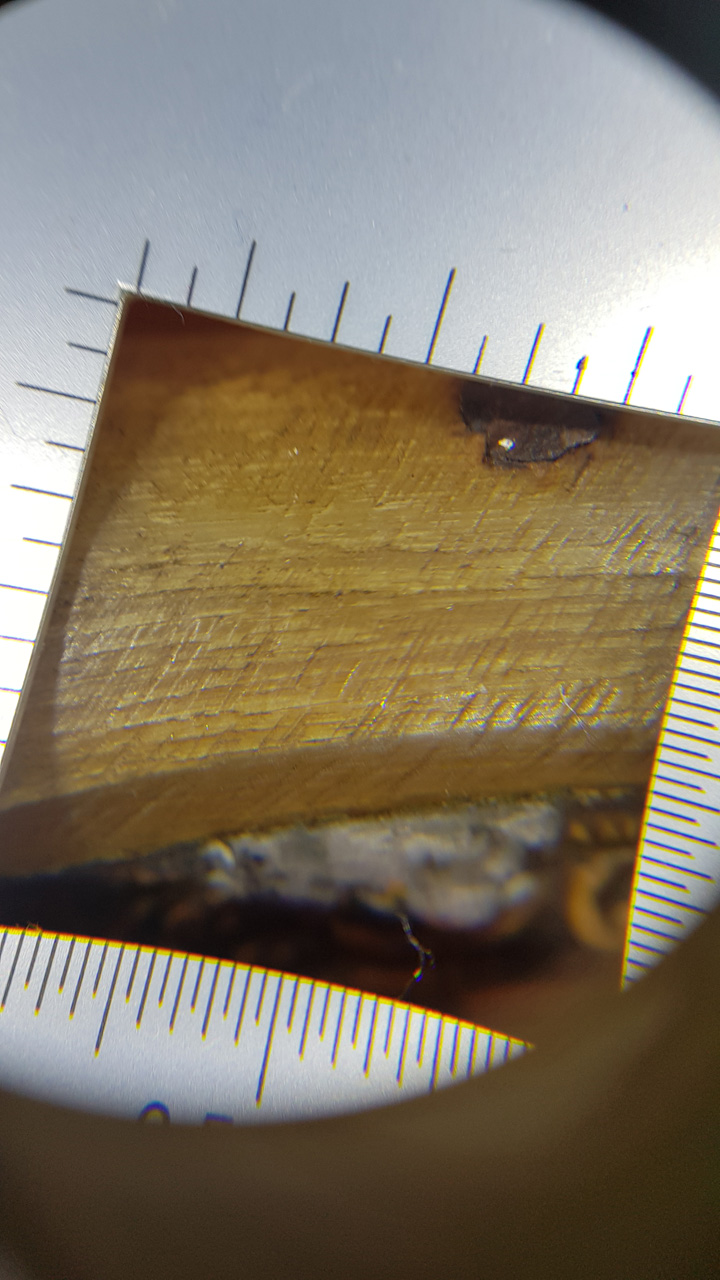

Posts: 6

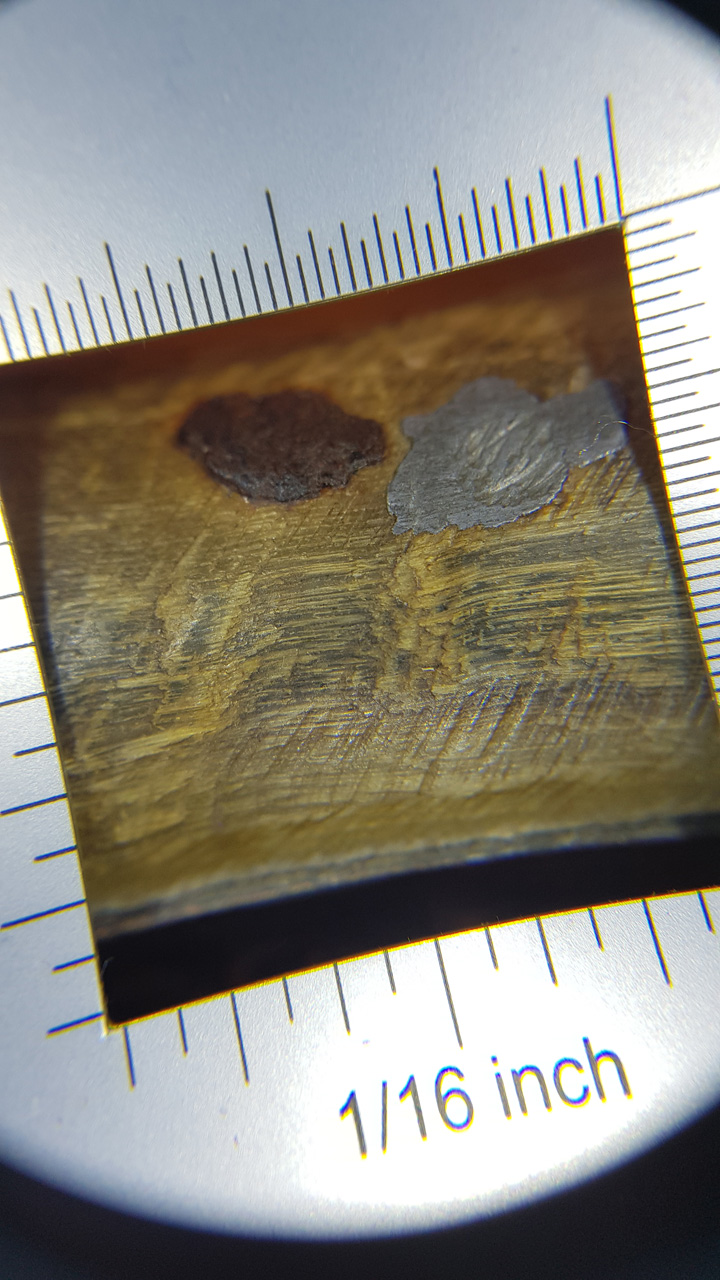

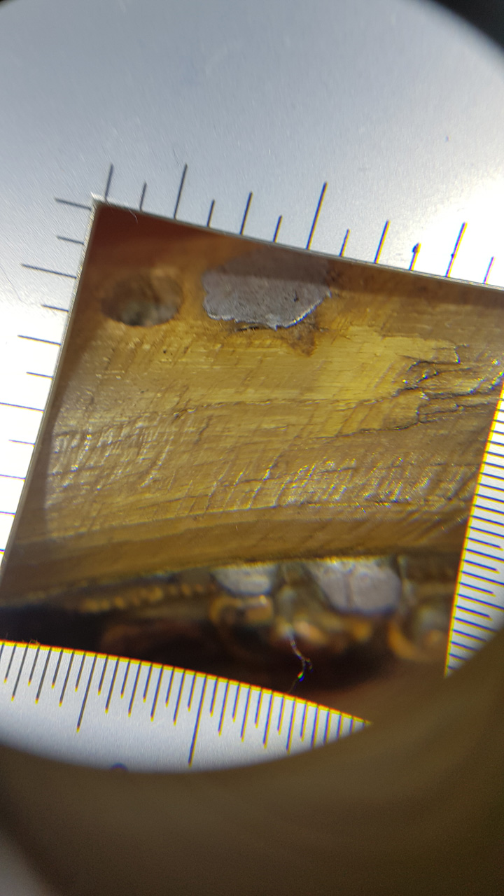

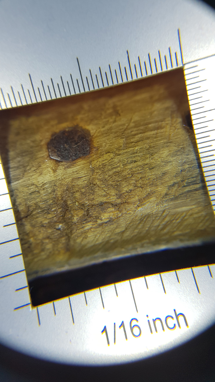

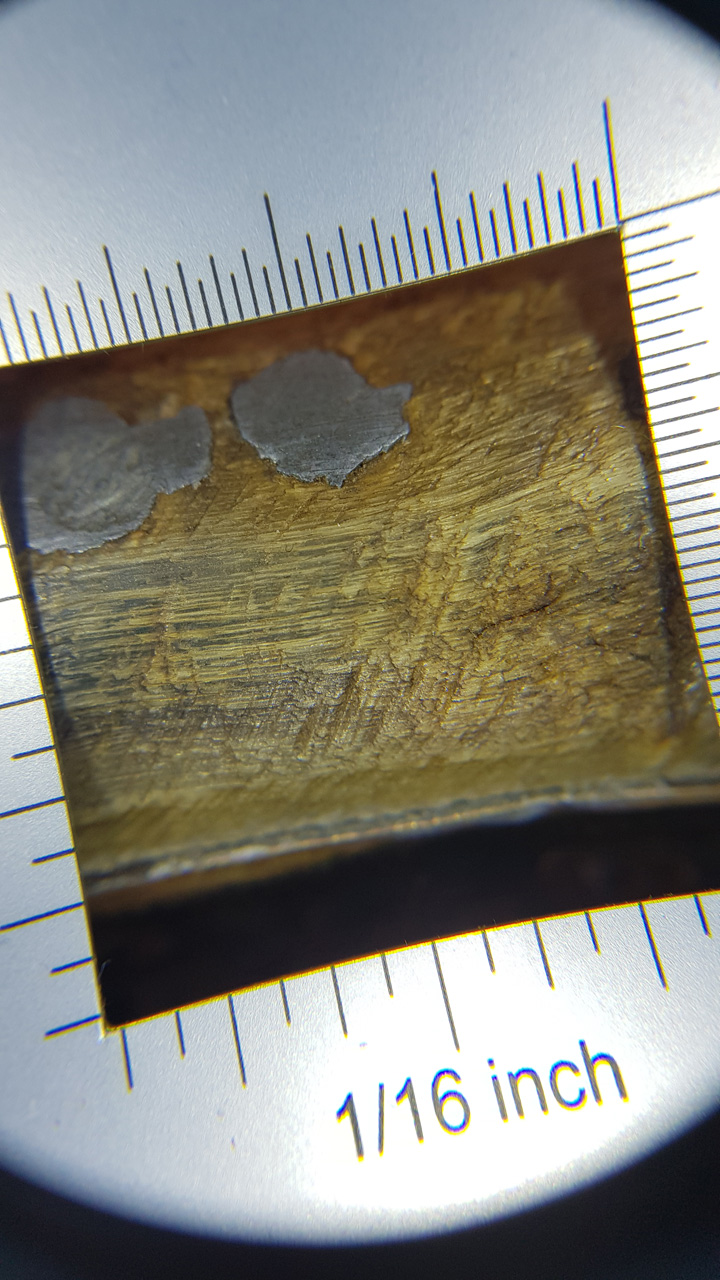

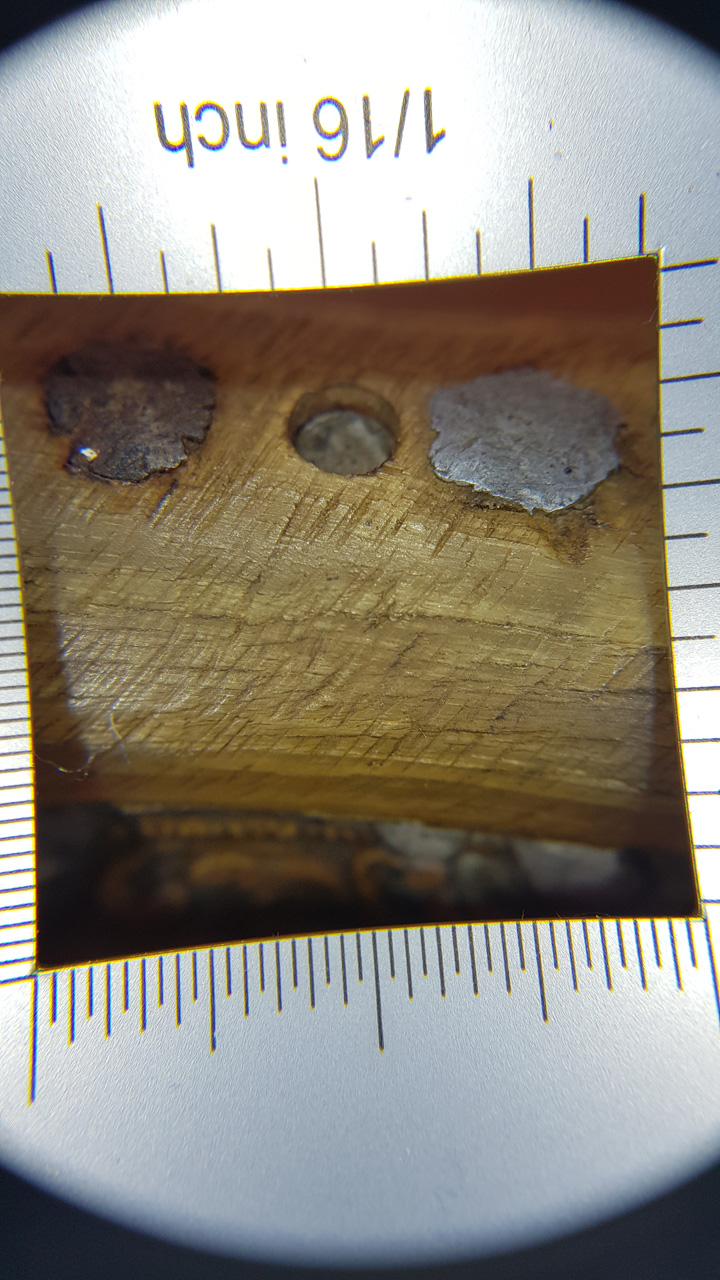

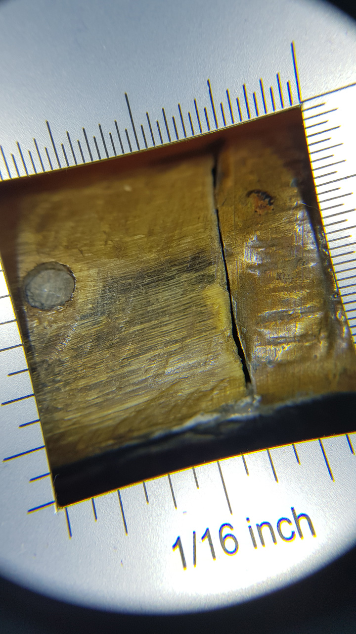

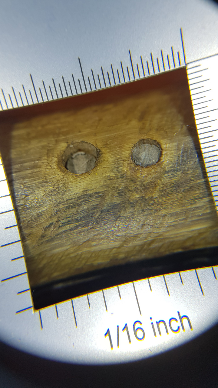

Some mildly magnified images

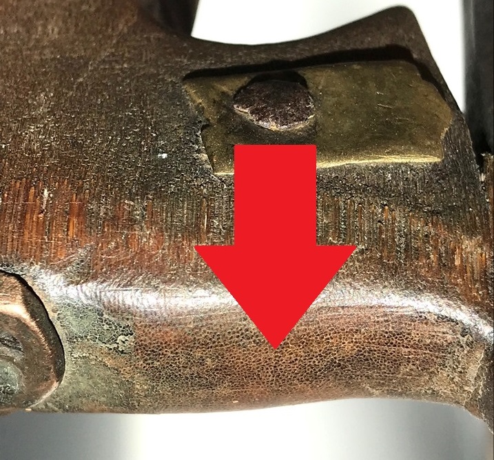

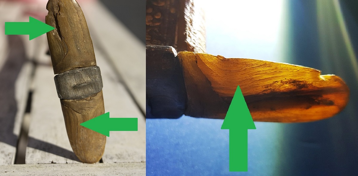

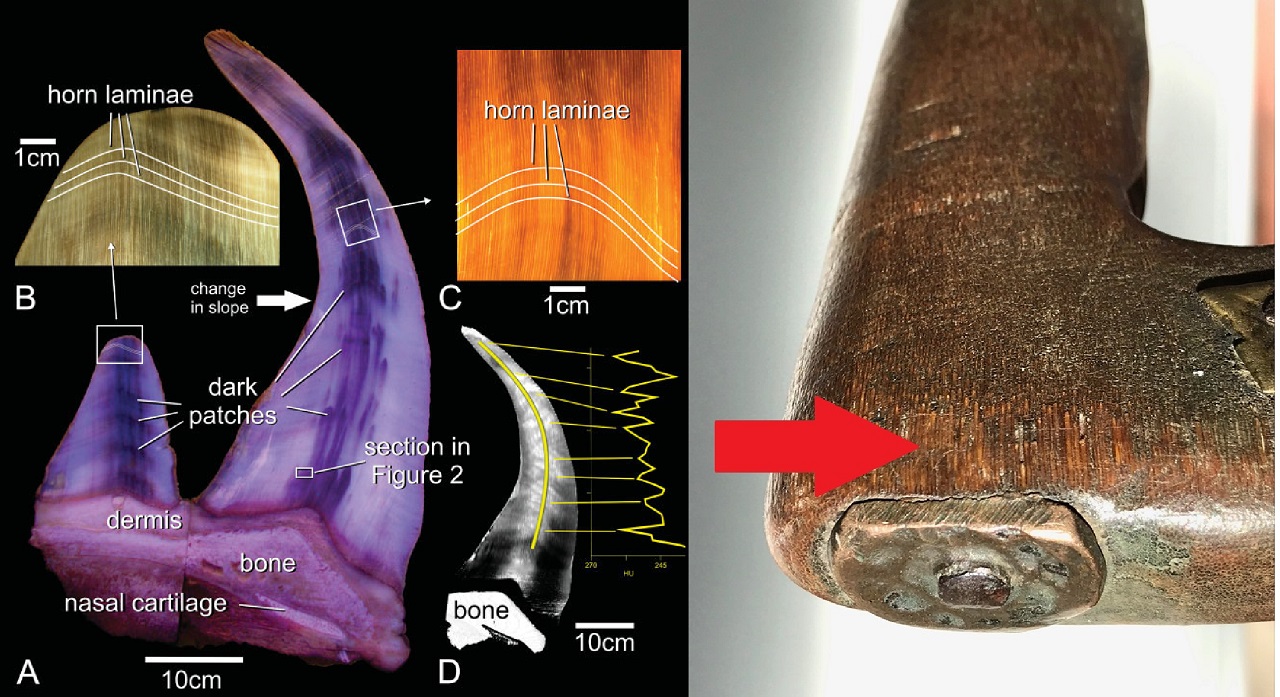

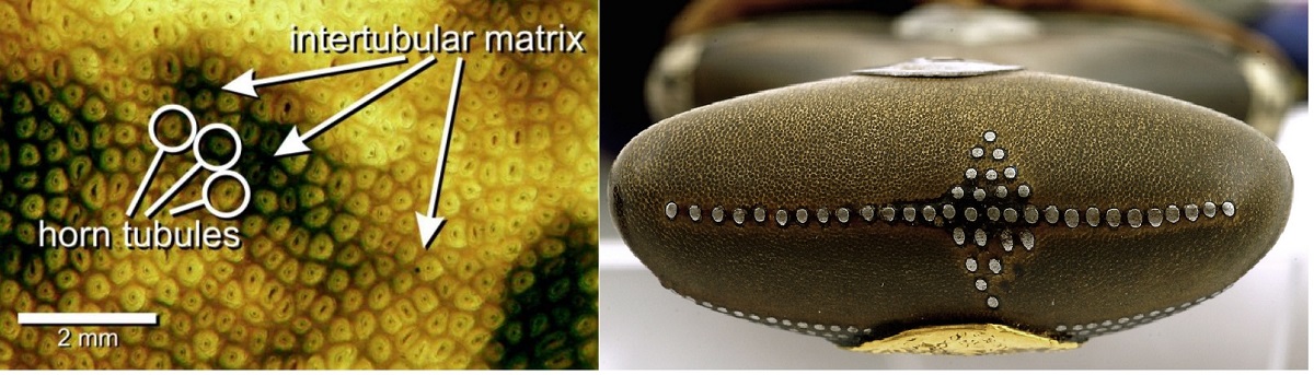

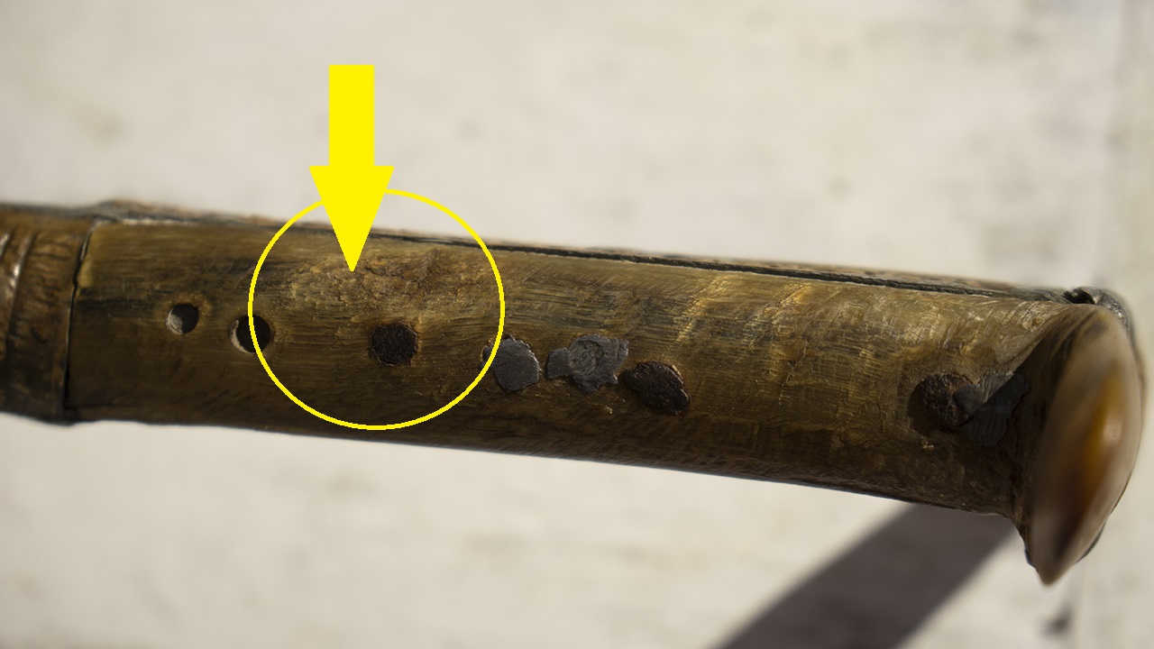

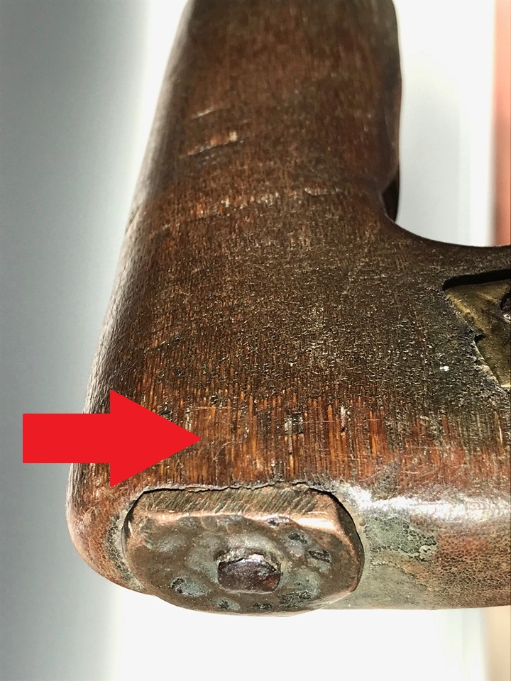

Sorry for my bad english. My 5 cents. I’ll try to explain about the rhino horn. I think everyone knows that a rhino horn has a structure that is different from that of a cow horn.
The rhino horn consists of special very hard hair that has grown together. The result is a structure in which the fibers are arranged - in parallel.
This can be seen in the photographs with red arrows.
If we look at the cross section of the horn, we will see a structure that is somewhat similar to the points - these are transverse sections of hairs.
On the subject that we are discussing, we see "curls" (indicated by green arrows), which do not happen on the rhino horn. And we do not see the "points" that occur on the cross section of the rhino horn.
In addition, the rhino horn is never stratified by “scales” (indicated by a yellow arrow). But such a stratification is found on old products from cow horn ...

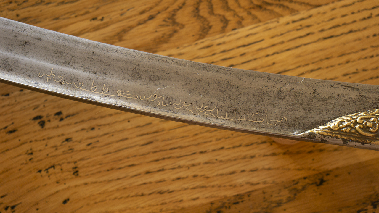

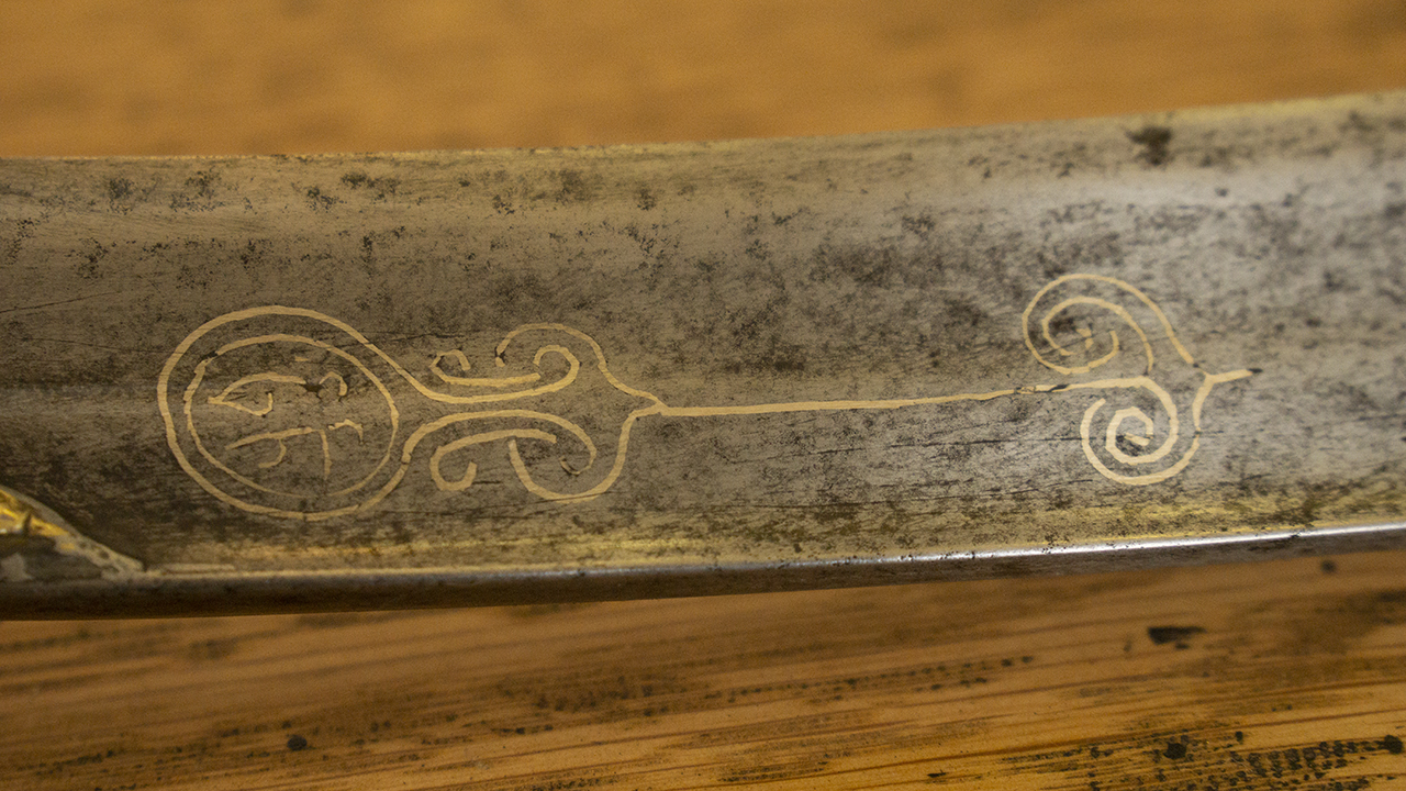

Not an easy one I agree ...and a rams horn ...is inscribed on the blade on your second picture...so... But the grip opposed to the ears is so hacked about it is almost impossible to tell ...but I will stick to the translucency test which indicates Rhino … probably very old but there it is.
Notwithstanding the horn ..this is a great weapon and a fine example.

Thanks for your help everyone. I think ram seems to be the correct determination, it hadn't clicked ot me that the inlay was a rams head on the blade, but now I can't avoid seeing it.
I think the best way to check for sure would be to remove the handle scale and see if it has the "spaghetti stand" end grain, but I don't want to damage anything.
Even without checking the end grain, I am satified to say it's rams horn

I think Sfenoid13 might be correct: goat or ram horn.

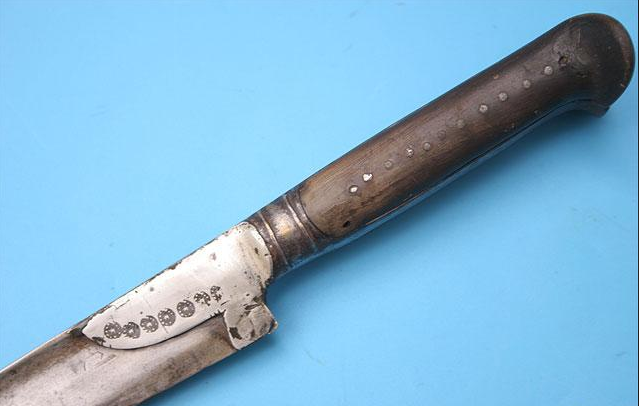

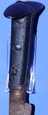

Also, this is not a classical Zeibek yataghan, the blade and the metal parts of the handle are of a typical classical generic Ottoman fashion. There is no integral bolster , no T-blade so typical of Zeibek. The meaty ricasso-located plates are of a fashion often seen on Balkan examples. All together, those parts are too sophisticated for being of Zeibek origin.
However, horn plates are genuine Zeibek: they are a later replacement and even have extra holes to prove it.

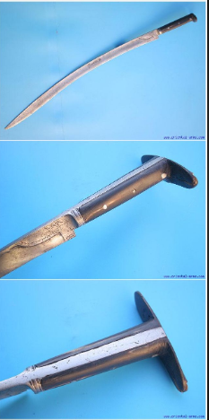

Couldn't see it, sorry. Usually, Zeibek yataghans are very simple, with few decorations, curved ( usually not even recurved) blade, prominent T-spine and integral bolster.

These are not mine, just examples from the net.
