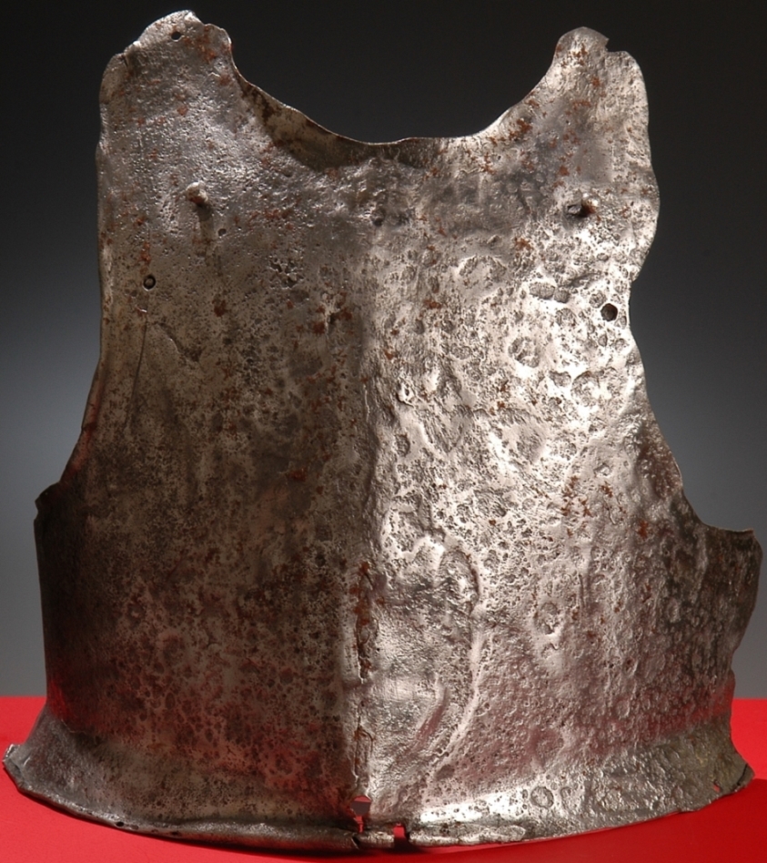

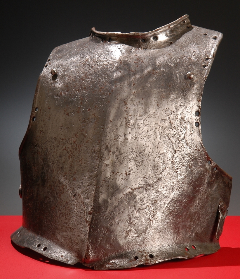

Default Breastplate for comments

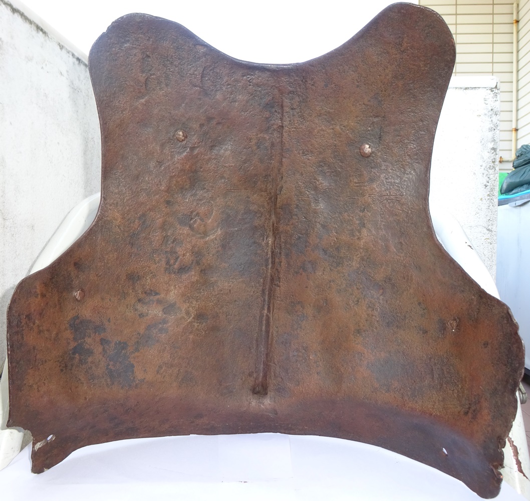

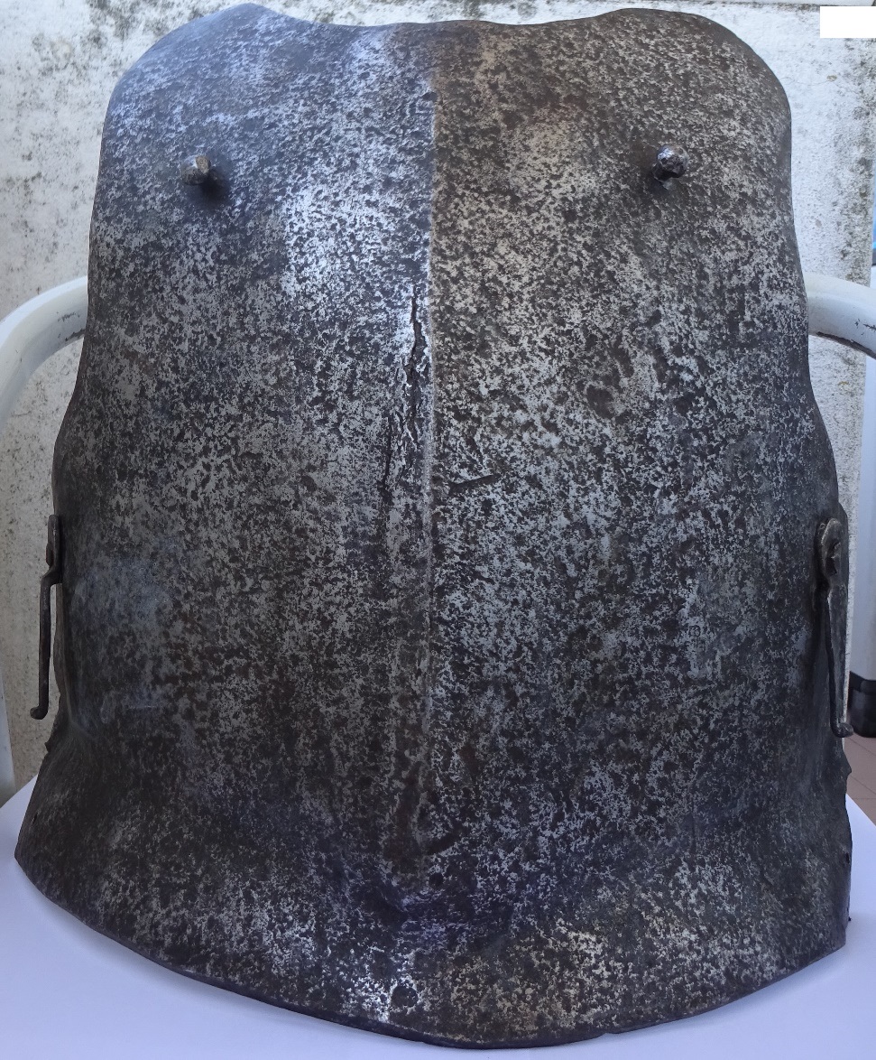

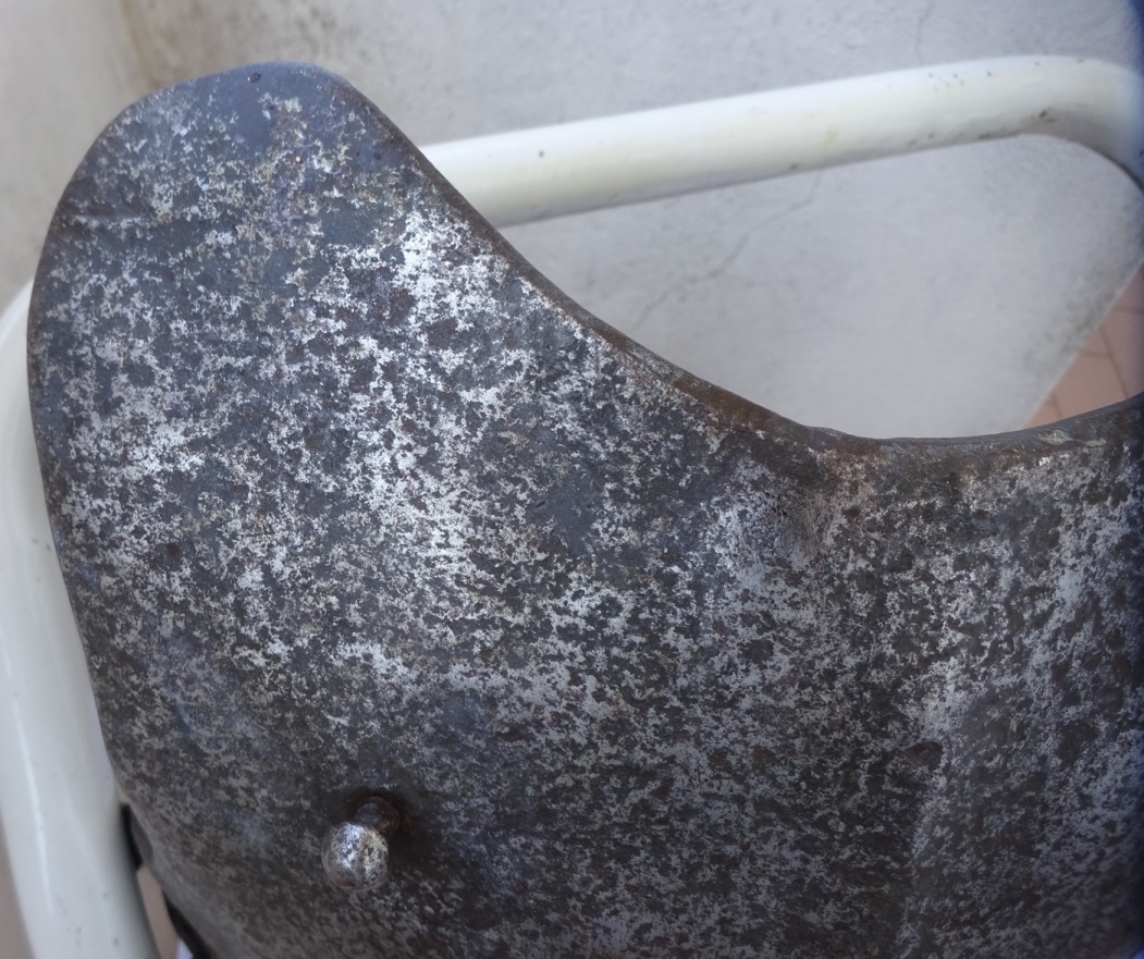

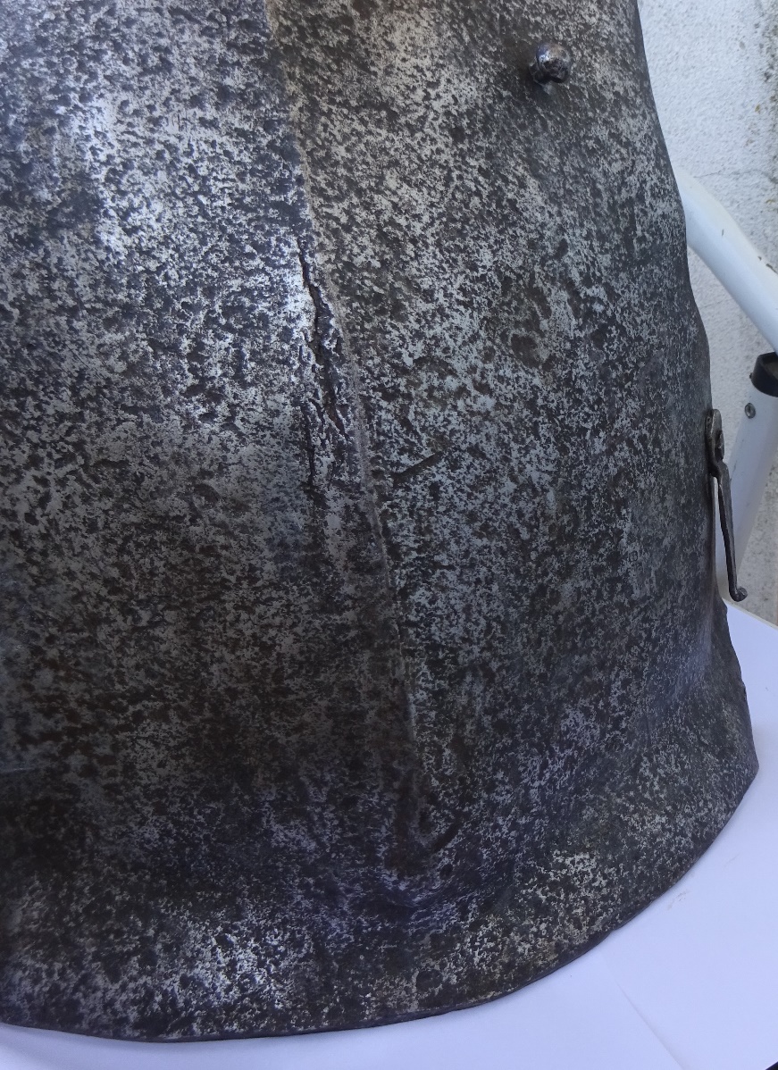

This is in principle of Portuguese manufacture, most probably coming from the Royal smithies of Barcarena; where production of these basic examples is well recorded, in this case to equip the common soldier during the Restoration War (1640-68). Usually smiths working in these facilities did not mark their work; my search for a possible mark resulted inconclusive, after some vinegar etching ... an adventure i regret.
It came with a finishing cover of varnish, which gave it an ugly yellowish tone; i had to strongly rub it with acetone, to bring back its natural aspect.
Made of one piece (non laminated) steel plate, weighing closest to 4 Kilos and measuring 35,5 X 35,2 cms.
I would be willing to receive comments towards this piece, whether positive or discouraging so, Gentlemen, please fire at will.

Wonderful find of a substantial breast plate. Since this is not my area of collecting do you have any illustrations of what the soldier would look like wearing this plate? What type of swords would accompany this?

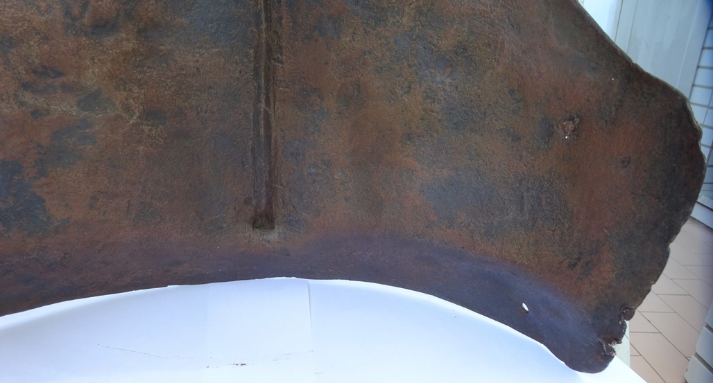

Is this breastplate an excavated find? It seems to have quite deep pitting all over on the front and the shape is a bit unclear. Interesting to see the strap fastenings as this gives an idea how the piece was worn. I recommend you put some mineral oil on it to prevent rusting. You seem to have done a good job of removing the yellowing varnish.
It almost looks like something you’d imagine a sapper wearing when removing mines.

I don't think this was an excavated find; the guy i got it from said this was included in a lot with various things (weapons, i gather).
These being humble pieces and not those belonging in nobility armour, are more subject to weather exposure and to the places they were abandoned, specially the side that was facing the ground. There is a similar example in the Barcarena museum which, together with a more refined one, with Switz marks and Swedish re-marks, were found by a sports diver near a place where actually XV-XVII century wrecks occurred; only that, judging by their condition and knowing that iron corrodes fast in salty ambiances, they didn't reside there longer than a couple decades. If only that couple could speak.

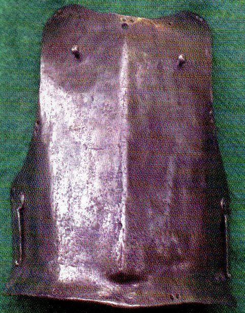

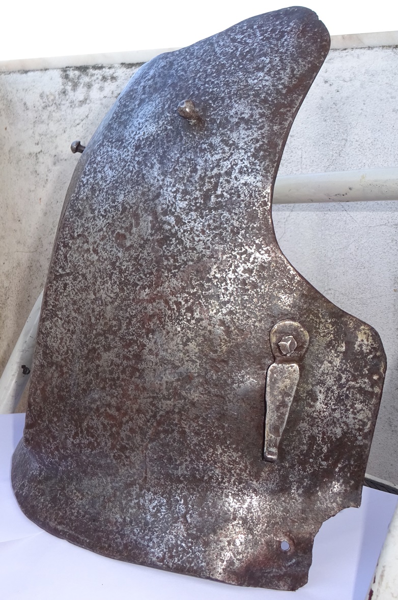

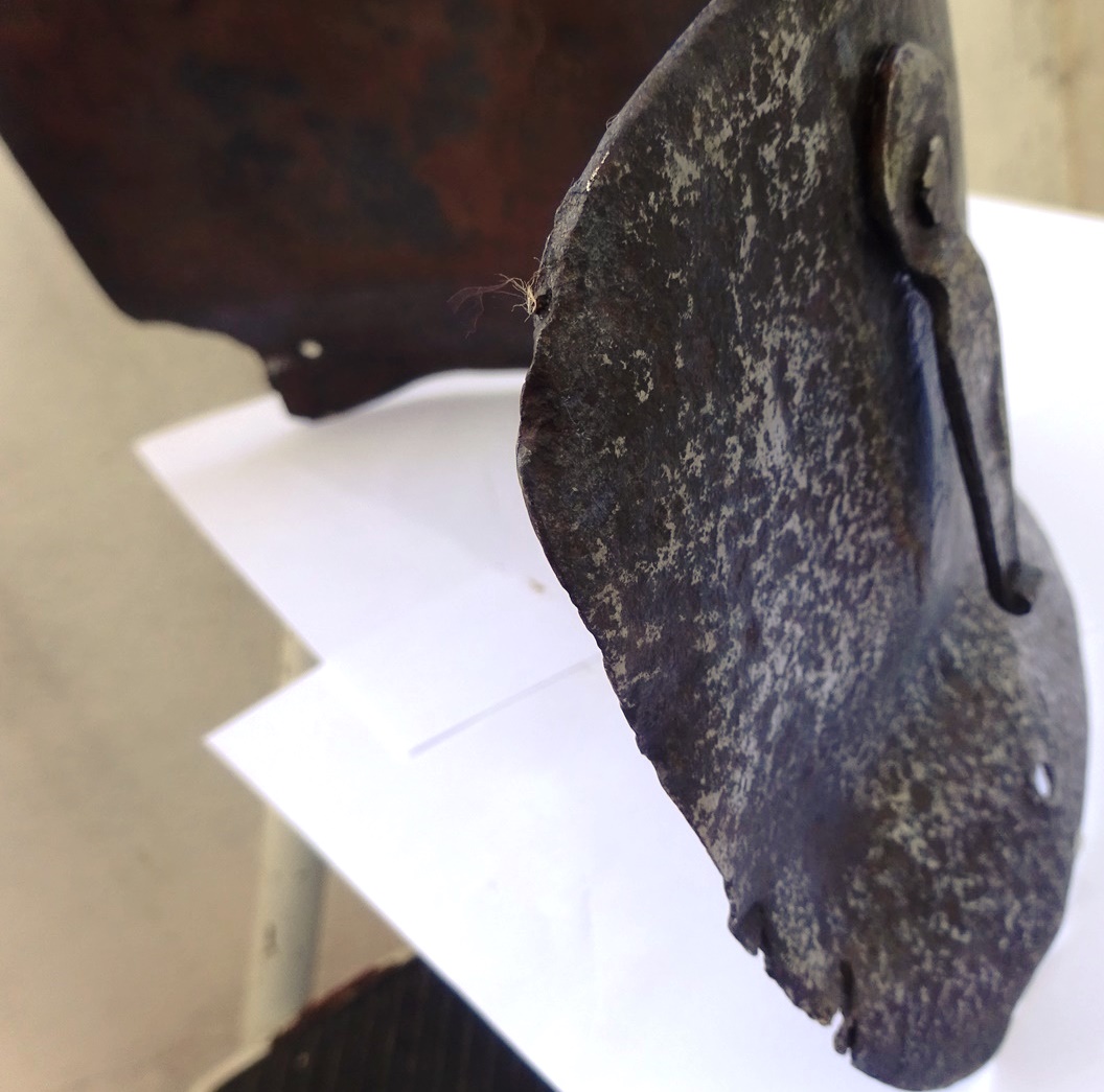

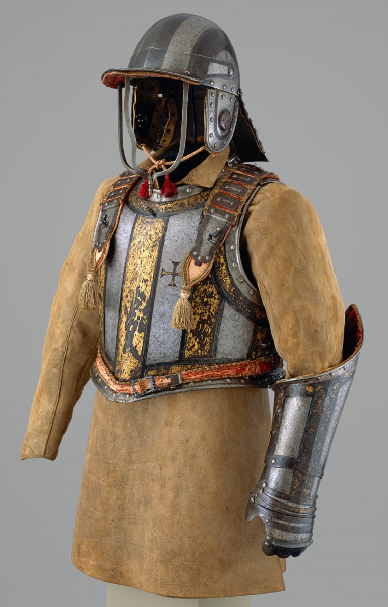

The last picture here uploaded is of yet another example, this one belonging to a private collection. In this one you can see again the strap fastenings, typical of pikemen cossoletes, while in the one at the museum, the text refers that only some residuals remain.
You will also notice that all these rustic plates were not made following the finest design; instead care was taken to make resistant.

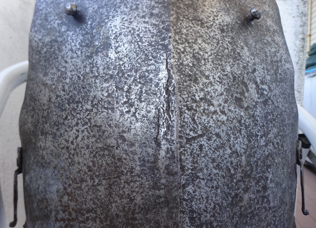

As for your wise advice to preserve mine with some oiling, that was the last of a multi episode saga. When i noticed that the varnish would easily scratch with a fingernail, i first rubbed it with a very soft brass brush. Lots of varnish 'powder' came off, but not the whole cover.That's when i gave it a double rubbing with acetone; then washed it with water & soap; and after pass it a gentle layer of 'sewing machine' oil.

Just some additional interesting pics I found on the subject.
Seems most pikemen’s breast plates were not shot proof marked. Presumably they were mainly for protection from enemy pikes and therefore perhaps need not be as thick as other breast plates. 4kg does not sound excessive for a pikeman’s breastplate. I have a shot proof marked Swedish 1680s cavalry breast plate that weighs about double that.

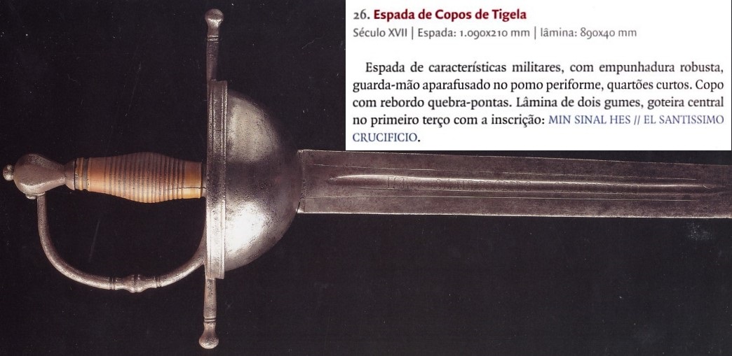

No cavalry sword type was mentioned Wayne, but cup hilted ones; and those you have them mounted on blades for all tastes, short, long, thin, thick. I have one with a rather small cup bowl, a wide blade but only 63 cms. long.
Actually i didn't find any specific description of sword used by pikemen; i gathered it was mostly the one used, as by the time, and not only, they were more than flies in number. And i have for myself tat pikes were not only abandoned as per virtual written tactics; they brake, they fall, they may become clumsy in determined circumstances. Having a sword at hand in real crude battle was a comfortable ally.

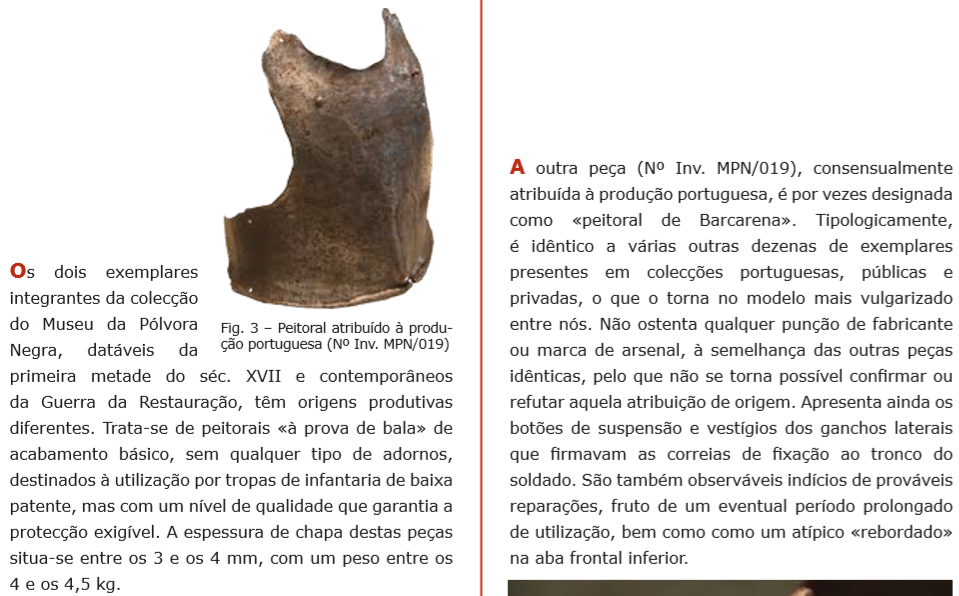

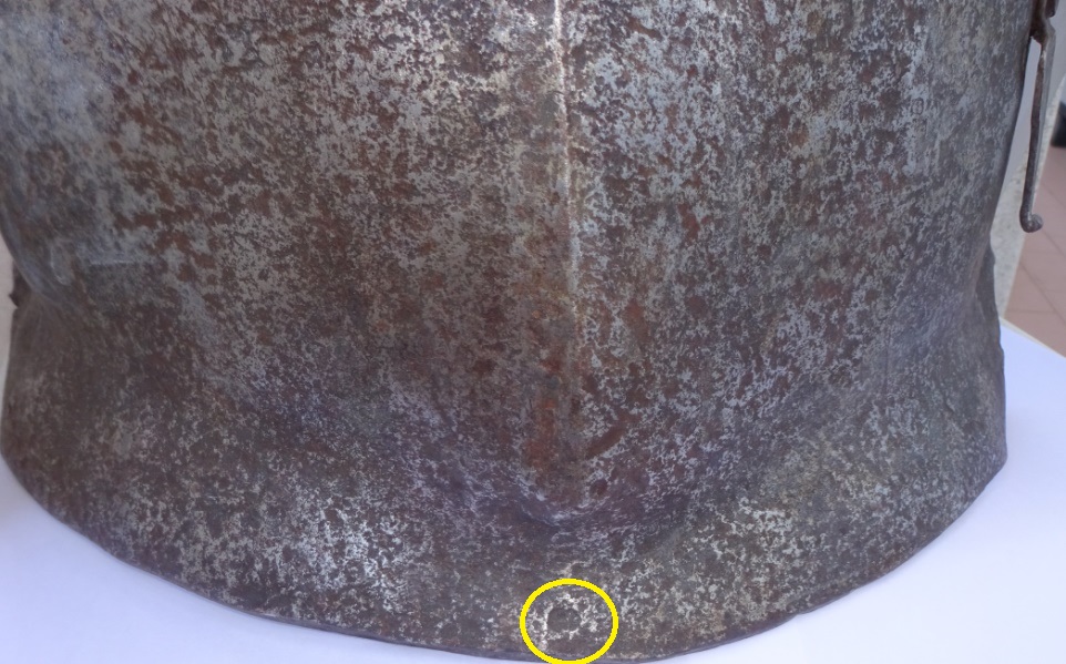

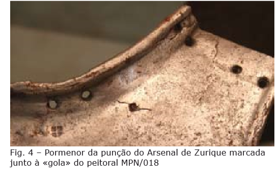

Concerning weight and shot proof tests, considerations would be; In the texts produced by the Barcarena Museum, breastplates made over there were subject to such tests, although i don't notice such shot in my example but, given the benefit of doubt, tests may take place as checked by the inspector, and not show the shot mark ... whether this was performed with a lighter musket or a lighter load. Curiously the other example exhibited at the museum is one made in Switzerland (Zurich arsenal) to export to Sweden, which ended up in Portugal in 1642 when Queen Cristina got rid of a lot of equipment after the years war. This is a more 'sophisticated' version,with signs that it has been lined, and also with strap fastenings... but no shot proof mark either.
Curiously it is recorded has (also) weighing circa 4 kilos.
Obviously your example weighing about the double served a different purpose; notwithstanding all that weight may not only be about thickness but also about (higher) measurements, to fit a men's in another manner.

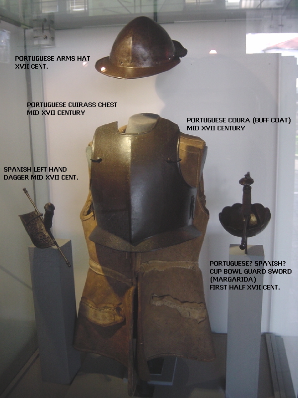

I was talking more about English pikers. The Spanish/Portugese ones favoured the cup hilt swords, English, not so much. I note in Victrix's entry above the sword hilts do show a couple cup hilts, the rest were more open styles.

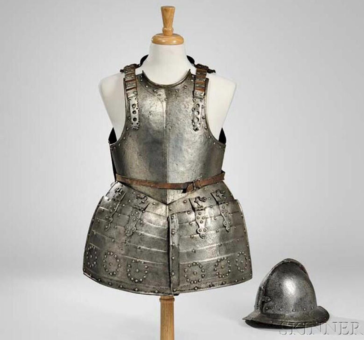

I read that the 17c english armies went with infantry about 1/3 pikemen, just under 2/3 musketeeers with a few miscellaneous other types. The drawing I posted would seem to indicate the officer is the armoured one with the sword, and the unarmoured ones were the cannon fodder. but i suspect the armoured ones in front were being bossed about by the unarmoured older dandy hiding in the second rank pointing forward and the armoured ones were just lucky to have accumulated expensive armour. Alexander's sarissa pikemen probably were not quite so uniformly accoutored either. (They must have acquired the elephant along the way to India )
I'd found a nice modern photo from the same perspective as the macedonian photo of a group of english re-enactor pike persons from the sealed knot, all in buff leather coats and morions, but the two most prominent were rather excessively heavy looking and even more obviously female. Didn't think they were quite representative for here. Mean looking tho. They were their own shield wall.
