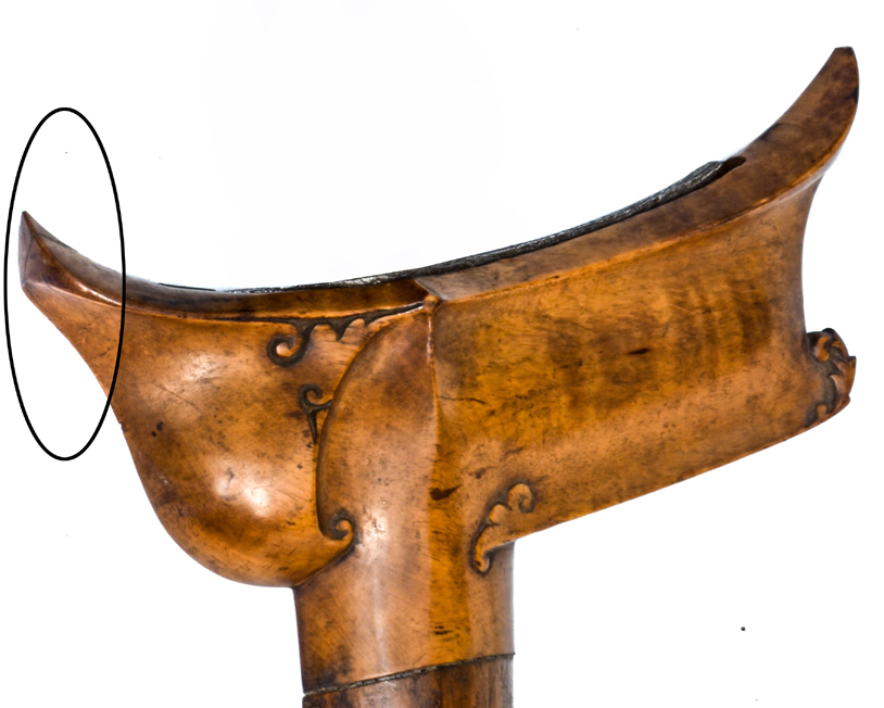

What about this warangka type.
From the one hand it looks like a Madura daunan model ( with broken wing) but it was labelled as 'possibly Malaysia'.

Hello Paul,
Please show us the whole scabbard as the gandar is important for identifying the provenance.

I am not going to guess what this might be, because it is a little bit unusual, and I'd really need it in my hand to support any guess.
However, to me, it looks very much like the ladrang type that starts in Tegal and runs all along the north coast into East Jawa.
Actually, when I saw the first example of this type it was introduced to me by a very well known collector who lived in Malang and who considered it to be an East Javanese ladrangan, I only found out much later that it could be found all the way through to Tegal.
If we strip it of the ornamental enhancements, what does the form look like?
If we consider the enhancement at the ri pandan, where do we often find that, or a similar, enhancement?

OK, here's a guess:- North Coast Jawa, Pekalongan, or thereabouts, probably for a Chinese gentleman --- that's if everything belongs together from day one.

The scabbard looks from South Sumatra to me in spite of the unusual carvings, but the blade & hilt from Java North Coast indeed.

The basic shape of the wrongko also strikes me as north coast.
If the other components are original to the ensemble, then the jejer decorated with megamundung would seem to point in the same direction.

David, anything is possible.
What I have given is a guess, it is not intended to be a supportable opinion.
In the blade itself I can see certain indicators that suggest North Coast.
In the hilt there is a very clear North Coast motif that is usually associated with Pekalongan.
I'd like the wrongko in hand before I said too much, but what I think I can see is that it has the profile of the Tegal - North Coast - East Jawa ladrangan style, and it appears to have pointed tips to the top (godongan, angkup), carved enhancements such as are on this wrongko, are common in wrongkos from East Jawa, Madura.
I don't think I've seen a South Sumatera wrongko with pointed tips like on this one.
Madura styles influence the North Coast, I do not know these carved enhancements in South Sumatera --- they might exist, but I have not seen them --- additionally, Chinese gentlemen are known to not be averse to moving away from traditional style if they wish, they usually are not bound to kraton dictates or family mores, they do what they wish, Pekalongan is a decidedly Chinese influenced part of Jawa.
Another thing to bear in mind is the Javanese influence in keris style on South Sumatera, especially Palembang. Palembang wilahan sometimes look exactly like Javanese wilahan, and it is impossible to know if they were made in Palembang or in Jawa.
The above is the rationale behind my guess, and it is a guess, not an opinion, I could only give an opinion in this case if I had the keris in question in my hand, I'm not good enough to do it from photos on a computer screen.

In the blade there are also equally strong indicators that suggest Palembang.
Gambar is a Palembang form, Gandar with squarish tip is typical for South Sumatra/Palembang.
Strong Chinese community with influence on art also in Palembang, see lacquer work, furniture, but the cloud motif, as suggested, points to North coast Java (Cirebon).
The carvings on hilt and Gambar obviously correspond. There could be a possibility this being an original ensemble.

Thanks for putting that pic up Gustav, yes, looking at that wrongko I'm seeing details that I have not previously seen on a South Sumatera keris. I think in light of that example I'd be quite happy to add South Sumatera to the guess basket.
However, as far as the blade goes, it is pretty much as I have already said, there are elements that suggest north coast Jawa, in fact, there can be no elements in the blade that suggest South Sumatera or Palembang, because there is no blade style that is unique to Palembang or South Sumatera. In Palembang, locally made blades copy blades from other areas, so we cannot really know if it originated in Palembang or if it came from somewhere else. In other words, tangguh Palembang does not exist --- even though some Jakarta dealers would like it to.
Regarding the motif, whilst it is true that the cloud motif originated in Cirebon actually dating from when Sunan Gunung Jati married Ratu Ong Tien (who was Chinese), the motif can be found in a number of other places too, and especially along the North Coast, in batik and in wood carving it varies a little bit wherever it is found, a batik expert can tell the differences, I cannot, but I do understand just a little bit about these motifs, and to my eye, the way in which this particular hilt motif is carved looks more like Pekalongan than Cirebon style. But I'm no expert, so I'm happy to settle for "North Coast".
Thanks again for the pic, where is it from?

If we look at this entire ensemble, there is one thing about it that really screams, its not nice, and that is the proportion of hilt to wrongko, its gawky, unbalanced, the hilt sits much too high, like an after thought, just plain horrible.
Maybe what we have is a keris along with hilt and wrongko that went from North Coast Jawa to South Sumatera, the wrongko was unsuitable for Palembang --- or wherever wear, so a new one was made, and the present selut was fitted to the hilt. This present selut is certainly identifiable as Palembang or South Sumatera.
My feeling remains Chinese involvement, and knowing the way Chinese businessmen moved (and move) around, that seems reasonable to me.

Old 19th December 2018, 01:30 PM   #27
Hello Gustav,
Congrats, that's a great catch!
From what I understand at the moment and am able to see, the blade could be earlier then 1800, the dress perhaps before 1850.
D'accord. As you mention, the edge seems to have seen some revision; still it looks like the blade was slender to begin with...
What about the inlay? Any translations forthcoming? (Close-ups would certainly help.)
The hilt really seems to be one of those one-offs that clearly exhibit Chinese taste and probably got commissioned for wear by a Peranakan (which doesn't help in placing the ensemble since this could be just about any trading port throughout the archipelago as already mentioned).
IMVHO, the scabbard seems to be the best bet in placing the ensemble.
Old 19th December 2018, 01:59 PM   #28
Gustav
Join Date: Jun 2009
Posts: 1,346
Kai, thank you.
the revision of the edge seems to have been repeated a couple of times.
The Odo-Odo is quite out of center at the second Luk. I would say, the blade there originally was still 3 cm wide.
And, just to illustrate the subject I wrote about in my last post, a riddle for all viewers - from where originates this Keris?
The smaller picture is a picture from a booklet by Solyom about a Lampung exhibition. Try to pigeonhole one of them and you will get nightmares.
Speaking about that region (N/W Java - S Sumatra) you can be sure of very little.
