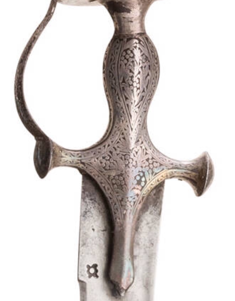

Greetings folks,
I appreciate your interest in my topic.
I’m wondering if anyone could shed some light onto the origin of the stamp on this sword. The sword is from the 19th Century India.
I look forward to the replies.
Thank you.

Welcom to the forum.
Please show the whole sword. Why do you think it is the kind of sword you write it is?
The mark can be seen on many Indian swords, sometimes only one mark, but mostly several marks of the same kind.
Old 4th July 2019, 04:23 AM   #3
Posts: 10,865
I also welcome you here! and as Jens has noted, an image of the entire sword is helpful as the designation of 'tegha' is often misunderstood and even misapplied on many Indian swords. While we understand your key interest in the marking, it is sometimes the case that markings may be better explained if full context is known.
For example, this particular mark is a copy of what was a known stamp used in Northern Italy, and often accompanied the 'eyelash' or 'sickle' markings which were profoundly familiar and often used by other arms centers.
These sometimes occurred in pairings or groupings as well.
They are from late 16th century, but used in Germany and Styria well through the 17thc.
India is known to have copied the 'sickle' marks often, but at times used this marking (sometimes referred to as 'mill rind' or 'twig' in European parlance) and often placed these in the blade location you show. In this location (near the distinctive blunted edge known as the 'Indian ricasso' on Indian blades, it seems this was some sort of traditional place to place these marks. Others used were the 'man in the moon' (from German copies of Spanish marks in 17th c); as well as the 'cog wheel' another Italian, then German mark same period.
The use of these marks on Indian blades spuriously placed carried well into and through the 19th c. representing venerable quality of earlier European blades.
The two first photos are similarly marked Indian tulwars with these type blades and the next a 16th c. European sword with similar mark...note blade location.

Thanks for the warm welcome. I was posting on my mobile device, which meant I was unable to resize the image as it was too large to upload to the forum. Alas, I've resized and uploaded an image of the full sword.
I may be wrong but after examining the thickness and curve of the blade, I recognize it as a tegha/tegh.. What are your opinions?
In regards to the stamp, I've seen many 'eyelash' stamps on various blades but haven't seen one like this ever. Are these stamps that've been put on the swords after battle? or simply a stamp of the manufacturer?
Thanks

You may call it tulwar on the basis of general construction and the general style of the handle, or you may call it tegha due to its wide and massive blade. That's the matter of personal preference and does not matter much : either name means a long-bladed weapon, a sword.
What is obvious, this is an Indian blade with a spurious European style mark.
19th century is most likely correct. Trying to pinpoint its origin by the style of the handle is an exercise in futility: handles were changed left and right and quite likely it was a second or third marriage for both of them.

bsingh, your sword seems to be what we mostly call a tegha. You may not have seen this marking before, but as Jim writes, they were used together with many other markings, copying European markings to show the 'quality' of the blade.

Thank you for showing the entire sword, and very nice example. As Ariel has illustrated, the term chosen to describe the sword largely depends on who is describing it. These are terms which may be applied equally in most cases.
It seems the 'tegha' term applies more toward a wider and thus heftier blade, and may refer to such with the 'Indo Persian' tulwar hilt, or perhaps in some cases to other hilt forms sometimes seen on such blades.
Some of these blades are not entirely wider and heavier but have a widened flare toward the distal point of the blade, thus heavier toward that point. The heavier blade itself augments the momentum in force of the cut, but these widened tip blades also perform that without the additional width in the rest of the blade.
This blade has the distinctly identifying feature of the 'Indian ricasso' with is the blunted, and blockish section near the hilt, and at the terminus of the blade edge there. The placement of these marks as noted were often situated in this location, and it would seem stamped in most cases. In this 'cogwheel' or 'solar' example, it looks as if it is stamped, and remarkably like the European versions of this long used mark.

Be aware of, that deep stamps were made while the blade was still very hot, and not so deep stamps were made on a 'cold' blade.

In-person analysis of Tegha sword:
Hilt:
Silver Inlay/Koftigari:
85-90% of the original silver inlay (Koftigari) is still intact on the hilt. You can tell the koftigari was applied in very generously, the pattern is very thick and shows the royalty and power of the original owner of the sword.
In addition, you can tell the koftigari took a long time as it covers the entirety of the hilt.
Hilt Design:
The bottom disk of the hilt is manufactured to have a slight upwards position which would delegate how the swords would have been used. I also noticed a very rare cobra on the end of the knuckle guard - this must've been the first Indian sword hilt I've ever seen with such a hilt.
Hilt marriage with sword:
Upon inspection I'm pretty confident that the marriage between the sword and hilt were never "broken" as the "glue" or masala looks to be made from the same ingredients they were made back in the 19th Century. Plus, the blade is precisely in the centre of the hilt.
Sword:
The sword has the typical Indian Ricasso which actually helps with wielding the sword as it's not uncommon for the index finger to be rested on the bottom area of the ricasso.
The blade shows very little pitting. I can't put my finger on the material as of yet as I will be conducting a small restoration project in which one of the items on the list will be to etch the blade to see if there may be a pattern hiding under the polish.
Furthermore, the blade has a beautiful polished shine to it and is lightweight!
Stamp:
As other members of this forum have highlighted, the "Quality Stamp" on the blade located at the end of the ricasso is deeply inlaid. This would fortify the argument that the stamp was indeed put on the blade when it was still very hot.
