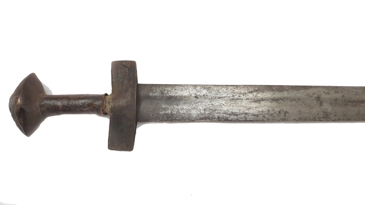

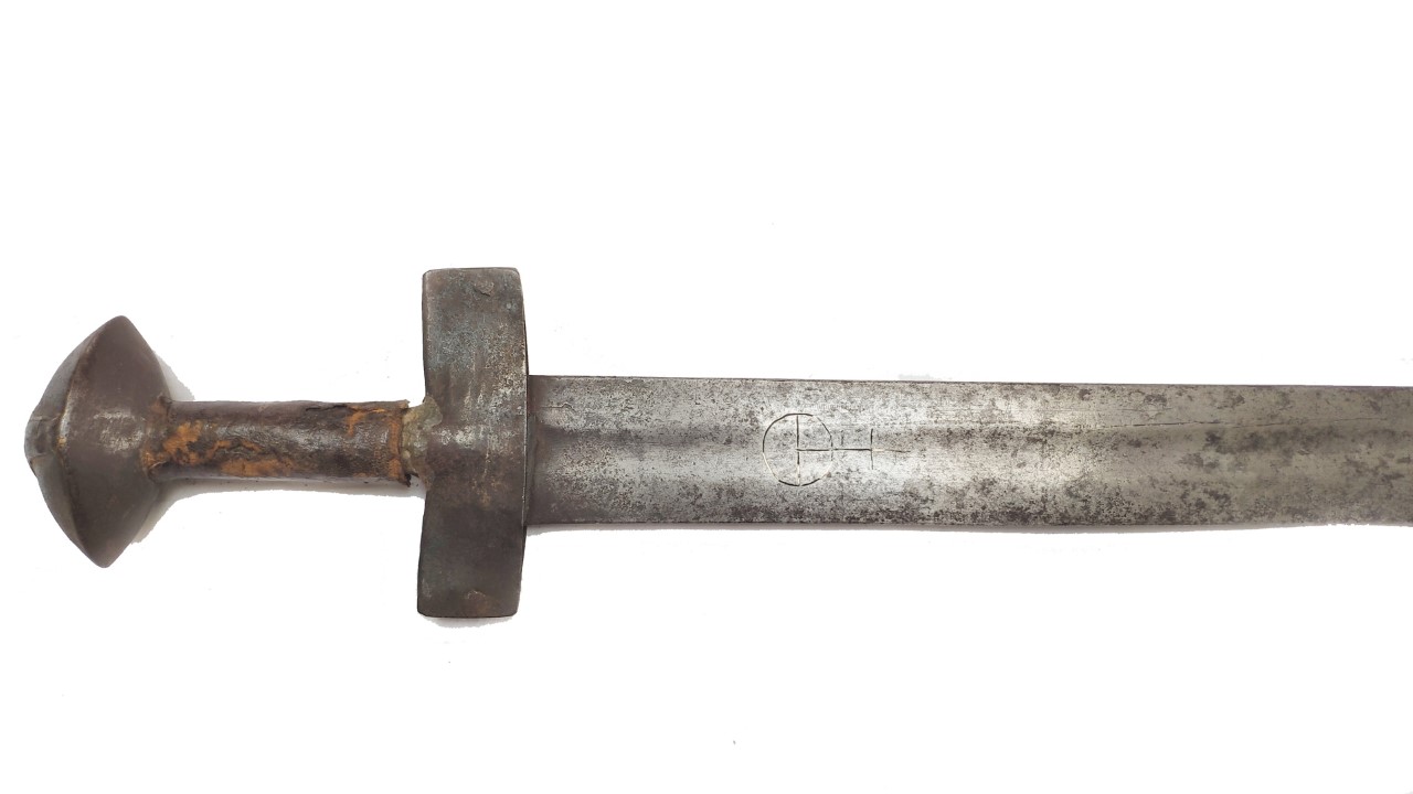

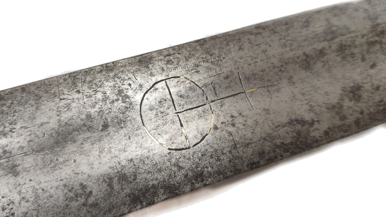

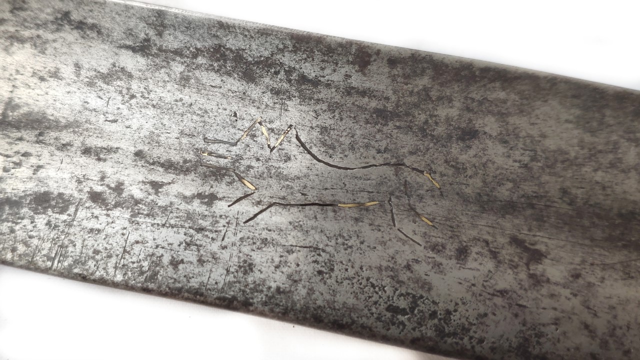

This was acquired for a friend, so I have been documenting it. Nothing we haven't discussed before, but a very nice blade with running wolf and cross and orb with original latten corresponding to the style common to the 16th century with this blade geometry. Might be a little earlier or later but this seems a fairly safe date range.

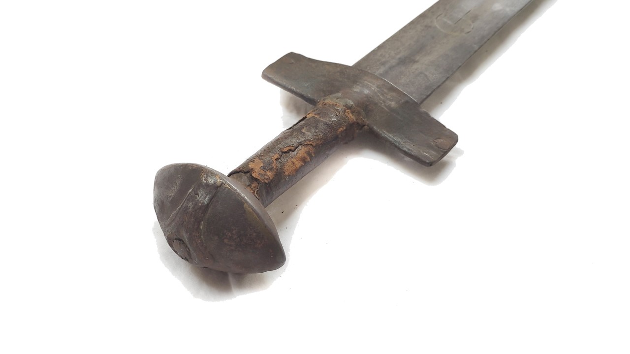

Nicely balanced hilt, but not the holdest hilt style, so likely early 19th century mounts or late 18th. No brass hilt plates as often seen on these old warriors, the guard was originally leather covered. The whole assembly is nice and tight, still very much a fighter!

It is interesting seeing this upper centrally situated fuller, to about 1/3 of the blade or slightly longer, as well as the application of the globus cruciger on one side and running wolf in the other, and in latten as often discussed.

The hilt I'm confident is 18 or early 19th century work.
The blade likely came into the North African Ottoman sphere very early via alexandria. I would guess in the 16th century where it remained. Shipments from Europe were frequent despite papal bans. 😉
