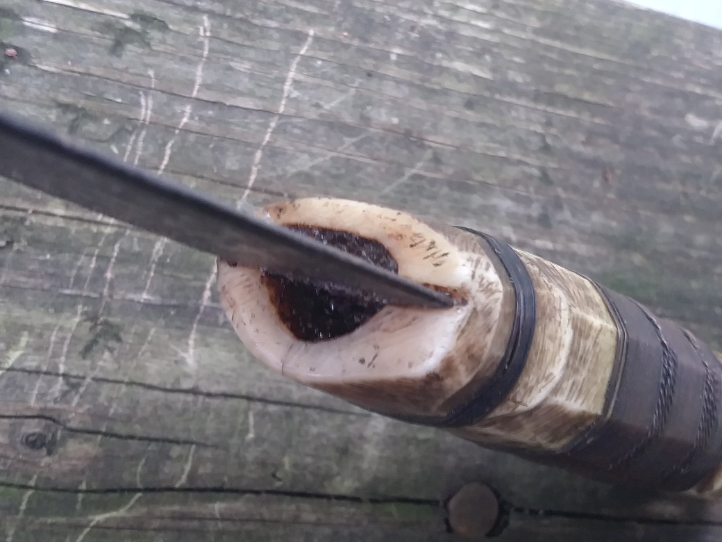

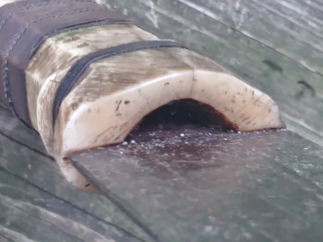

I have an old Sudanese dagger from the Mahdist era, with the typical etched inscriptions and a bone hilt, nicely wrapped in fine copper wire.
However, the resin or goop that was used to secure the blade is missing on one side. Even though the blade is fastened to the hilt, there has begun some slight movement over the years.
My question is, what ought I to use to fill the gap, to keep the whole construct from loosening further? The dagger is fairly commonplace, of course, but even so it deserves some respect toward originality and perhaps even reversability.

Old 8th June 2019, 05:22 PM   #7
Bob A
Join Date: Feb 2014
Posts: 472
Pictures as requested.

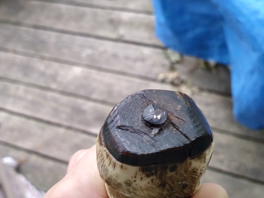

Dismounting might be a bit problematic. The tang extends through a horn end cap and is peened over. (See picture)
Ebay has a lot of damar, in a wide variety of colors. India seems to supply "black" damar; I suspect it's just in a less refined state than the rest. I am led to believe it is synonymous with Benzoin, an incense of which I have a few ounces left over from the 1960s.
I also assume the melting point would be high enough to prevent problems; stuff seems pretty solid.

Yes Bob, that peened tang would present a problem.
So patch. This jabung mix can be handled with bare hands, you make up the mix, heat it to fluid, then let it cool down until you can pick up a piece that is just warm enough to handle like putty. Roll a little bit, more than sufficient to fill the hole, between your fingers, push it into the hole, then heat up a little piece of steel, something like a nail, grip it with vice grips, and apply the hot steel to the jabung to melt it and let it penetrate the hole. When it is set, but not yet hard, use a bit of sharp wood to cut off the excess, clean up around the fill with mineral turpentine and a hard toothbrush.
