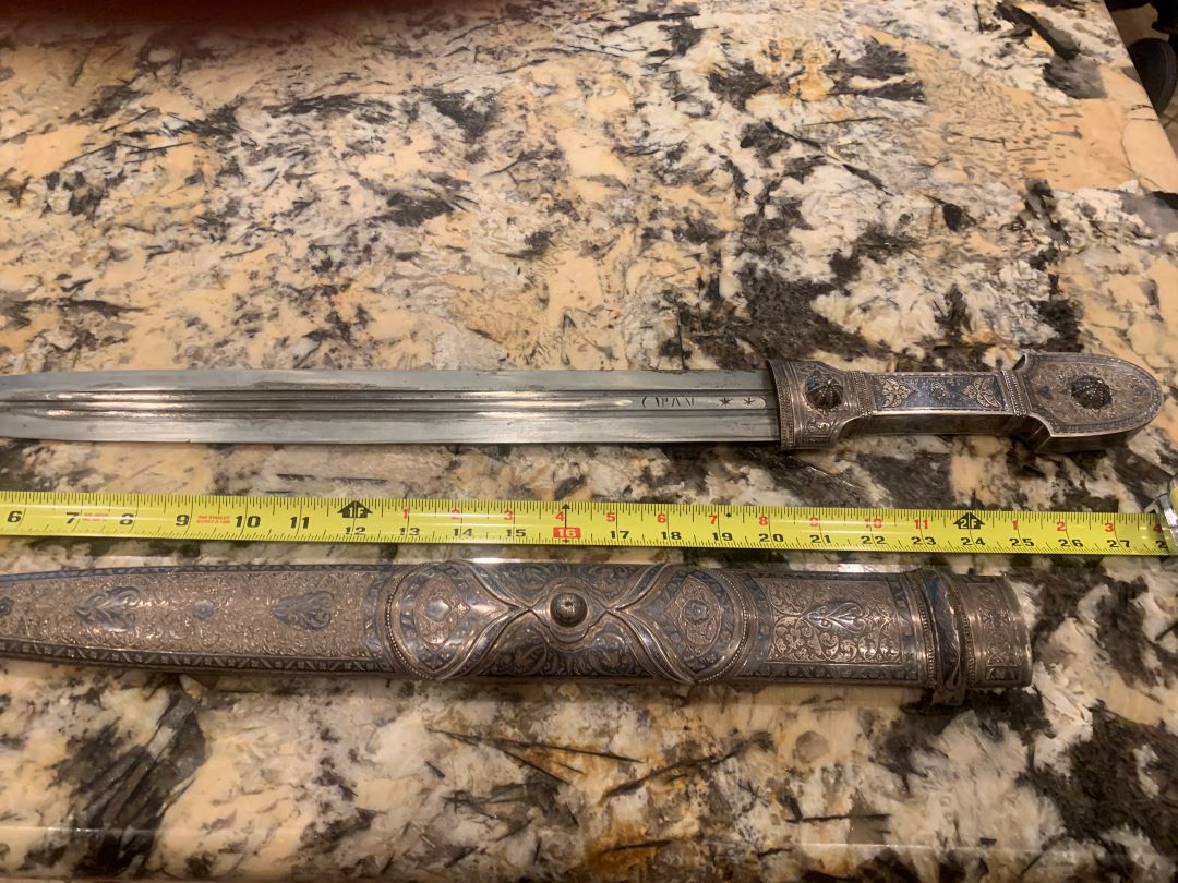

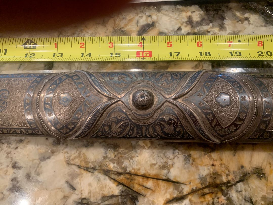

I acquired this sword in Oman. I don't know how it got there. I believe it is of Georgian heritage. The Arabic date (1287), stamped in the hilt converts into 1870. I am curious if the two asterisk’s have any meaning. I could find no other marks. It is 32" overall length, with a 8"grip and a 21" blade. Both sides are decorated in nielloed silver. I'm curious of what the group thinks of its origin. This is my first post I hope I have done it correctly. With Regards, rm

Hi RM:
Welcome to the Forum! You did fine in your posting of pics, etc.
This may well be a 19th C. Georgian kindjal, but others here are far more expert than I am and they can likely pin it down to a specific area or town for you.

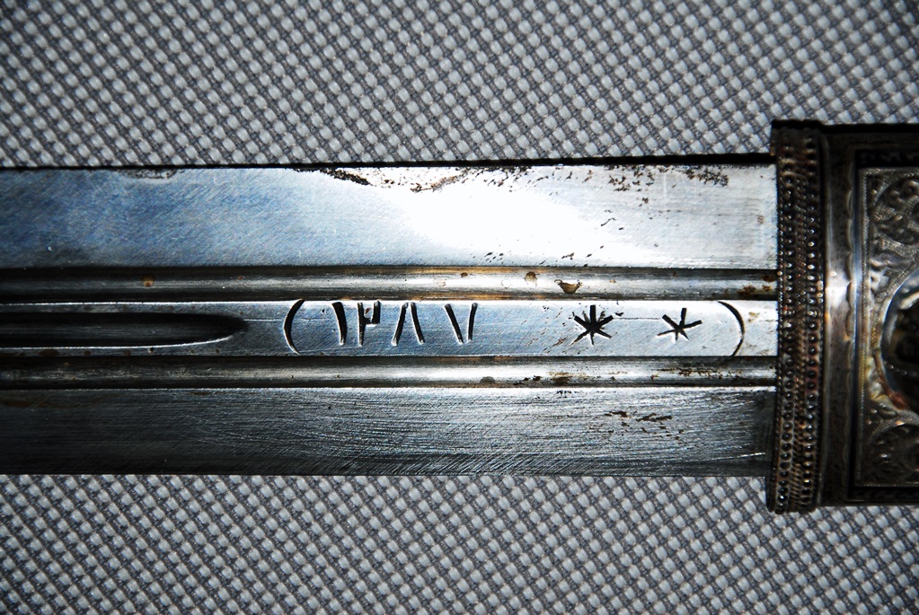

The date ok, but I don't understand the asterisks. Perhaps no meaning but why bother?

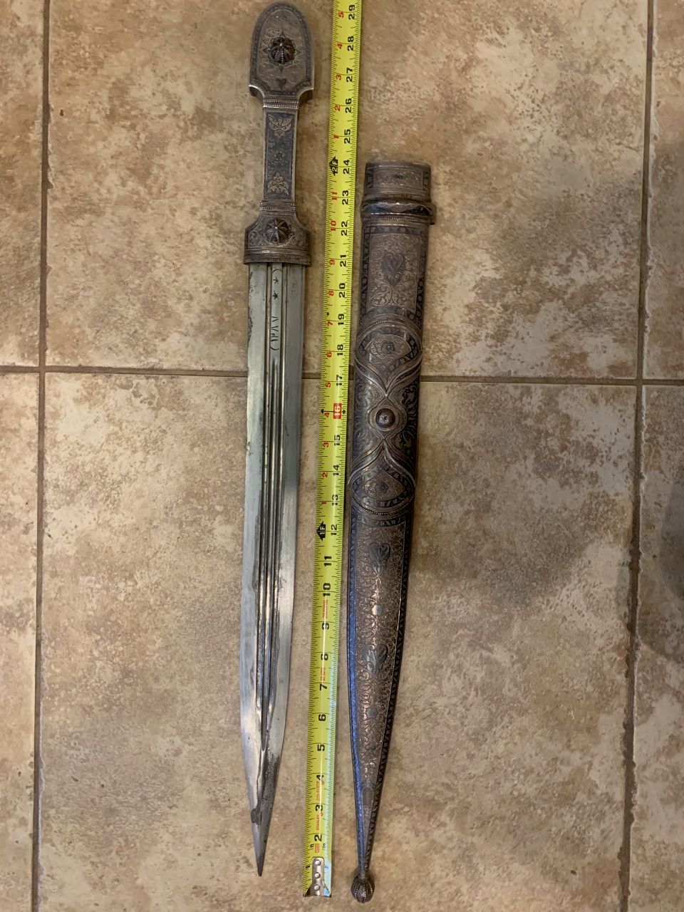

Can you please post a photo of the whole blade, not taken at an angle, so that the shape of the blade can be clearly visible?
1870 is probably a correct date, but where does it come from is much more tricky. It is Caucasian for sure but whether is Daghestani or Georgian, is debatable.

I have added a more complete photo.

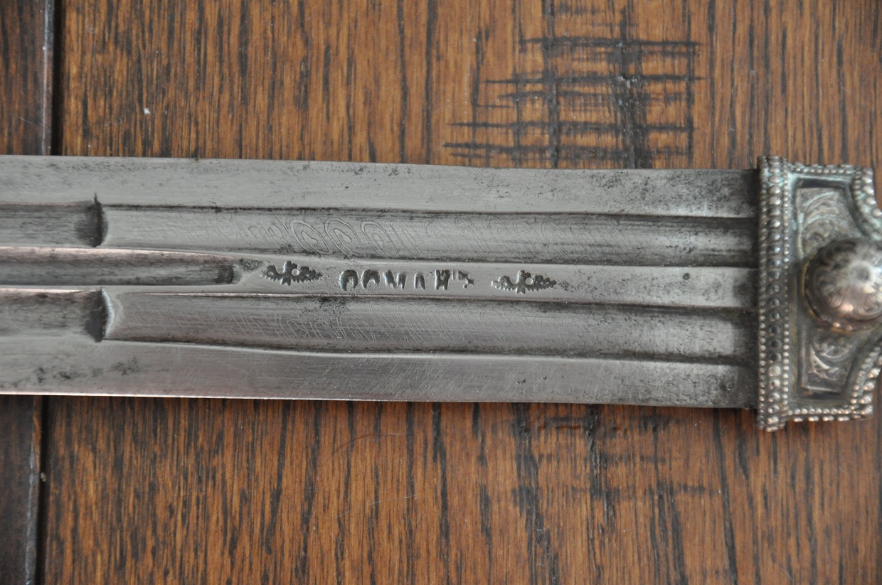

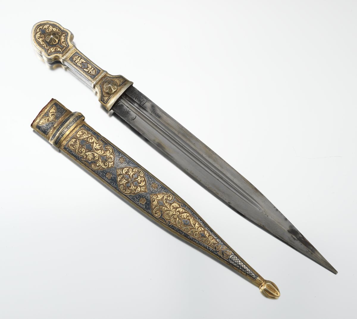

During todays homework I found similar craftmanship on an older auction website. The auction house described the knife as a "Kubachi example" What I found interesting as it was struck with the date (1900, I think) and a asterisk?
rockelk is offline   Reply With Quote
Old 13th May 2019, 07:29 PM   #8
Asterisks are not a problem, they are like cheap versions of fabrication stamps
sometimes both sides of the maker's name. Look at my Omarov, eagles both sides instead of asterisks.
Ariel is the expert, but I think like Eric, yours is early 20th c.
