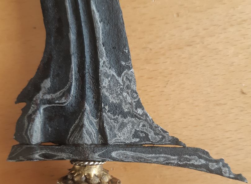

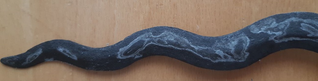

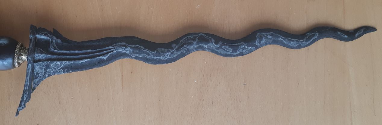

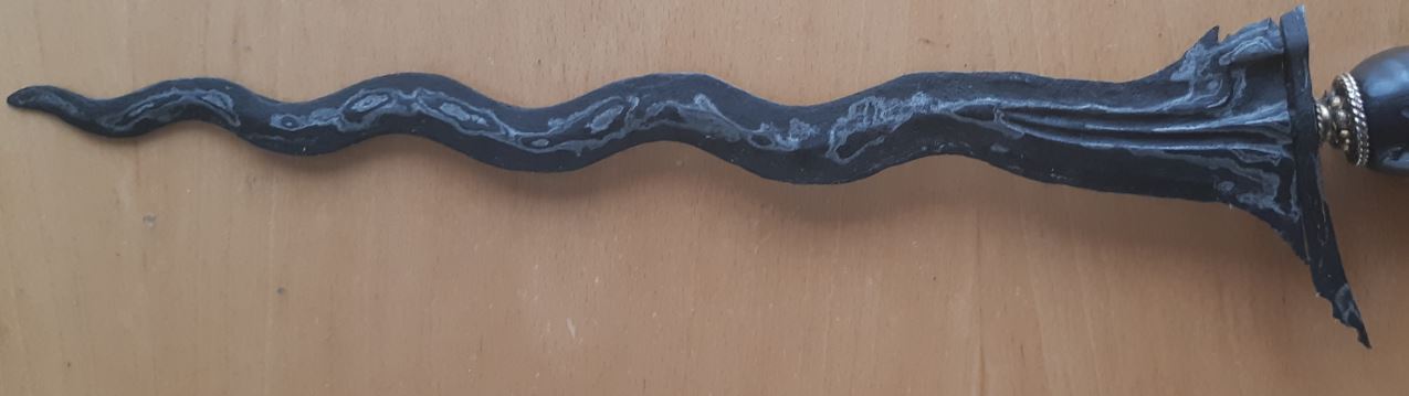

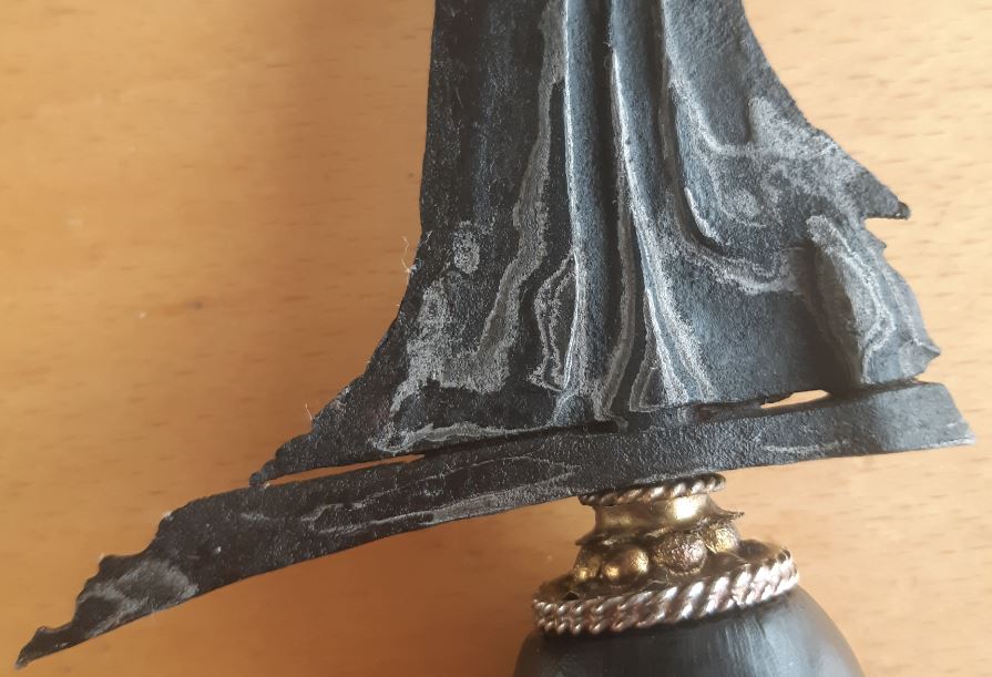

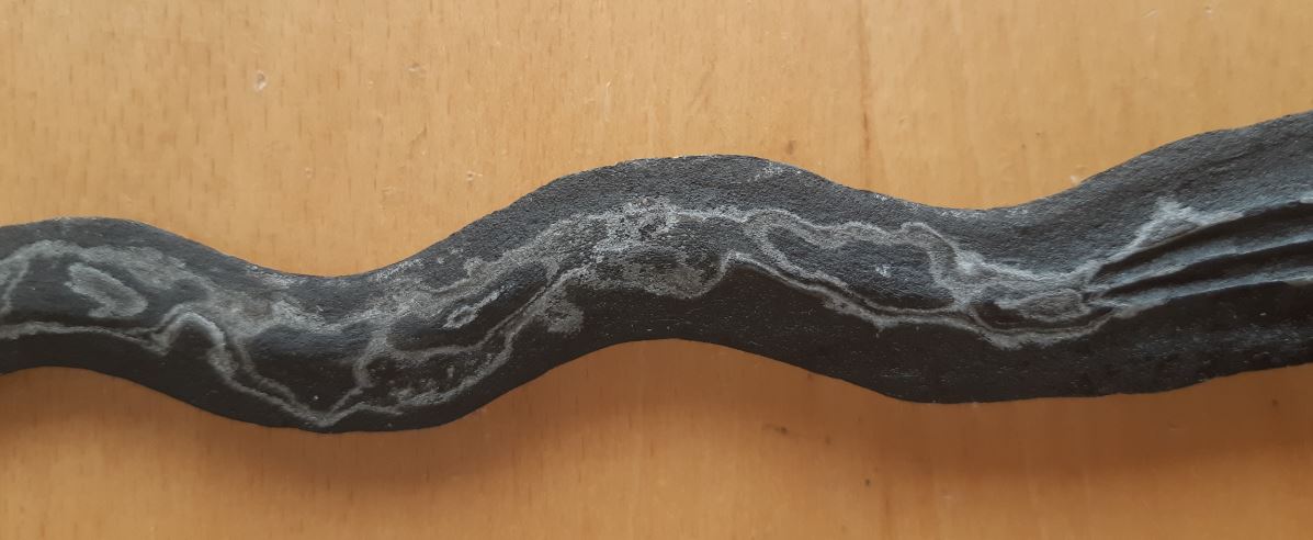

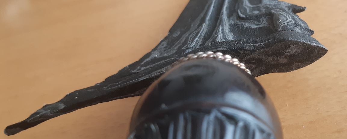

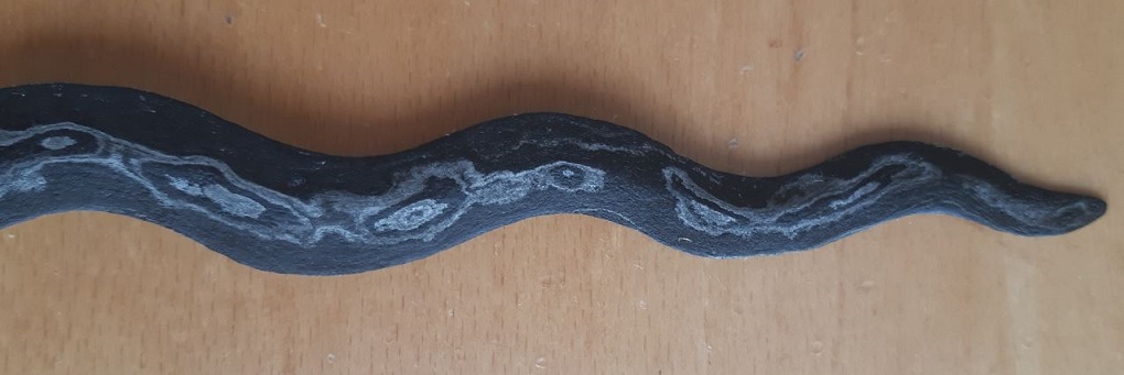

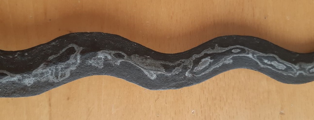

Hi all,
Is it possible to identify the pamor on this Madura Keris based on the photo's?
regards Pat

Beras wutah!

drdavid
Join Date: Aug 2005
Location: Australia
Posts: 375
Beras wutah for me too

Marcokeris
Marcokeris's Avatar
Location: Italy
Posts: 928
Ngulit Semangka

Posts: 7,253
Perhaps you might like to explain why you favour ngulit semongko over wos wutah Marco?

Marcokeris
Marcokeris's Avatar
Location: Italy
Posts: 928
IMO because the blade has very little layers

Posts: 7,253
Yes, there are very few layers of pamor material remaining on this blade, it is heavily eroded, but if we look at the pamor nearest to the gonjo, those layers are not really the heavy layers that we find in ngulit semongko.
I feel that most people would probably give this as wos wutah (beras wutah), as they do with just about any random mlumah pamor that does not display the very broad bands of ngulit semongko or a manipulated surface.
Personally, I'm reluctant to give the pamor a name, it is too heavily eroded for me to guess what it might have looked like when it was new. I think I'd be happy enough just to give it as "random pattern", or "mlumah".
