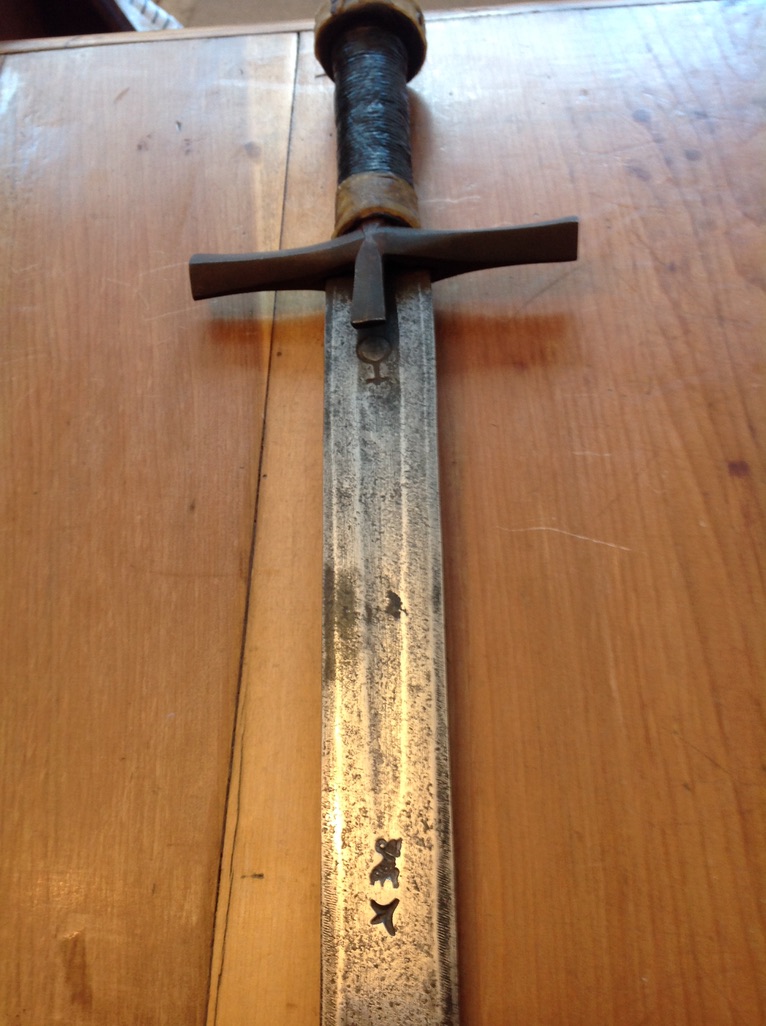

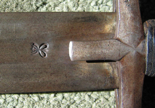

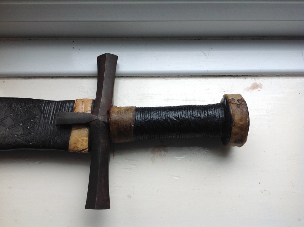

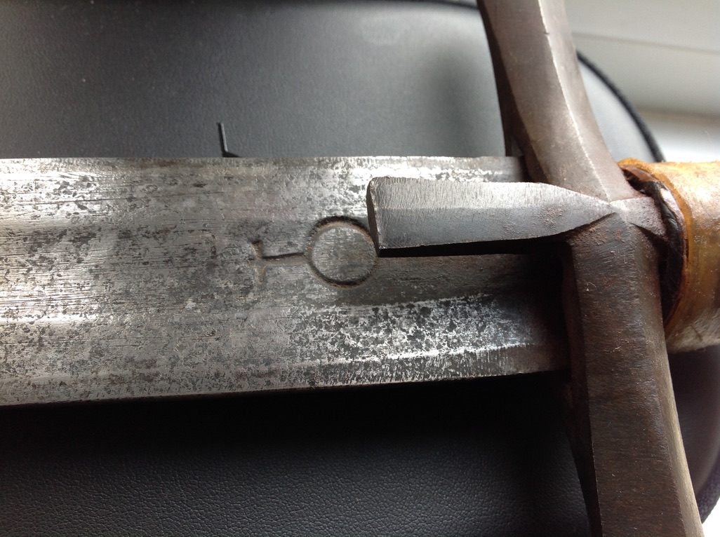

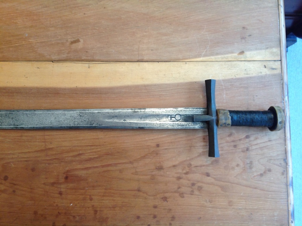

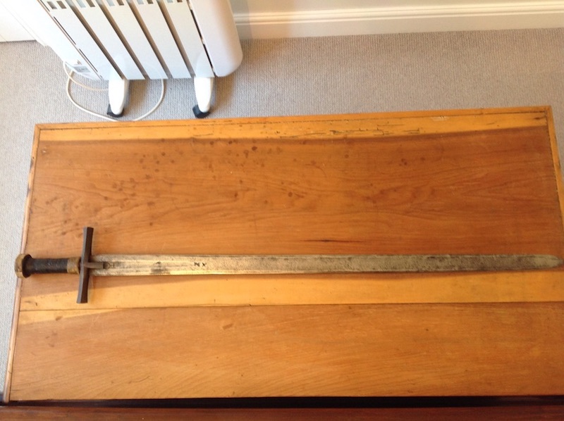

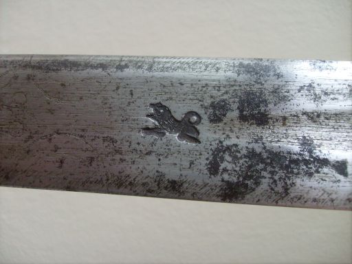

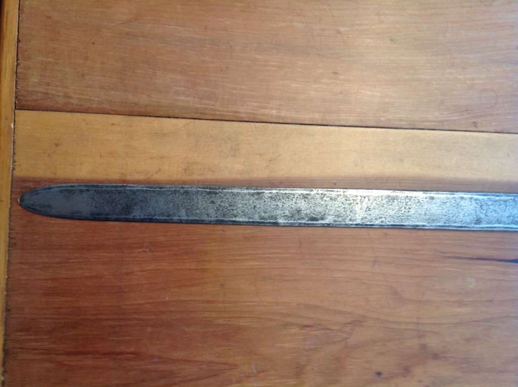

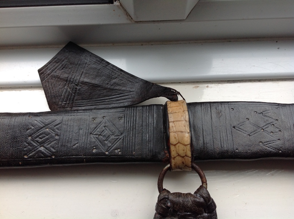

I have cleaned this up and would love to know more about it. All opinions most welcome!

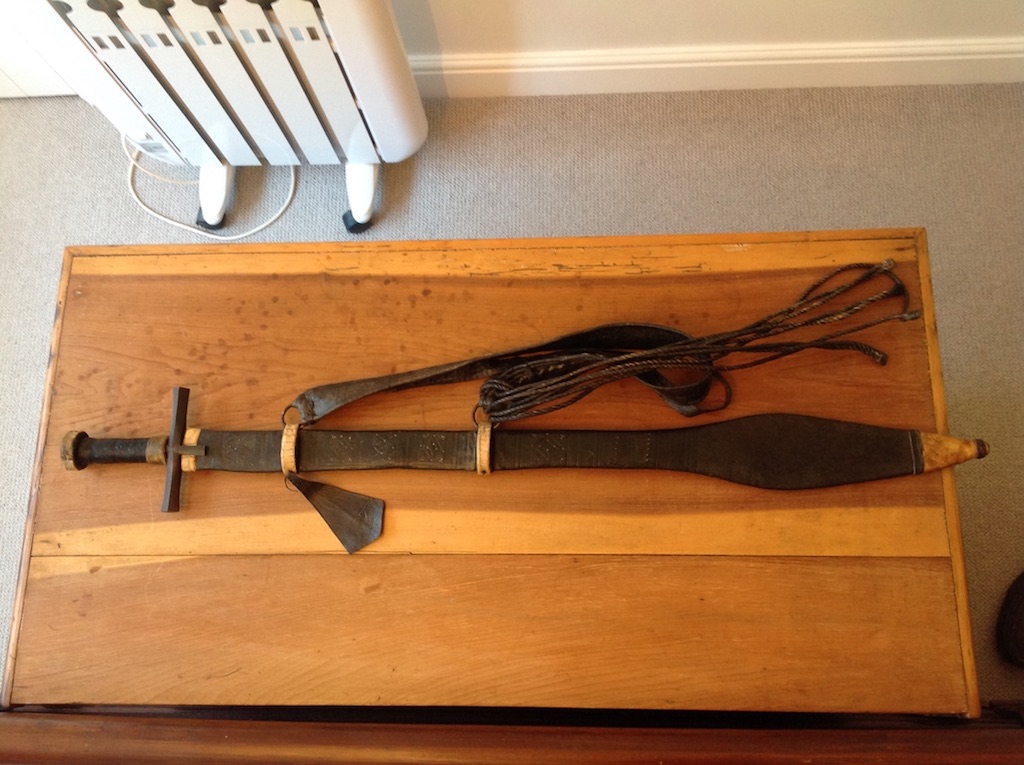

The blade has a short central fuller, with cross mounted orbs on either side of the blade. On one side is also a detailed symbol of a crouching lion, staring at some strange plant like object.

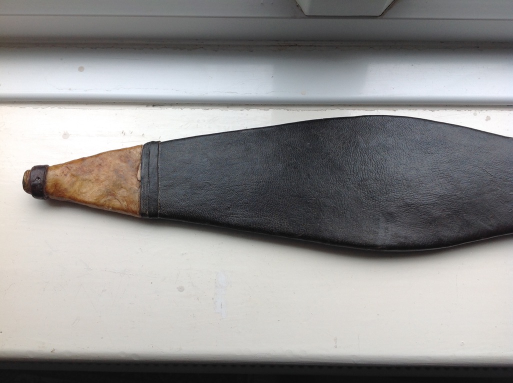

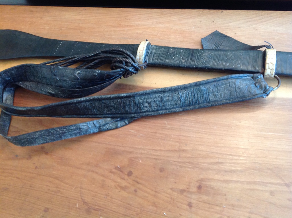

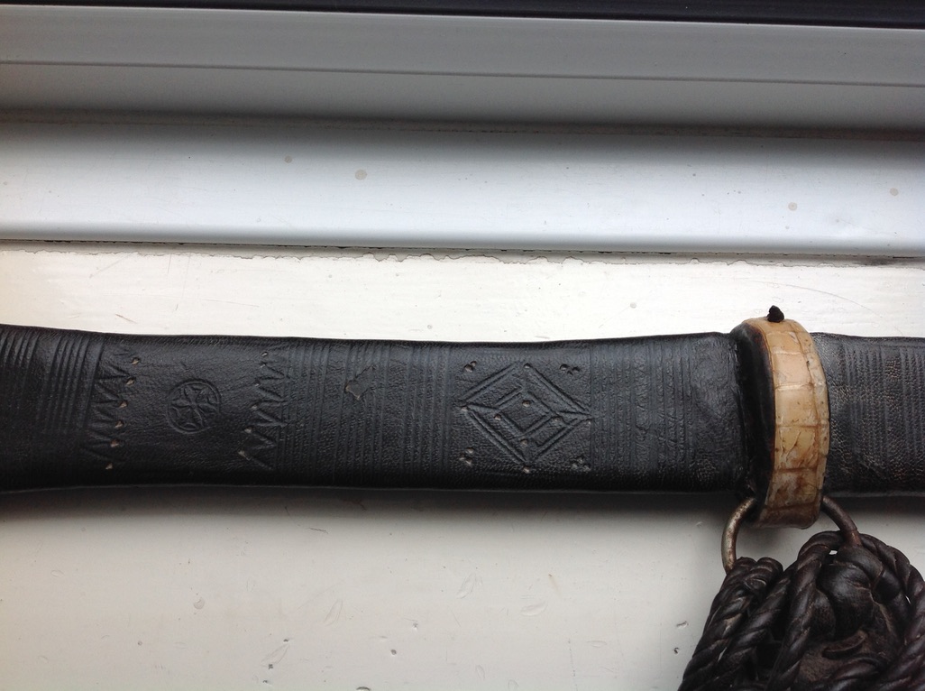

The scabbard has strips of reptile skin wrapped around it, not sure what this is, and the belt doesn't seem like normal leather.

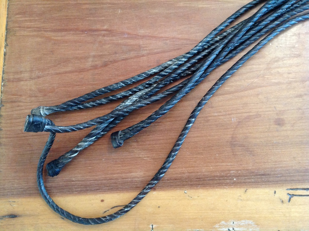

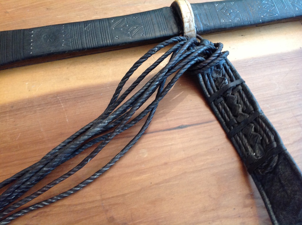

Attached to the belt loop it something that looks like a 'cat o'nine tails' whip! Any views on this?
I welcome any opinions on the age of this sword, the region it might come from and significance of the embellishments.

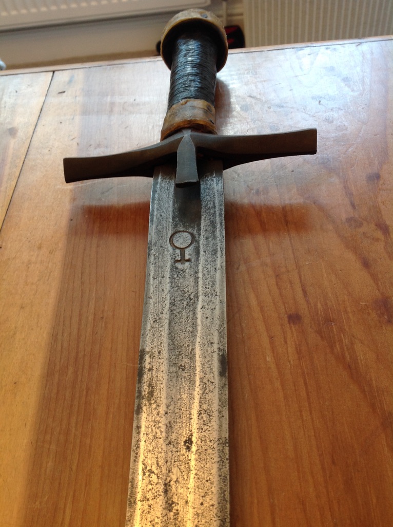

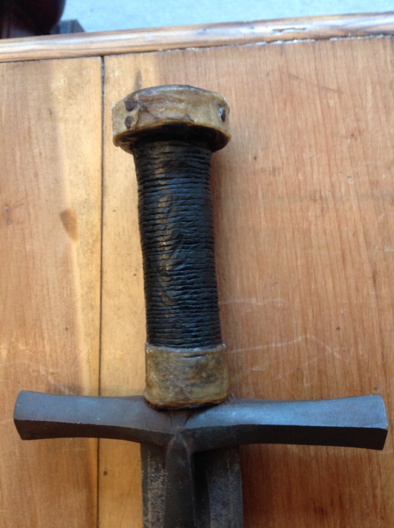

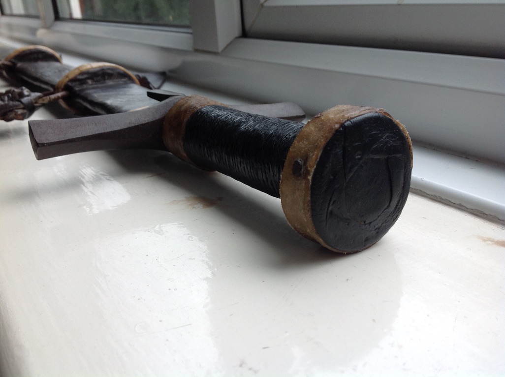

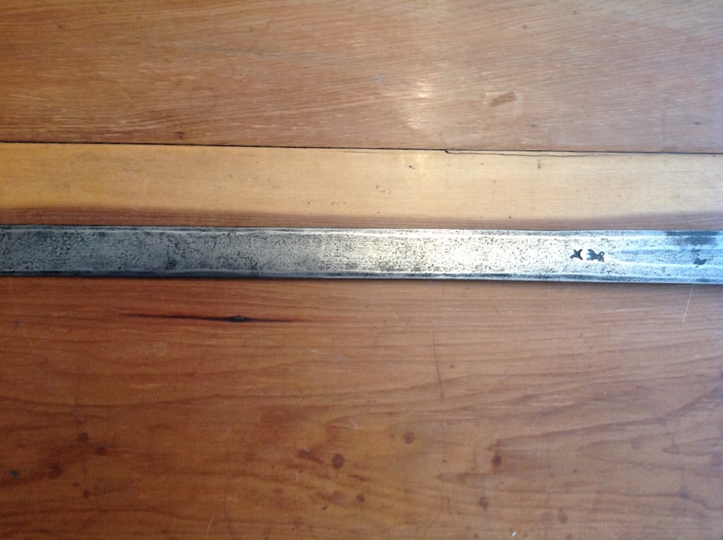

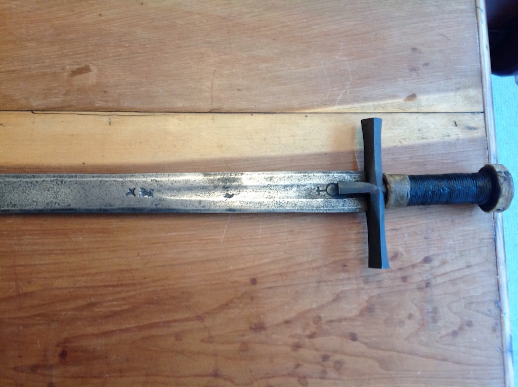

And more photos

William,

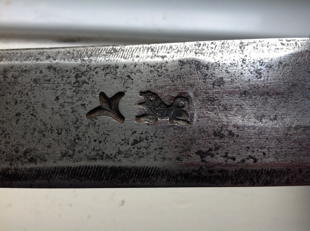

The short fuller on your kaskara has been common on broadswords since the Viking era so that in itself is not indicative of age. The lion has not been identified as to maker/age, but is also shown in Fig. 13 (from Steven Wood) in my Kaskara Fuller Styles thread, link below. The other mark nearby is unknown to me.
http://www.vikingsword.com/vb/showth...aker%27s+marks

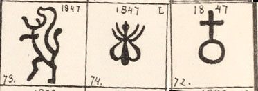

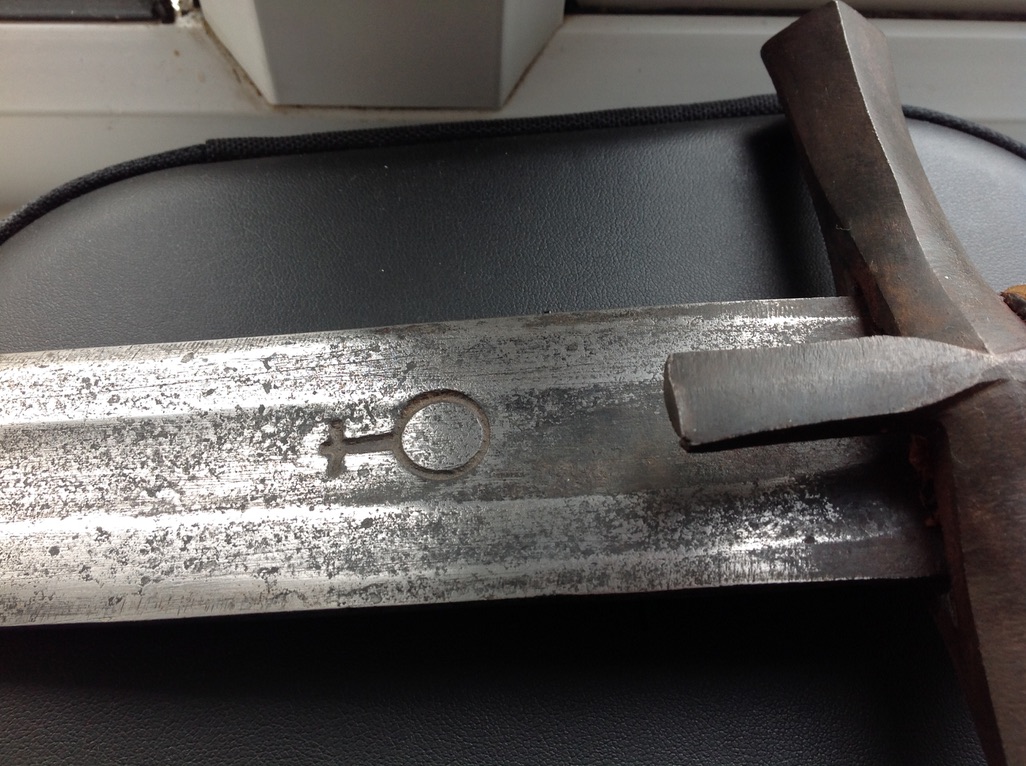

The "cross & orb" is unlike and upside down from the standard Kull/German mark, c.1847, (Fig. 8), but looks more like the Funj "drum & sticks" mark (Fig.10) also from Steven Wood. The Funj marked their property, including animals and even slaves with that mark. The Funj Era ended in 1821, but your sword could have been marked virtually any time before. The fact that its size is larger than the Kull, upside down and not centered in the fuller heavily suggests to me that it was added after manufacture and likely in the field.
Hopefully, others can add more on the lion and whatever marks as well.
Ed

As far as I can relate, this is a kaskara from probably early 1900s, and the blade recalls earlier Solingen forms which were of course well known, and served as examples for workers such as in Kasalla to make their versions. This blade is of the type shown in "Kaskara from Northern Darfur, Sudan" ( Graham Reed, JAAS, Vol.XII #3 March 1987) example LII (p.167).
In Ed's treatise on these swords, one of the most detailed and exceptional reports I have ever read! the form is listed as 'Dukkeri abu Dubban' which has this type central fuller as well as three marks, two of which, the 'lion' and 'cross and orb' are seen here. The third mark seems to be a lily or flower of some sort.
Clearly the lion (resembling the Peter Kull rampant lion) and the cross and orb are native interpretations of these marks from Solingen.
These marks have nothing to do with makers, but more with talismanic and interpretive views in native lore, tradition and folk religion.
The cross and orb, considerably different than Solingen versions, seem to have been regarded by natives as a drum and sticks in some cases, in others a tree.
The geometric designs on the scabbard are well established styles seen on these scabbards, and apparently the wider the scabbard the older (according to Reed).
The leather cords, which seem to vary in number (some with 8 and up to 12) are of wrapped leather and hand free or are occasionally looped through carry rings. These were apparently additional trappings used in fixing the sword to either horse or camel mounts, and while attractive in appearance seem to have had genuine purpose.
This blade seems of early 20th c. and the mounts and scabbard from subsequent refurbishing as was typical with these swords. Leather wrap and the discoid pommel are typical, and reptile hide may have been used in variation, just as varying types of leather in scabbard and mounting straps.

Im glad I could add what I could here William, and I am always grateful to you and others who have posted these kaskara over the years. There are so many great discussions on these pages over the past two decades, and we have all learned so much together.
On these cross and orb, the true European examples are never placed at the forte of the blade, and the cross has equal arms, not flattened like this. While there were some European blades mounted in kaskara, many were quite old and had passed through many generations. The swordsmiths in Sudan became extremely skilled at crafting blades of European style, and adding their interpretations of the familiar markings on them.
Yours is a great example and as noted these braided lines suggest this to be a very good one with such a scabbard. Ed's work has been an invaluable work that has been constantly referred to by most of us here through the years, so it is ever present in discussions.

Agree with Ed and Jim, 20th century, likely 1920-1950s blade, locally made the marks imitating the well respected and desired Kull pattern from the mid 19th century.

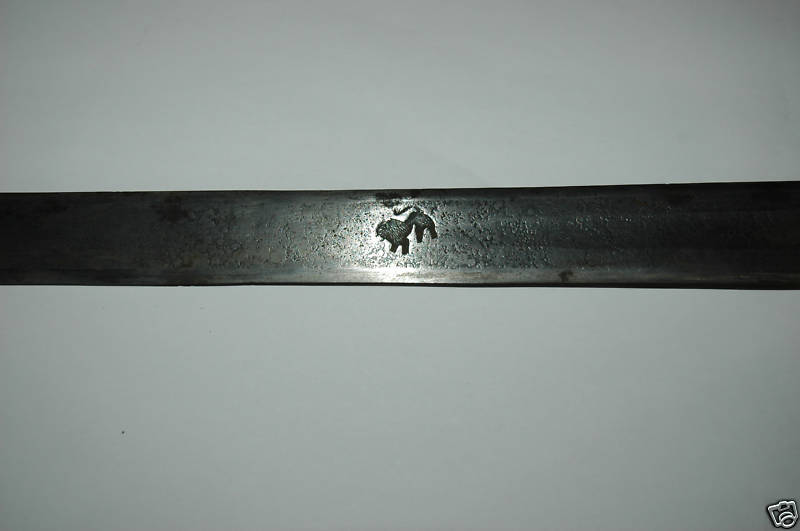

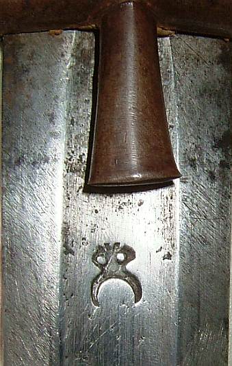

I am not owner of the sword on the picture below (and I donīt have more pictures). It is Ethiopian seif... Is the stamp original Kull?
Old 11th March 2019, 08:36 PM   #9
Posts: 10,867
Actually no, this is simply a lion in similar character in couched (lying) position in the manner of this example but not oriented the same. It seems possible that these may have some reference to the Lion of Judah which was the royal emblem of Emperor Haile Selassie of Ethiopia but these lions are with crown and lion holding a banner. Whatever the case, it seems more an allusion to quality or such blade imbuement.
The rampant lion used by Kull (attached) seems similar to the 'perillo' mark of Spanish swordsmith Julian Del Rey which was supposed to be a 'little dog' but looks more like a lion. The use of Spanish marks was common in Solingen.

Hi Martin, as Jim has stated this does not appear to be a Kull blade, but to my eyes does look to be a European stamp, especially considering the volume of blades Ethiopia imported from European suppliers. This could be from any number of the workshops operating around Solingen in the 19th century.

Thank you Jim and Iain, I saw the sword - it was definitely rehilted. The blade is of high quality - still absolutely straight, strong, flexible. The stamp seems to be too much detailed/realistic - to be of local production.

Iain, very much agree, this definitely seems to be a European stamp but I cannot place it among varied Solingen marks. Perhaps it is among the many which become prevalent among knife makers etc later in the 19th c.
I have always wondered, and possibly you might have encountered or considered, that importers in entrepots in Africa might have had stamps as used in Europe.
We always look to the quality of such marks on blades hoping to determine if European or native, but some recurring marks seem of European quality while oriented atypically on blades.

Getting back to these deeply stamped lions, while the quality and character of the mark seems to indicate a European stamp, I still cannot find anything among known European marks that corresponds to a lion in this stance.
Also the depth of the stamp is much like the cross and orb cases seen here, but the cross and orb was always in blade center not forte. Also the cross is atypical and not European. This brings me again to the idea that perhaps there were stamps used by artisans in Sudanese or other entrepots that brought in blades whether trade or other native makers.
The similarity and configuration of these three examples with stamped lions in the attachments....especially the center and bottom, both on kaskara. The Kassalawi makers it seems had stamps, which degenerated over time. Pm the one with the flower (?) it pretty well matches the other lion which is by itself.

Does anyone have any knowledge of the scabbard and scabbard embellishments of kaskara? I wonder if those little tassels and added details represent tribe, region or status?

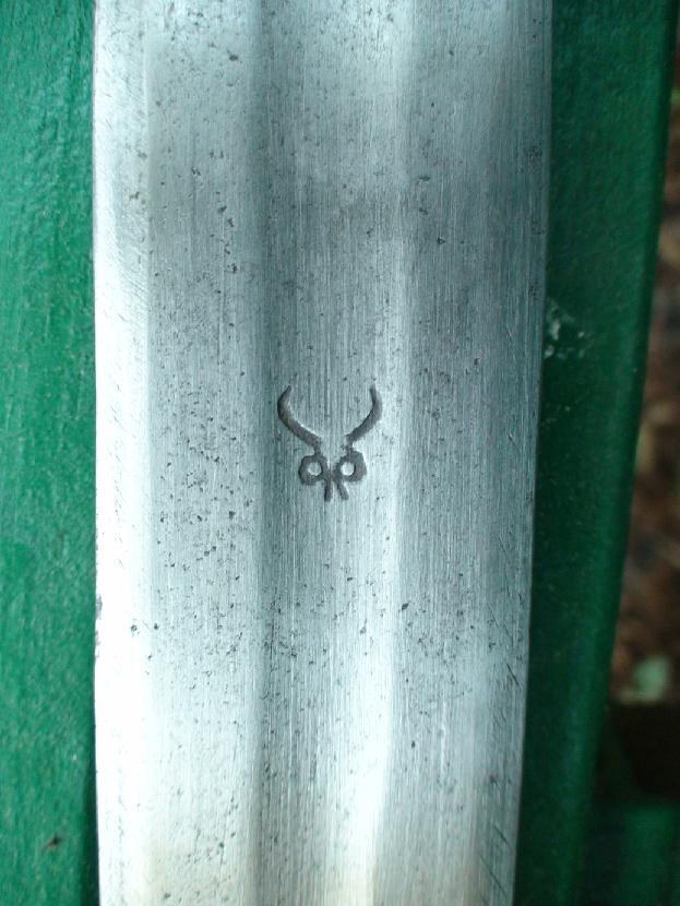

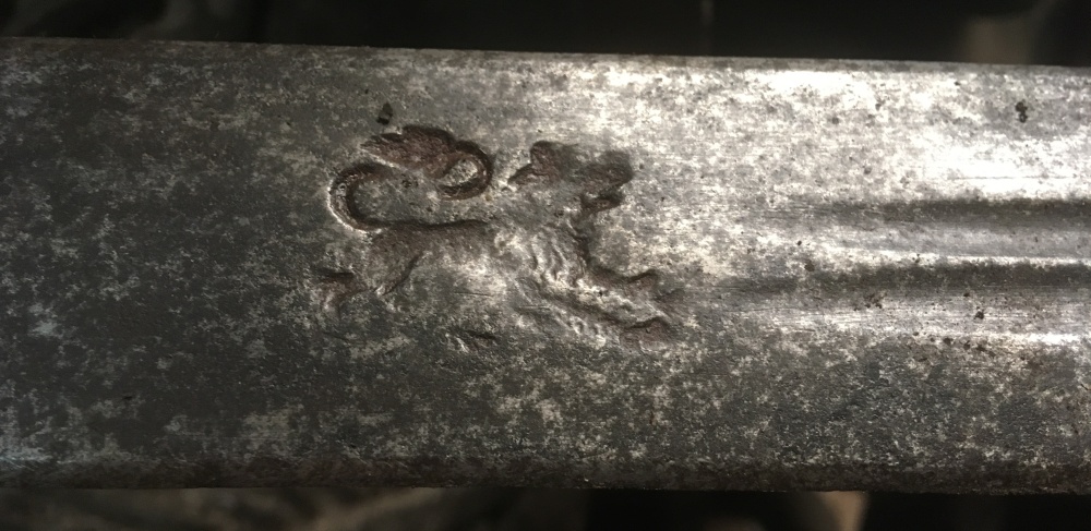

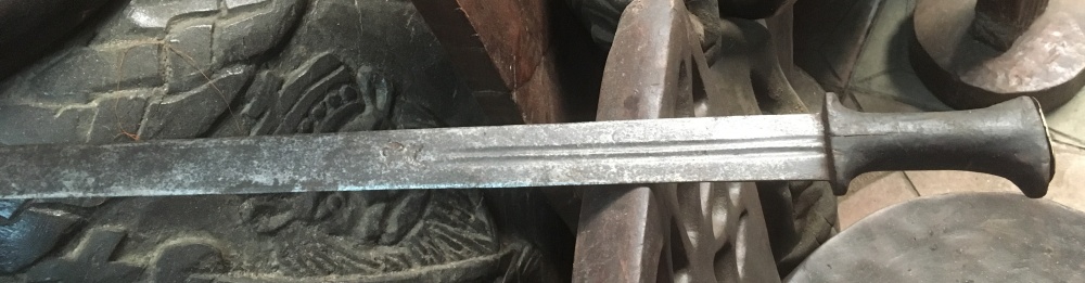

Jim, Both William's sword and Stephen Wood's sword and markings from this 2009 post are virtually identical.
http://www.vikingsword.com/vb/showthread.php?t=10043
Both have a cross & orb and "lion" as noted by Stephen in Pallme (Travels in Kordofan, p.298) and attributed as Austrian imports. (William's has the 4-pointed mark (applied by two strikes) in front of the lion that Stephen's does not. This mark is unique to me, and I wonder why it is on William's and not Stephen's.) Also, I agree that these marks are not from Kull.
Both swords have a more rounded point, I think more in common with imports than the more common pointed locally forged examples. Thus, I tend to agree that both blades are imports, but of unknown manufacture.
If the cross & orbs are actually Funj sticks & drums property marks these swords could be from at least the early 19th Cent (pre 1821). That may be why the common marks are unknown.
The "lion" is rather stylized with internal fur, but the open mouth, curled tail and especially the rump look unnatural to me.
William, the scabbard looks rather recent to me, certainly not as old as the sword. Also, most are dyed a reddish brown rather than black. I don't think the scribbed designs are indicative and the strings are as far as I know just for looks.

Thank you Ed for the link to Stephens post which described the Pallme reference, key to these markings of lion and cross and orb.
Ignatius Pallme, a German traveler, explored Kordofan in 1837-39 and his book "Travels in Kordofan" was published in 1844. In this reference he draws a picture of the cross and orb and states that Austrian blades brought in had this and a lion on the blades.
This sets a date of c. 1837 for this marking combination, and the blades said to be rounded off at the point. It would seem that these blades, while of course rehilted numerous times, must have come into Sudan around this time.
In later times during the Mahdiyya, it was noted that the Mahdi himself had a blade with the double headed eagle of the Holy Roman Empire on a sword he had. Obviously this would indirectly support the idea that Austrian blades were coming into Sudanese regions in years before just as Pallme (1844) had noted.
I think this brings an important perspective on the vintage of these blades with the lion and cross and orb, and that they were likely from Austria.
Now if we could just find a maker using these marks in this manner, perhaps Styrian?

The more I look at William's blade, the more the conundrum of its markings puzzle me. I cannot get past the idea that this is a native made blade and of the early 20th c. While the elliptical fuller is of a form well known on many European blades, there was typically a forte of some sort on European blades .
As I earlier noted, the cross and orb on European blades was typically used at fuller terminal and at blade center, not 'in' the fuller and near the hilt. It was not a makers mark but more of a talismanic augmentation. In Sudan, it seems a regularly seen convention to place these kinds of marks at the blade root.

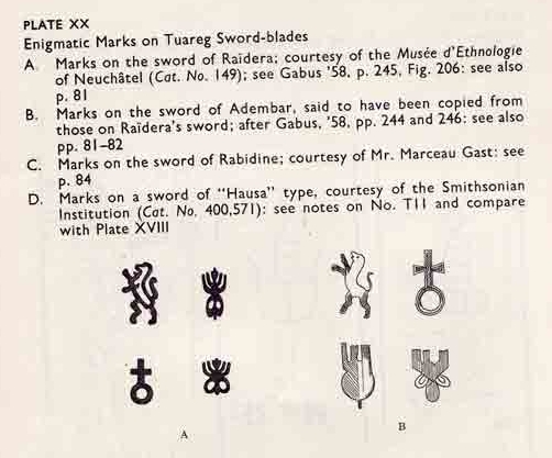

We have seen in Briggs (1965) that the curious marks from his work (a strange geometric device that Briggs believed derived from either Kull or other Solingen marks) were typically placed in this location. Other marks which resemble stylized 'death head' of Kull also appear at blade root in variation.
These marks are approximated by Sudanese artisans and deeply stamped much in the European manner. Here I would note that the cross and orb on William's blade is not centered in the fuller, where it should not be in the first place if indeed European.
The hexagonal section of the blade is not in the manner of such blades from Solingen also, and in this case seems sharply beveled steel stock rather than forged in typical hexagonal fashion.
This leads me to the curious case of the lion, which as it appears in two blades and in the same orientation and appears to be from the same stamp, suggests the armourer was following perhaps a well emplaced tradition ….as noted by Pallme (1844).
The Pallme reference has given us I believe a red herring as well as the note of these marks as he observed in 1837-39. In his book he illustrates the cross and orb, but only notes a lion was also applied to these blades he presumed were from Austria. There is no image of the lion, or for that matter how these were oriented on these blades. I suspect that his assumption the blades came from Austria was because he was cataloguing the goods imported from Austria...however these may well have been Solingen blades. We know that Solingen blades did have standing lions and cross and orb in many cases particularly Kull examples.
Added to the lion mark on William's blade is the curious 4 point mark, which while in the manner of the many indeterminate 'Rorshach' marks well catalogued by Sir James Mann (Wallace Coll. 1962)...appears perhaps to be a water lily. While uncertain of this symbolic meaning, it seems strategically placed next to the lion, and suggesting possibly some sort of allegoric theme.
Clearly we have much more research to do on the methods and significance of blades being marked in Sudanese (including Kordofan and Darfur) contexts and the nature of the stamps they appear to have used.
In attached photos the line illustrations are from Briggs (1965) and the type of lion I think was alluded to in Pallme (1844). The 'fly' marking seems to have perhaps (as suggested by Briggs) evolved into the curious geometric device also pictured . These occur in various forms as does the strange figure with 'eyes' thought to resemble Kulls death head.
