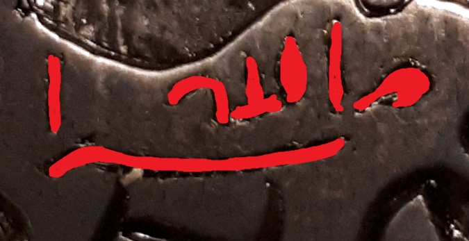

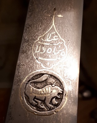

I have this 19th century ottoman shamshir. It has a rather common makers mark and a lion carved in the blade. It has been discussed several times on the forum and I have read Olivers article http://auctionsimperial.com/om-the-p...f-assad-allah/.
I do not however know what the text in the lion says. Any guesses? I does not quite look like the exampel in Olivers article. EDIT: looked deeper in the forum and found this thread: http://www.vikingsword.com/vb/showth...ht=assad+allah Looks to me like its says "Assad Allah" like in that exampel from that thread, only mine looks kinda crude compared to that one

G'day Drabant1701,
Yours is very similar to mine discussed on this thread. http://www.vikingsword.com/vb/showthread.php?t=23381 Cheers, Bryce |

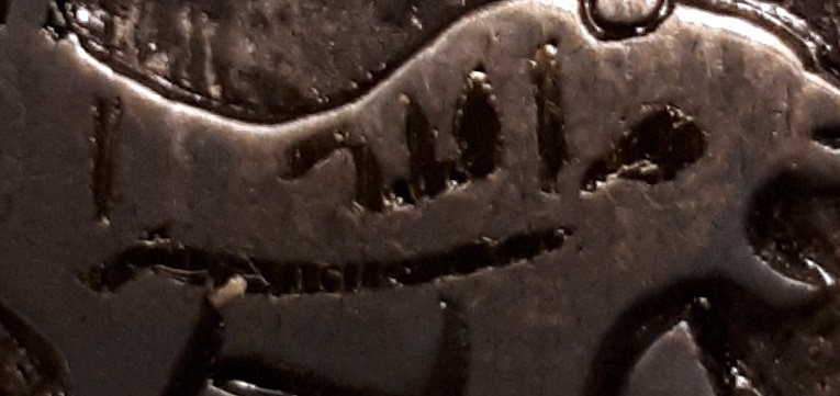

The inscription on the lion appears to read, MASH'ALLAH-- God's blessing.
Please post a closeup. |

Please repost the large pic without the red marks

It has written Asad Allah(the lion of god). This is the senior sword maker during Abass Shah tenure. However, this stamp is not authentic. This stamp was used many years for trade mark. In addition, this sword made in Iran (Asfahan) not Demas( Syria).
There are only 10 swords in the world who are really made by Asad Allah before kidnaping him. These swords have a different stamps. The name of maker Asad Allah and Quranic call( Ya Qazi Al- Hahat) which means the one(god) who answers the requests/ prayers. I hope that helpful Cheers |
