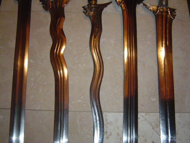

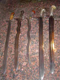

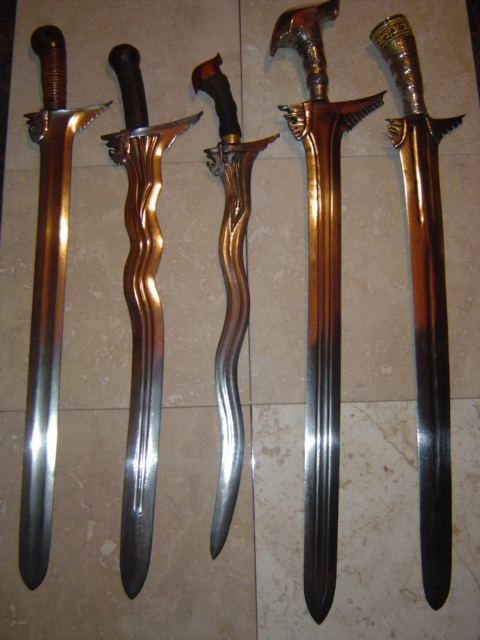

Question from a new bie.
Attached are photos of my fullered Moro Krises, ranging from single to triple fullers. Each has its own uniqueness and beauty, but the question is, what are the actual functions or purposes of this elongated deep canal look, chesseled? on each blades. thanks

The purpose of fullers is threefold:
1. The make the blade lighter. The energy is proportionate to the mass of the blade times square of velocity with which it is wielded ( just like any other energy, including the famous Einsteinian equation ). Thus, a small sacrifice in the mass of the blade allows the swordsman to move it faster, thus increasing the energy of the cut. An example: decrease the mass from 2 to 1, and increase the speed from 2 to 4 (same proportion): the energy of the blow increases twofold.
2. Creation of fullers increases the surface length of the tranverse section. This increases it's rigidity (less bendable) The fuller creates a section of a semi-pipe, and we all know that it is much easier to bend a solid piece of metal than a pipe of the same diameter. this is why several narrow fullers are mechanically better than a single wide one. The same principle applies to the "T-spine".
3. To serve as "blood grooves", but only in horror movies

weight and balance control, rigidity to some degree but not true for all, multiple narrow fullers for weight and balance are still flexible
