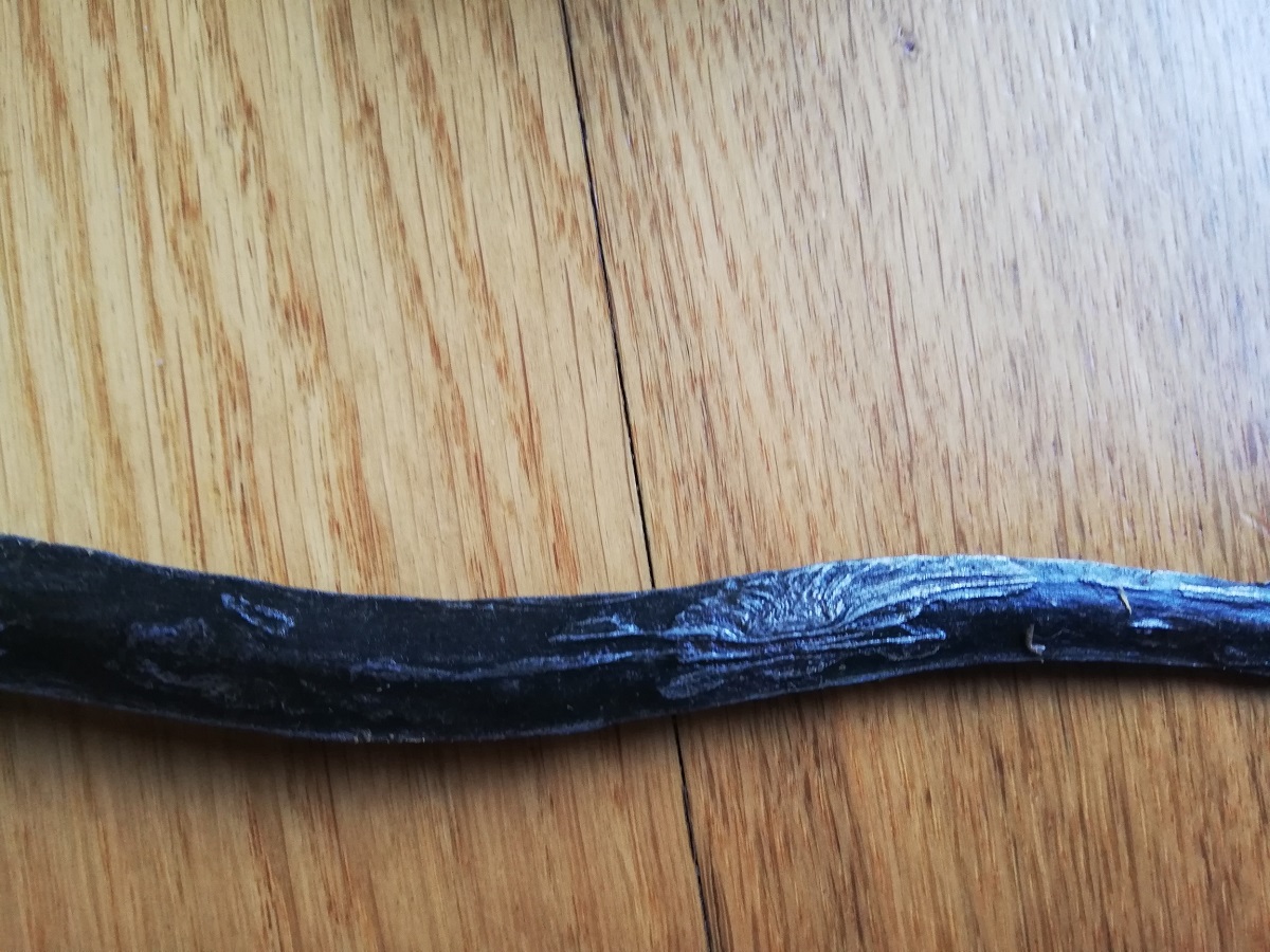

Hello members, i got an account some years ago, but are new on this forum. I got this keris, as a pusaka, but like to have some more information about this keris. Does anyone know something about the pamor?
Or anny information about this keris.
The first owner, for sofar we can see is born in Yogja an lived in Tegal.
Looking forward to your oppinion.

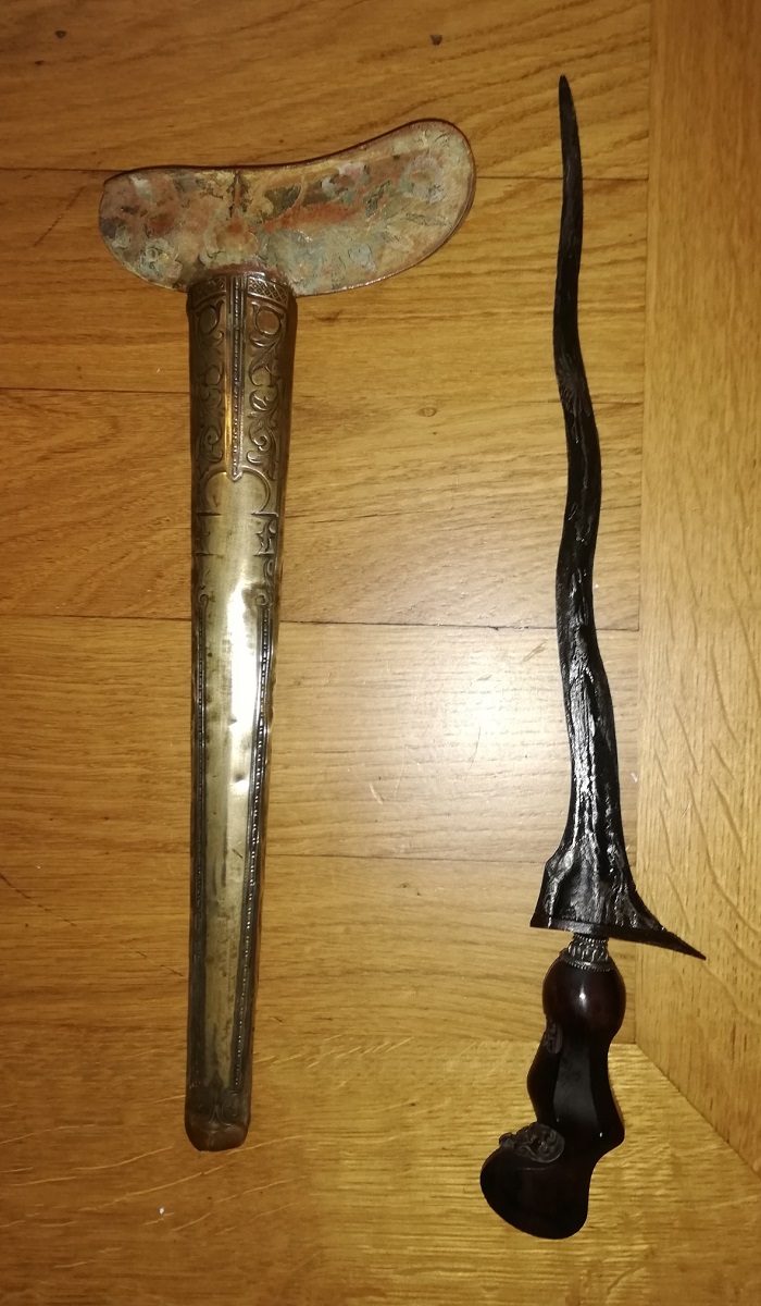

That does indeed seem to be a lovely old keris. Also seems to be an old sunggingan wrongko with a nice silver pendok and a rare form of planar hilt. If you are able better photos of all parts would be helpful in sorting out any new information you don't already have.
Can you tell us more about how you received this as pusaka and what provenance you have that the first owner may have been born in Yogyakarta and lived in Tegal?
BTW, i believe that planar hilt form that you have with the "pot belly" is known as Narada Kandha. The form can be found at least in both Central and East Jawa and though i would need to see better photos, your appears to be an old and well carved example.

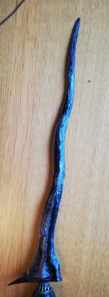

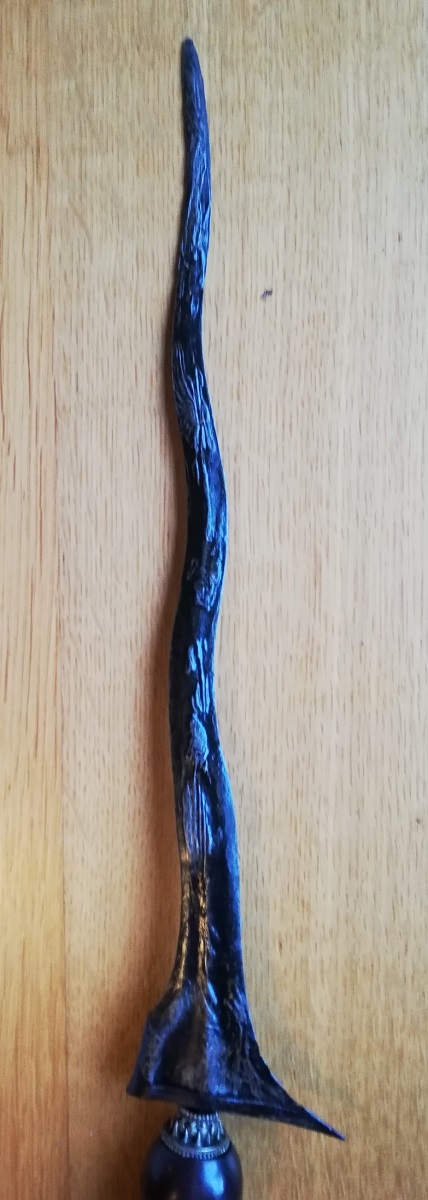

I like to know more about the painting, and my question is if Yogja has the same rules for colours as Solo? The basic colour was bleu.
I cannot recognice the pamor, just some of it spread over the blade.
I realy like the light sogokan who is very high on the blade. What does this mean?
Also the grip is something i've never seen. Yogja, Solo or maybe from the little kingdoms i do not know much about...

Before i passed these new posts i did add to my first response more info about your hilt. I believe this "pot bellied" style of the planar Nunggak Semi hilt form is referred to as Narada Kandha. Now that i have seen better photos i can confirm that this is an older hilt that was nicely carved.
I can't name this pamor for you, but perhaps someone else will give it a shot. This is an old blade and there has certainly been some loss so it is harder to identify.
You are correct to identify the wrongko as Yogyakarta gayaman form. I am afraid that i do not know the answer to you question about color symbolism for Yogya kraton, but perhaps Alan Maisey might know the answer to this. On the color i see a lot of blue, but i believe that the background/base color of the sunggingan work might be closer to orange.
The pendok is unusual and beautiful. Is it possible that it might be suassa (a low gold content metal) because with the new photos it doesn't look like high gold content and seems have some tarnish which high content gold would not have.
My feeling about gold and silver parts on keris ensembles is that they are meant to shine. I know some collectors worry about removing "precious" patina. Bronze should have patina. Gold should be bright. So if this were in my care i would polish up this pendok and return it to its intended glory.

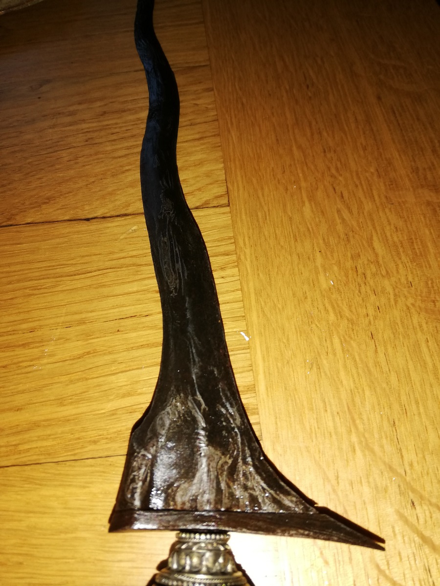

I am still not completely sure i see the combong. Is it a tiny little hole at the base of the pecetan that i think i can make out in the silhouette photo? If so i have never seen one so small. Interesting.

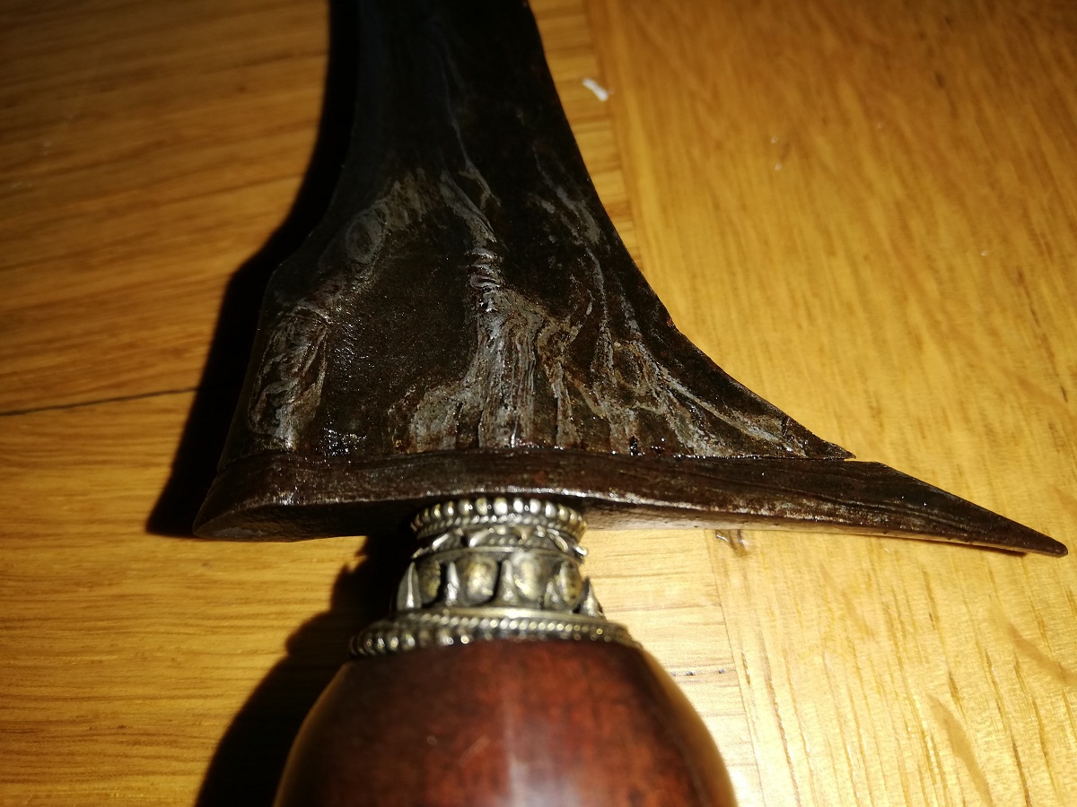

The "wish hole" looks very much like the gap we frequently find between wilah and gonjo, as such it cannot be regarded as a combong, however, as is common in matters of belief, an individual can always subscribe to his own beliefs.
David Gallus has told us that he is a goldsmith, so if he says this pendok is gold I fully believe that statement, however, if it has been tested as gold, may we know the level of purity?
On my screen this pendok looks very much like mamas and the embossing also looks as if it is work done in mamas.

Hi David, thnx for your replay. So the handle is Solo, Naranda Khanda? I know the east Javanese handles, but not for Yogja.
It also doesn't have that round from Yogja but more that edgy like Solo??
I'll upload some hilt forms, but my knowledge about handles is limited.
You are correct, the pendok and mendak needs some care! I'm going to test the pendok this afternoon to see what karat comes out.

Well i tested it and a little disappointing, it cannot be classified as gold! I was so convinced that it was gold because of the feel, silver and gold transport heat very well, and the colour, but gold can only be clasified as gold if it contains more than 50% gold!
I tested with 4 bottles, the right is 21.5k, then 18k, 14k and at the left 8k.
You can see that the three on the right disappeared so it must be under 14k.
Only the 8k stayed, so it could be >8k gold.
So metal pendok containing gold....
About gold, and i mainly work with rings, the official Indonesian gold is >21.5k what is absolutely not good for a ring, i'll post a ring and you can see that it is actual to soft. In Indonesia there are a lot of objects from silver in 72% that cannot be classified as silver but are totally genuine because that is the exact percentage of silver in the dutch coins. Also i see lots of rings in 14k gold, also the Dutch standard for gold, so probably made in order of someone who brought his own gold. I realy thought this would be 14k, but the test gives this result.
Suasa is possible because it is normaly 9k...
