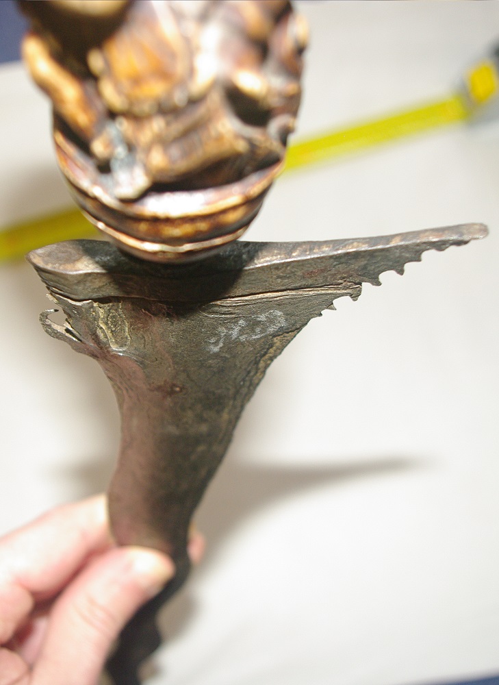

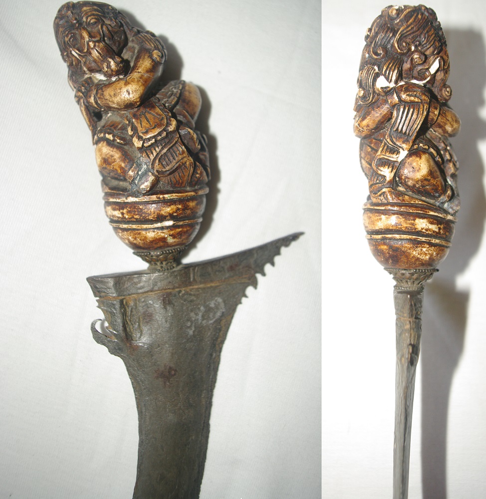

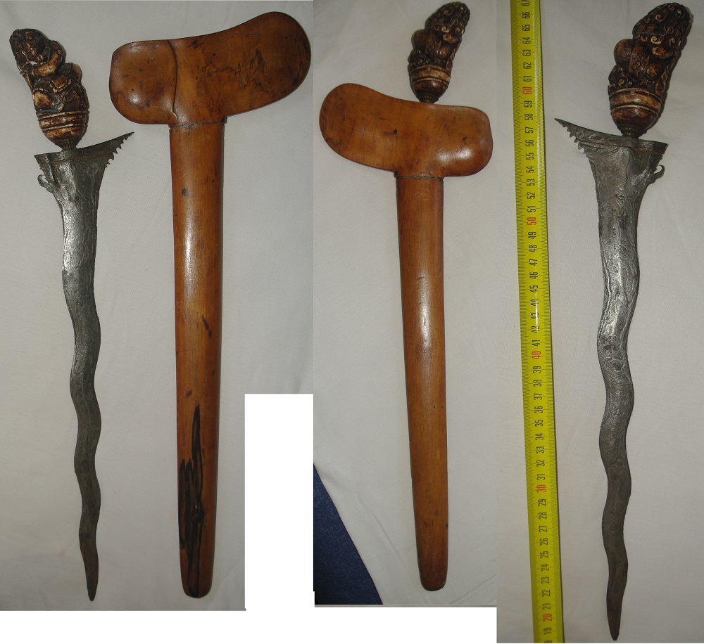

This keris has many javanese features (Sheath, blade surface, mendak), but also others are strange compared to my other javanese keris (the size: 40cm for the blade) and the hilt representing Ganesha.
The scabbard measures 47cm and fits well with the blade.
The hilt was broken and repaired with a lot of glue in the past, impossible to remove. It looks like plaster (or resin?) painted to imitate old ivory.
The hilt probably dates from the second half of the 20th century but the blade seems older.
I think this Keris comes from East Java (or Madura?), but I don't understand the mix.
What do you think?

In the area of Sumenep in Madura there is a story that tells of a failed invasion of Sumenep by Balinese warriors.. The ruler of Sumenep had advance warning of the Balinese arrival, waited until they left their boats to attack the town, burnt the boats and then came up behind them just as they approached his other forces who were guarding the town.
The Balinese were surrounded.
Goodbye invasion.
Did the ruler of Sumenep slaughter them and stick their heads on posts?
No.
He offered them a choice:- pledge your loyalty to me and become my people and I'll give you land and a wife, or, you can refuse to pledge your loyalty and I'll kill the lot of you.
The Balinese warriors made the sensible choice. Ever since that time there has been a small Balinese settlement in the Sumenep area. This is the reason we see this Bali-Madura keris style.
In the case of this example we have a keris of Balinese size, but of very distinct Madurese style, and dressed with the Madura-Bali wrongko.
Forget the hilt. Put it on ebay and look for the correct hilt for this wrongko, like a Bali bondolan, but a little bit fatter and shorter.

Athanase, the bondalan style hilt that you should be looking for is not the typical Balinese style. The Maduran form is a bit wide, sqautter, stockier if you will. This style is discussed a little bit on this thread as well as what may or may not be an appropriate mendak for such a hilt.
http://www.vikingsword.com/vb/showth...light=bondalan

Skip hilt and mendak.
A bondolan hilt does not need an uwer.
Old 6th March 2017, 09:42 PM   #12
Posts: 7,209
Yes, you're right Kai:- a bondolan does not need a transition piece from blade to hilt.
However, the complete keris usually is much more pleasing if a "keris ring" is fitted.
It's a matter of proportion and perception.

Anyway the existing mendak is a Central Java model and should better be replaced.
Old 7th March 2017, 11:40 AM   #14
Question
Thanks, Alan!
Since the proportions between hilt and gambar (as well as gandar) are already different, would you go for a uwer Bali (maybe a relatively narrow one?) or a Madura style mendak or even selut?

I finally found an old handle to replace the previous fantasy hilt.
Here is the new montage:
