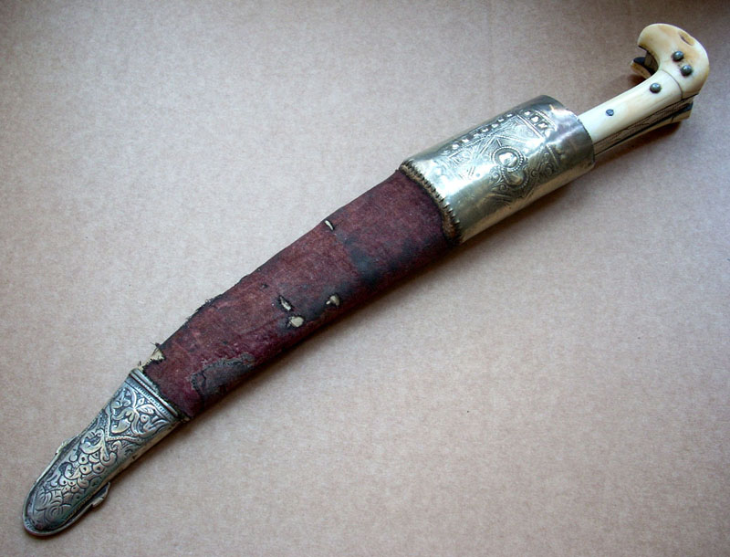

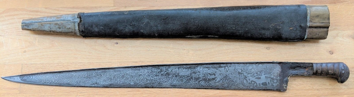

The title was deliberately shortened; the full version would sound something like " The oldest dated Khyber I can recall"

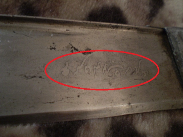

The date is acid etched on the blade: 229H ( 1229, of course), i.e. 1813 in Gregorian.
The handle was damaged, and the bolster and tangband are made of brass.
Any criticisms or doubts?

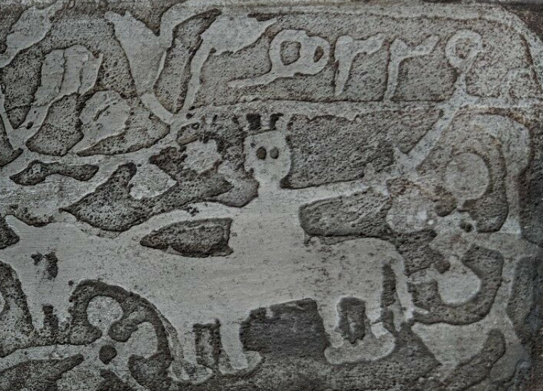

My regrets, but most of the Khyber knives, whose blades are decorated in this style, have been decorated in the last 20-30 years ... It is a known fact that Afghans did not decorate their weapons with images of people and animals (although they could use Persian or Indian weapons with such images). But on the weapons that the Afghans themselves made not images of people and animals there. In the last 20-30 years, a lot of "improved" old Afghan weapons and modern souvenirs for tourists whose blades are decorated with images of animals of different quality have appeared on the antique market.
I would believe the authenticity of the inscription, if it was similar to what I attach in the photo - short and without images of people and animals.
Although, anything can be. Once in a private collection I saw a khyber knife with a star of David roughly cut on a blade. The collector sincerely believed that this was a rare Khyber knife of an Afghan Jew
P.S. By the way, it seems to me, or does the saber in the hands of the rider (in the image on the blade) - have an elman (the wider part of the saber is closer to the tip of the blade)?

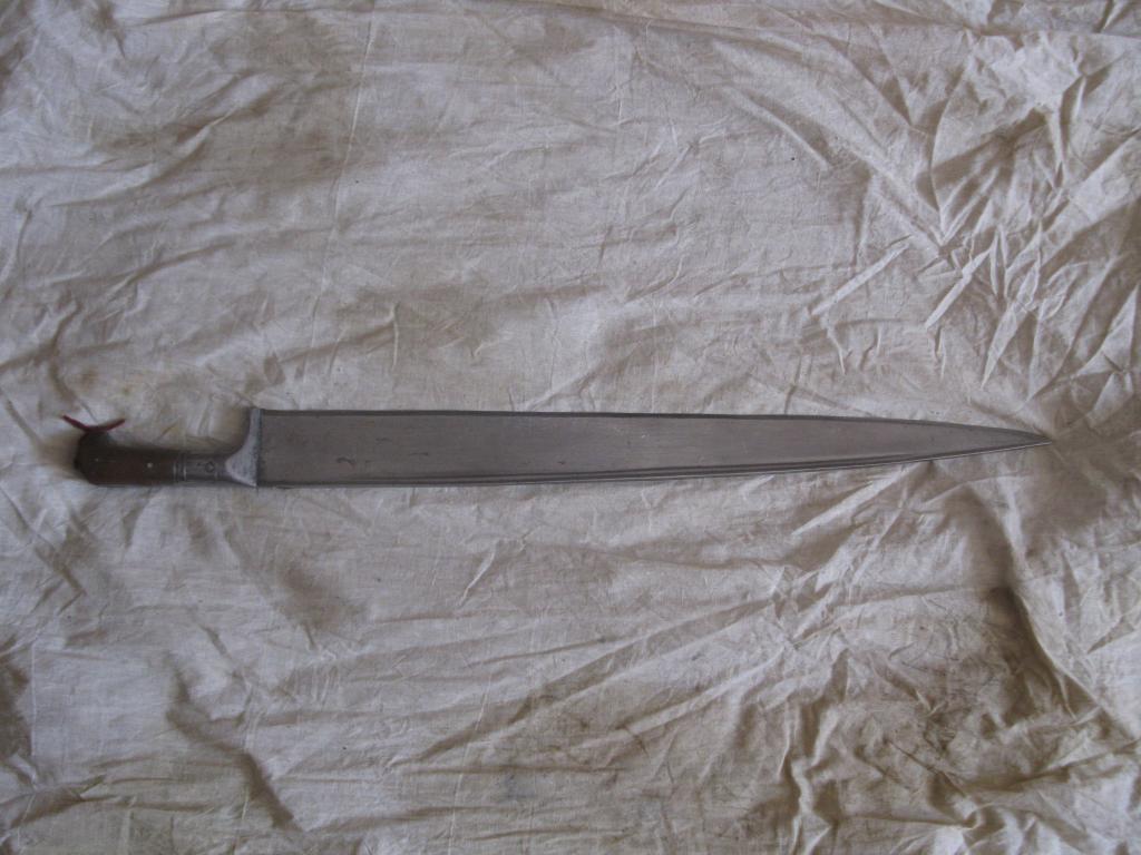

1) We see the "classic" Afghan Khyber knife. By the way, no one says that he is not real. This is a authentic Khyber knife for the 19th century or early 20th century. The truth is not in very good condition. However, there are no elements that would tell us about its Persian or Indian origin (usually these elements are easy to recognize).
2) Sellers of antique weapons, souvenirs and "upgraded" old weapons in Afghanistan are not considered a problem if their goods are damaged. On the contrary, for them this is an occasion to say that this is an old item. Unfortunately, the times of Egerton, Moser and Prince Saltykov, when you could buy very good items in India and Central Asia, are long gone.
3) Using such a technique for decorating a blade for typical Afghan khyber knives is absolutely not typical. But, miracles do happen. However, I would like to see analogues from Afghanistan.

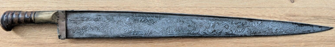

What is certain is that we can speculate ad nausea whether the blade was etched at the time of manufacture or much later.
Then, we can speculate if it was etched in the 19th century or 30 years ago.
We will NEVER be able to establish with 100% certainty any of the above mentioned asumptions.

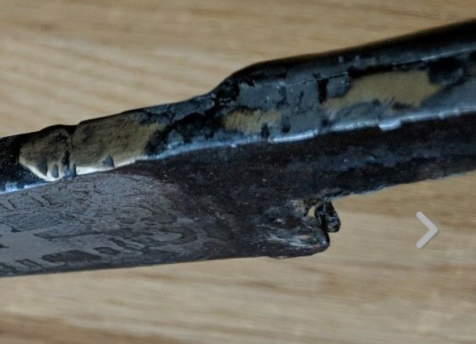

But, based on the shape of the blade and amount of corosion on the tang we can presume with a reasonable degree of certainty this is a regular Afghan khyber blade from 19th to early 20th century.
The presence of the etching, however, is absolutely atypical for the Afghan khyber swords and this is also reasonably certain.
Then, the blade can be
1. with an original etching, making it an exception/curiosity;
2. with a later etching to make it more attractive.
Out of these two alternatives, I would choose the second as I consider it much more likely than the first one, since the I do not really believe in miracles (but as Mahratt said "miracles do happen").
PS: How much would this sword fetch if it weren't etched?!
How much could it fetch as an "exceptionally rare and dated" Khyber sword?!
The damaged hilt would enhance the impression of authenticity...

This to me is clearly a 19th c. Khyber knife (salwar) which has apparently been acid etched (as astutely noted by Bob) at a much later date, my guess would be late 19th early 20th.
While we know these swords were keenly used throughout Khyber regions, they certainly diffused into many congruent regions which were all part of the Northwest frontiers later becoming Afghanistan.
The acid etching always tempts many to classify the decoration as souvenir oriented, which of course many examples of tulwar. kukri and other Indian forms do carry in many cases.

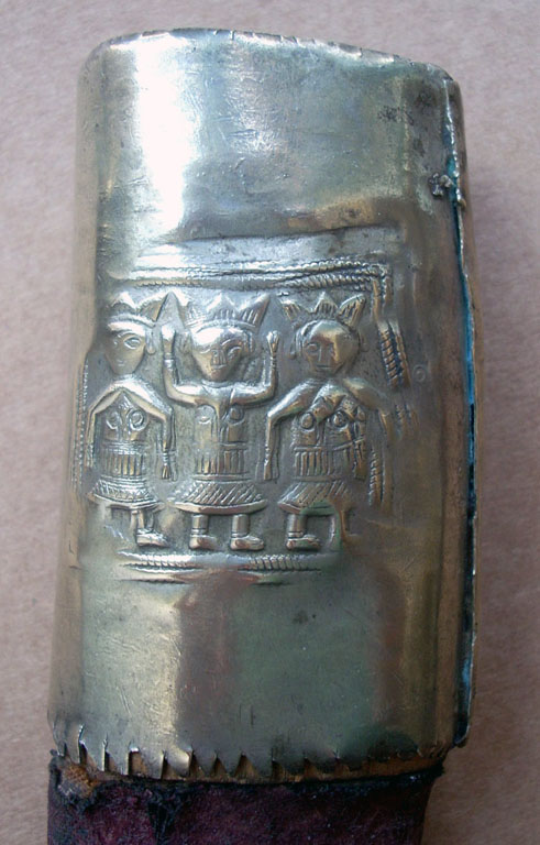

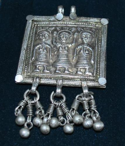

In this case however (and most unusually) this example has decoration which resembles the kind of figure often seen on weapons of the Kalash people of the Chitral district and areas of Nuristan. These animist tribes have in many cases nominally adopted Islam, which may account for the Hegira date, and in my opinion most probably (if accurate) represents something commemorative.
It seems the character of the figures used in the decoration of these people is much like the crowned figure mounted in this motif.
The Kalash are a very much endangered (culturally) people who were known as the Kafirs (as described by Kipling) and their regions known as Kafiristan before invaded by Abdur Rahman Khan in 1890s. These areas became known as Nuristan and remain as part of the provinces of now Afghanistan.
While the Kalash are known for use of the 'jamadhar katari' , a dagger described in Egerton and often discussed here, they also use varied swords and long hafted axes resembling the Arabian jers.
While it is remarkable to see a Khyber decorated in this way, it is not surprising that one via various means of contact, found its way into this most unusual context.
Entirely speculative of course, but I find the etched figure and motif compellingly like that I have seen in the material culture of these people.
They were written on by George Scott Robertson "Kafirs of the Hindu Kush" (1896), and I have a reference from Germany by this title about 20 years ago but not on hand at the moment.
