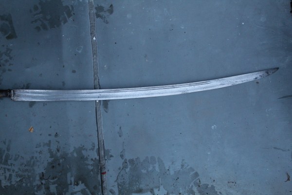

Good evening european forumites,

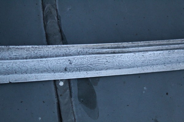

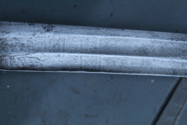

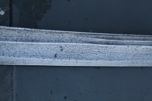

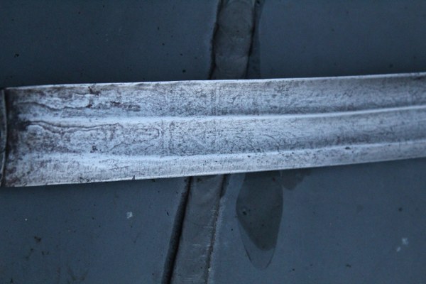

I would like to have information about the origin, age and model of this blade.
It is mounted in Atjeh sikin pasangang fittings, but the blade shows european style etching as well as damast pattern.
Willem

While I am admittedly (and clearly) unfamiliar with the history and weapons of Indonesia and these archipelagos, I am disappointed in the lack of response so wished to at least venture suggestions here.
The basic pattern of the blade suggests obviously a cavalry sabre blade, probably East European and of the latter 18th century into early 19th. The etching style, though extremely worn and indiscernible in the photos is of course indicating an officers sword.
Without searching through references to match the interesting fuller arrangement to classify possible nationality of this blade, the key factor in its appearance in this Indonesian context is of course trade. While the Dutch predominated control in these regions, there are likely a good number of possibilities how this blade ended up in these Atjeh mounts. Only speculation by those more familiar with these trade activities and regional history can offer more viable solution.
Hopefully Willem, these people will step in with more detail.
Best regards

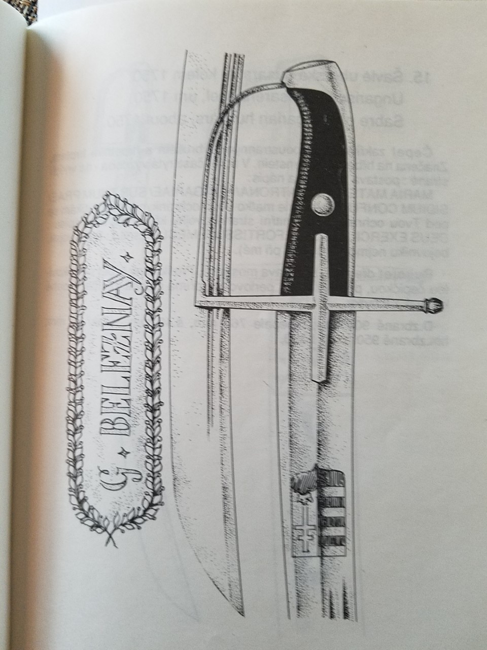

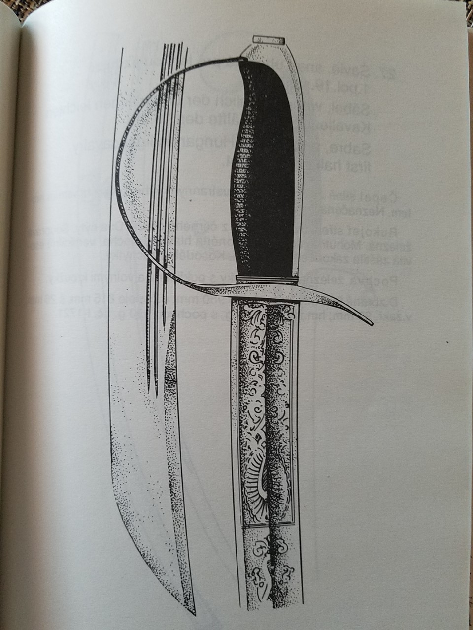

I checked my copy of "Edged Weapons of the Habsburg Monarchy 16th-20thc" (Konipsky & Moudry, Prague, 1991) as I felt this blade resembled one of East Europe, and found two examples which seem plausibly connected.
The one with the coat of arms on the blade ( p.43 ; #14) is from Hungarian hussars c. 1751-54.
The other is Austrian light cavalry first half of 19th c.
What drew me to these types were the multiple fullers in the distal half of the blade, while the beginning of the blade is of hollow ground form. With these two blades, the later (19th c,) form has three fullers.....however the style of etching seems more in line with this example Willem has.
The earlier blade seems to be in line with the fuller pattern of Willem's but this type etching inconsistant.
There were of course many variants, and these blades were typically from Styria. According to some notable experts, Hungary did not have blade making centers but of course it was then part of the Austro-Hungarian empire.
These blades were often found used in shashkas in the Caucusus, and were highly favored in Arabia and other regions, so there are any number of ways they may have entered trade networks which interacted with those of Indonesia.
I hope this will be of some help Willem, and I of course look forward to views of others with other information. In any case, a most interesting example with a very unusual blade in this context.

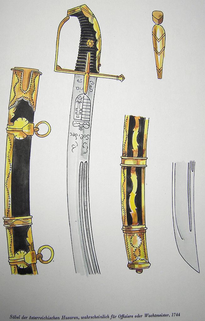

Here is another picture of an Austrian husar sabre for officers about 1744 with similar details of the blade. The drawings of the blade in question, especially the shield and arms on one side visible have a very European aspect.
corrado26

I checked the database of the dutch army museum, but did not find matching blades. Unfortunately also the most swords on their website were pictured sheated in the scabbard ?!
I intend to give it a better etching in due time to see if that brightens the decoration as well as the damascene blade.
Willem

I’m sorry we can not be of more help. It would be useful to be able to view the engraving.
There could be a general Dutch colonial connection with the blade. Then there could be an Arabian connection (through Islam) where the blade could have been captured/sold from Hungary or marketed as a Hungarian ”trophy” blade to Arabic buyers (e.g. http://www.vikingsword.com/vb/showth...light=hungaria). Damascene blades were not common in Europe so that also makes it unusual. The blade would then have found it’s way to Indonesia and recycled with local mount. An object with an Arabian connection/origin would probably be highly esteemed in Indonesia for cultural reasons.
In his book Wagner (1969, 2nd ed.) mentions the hussar blade discussed above as ”The blade is curved, 92cm long, hollowed out on both sides. It has two grooves of unequal length...” The width is said to be 3.5cm.Perhaps erosion on your blade made the grooves of equal length? Perhaps frequent sharpening made the tip more pointed? Or perhaps the blade was so customized to individual taste for an officer?
