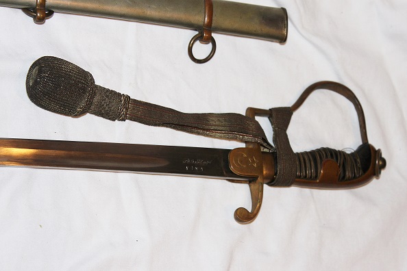

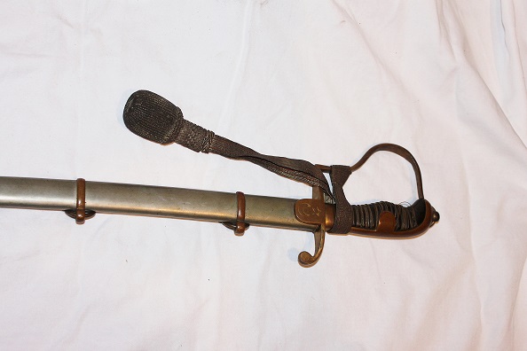

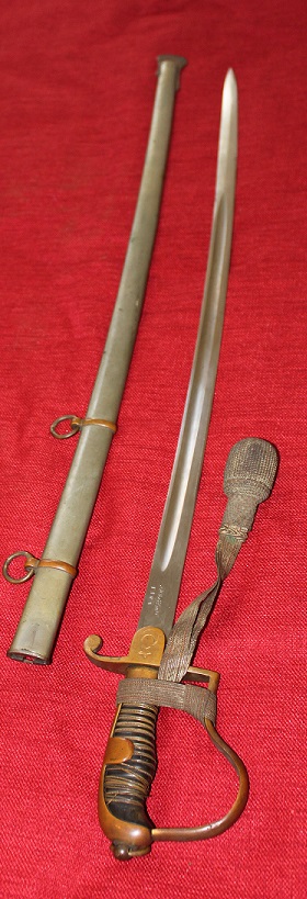

I discovered this sword in my late father in law's attic. I believe it to be an Ottoman Turkish sword but for the life of me I do not know why it has a Portepee on it.
My father in law was an officer in the US Army and served in Europe during WW2.
Any help in identifying and history of this sword is greatly appreciated.
Thank you,
Steve
Semper Fi

Hi Steve,
The sword is artillery Ober-officer M 1882/1909 was in arms in the Ottoman Empire.The portepee is not Turkish and is probably added later.Perhaps it is Prussian but I can not be categorical

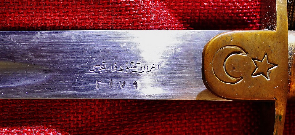

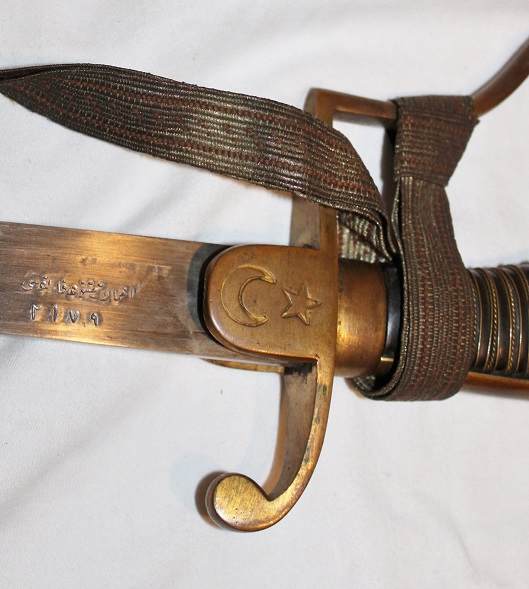

Thank you OsobistGB

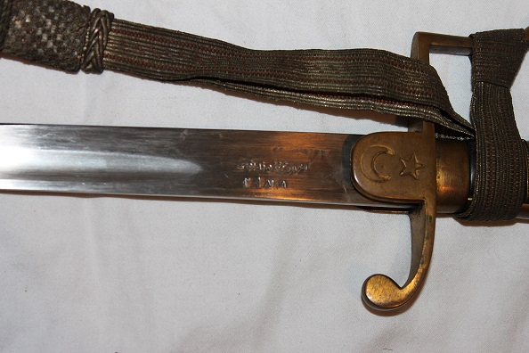

Any idea what the inscription is?
Steve

Old 29th March 2019, 10:57 AM   #4
Yes it's Turkish
It's a German Turkish Ottoman sword WWI
you have also a serial number,might be the regiment.

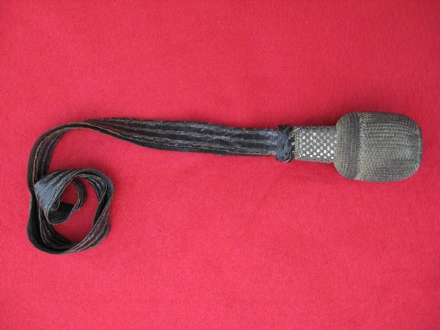

Old 29th March 2019, 11:55 AM   #5
Posts: 4,278
Side bit: The earlier Arabic style alphabet was replaced with a more western Latin style alphabet, with a few extra letters for sounds that do not get used in western languages, on 01JAN1929.
Swords and daggers/dirks) almost universally had sword knots/portepees as they are intended to aid in retention of a weapon accidentally dropped or jarred out of the hand. usually lost by the time a collector gets the item. As many nations admired and emulated the Prussians - this sword being of similar design to their modified Blucher style derived from the UK 1796LC, a Prussian style sword knot would not be out of place.
Many officers replaced the sword knot with a silk scarf tied to the sword with a loop for their hand, I presume for it's lightness and strength & for not getting their formal parade one dirty or covered in red stuff.
A Prussian sword knot:

Old 30th March 2019, 09:39 AM   #7
Posts: 2,821
Originally Posted by Kubur
Yes it's Turkish
The inscription MAY BE Turkish but the 4 punch marks underneath are definitely Arabic numbers and read 2179. Not a date obviously, but perhaps an armoury number.
Stu
Old 30th March 2019, 09:50 AM   #8
Posts: 4,278
Yup, definitely not a Hijri date, a better photo of the inscription on its own would be useful. As would a photo of the entire sword out of the scabbard and next to it.
