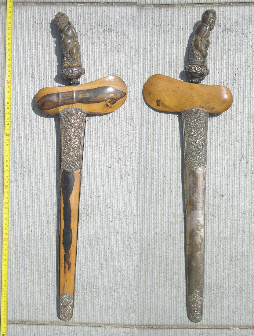

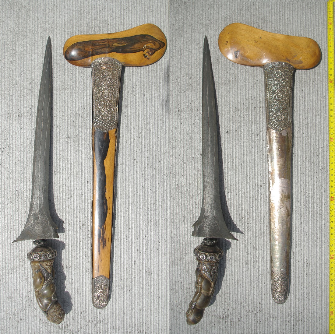

I would like more information about this Keris.

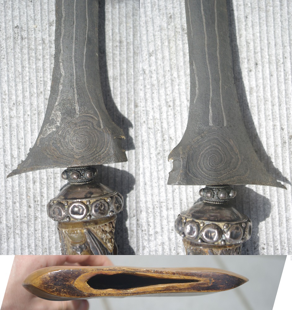

The blade shows an interesting pamor, unfortunately she lost her ganja.
The surface of the blade is not as polished as that of the other Balinese keris I own.
The sheath seems to have been modified but adapts perfectly to the blade. (Maybe it was changed after losing ganja or then recovered from another keris)
The clothing of this Keris seems to date from the twentieth century ( early or late? ), but it is well done.

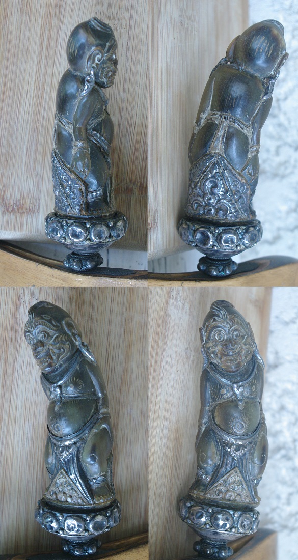

The horn handle (cow) is covered with fine silver plate to highlight the character's clothes and jewelry.

I don't believe that this sheath was adapted for this keris because it lost its gonjo. The original opening appears to have been much larger than than. I am also not sure this isn't a complete keris with gonjo iras. If the shape of the gonjo is the same as the current open suggest i thing it is far more likely the blade is iras (all one piece). Valued old sheath are often adapted to other blades like this and this sheath has some unique pelet wood markings that were probably seen as worth saving. I would think this sheath is at least pre WWII.
Interesting hilt as well. I love the expression on this guy's face.
Unusual pamor for Bali. Lombok is another possibility. The blade also looks like it may have been shortened/reshaped at some point. The pamor seems to run off the tip.

Pamor Teja Kinurung/ Adeg Tiga and Kul Buntet. Blade and scabbard not originally matching, Javanese blade?

The handle reminds me of a RARE KUMARA.
See this link:
http://www.vikingsword.com/vb/showth...ht=kumara+rare
A pity that the silver selut 'cabochons' are all bumped.

Originally Posted by David
I could be wrong, but i don't think this looks quite like a Javanese blade. If i had to guess i would say Lombok.
Athanase noted that the blade was not original to this sheath, but it does appear that the refitting was indeed done specifically for this blade so i suspect it had a life in either Bali or Lombok.
I agree that the shape of the blade is quite massive for a Javanese blade but why Lombok?
The back side of the ganja significantly sinks into the scabbard slot while the front side is flush, poor mranggi work. BTW I am not sure that the ganja is missing?

Posts: 432
Thank you all for your information.
The blade is "short", 33cm. But the pamor seems to have shown that it was longer at the beginning and that it was shortened afterwards.
I can't differentiate the blades from Bali and Lombok?

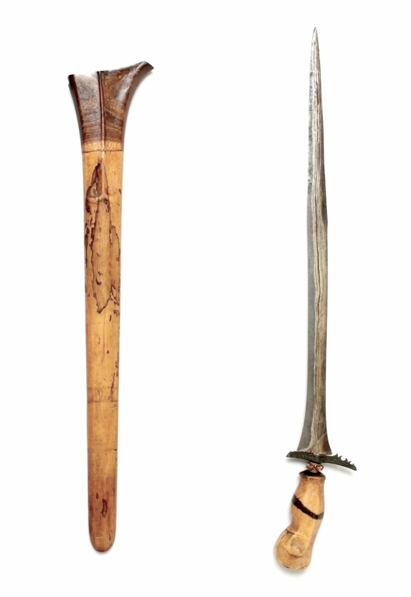

I believe i recall that certain style of "Bali" sheath was more common to Lombok, but perhaps someone can confirm that.
Yes, the kojongan or kekonjongan style of scabbard seems to have been more common in Lombok than in Bali (see pic, I bought this typical old piece in Lombok).
Athanase, from your pics your blade does not look to have been significantly shortened as the Teja Kinurung pamor pattern extends up to the tip. Regarding your question about the differentiation between the blades from Bali and Lombok, it is much too complex to be replied in a simple way but the krisses from Lombok got other influences (Java, Bugis) so many of them are not in pure balinese style as shown in the book "Keris di Lombok".
