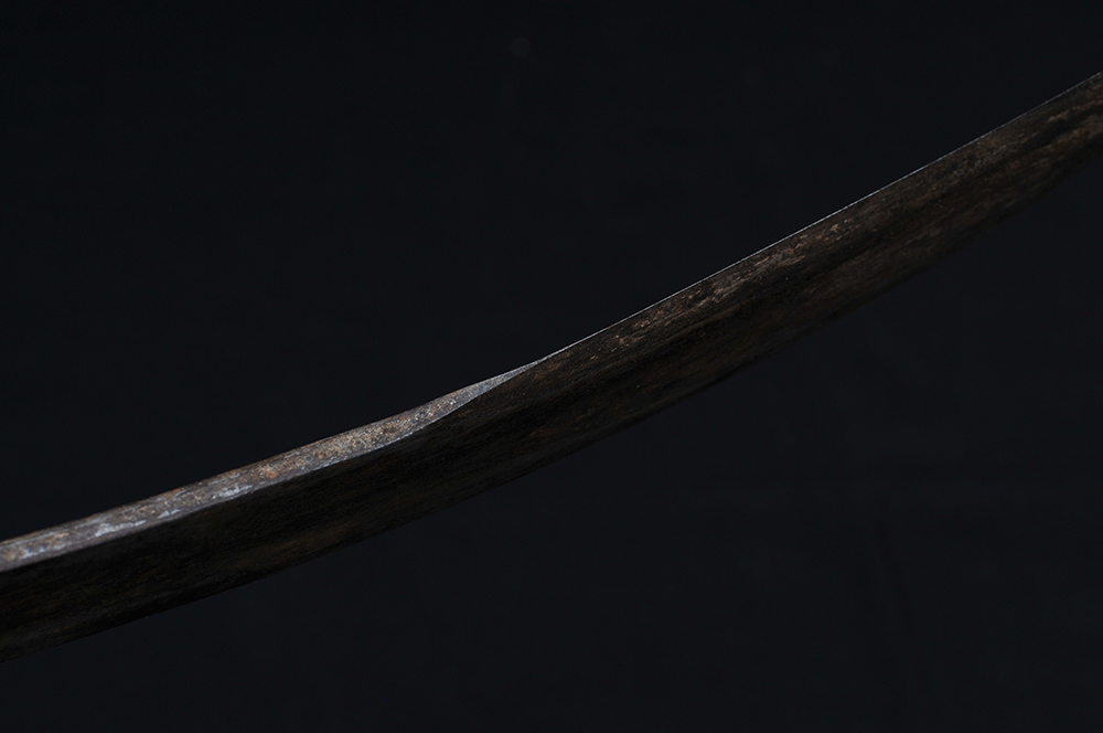

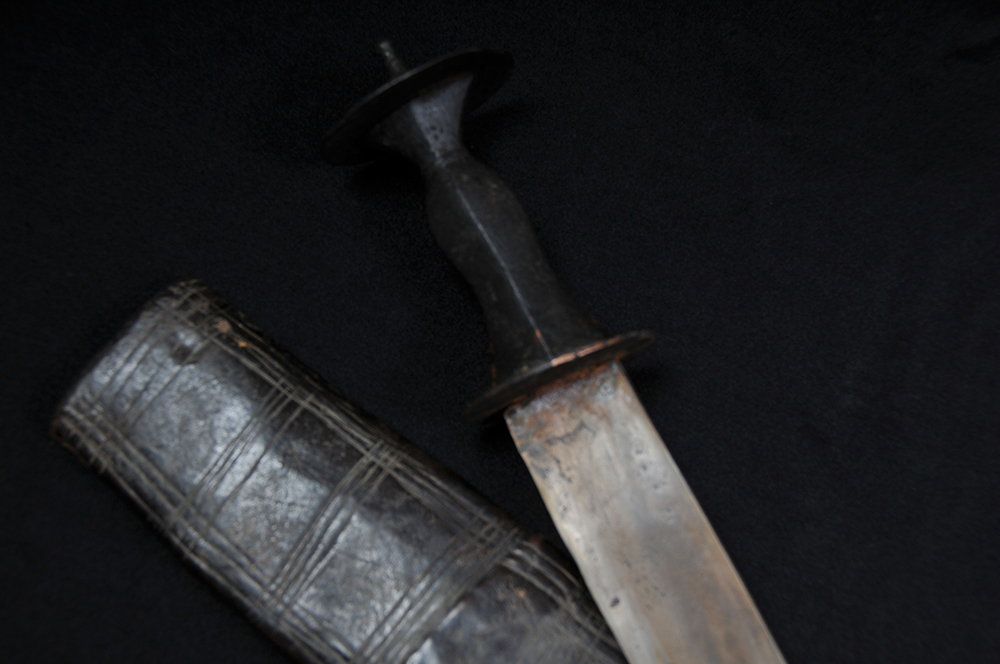

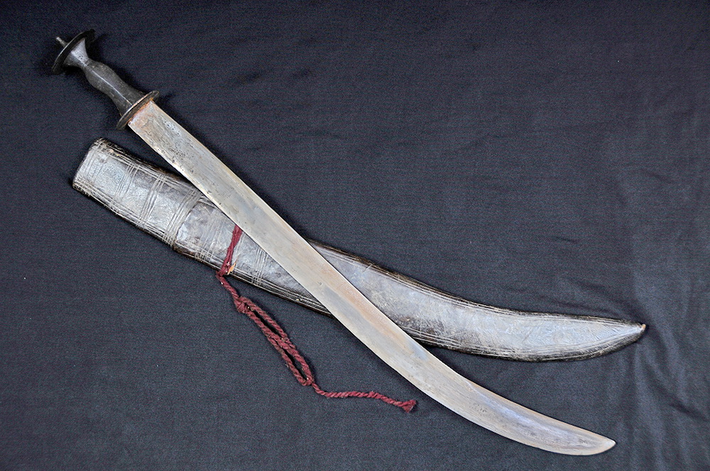

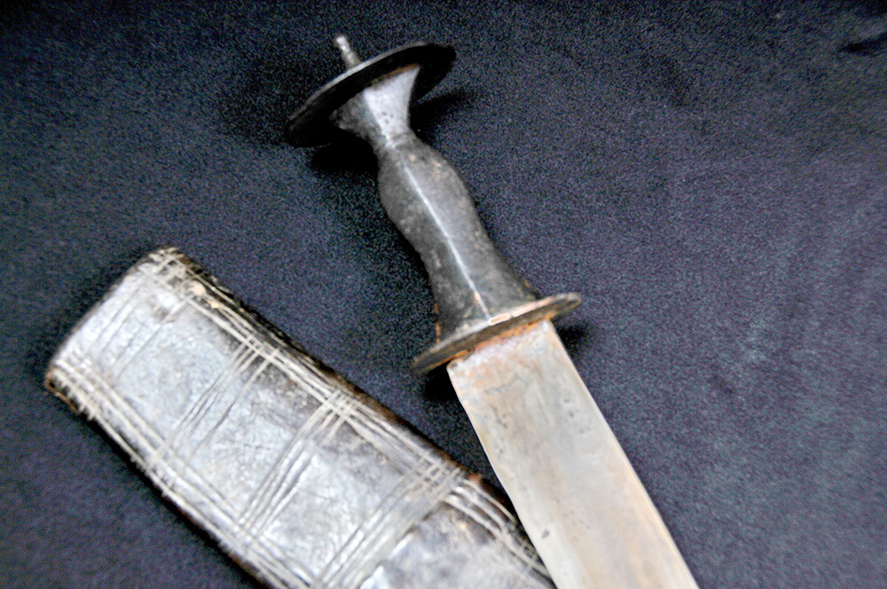

Hi folks.
Some time ago I bought an unusual saber. The shape of the handle is associated with Nepal or North India. However, I have never met such a saber before. The blade is quite heavy and sharp. I can assume that the saber was made at the end of the 19th - beginning of the 20th century. What is your opinion about the saber?

I have lightend two of the pictures a bit.

Rare too see one of these, especially with a compete scabbard!

Looks like a good Nepali Tarwar, they still make them, tho less curved and usually with a khukuri type grip rather than the talwar style...Kind of a generic Himalayan dao. They're still popular in some quarters.

I can assume that the old hilt was put on a later blade. The blade is quite simple, blades of this quality in Nepal are usually used not only as a weapon, but also as a utilitarian tool or weapon for slaughtering cattle.
