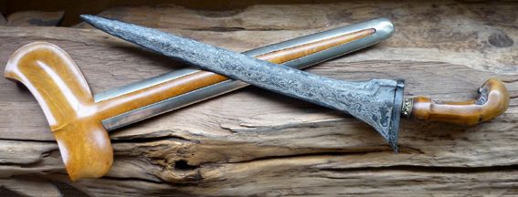

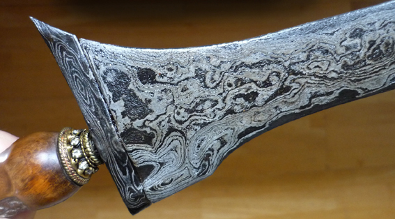

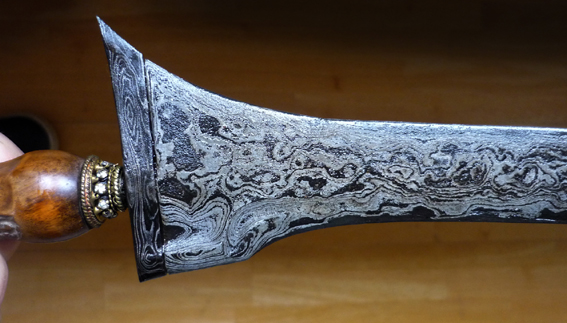

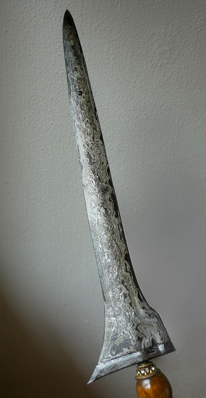

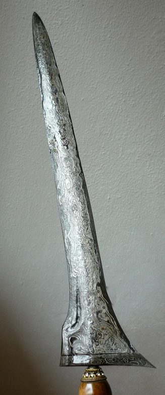

Here is a recent purchase of a keris from Solo.
The blade is strikingly wide with fine Pedaringan Kebak pamor and interesting pamor at ganja sides.
This could be a Tuban blade from Pajajaran era?
Gandar iras dress (it may look pretty young but it isn't) Cendana kayu?
Anybody interested to chime in?

I like the blade. It's sturdy and shows character.

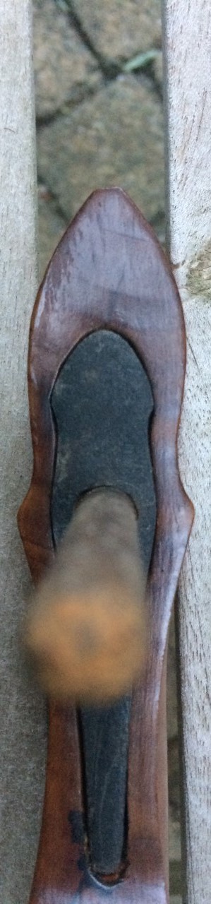

If possible, post a photo of the top of the gonjo (like shown on the below illustration). Tuban blades have a very specific style of gonjo, so such a photo could help in identifying if the blade has a Tuban style (which is not to say it would originate from the Tuban era).

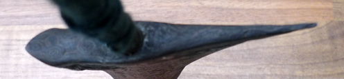

Here is a pic and it looks quite the same to me.
Paul B. is offline   Reply With Quote

Paul, I'm afraid you've read too much into the illustration I provided. The illustration I added was only to show from what angle to take the photo, it does not show a Tuban gonjo.
As your photo is taken from an angle, it is difficult to see, but from what I can glance I'd say the gonjo is not Tuban.
In this thread you can read more about what a Tuban gonjo looks like.
Bjorn is offline   Reply With Quote

Maybe it isn't the original ganja.

Based upon what I believe I can see in the photos, the gonjo might be a replacement, I cannot tell from the photo, and the blade classification is moving towards Tuban, but I would hesitate to give it as Tuban.
However, this brings us back to a continual problem with the Tangguh system of classification:- if it is not Tuban, what is it?
Is it in fact classifiable at all?
Well, I think it probably is classifiable but I'd need it in my hand to give any opinion, and that opinion would be based upon a balance of the indicators.
But is it Tuban Pajajaran?
No, sorry we cannot go there. As with just about all tangguhs, there are definite indicators that you can home in on as soon as you look at a blade, and then you try to confirm or discard those indicators by putting the other indicators on one side or the other of the balance.
In Tuban Pajajaran the lower gonjo tail below the buntut urang,that is, the area where we would look for a tungkakan if there was one, declines as it joins the wadidang. On Paul's keris the gonjo is straight, thus it cannot be classified as Tuban Pajajaran.
There are multiple other indicators that would need to be assessed in the hand, but that single "tungkakan" indicator disallows Tuban Pajajaran.
If we classify a blade as Tuban-Pajajaran, that does not necessarily mean that it originated in the Pajajaran era. The Pajajaran era ended in 1579.
The pamor at the gonjo sides is simply a random pamor that has had its appearance altered by forging to elongate the pattern, the wrongko is probably Cendana Jawa, that is unscented sandalwood.The jejeran is less than good,as also is the mendak, in fact these two items spoil the entire ensemble, which is actually pretty nice.

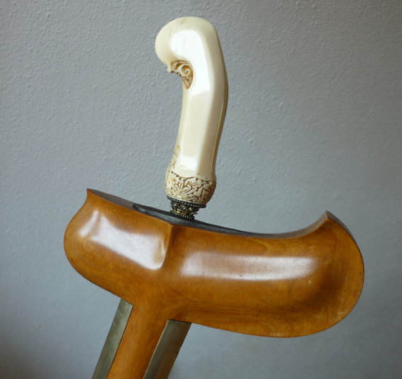

Thanks Alan for your insight and I have replaced both mendak and handle as I fully agree these are 'disturbing' elements.
The ivory handle has an integrated selut that is a decoratively carved bases. Quite unusual.

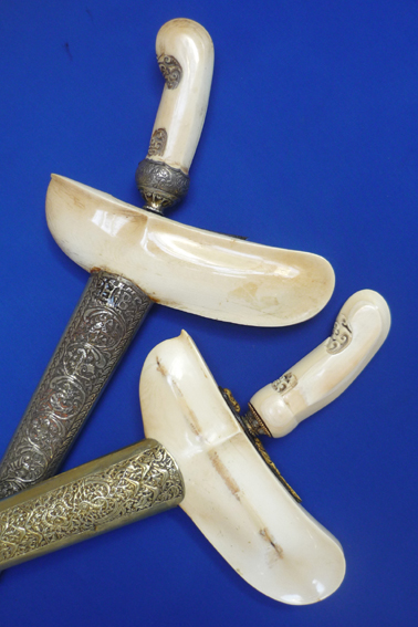

Very nice Paul, very nice indeed, but if you have one, I'd change that very nice ivory hilt for a dark wood hilt, possibly a yudowinatan?
It is deemed to be good taste to have a hilt that is darker than the wrongko.
Really as it is now it looks wonderful, its just that the darker hilt is more in line with conformity.
Old 30th June 2018, 01:13 AM   #9
Posts: 6,442
This begs the question Alan.
What would this ivory jejeran be suitable with?
Or is it just bling?
The carving looks to be exceptional.
Old 30th June 2018, 04:10 AM   #10
Posts: 7,263
Rick, I'm talking top level kraton taste. The elite in the Surakarta Kraton tend towards restraint. Its a case of "less is more". Rolls Royce type class, where you do it rather plain but top quality X 200%.
One of the established standards for top class dress combination is that the hilt should be at least a little bit darker than the atasan of the wrongko. Yeah, at night-time functions you'll see the diamond seluts come out, and sometimes diamonds on the pendok. But plain high quality is more or less the benchmark of good taste.
So just where does a brand new, dead white ivory jejeran belong? Frankly, I cannot see it in a kraton setting. Maybe in a non-kraton setting, plenty of opportunity there I guess. I've got several planar hilts in ivory, only one is new and white, that is mated to a wrongko that is also dead white.

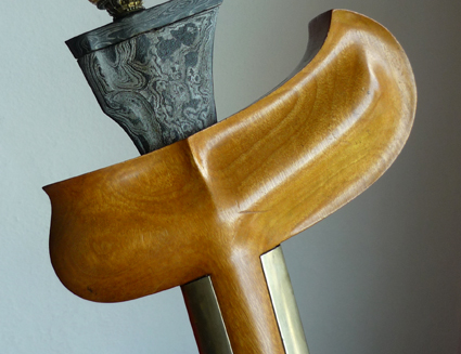

This wrongko of Paul's is a real classic, nice old mamas pendok, its a terusan, or iras gandar, should this sort of wrongko be mated to new ivory hilt that has been made as a display piece? I think not. I'd like to see it with a good, old tayuman yudowinatan.
There is no doubt that this keris looks nice as it is, but it is a classic, in my opinion it would look better presented as a classic. In a kraton setting I cannot imagine who might be able to wear it the way it is.

So 'white always meets white'? Is that what you're saying Alan?
I am aware of the 'unwrtitten' rule that a handle should look darker than the scabbard. So it just means that ivory handles are only applicable as in the underneath pic?
BTW> Why are ivory Solo ukiran much more scarse than the Djogja ones from the same material?

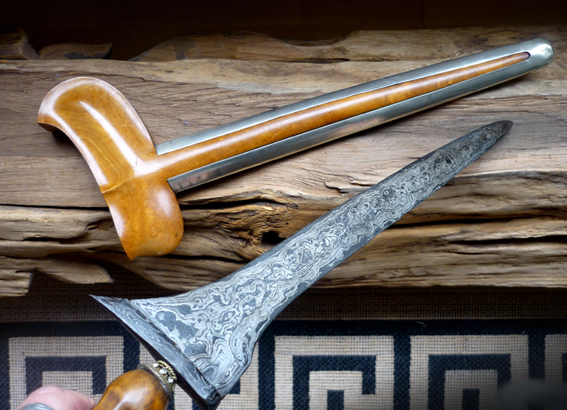

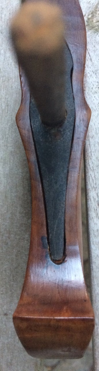

Any clue why there is a kind of kendit in the scabbard depicted below? It is not a scratch.
Old 1st July 2018, 10:14 PM   #12
Posts: 7,263
I don't know about the "always" thing Paul, all I know in this respect is what I've seen, and I can never recall seeing ivory dress actually being worn. I'm inclined to think that at least in Solo it could be more a display thing than something that has a place in the dress code.
Ladrangs are used for formal occasions. Ivory should not be exposed to sunlight. Gayams are for non-formal occasions. One really tries to avoid wearing a gayaman when one should be wearing a ladrangan. Just where does a complete ivory gayaman fit in? Just hypothesising now, but maybe at a wayang performance, or a public dance performance, but these days most people choose to wear Levis and batik, rather than Javanese dress.
But then keris are worn all over Jawa, I guess anything goes once you move to Jakarta or Surabaya. Jakarta in particular is not really regarded as a part of Jawa, of course it is not, but I have known a lot of people in Solo who have seemed to regard Jakarta as beyond the Pale, just as in 17th century Ireland only the Pale fell under English authority, and the area beyond the Pale was thought of as uncivilised, barbaric, so these Solo people regard Jakarta as almost a different country, not civilised at all. So, once outside the influence of a kraton, things change.
Why more ivory in Jogja than Solo? Keris in Jogja have become an industry, Jogja itself is easy for outsiders to penetrate, Solo on the other hand is very reserved, secretive, you do not get accepted to the "inside" very easily in Solo, but in Jogja its pretty much a matter of what you are worth. Keris craftsmen in Solo are people who are spread out all over the place and they work alone, in Jogja there can be a community of keris craftsmen. Jogja has higher production, lower standards. If ivory sells, ivory will be produced on the hope of speculative sale. Doesn't work like that in Solo.
The "kendit" is possibly because the carving needed to go close to the skin of the ivory.

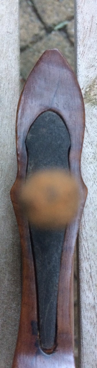

Hello all,
Would the below be considered to be a type of Tuban gonjo?
Old 17th July 2018, 10:15 PM   #23
Posts: 7,263
"--- a type of ---"?
yes, very probably.
