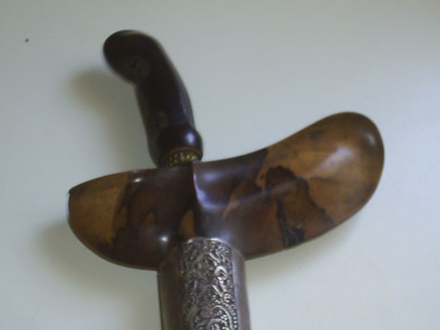

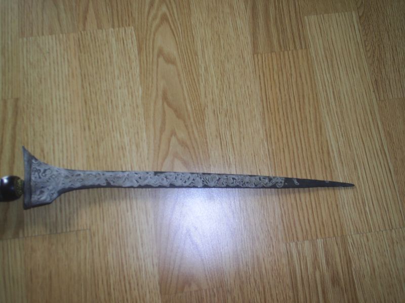

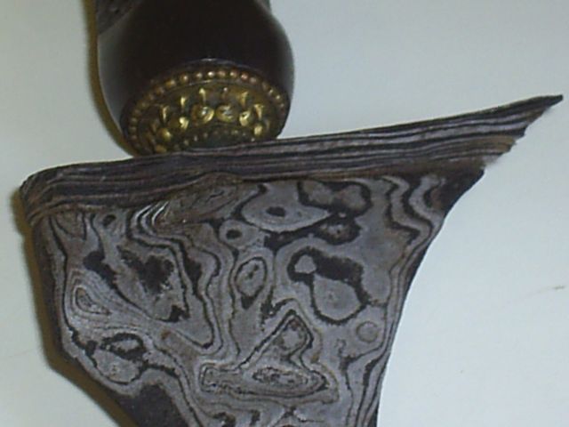

Hello everyone. I am a member of swordforum.com. I am new to sword ownership and someone at swordforum told me I needed to bring my problem here to be solved. My sister has lives in Jakarta, Indonesia for the past 10 years. On her most recent trip to canada she brought with her a sword she had purchased over there. Here is the brief but suspicious tale she told me. She was in a town called Yogajakarta, Indonesia. She had recently completed a tour of the palace and had seen several Keris'. When she asked the Palace security guard where she could purchase a keris for her brother in Canada the guard obliged her request by taking her and her translator back to his home in the village where she was shown some very nice blades. Upon choosing a keris to purchase, I am not certain as to the price she paid, the guard performed the following ceremony. He removed the keris from the sheath, put it onto it's tip, and proceeded to go into a "trance", while in this trance my sister said the keris stood upon ots tip without ais or support og anykind. The man blessing the sword did so for peace and harmony as my wife and I purchased a new home. The guard told my sister the blade was between 75-100 years old. Other people on the swordforum said the blade looks new. I would really appreciate any help you can give me regarding the quality of the keris, possible age verification, and spiritual qualities, i.e. good blade v.s. evil blade.

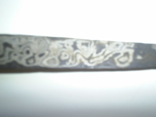

A couple of observations ; though the pictures you have submitted are kinda fuzzy and we would also love to see the ukiran (handle) .
I'm going to take a wild guess and say that the pamor or pattern on the blade looks like wos wutah (scattered or strewn rice grains) which is a beneficial pamor pattern aka 'friendly' .
I'll go out on a limb and say that this is not an 'evil' keris .
The cross piece on the scabbard is of the gayaman form which is considered informal . Hard to tell about the pendok (metal sleeve on the scabbard) but I'm willing to guess that it is fairly new .
I think we'd all like to see some better pictures of the entire piece .
Now I'm thinking that if your Sis bought this from a palace guard it is most likely not the first one he has sold to visitors from other lands .
I think you'll find that there is always a story that accompanies every keris sold in Jawa . the idea is to purchase the keris rather than the story .
From what I can see (from the pictures) it looks like an average keris in quality ; age is hard to determine from photos .
Whatever it cost the money has been spent and at this point is of no account . The real question is whether you like it or not ; if you do then it was worth the price .
I hope you'll stick around and learn a little more about these fascinating cultural icons .

Welcome back again, I thought the "problem" was already solved on the swordforum In case you want serious opinions from people here, I recommend you take some better pictures first.
I agree with Rick, from a blurry distance it looks like scattered rice grains.
I sincerely hope its not a evil keris, but you never know Did you hear it rattle in the scabbard already? Some keris are said having those special powers.
In case you're looking for a value indication just check the closed items on eBay, you find plenty similar keris.

I have a feeling that when we see a better picture of this keris the pamor might turn out to be "golden rain" or some variation there of.
I also doubt you've got an "evil" keris there.
If the keris pleases you very little else matters.

I join the question for more and better pictures. First impression is a lovely keris and certainly not a tourist toy.
Aging a keris blade is very difficult, but 75 to 100 years is a very good possibility.
Pamor beras or wos wutah is at he moment the best guess but like Nechesh said who knows what we see on a sharp picture. The scabbard has wrangka gayaman, Yogjakarta style, the dress for daily use. If correct the ukiran is Yogjakarta style too.

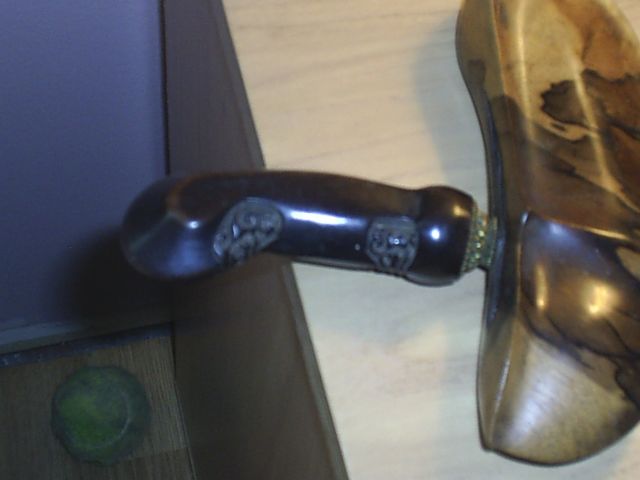

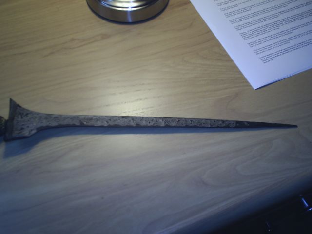

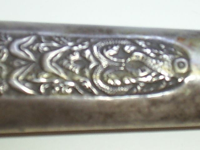

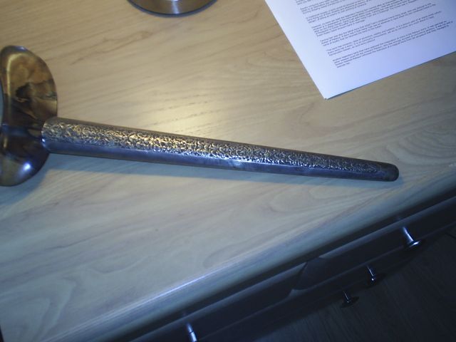

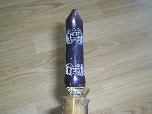

Here are some more pictures.

The blade is fine .
The pictures ......... well
We really need to see the entire pattern on each side of the blade in focus .
For care of the blade ...
A little keris oil maybe ; no more than that for now .
BTW , if you're going to pursue your interest in keris please buy from reputable dealers rather than electronic auctions .

The fittings, hilt (or ukiran) and sheath (or warangka) is in Yogyakarta Gayaman form. As said before, for everyday use.
About the blade, the ganja area (the other piece, lower part of the blade), seems to have some age to it with some worn-down area. The ganja has Pamor Mas Kemambang, i think. I'm no expert.
Overall, a slightly above average piece in good condition.
A little oil to prevent rust would be sufficient for now.

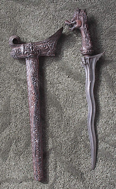

Here is my first "ethnographic" weapon. I paid a similar amount as your sister did. The good news is it led me here and opened a whole new world for me. You never know.
All the Best

Originally Posted by Jeff D
Hi scattered,
All the Best
Jeff
