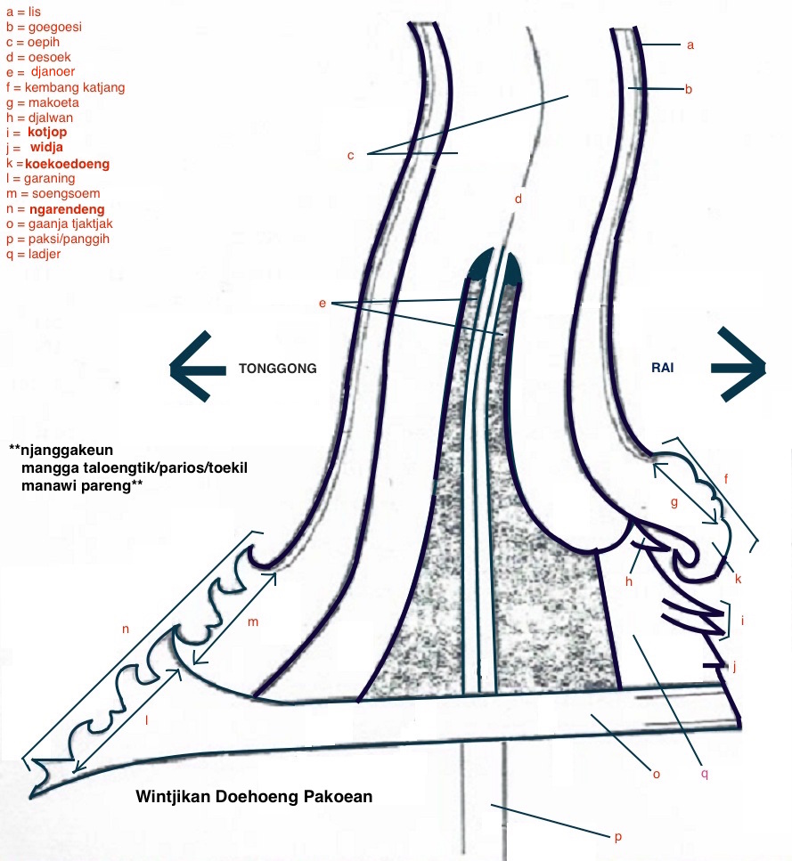

Hullo jagabuwana,
I am indeed heartened by your stated passion/enthusiasm and wish you well.
I just thought that I’d drop you the following diagram of blade details (the details are in their simple/basic forms).
Perhaps you may wish to consider it. (It may point/spur you in a particular direction.)

Thanks all for your contributions. I have heard about this pande migration hypothesis too - makes sense.
Amuk Murugul, the diagram with Sundanese terms is much appreciated! Did you label this yourself? I am interested to know why the author would use the Dutch / pre reform orthography.
