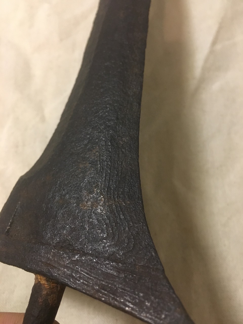

1) There is some kind of crater-like relief or depression clearly visible in the first photo. I doubt it's pedjetan, probably a defect or damage.

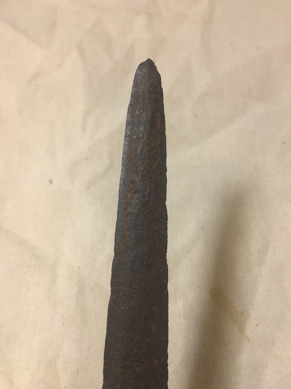

2) Significant corrosion towards the tip

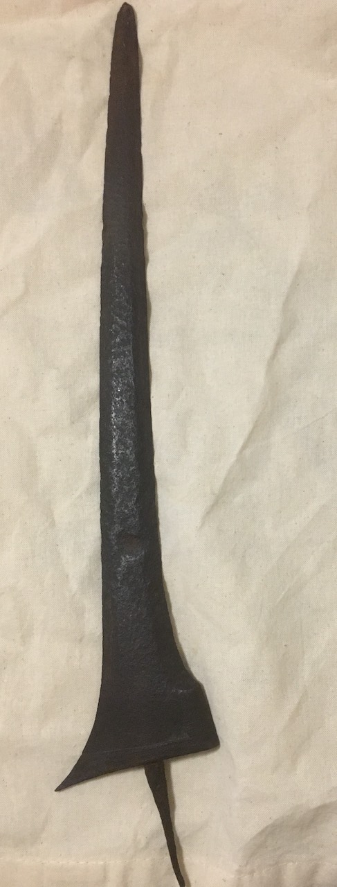

3) Evidence of pamor?

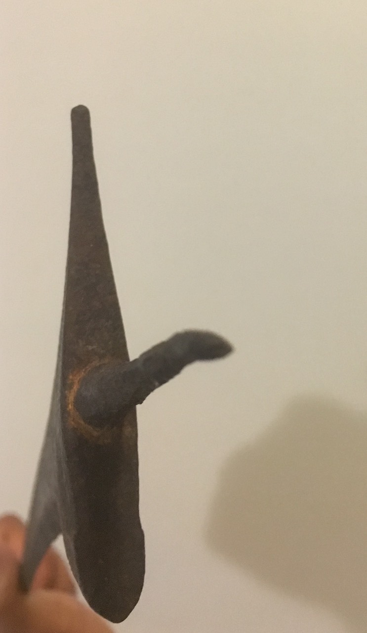

4) Not a very pronounced sirah cecak, and quite a uniform gonjo until the buntut. The pesi is a little twisted at the end, but looks more exaggerated in the photo. Not sure if the oxidation where the pesi meets the gonjo is evidence of mechanically fixing the pesi to it, or something else. I tried to scrape bits off and bits of some fibrous matter seemed to come off with it, which definitely didn't seem like corroded steel but perhaps wood or cloth.
It might well be a defect from forging (i. e. missing layer of pamor) - this should be possible to verify once the pamor structure becomes clearly visible upon cleaning.
Looks like there's still enough metal to keep it as is. Of course, another option would be to re-profile the blade tip. Not something to decide now - clean it first...
Pamor is obvious from the layered structure. The amount of possible contrast would only be visible after staining; however, many Bugis collectors nowadays prefer to only utilize weak organic acids like vinegar or fruit juices (despite historic evidence of warangan having been applied to at least some Bugis-style blades (IMHO quite likely for those with complex pamor). You'll probably be able to see some inadvertent staining during any gentle cleaning process.
4) Not sure if the oxidation where the pesi meets the gonjo is evidence of mechanically fixing the pesi to it, or something else. I tried to scrape bits off and bits of some fibrous matter seemed to come off with it, which definitely didn't seem like corroded steel but perhaps wood or cloth.
Quite possible that these are textile remnants of an earlier pressure fit buried into the rust. You'll need to clean the blade thoroughly before being able to study the pesi-gonjo fit in any depth, I guess.
Ergo, 4 votes for gentle cleaning!
